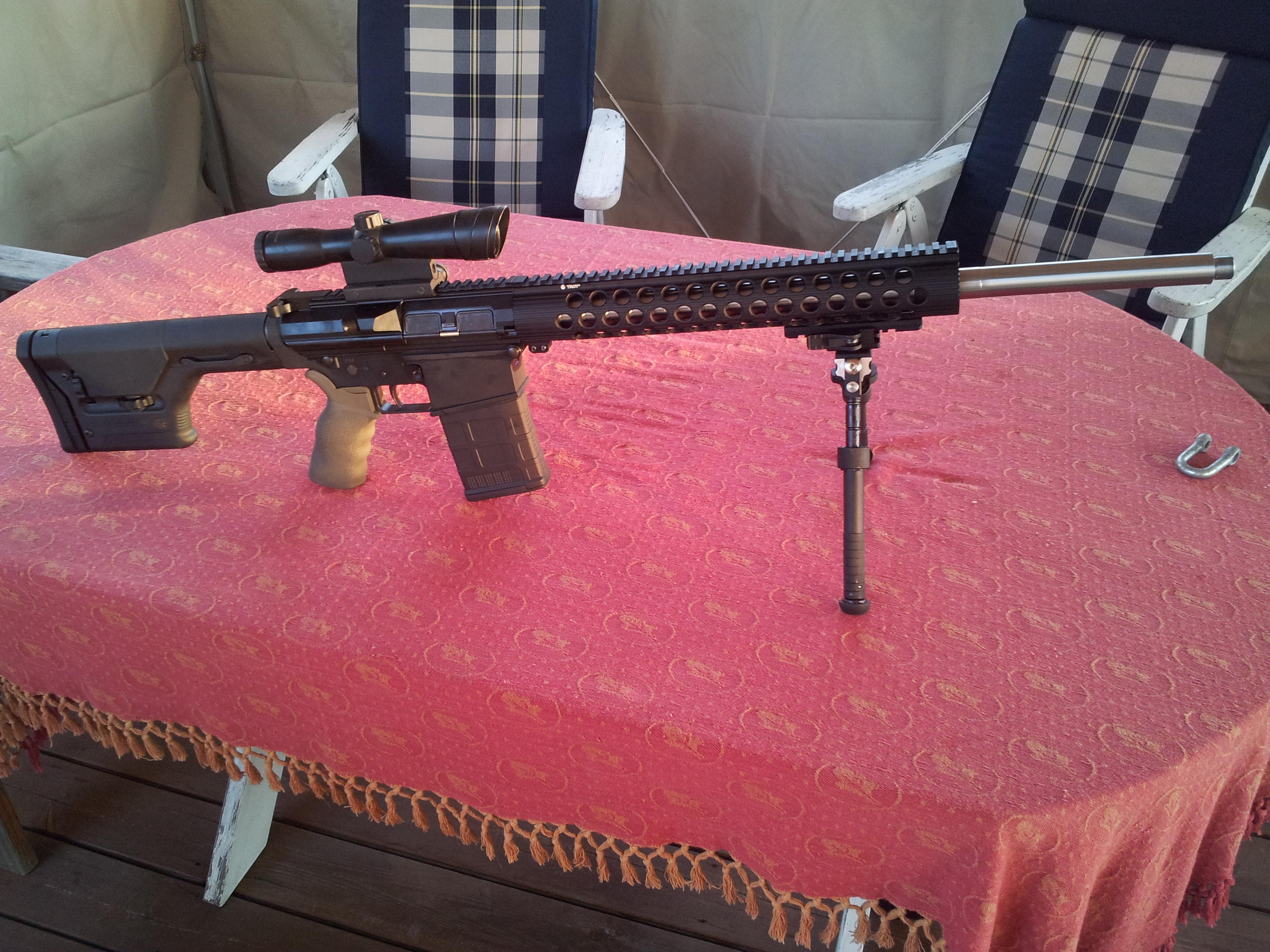

Hi I have a DPMS build that I testfired today and it did not work with Norwegian Nato 7,62x51 ammo, but the I tried with some handloads that had 168gr bullet and 42gr of N140 behind it at this made the gun cycle.
The gun Is buildt up with:
DPMS lower and upper
DPMS BCG
DPMS bull barrel, a 24" that is cut down to 22"
Brownell std buffer and bufferspring
Have checked gasblock posision and it's ok

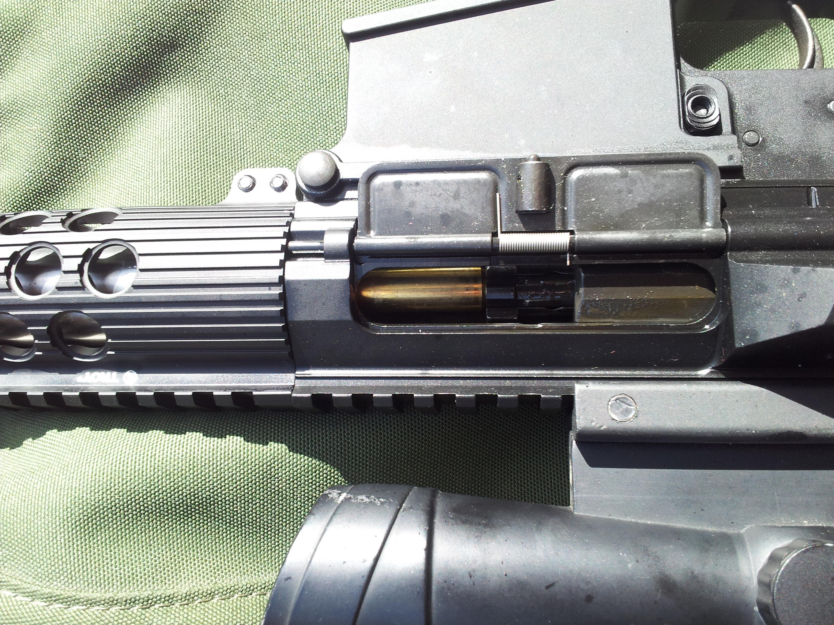

You see the emty casing in the second picture
Need help here :)

It not occurring with the other ammo makes me lean towards the Norwegian being a bit under powered. Did it happen with every Norse round or just one?
What you are showing is a classic short stroke, typically gas related.
Check the standard items such as gas ring condition, stagger, gas key secure to bolt carrier etc.
Keep in mind this is a new build so things are tight, especially if you selected premium bolt and carrier components.(NVM, you used stock DPMS)
Keep it well lubed and shoot known, good factory ammo. Let the machine wear in a bit.
