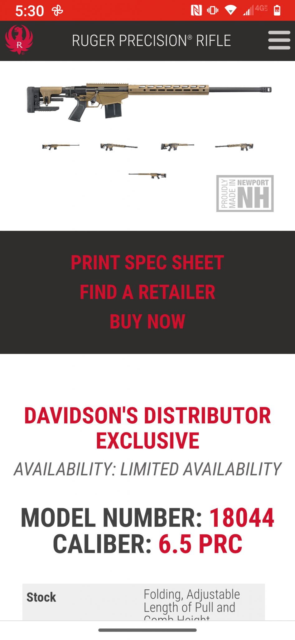

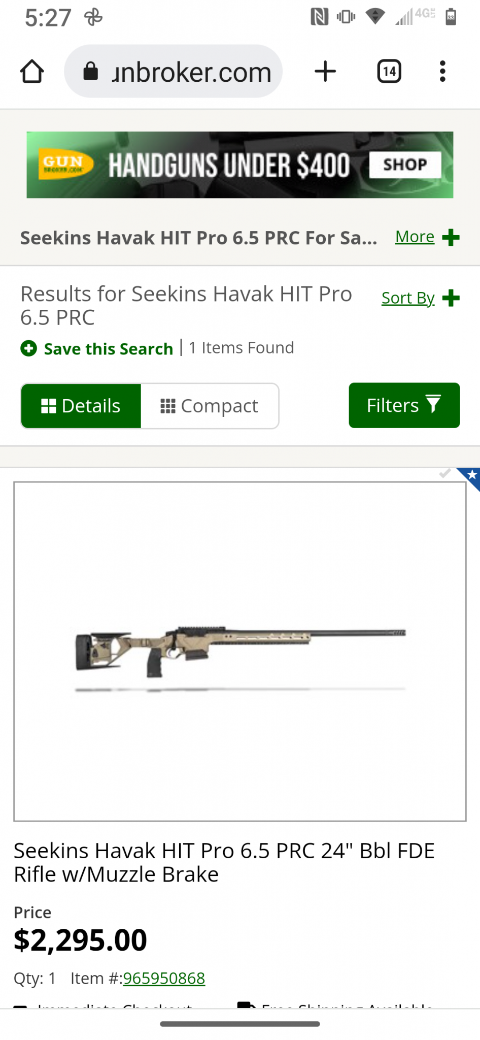

Thank you all for your help. It sounds like bolt action rifle is the best way forward for 6.5 PRC. Do you have any suggestions for good 6.5 PRC bolt action for about $1500? The budget can go up little bit if there is really good solution on the market
The Ruger can be found in your budget, but I'd recommend the Seekins if you can pay the extra, there's a few on GunBroker under 2K

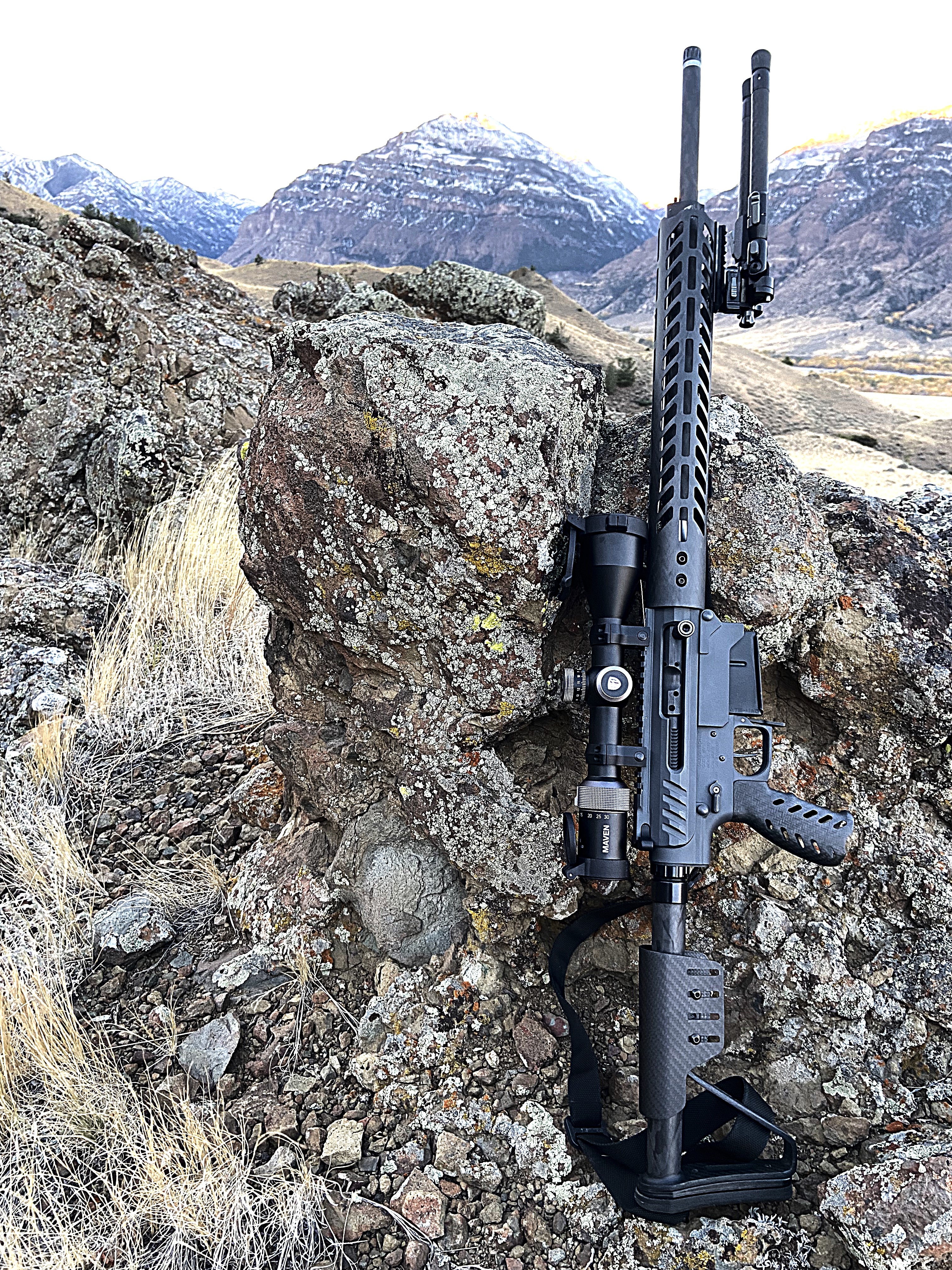

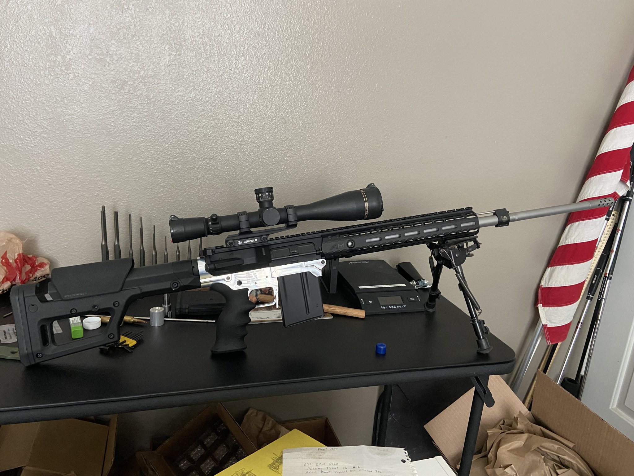

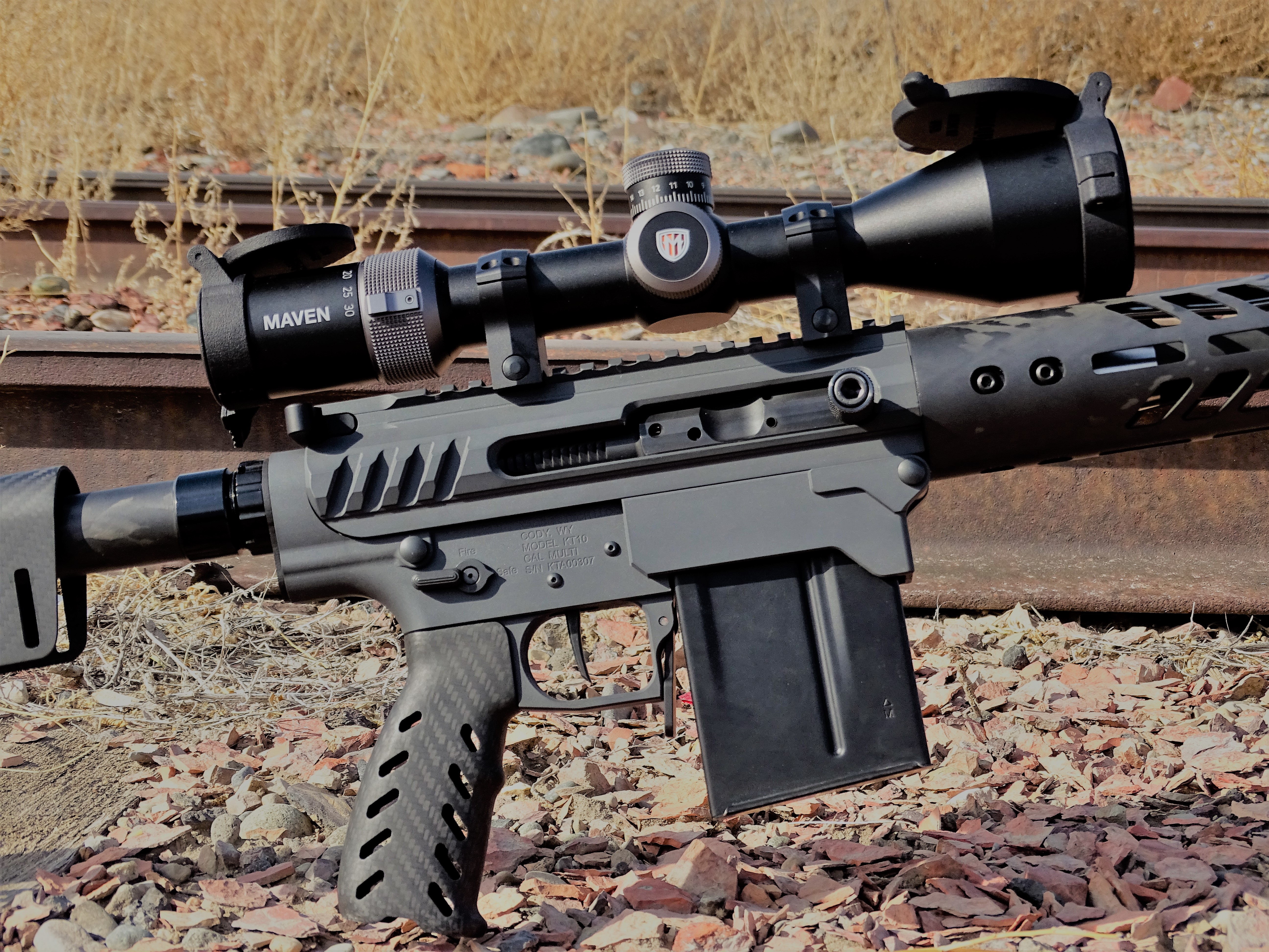

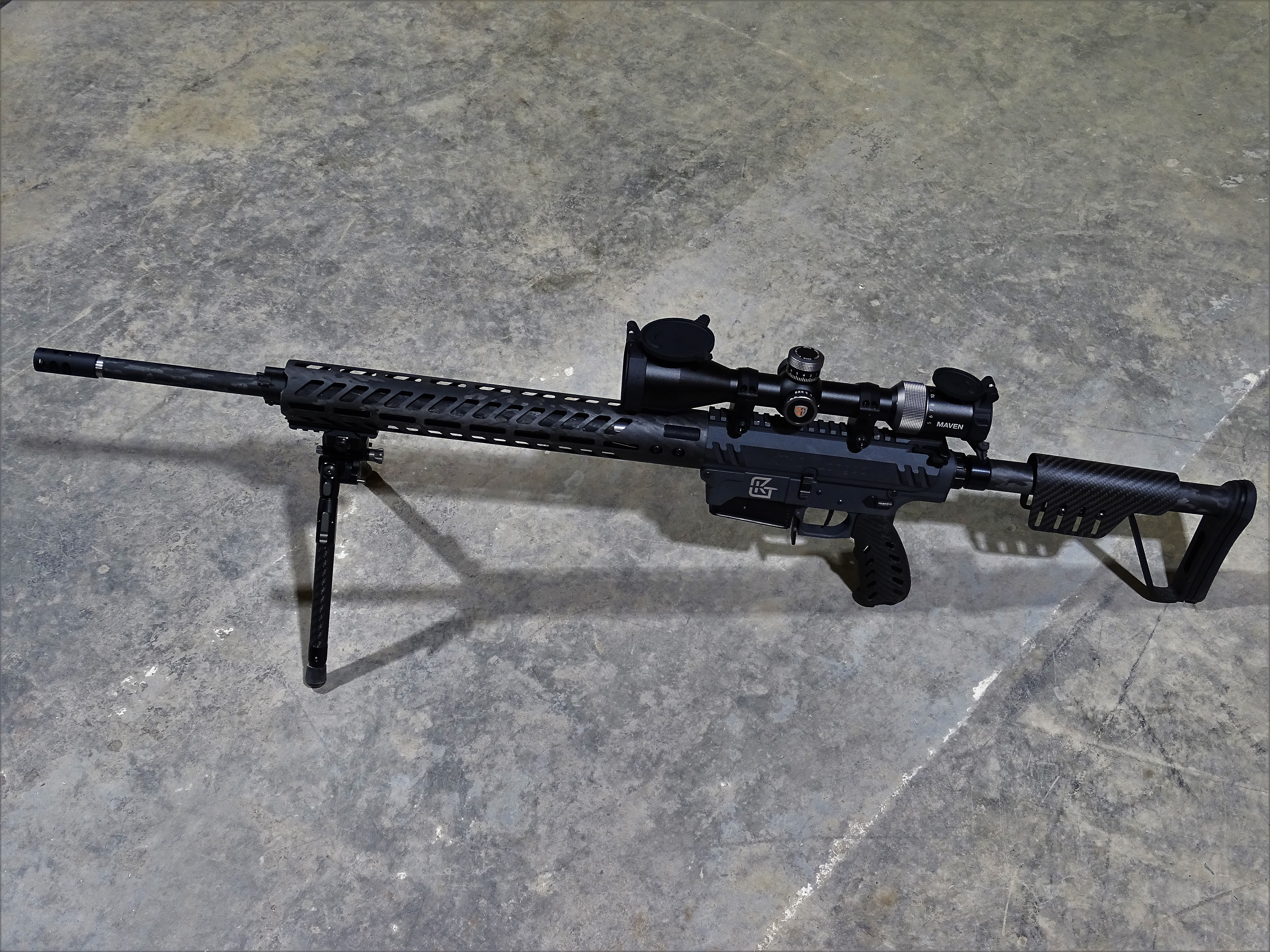

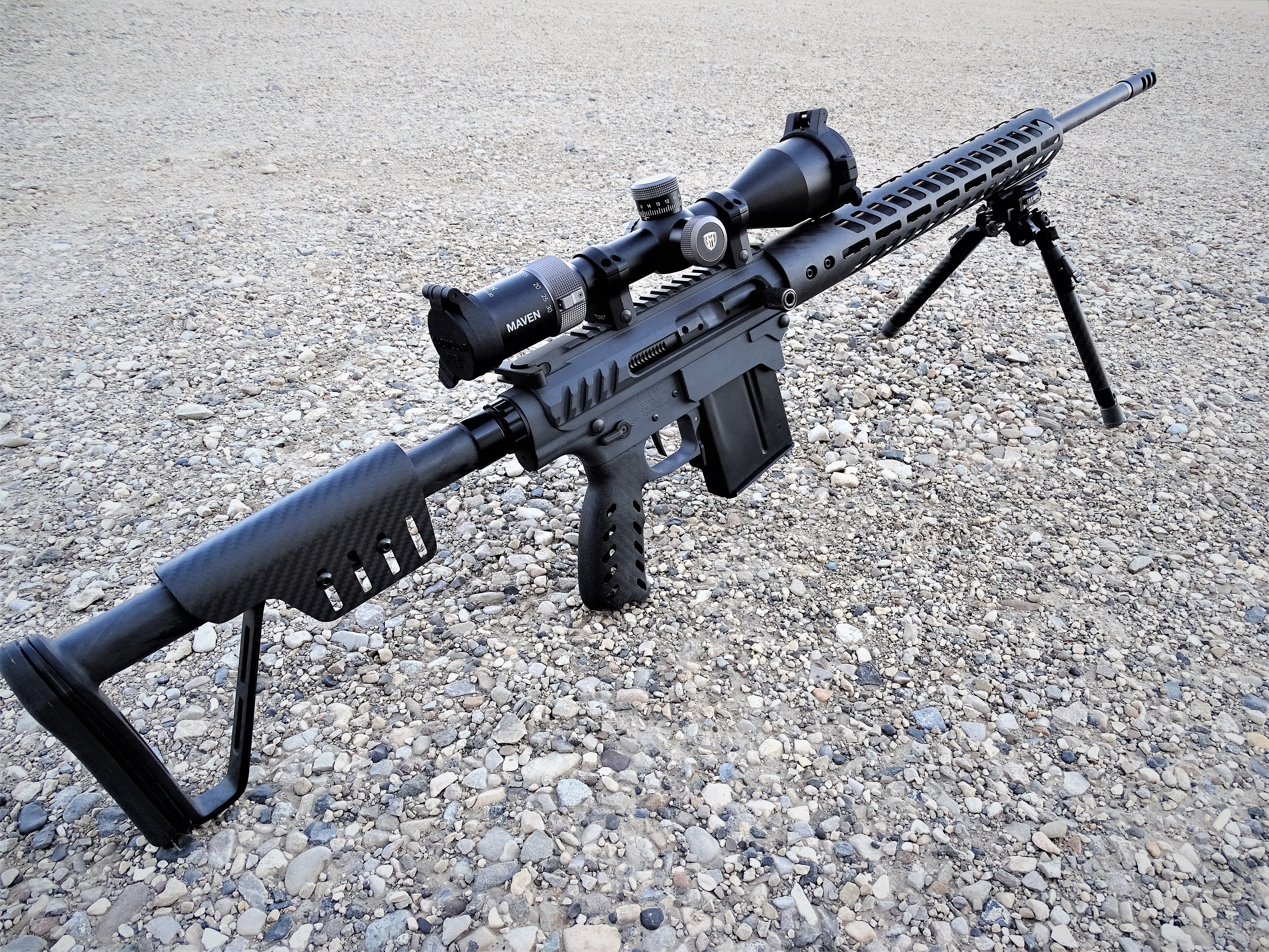

What is this madness built in Wyoming? More info needed.
This is my own design. I've got a small CNC shop and type 7 FFL and spent the last several months modeling up a receiver (mainly because I just really wanted one). I've opened up the bolt face to .54 and modified the extractor in order to except the larger rims. I also wanted a more reliable magazine, so I designed it to work with a AICS short action mag. So far, the gun chambered in 300 WSM feeds great, though I'm still messing with the tuning to get it as perfect as possible. I have a 6.5 PRC barrel, so once I get the rest of the parts I'm going to test that one as well. I'm expecting to to work similar to 300 WSM, but we'll see.
