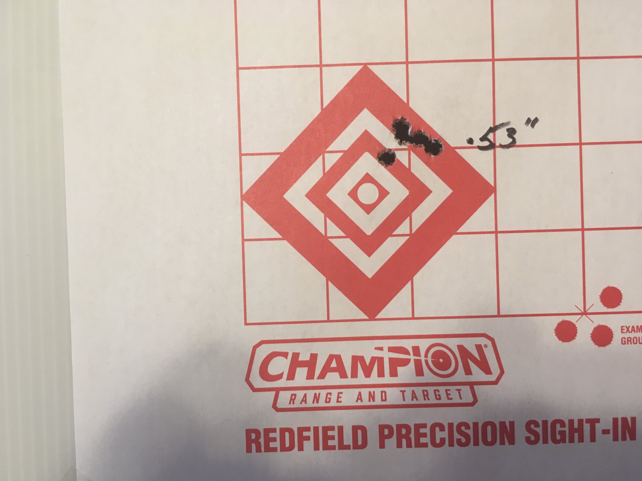

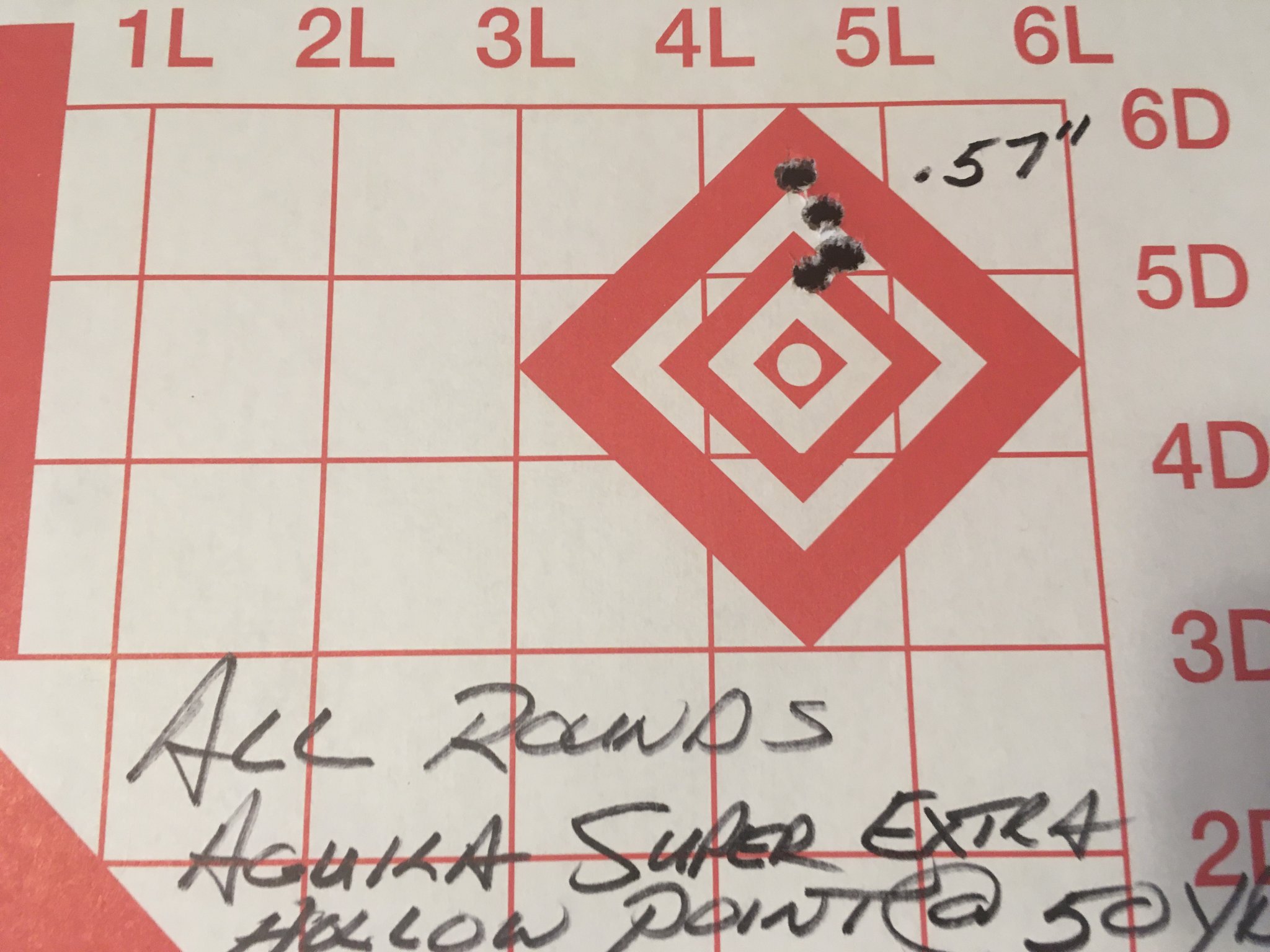

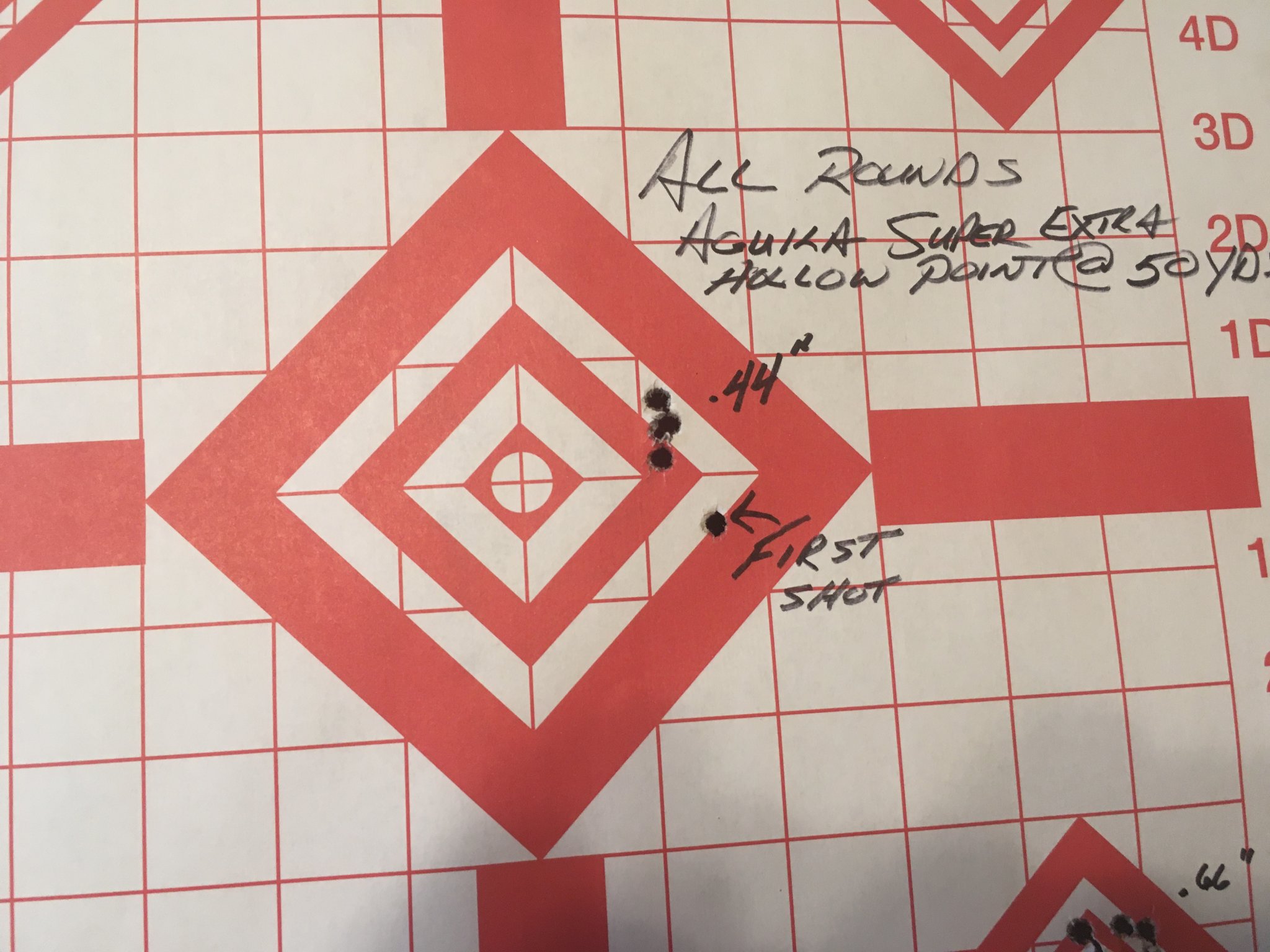

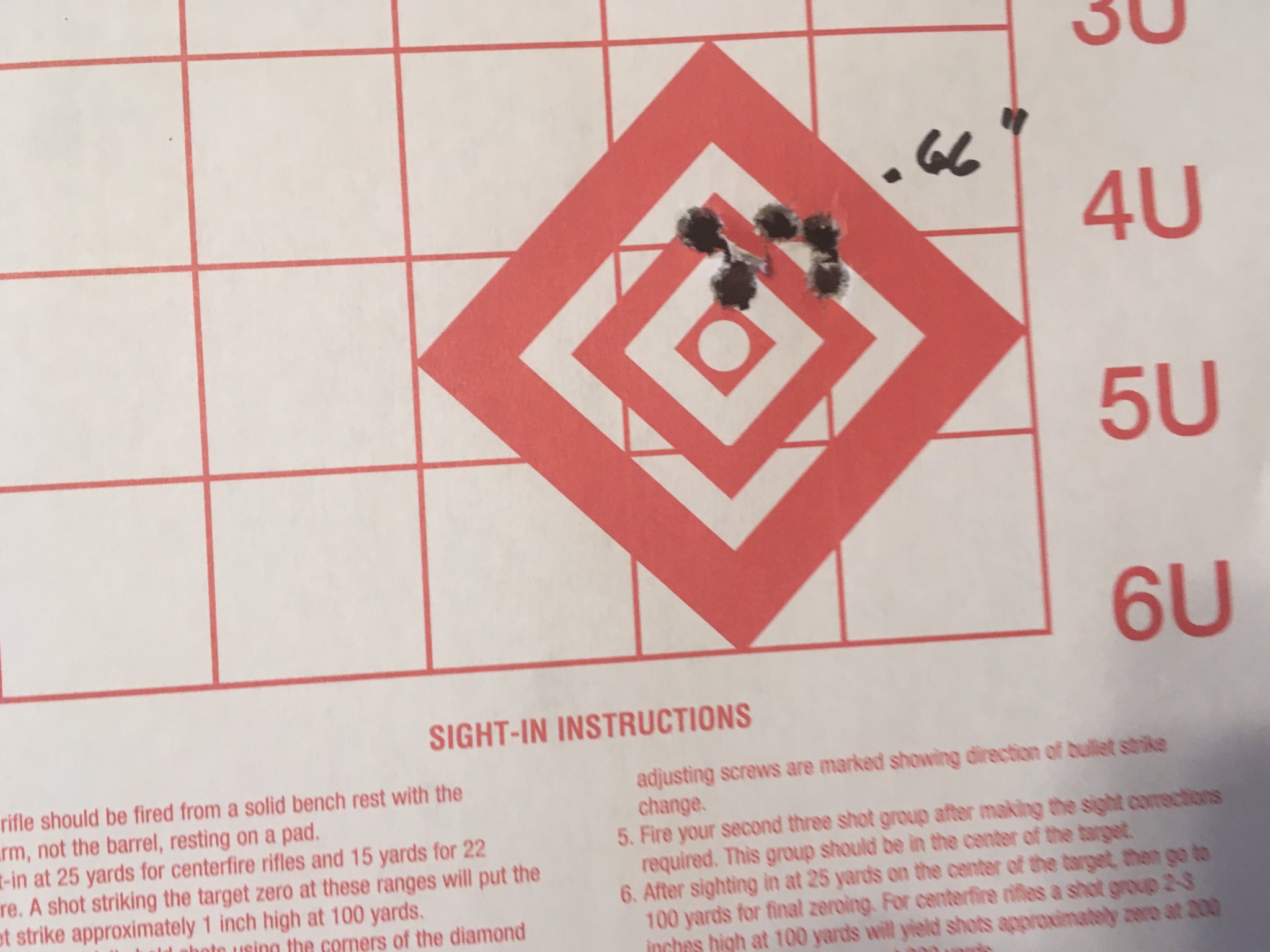

Mr. Wolf, Rio here, I finally made it out to the range yesterday on a cold, gray day. The temperature at noon was 32 degrees, light wind with several inches of snow still on the ground. Since it was so chilly, I decided not to test ammunition, but rather zero the rifle and see what kind of groups I could shoot with the modestly priced Aguila Super Extra 38 grain round, 1285 fps. It's clear that I need to spend much more time at the range with my MTR, but I believe it is capable shooting very, very accurately. For the first shoots, I'll take it. Attached are several photos I thought I would send along. Best, Rio

Rio,
good shooting with the Aguila, near MOA with the .53” If this is initial break in, recommend shooting 500-600 rounds of the cheapest 22lr you can get. when shooting higher quality stuff, i lumped ammo From the manufacurers together for testing (Ie shoot, center x and SK together, eley product together etc.)
It may be my imagination or me getting used to the rifle, but my groups settled down after shooting a few boxes of the same manufactured ammo.
