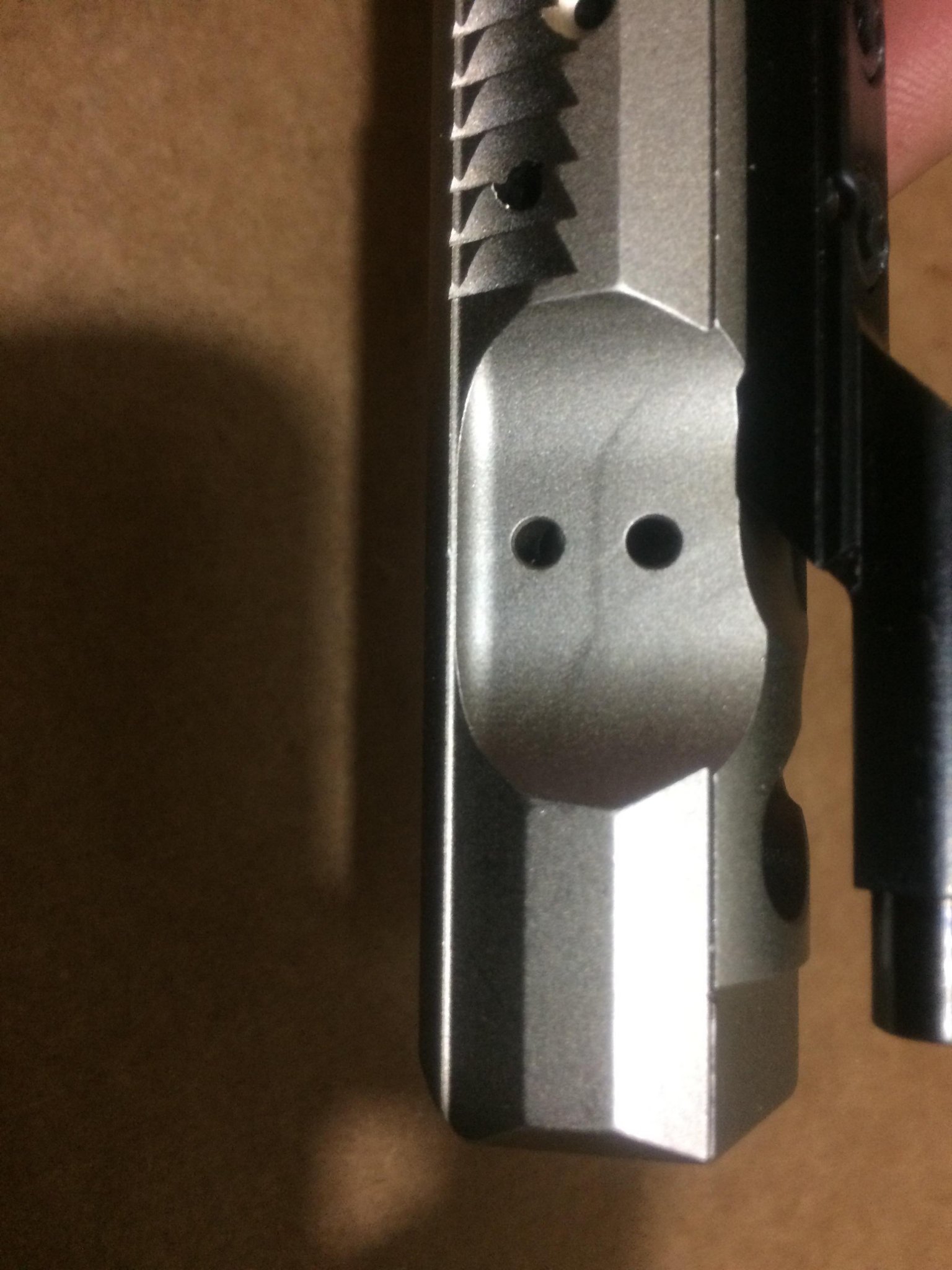

Hi y'all,
I need your opinion on a dark line on a new NiB bcg that arrive today. When I was inspecting the bcg, I notice the dark line between the 2 holes in carrier. When I tried to feel if there's a gap / crack in the dark line using my nails and don't feel any indication separation.
Should I be concerned on the dark line and contact the dealer or should be good to go.
Thanks in advance,
I would phone / e-mail the manufacturer and express your concerns.
It might be fine and simply cosmetic ... but I am not positive.
Send them the photo as well.
Thank you for your input/opinion. I emailed the manufacturer regarding my concern and ask for replacement if possible. I'll keep you posted if i hear from the them.
Got an email back from the sales and they said that the dark line is a tooling mark which is the reason that the bcg was sold with a discount ($76 shipped).
Thanks gain, this gives me a peace of mind on the bcg.
I agree with their claim. Part of my professional career is testing and inspecting metal parts for failures, so crack detection is a big part of that. Based on your picture - that is definitely not a crack, and the pattern of the line indicates a tooling mark. Nothing to worry about there, shoot it and be happy.
