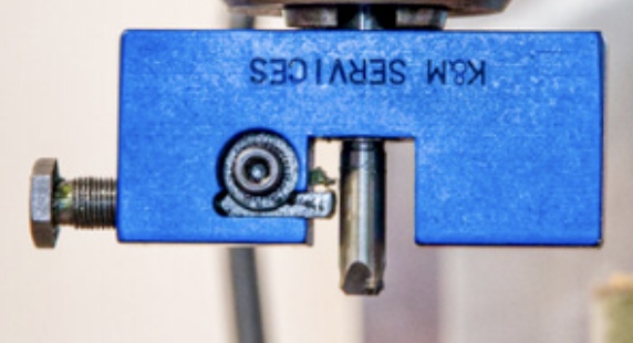

The K&M carbide neck turning tool plus mandrel also helps: It has a carbide cutter on the tip of the mandrel and a carbide blade on the outside cutting the neck to a smaller diameter. You turn the outside of the neck, and cut the donut on the inside, all at the same time. Works well enough, but a small portion of the donut remains.

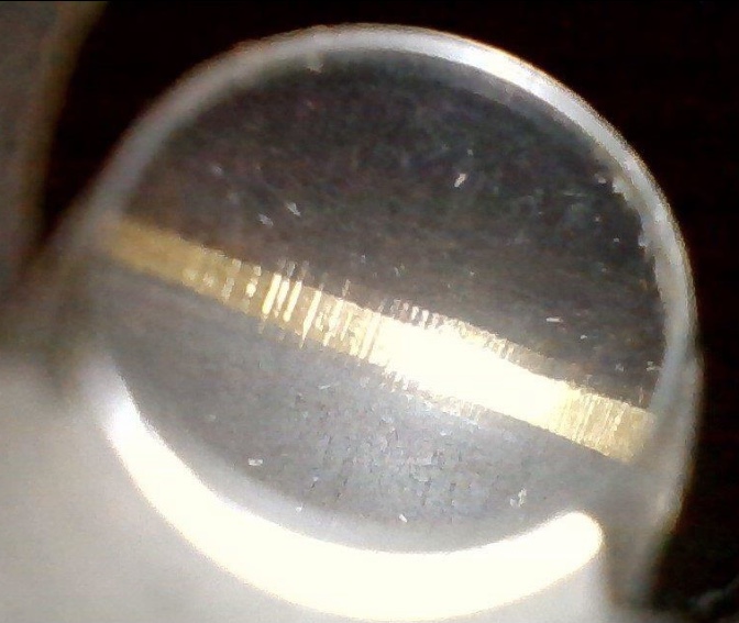

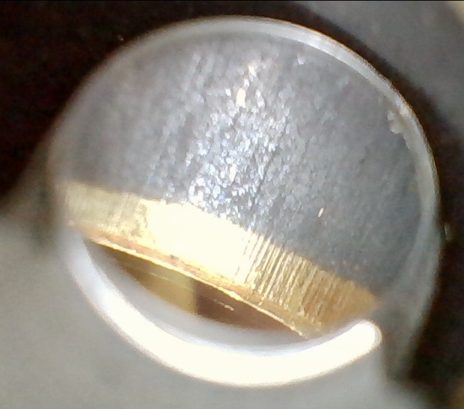

Some Teslong pictures from the inside of a fired case (no case prep other than corn cob tumbling) - after inside neck reaming:
Most of the cut occurs close to the top of the neck:
You can see the bevel at the edge of the neck where the VLD chamfer tool cut at an angle.
Any ideas why the neck area is smaller?

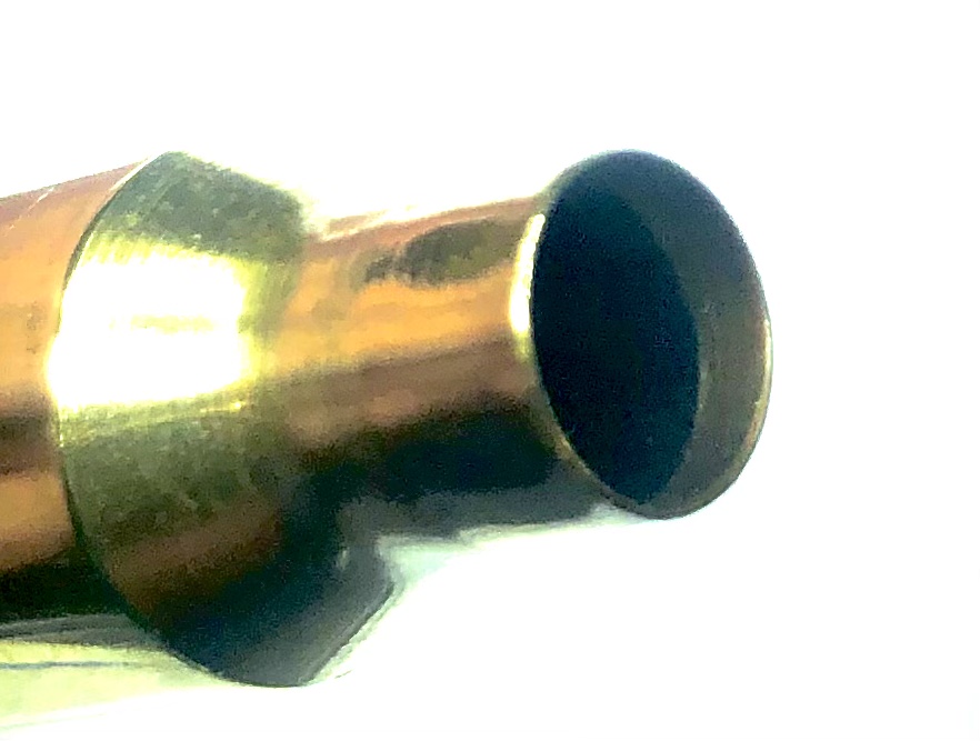

The picture below shows a bright ring mark at the neck shoulder junction, where the cutter encountered a significant donut. The smaller pin gauge also got stuck there:
After inside neck reaming, the pin gauge goes through easily.

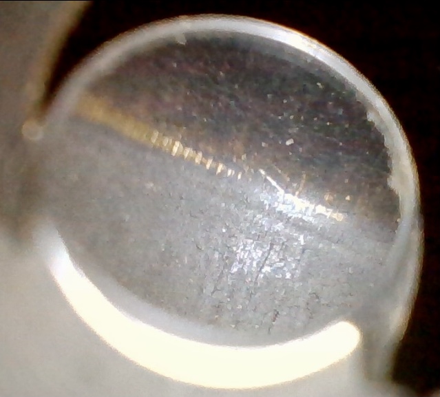

Below is a partial donut (different case) after cutting most of it out:
Pin gauge did not pick up this very minor donut. Note the pins are 0.5 thou apart in OD, so the measurement technique has limited resolution.
Note that the cut does not go right around the neck/shoulder junction, in this case it seems one side of the donut was thicker than the other side.
Some cases had thicker donuts, some were partial, some had none. [Probably a good recipe for inconsistent neck tension, if the bullet is touching the donut.]
Also note the “negative donut” (what looks like a hollow groove) just ahead of the cut mark. This was intentionally created during neck turning (K&M tool), by cutting into the shoulder. Clearly it did not help for more than 2-3 reloads. The new donut forms just behind the groove. [The Teslong bore scope gives something like 20x magnification, so don’t be alarmed by the depth of the groove.]

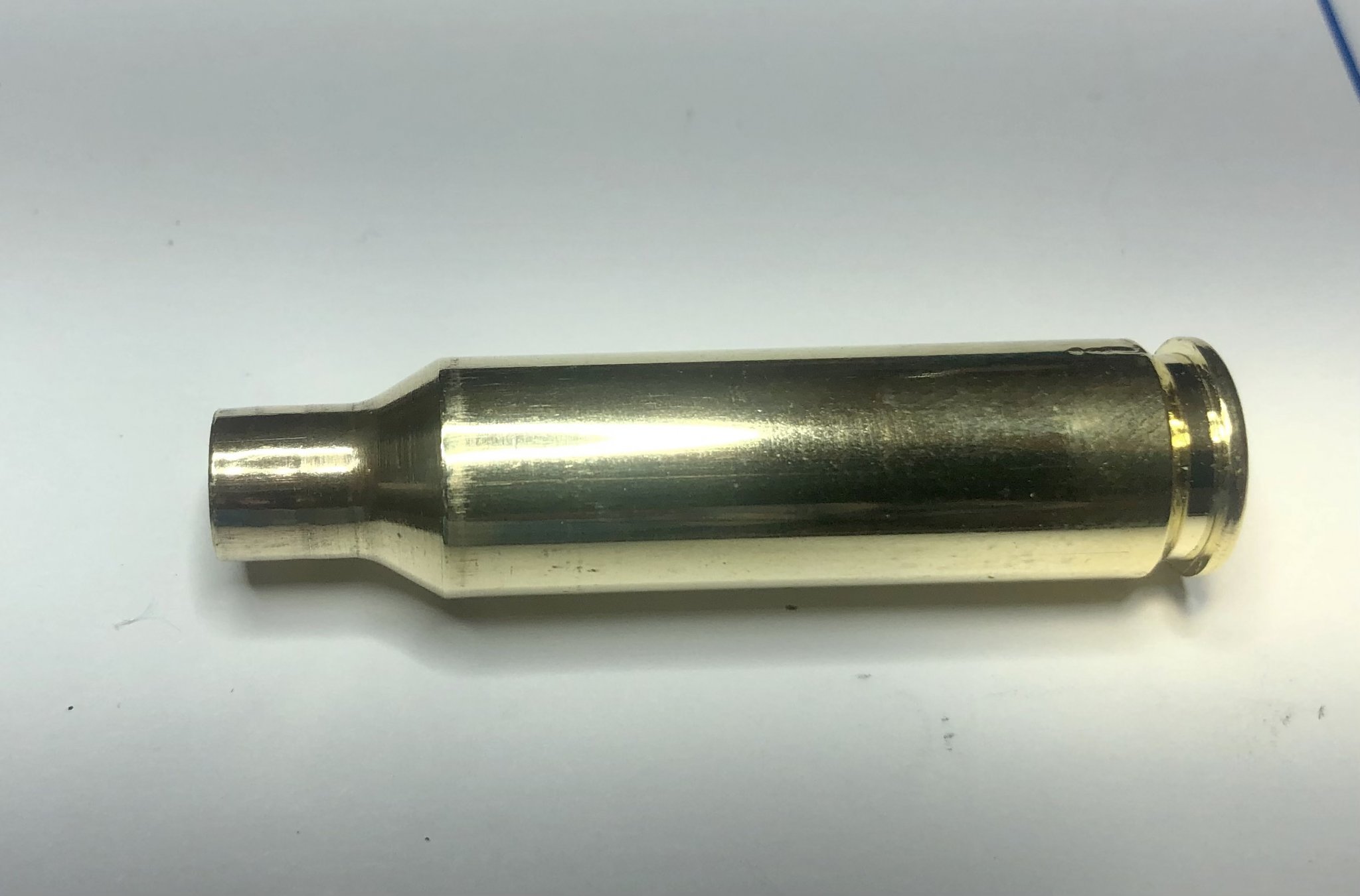

One trick is not to size all the way down to the neck shoulder junction, using bushing dies and then opening up the neck slightly with a mandrel die, e. g. the Redding Type S or the Wilson arbor press die.

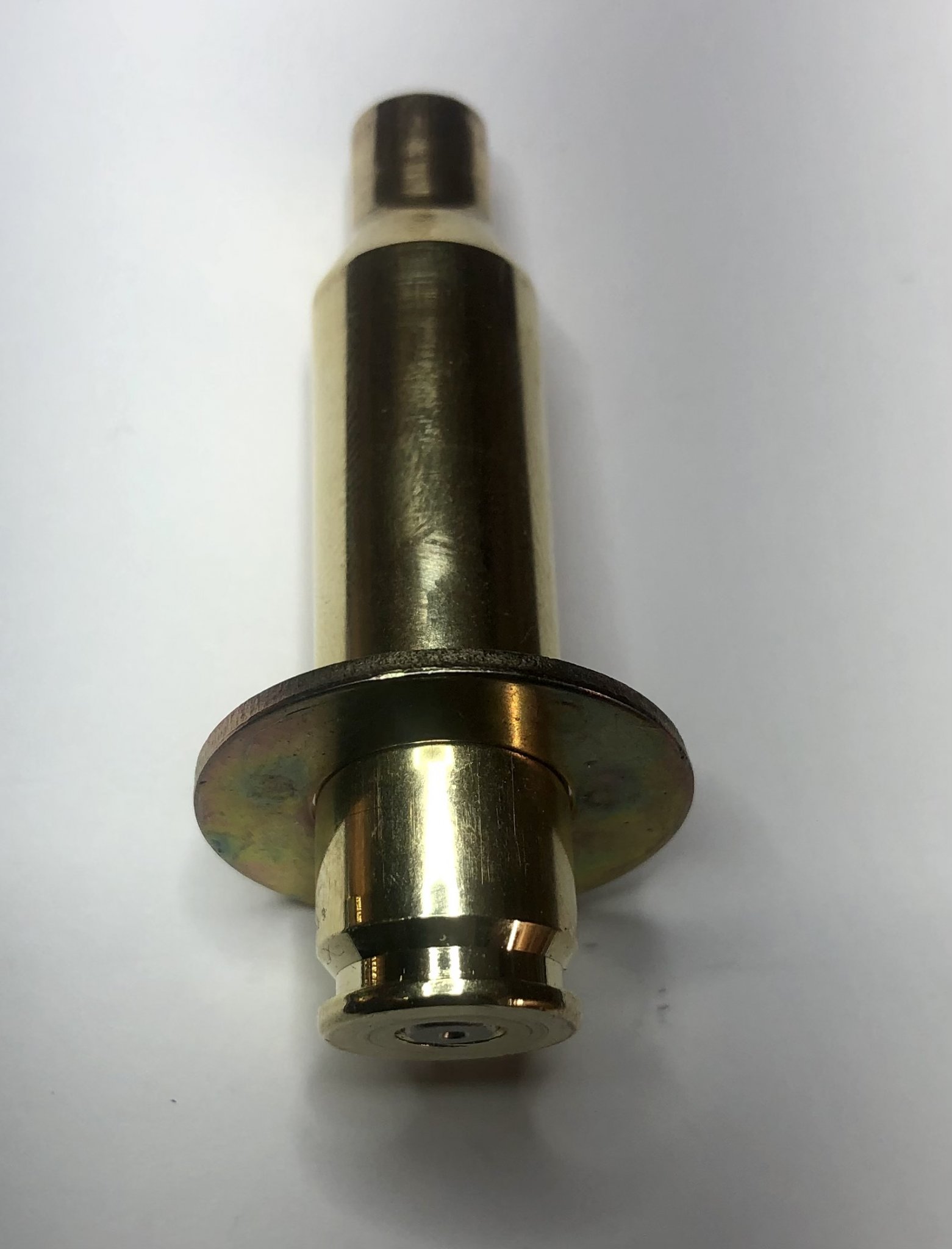

Another idea that i learned from a hide member is putting this thin washer in place when you use a Lee neck sizer plus small base die to avoid sizing the entire neck, to ensure the donut is not pressing against the bullet when seated deep:
Both approaches mean you have two sizing steps, instead of one. That will slow you down a bit.
General idea being that if the bullet is not touching the donut, then the donut cannot do you any harm.

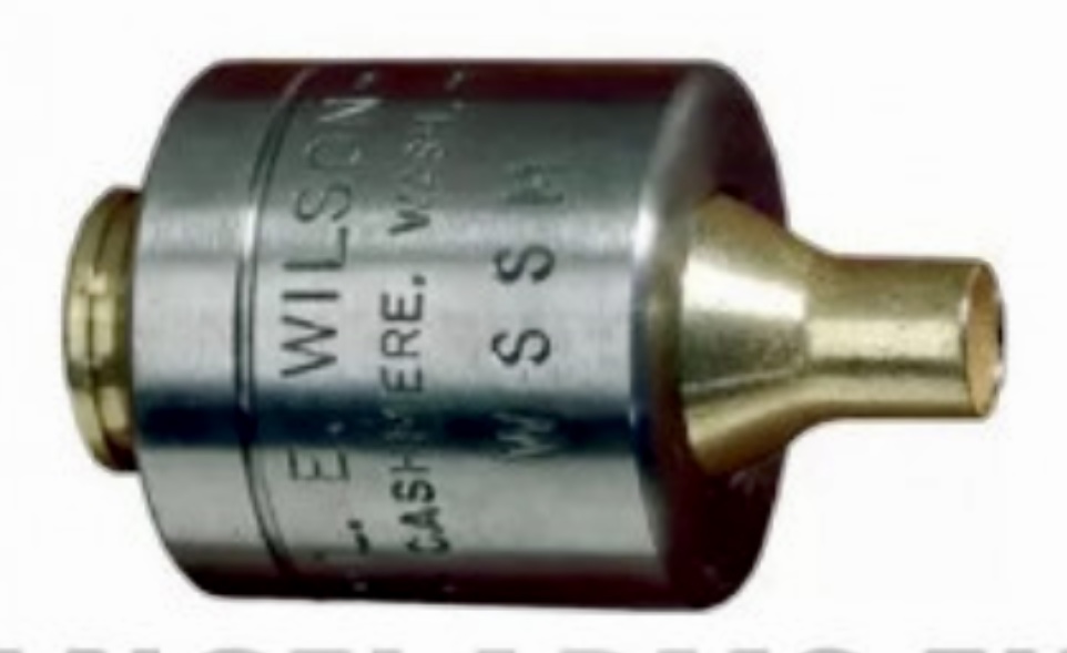

The LE Wilson inside reamer works fairly well too on fired cases, if the brass is first neck turned. It supposedly self-centers in the case, so concentricity is not really guaranteed. Apparently in order to reduce costs, their shell holders are not drilled perfectly concentric with the outside profile of the cylindrical case holder, but the cutter has some slop in the mini lathe, allowing it a small amount of float, so it can mostly self-align with the inside of the case neck. Workable but not perfect.

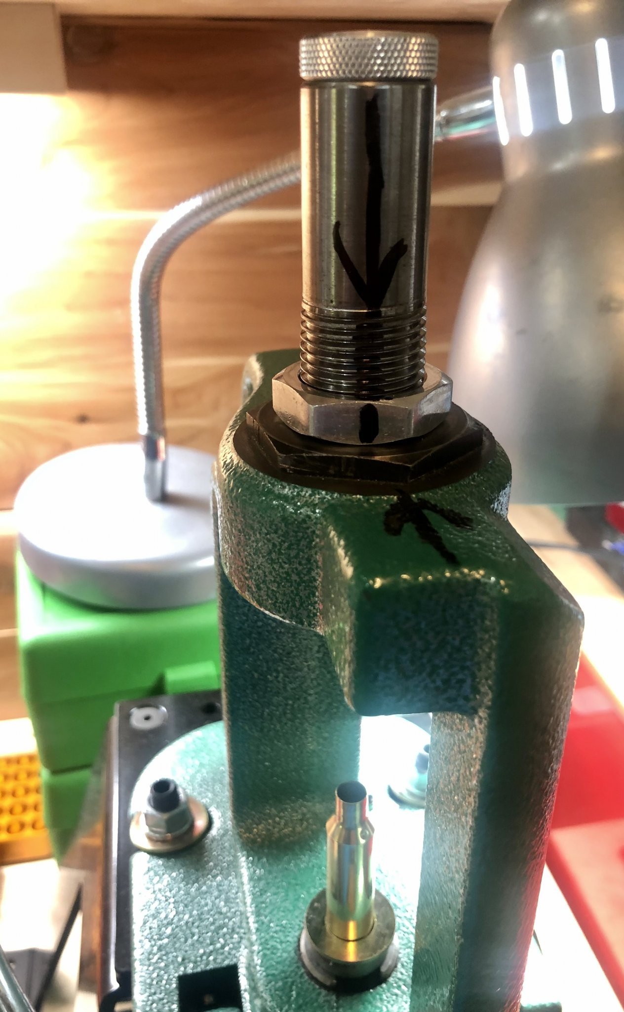

It’s the magic midget inside the collet die. He make donuts disappear.
I like your sense of humor sir! 😁 You are a very funny dude. No sarcasm intended!!
I guess you are skeptical if this combo will work? I can see how the Lee neck sizer will “smudge” the sharp edge of the donut and make it less pronounced.
And a small base die should cause less case stretch. So i am willing to suspend judgement and try it…. But i expect it will delay the donut problem, and perhaps not completely remove it.
Have you tried it? Any other approaches that have worked for you?
I’m not skeptical at all as I have been an early adopter and promoter of the Body Die / Lee collet neck die combination. I haven’t seen donuts since.
Lemme tell you guys a story:
I once got some brand new Lapua 308 brass. I loaded up some test rounds right out of the box and shot most of them at the range. The rest I brought home and pulled apart. Now all the neck tension was gone so I neck sized them in the LCND. I noticed something funny about the neck after I sized it. It was longer and not uniform anymore. Apparently the brass was soft enough to extrude under the pressure of the collet against the mandrel. It wasn’t a lil bit. It was 20-30 thou. That die generated enough pressure to squirt brass out the collet.
So donuts either don’t have a chance to form or are squished out or both. It’s a good system. Too bad they don’t make this die for all calibers or maybe a universal neck die system of some sort.
