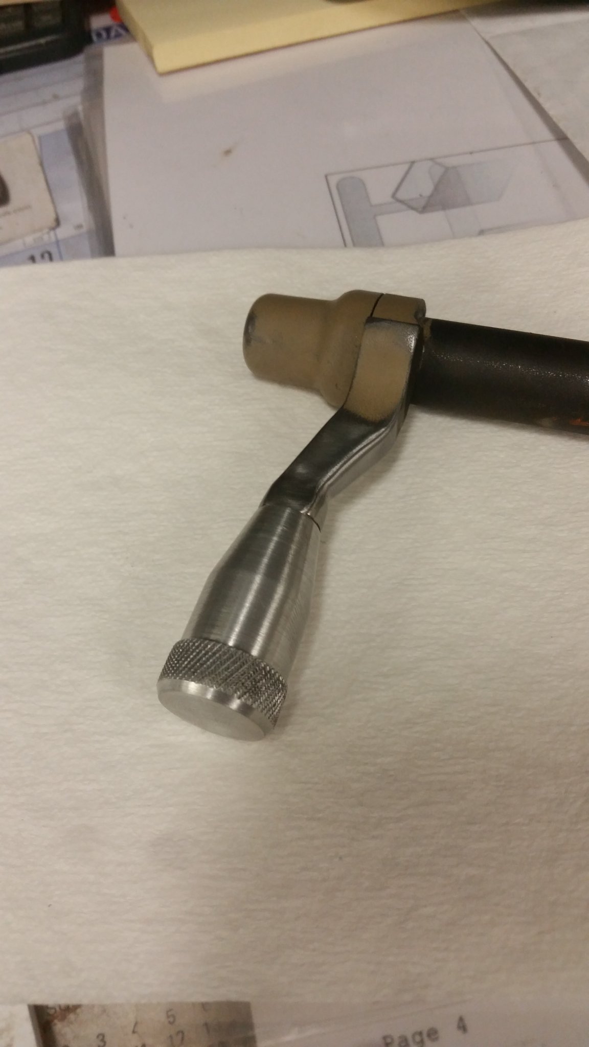

Decided to mod my 700 bolt knob
Ghillieman37
Jan 30, 2018
116
23
Central PA

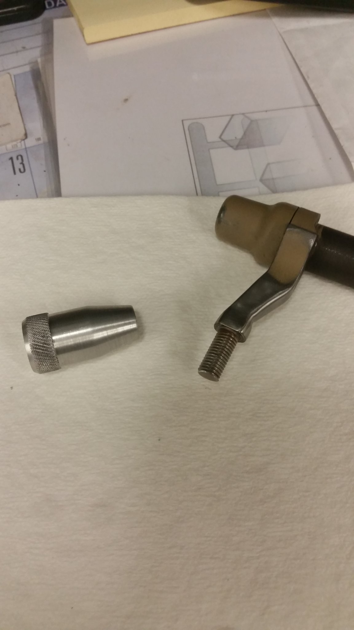

I don't have the fixture for turning the bolt handle on the lathe...so I cut off the existing knob and TIG welded a threaded stud to my handle, blended and polished it.
I then turned a 1.5" long knob on the lathe and knurled it
