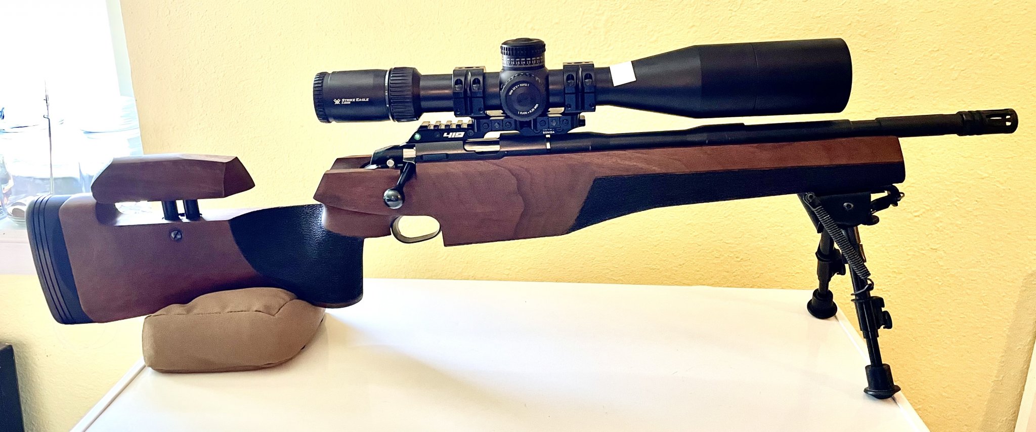

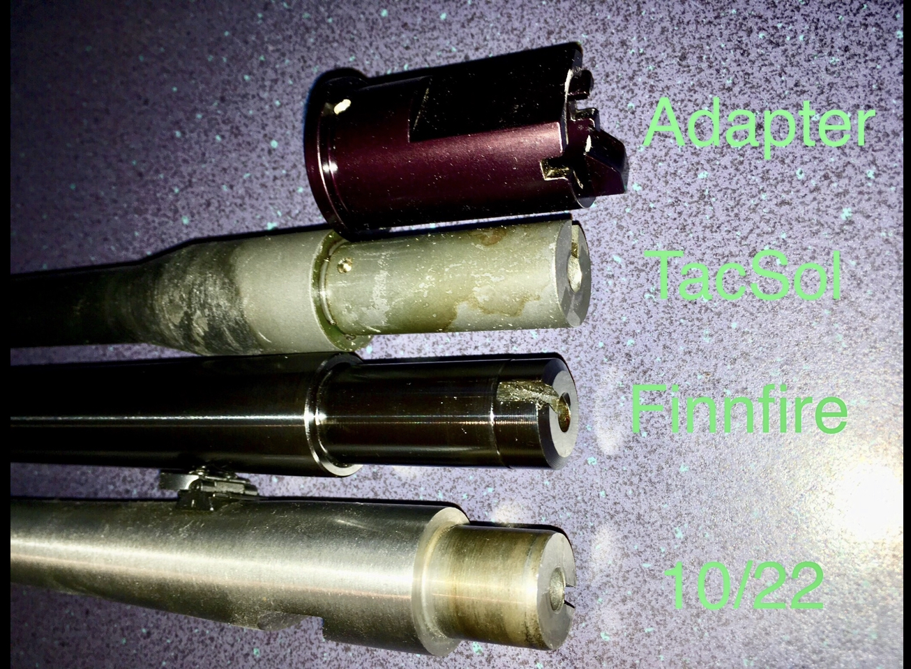

Tested this past weekend. It’s the barrel off my Tac-Sol AR-22 conversion that I hadn’t been impressed with the accuracy, but didn’t know how much was me, the crappy AR trigger, or floppy AR stock. Set to minimal headspace, the Finnfire’s adjustable stock and 2oz Jewell trigger let me really see what was what…
I’ve seen better tomatoe stakes!
This 16” barrel will be scrapped for other projects. Back to testing a Lilja, Anschutz, and extra factory Sako barrel for pure accuracy for the AR-22.

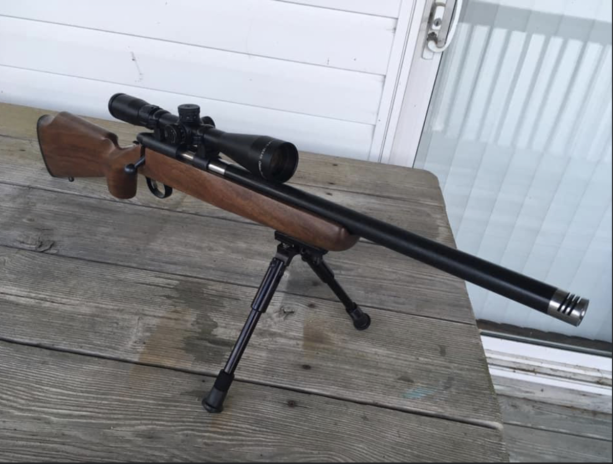

This required a thin shim, then slid in and tightened the Finnfire action.
Going the other direction will require the lathe, so I’m wanting to make sure I’ll be satisfied first.

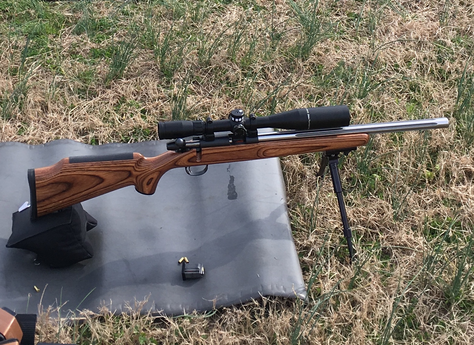

A friend turned these aftermarket 10/22 barrels to fit my Remington 504 bolt action. Since the barrel already has a Bentz chamber, I didn’t have to touch that, just lock it in.
