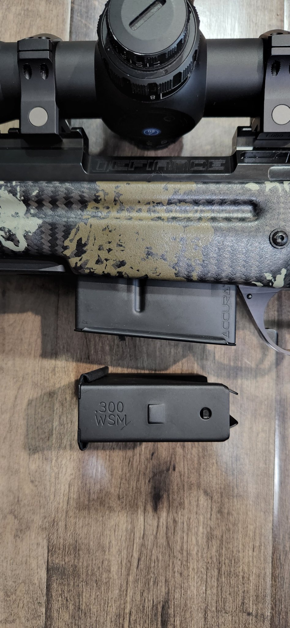

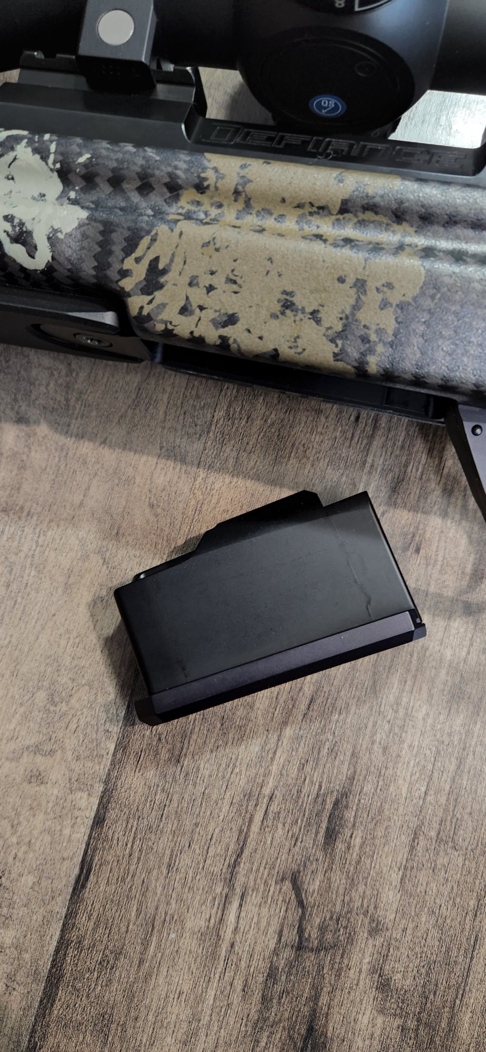

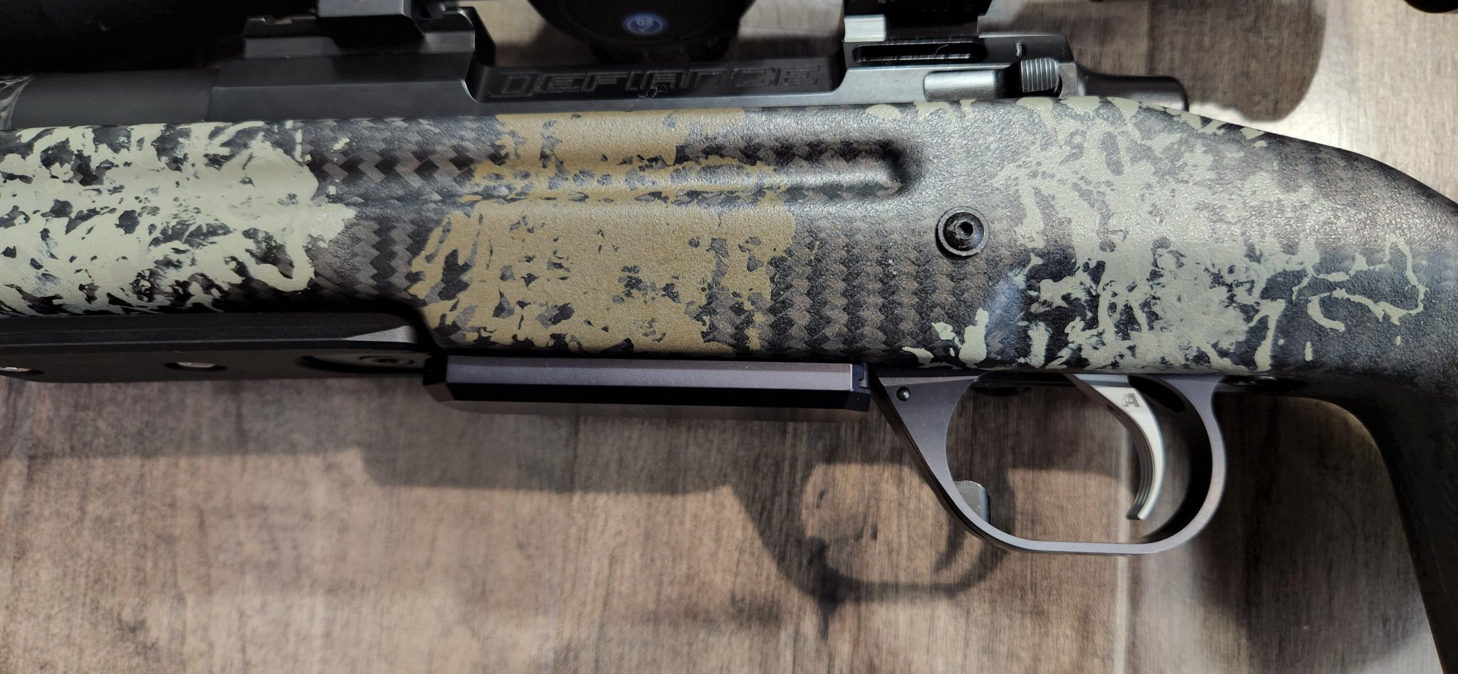

Here is a 6.5PRC in a Manners LRH, MCS-M5 mini chassis, with a Hawkins Hunter bottom. COAL on my rounds are 2.970 and work and feed perfect in my Antix action.
