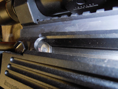

Went out shooting today with buddies in a clear cut. 700 meters to air tanks with my Savage 110BA.
Had a batch of bullets I meant to pull from my load box, but had forgotten. My buddy loaded the magazine for me, including one of these in the batch.
The recipe that was supposed to be loaded was Berger OTM 300gr, 3.8830 COL, 90.4 grains vv N570. However, the next recipe in the list has 93.9grains N570, which I had loaded these to. Fµcking dumbass, and damned dyslexia. The first one I shot got stuck a few weeks ago. The one today did also.
Got the bolt back and the primer was still attached to the bolt face. Still have to get the stuck case out, but my dowel is shot.

The dumbass steps here are multiple.
1) misread recipes in my notes
2) when the first case in the batch got stuck, I chalked it up to the Stuckage factor and did not examine the load recipe. I did examine the stuck case for pressure signs but it did not appear to be over-presured.
3) when loading my field box I did not pull the hot rounds.
4) I let my buddy load the rounds aware that sticky ones were there.
Interestingly, we were seeing POI = POA-2". The hot round seemed to be ~7" high ( estimate). That's what 10grs more will get ya at 700m.
Yes, I'm grateful nothing catastrophic happened. Time to adjust my procedures.
