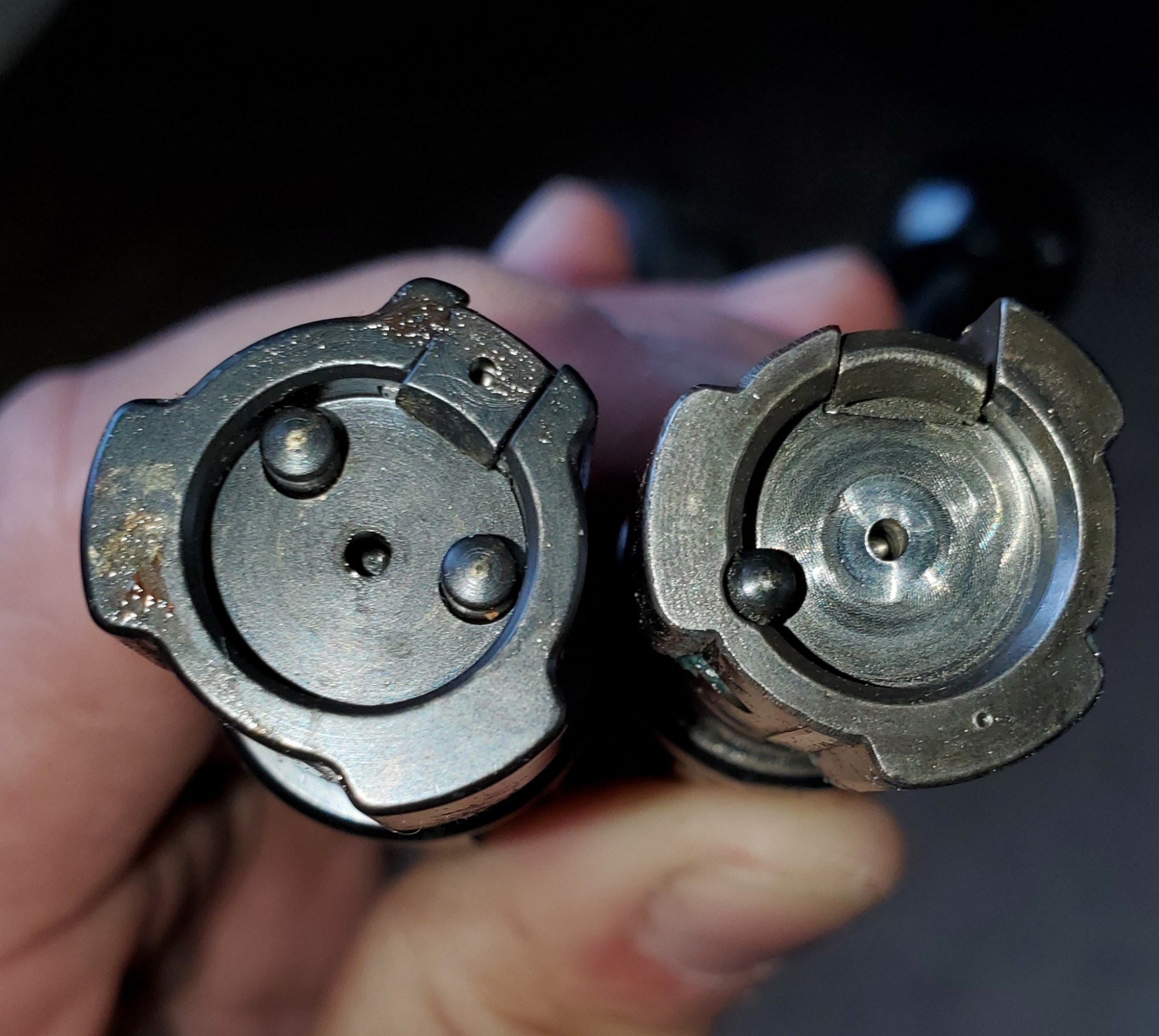

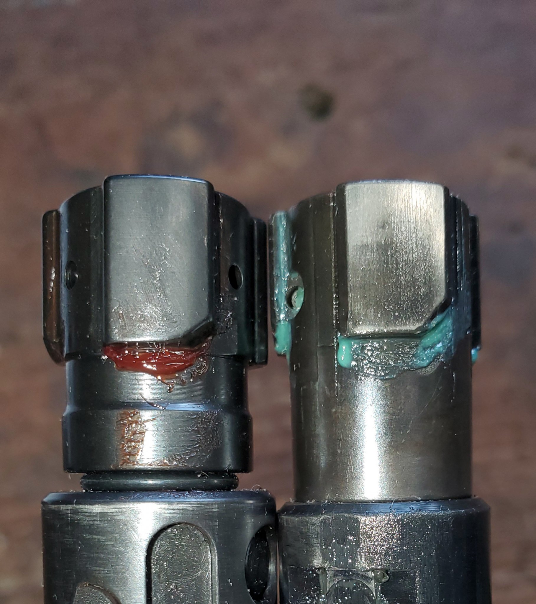

deadline bolt vs ai ae mk2 bolt, this pic shows lug with/near extractor on both boltsI
deadline vs aiae mk2, full lug.
Deadline vs aiae mk2, bolt face. Gives a good idea on lug height
If you make bolt lugs wider, than receiver lugs must be smaller to allow bolt head to withdraw. Also applies to the opposite approach. With a 3 lug bolt, there is only so much of bolt head perimeter that can be utilized. The lugs can be taller, but that requires a bigger bolt body diameter or raceways cut in receiver. Only other way to gain more surface lug area is to go to a 6 lug 60°, a la at/ax or badger 2013.

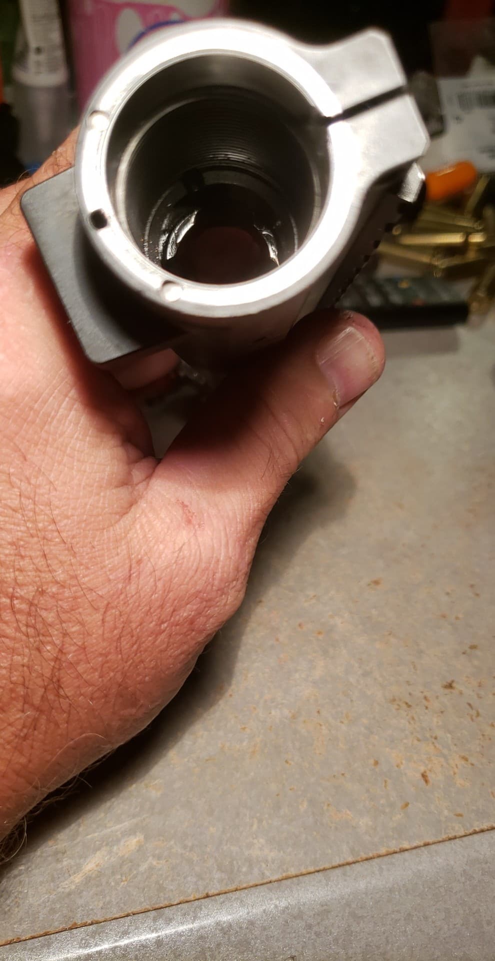

the first 1 was destroyed fireforming brass for the 7 sherman shortmag. ultimatum did replace the first action and the bolt head but they did charge me for a new receiver at a discounted price and after destroying the second action they refunded the money for the replacement receiver and told me about the other people who were also having the same issue. i'm now currently waiting for the second replacement action. the second action was destroyed during load work up which never got into pressure because i felt the action starting to go bad when i was chambering and extracting brass. all the primers during the load work up were round and i was at speeds well below what others were getting with the same powder/bullet/brass combo. i only had this picture leftover from what i sent to ultimatum. surprisingly on the first action only the receiver was damaged, the bolt head was fine but on the second receiver the bolt head and action were both trashed

Wow I see the action lugs that seem sheered? But is that recoil lug cracked in 2?
Also what did ultimatum say caused these issues?
I'm assuming whoever did the heat treatment botched it real bad which could have bad consequences for people by injuring someone by blowing up the action.

That looks like its galled very badly and peening. Im gonna say thats metallurgical issue. What are specifics of the 7 sherman, im not too familiarwith the shermans? Were you running any bolt grease?

Thats a split barrel nut designed to make barrel swaps easy, not a lug
Yeah that's a west Texas ordinance switchlug

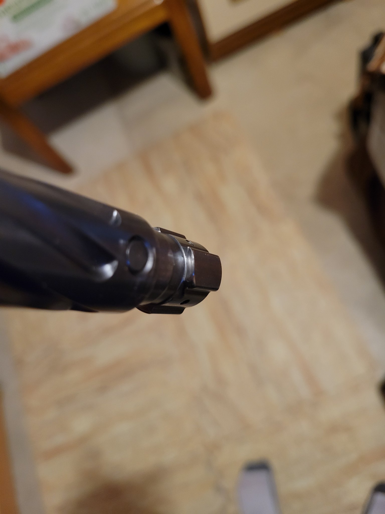

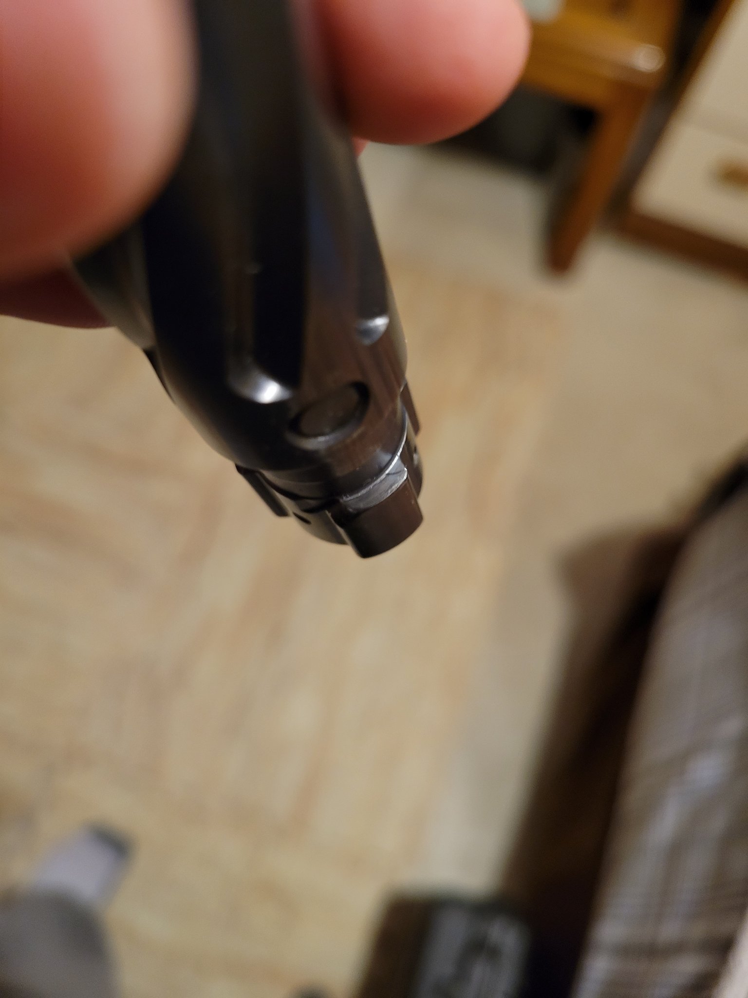

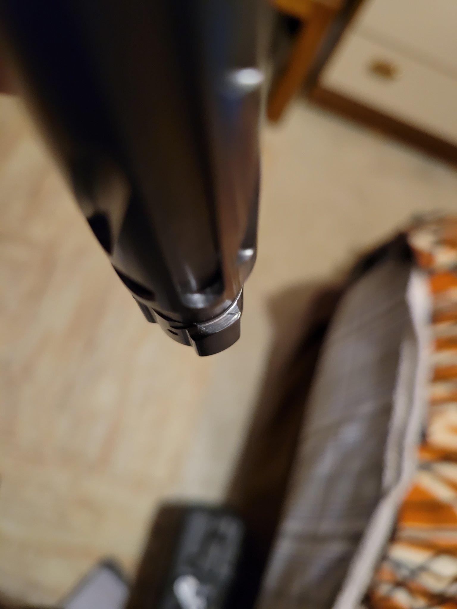

I just went through the same thing with my 6.5 saum. Supposed to be sending me a new one (6-8 week wait est). Noticed the marks on the bolt after 283 rounds, looks like I noticed it sooner than you did. What sn do you have ? Maybe it was an early run of the gen 1.
no idea i sent the first 1 back 2 years ago and the second 1 went back 1 year ago. supposedly my third has shipped or is being shipped
