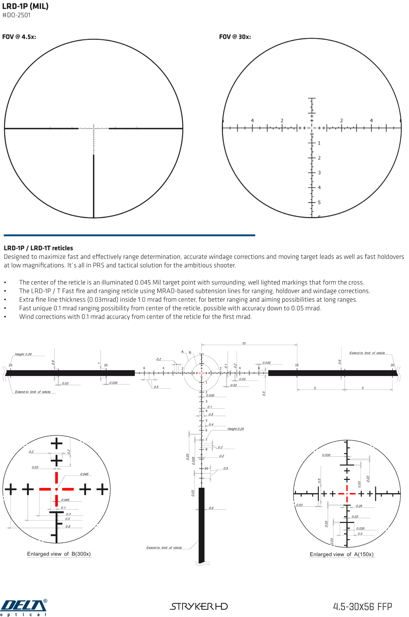

Hmm .. now that I look at that LRD-1T again, I can't work out what those initial wind holds/subtensions are meant to be ... perhaps it's just the New Year's drinks? :)
Anyone know a subtension guide / diagram of a marked-up reticle for this one? It doesn't appear to be on the main retailers' sites, or on SageRatSafari's Master List.
I also find this reticle to be less intuitive. It takes some getting used to.
The LRD-1T is the same as this but with the added tree.
You can use different parts of the crosses to make .1/.2 mil holds but ultimately it's just a PITA. Perhaps if you view it as just having .5mil holds for the first mil then .2mil holds for the next 2, it makes more sense.

Dont know why I did not take the picture with the P reticle instead of the T. But as you state, the main portion of the reticle is the same.
It annoys me that there are both .1 and .2 jumps and worst of all is that the vertical stadia is different than the other ones.

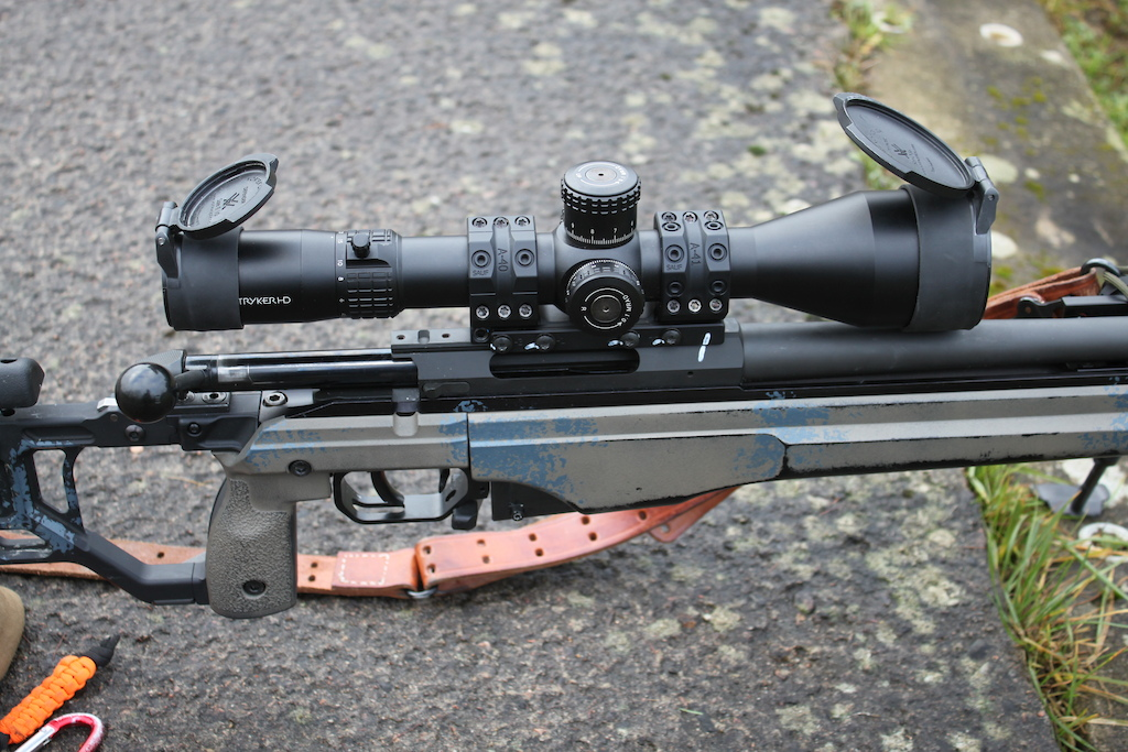

Here's mine, newly mounted in a 6mil Spuhr mount, I love the look of the Spuhr but cant help but think it's completely overkill for 99% of what I'll do with the rifle.
I must agree with patriot07 in that the reticle is excellent other than the 1st Mil from centre, the centre cross/dot is well sized as is the rest of the reticle. I like the crosses at each Mil in the tree, much easier to see at lower magnification than dots.
The glass and turrets really are great, I still maintain the only complaints are the centre portion of the reticle and the FOV could be better.
Reactions: VargmatII
What rifle is that?
The receiver looks like a Tikka but the bolt release is in the wrong place.
Sako TRG 22.
And I agree that the Spuhr ISMS is overkill in some ways, but I like fit and forget type items, it falls into that category. And it looks super clean with the direct mount on the TRG.
