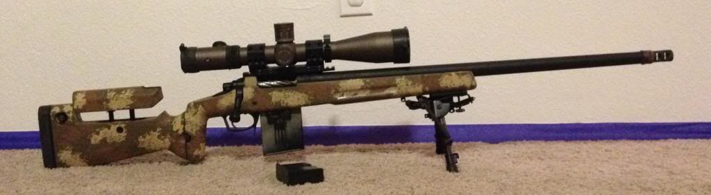

    Thanks everyone for the help/advice, but it turns out that my action fit perfectly in this mini-chassis. I thought the Defiance Rebel had a longer tenon than a Remington. Maybe it's a difference between the McRees and a Manners? There was definitely Devcon added to fill the void behind the recoil lug in my McRees I had, but it wasn't necessary in this Manners.
    I did a mockup yesterday with my daughter's play-doh to see how much Devcon I'd need and it smooshed it all out and there was none behind the lug. All I had to do with the stock was open the barrel channel and cut back the area around the ejection port as it was shorter than my action's ejection port. It turned out nice and it was satisfying doing the work myself. I used a 1" dowel with a piece of 120 grit sandpaper and a 1 3/8" pipe with the same. I still need to buy a torx bit large enough for the action screws so I can torque it down proper, but here she is.
