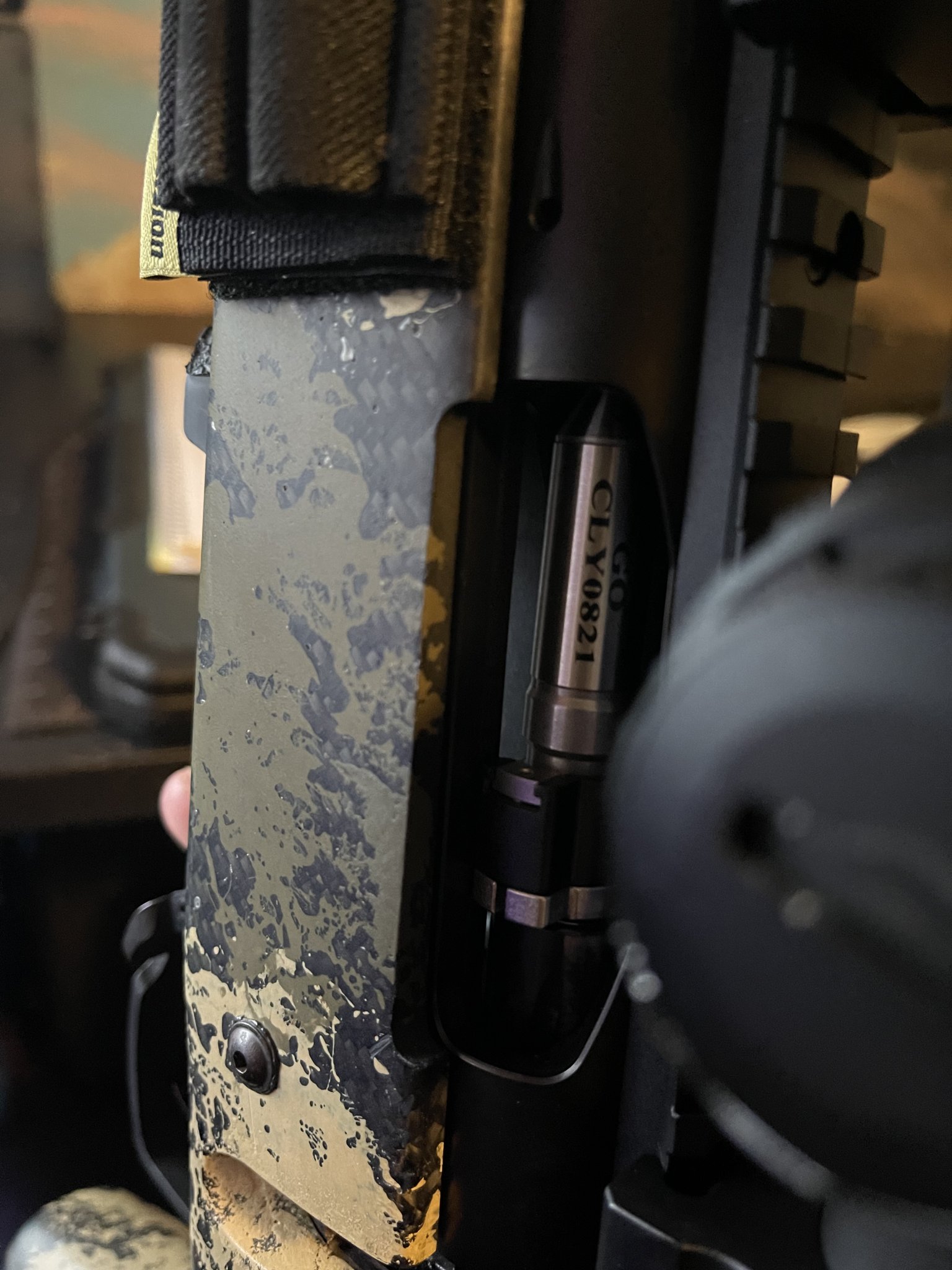

Im just finishing up my first long range hunting rifle build and I was curious if it is pretty common to get these go/no go gauges out of spec?

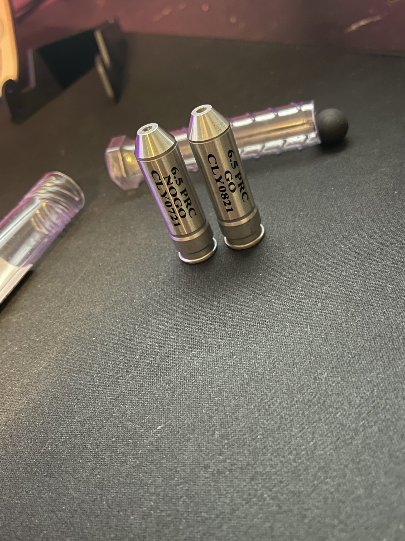

I have a TL3 action with a proof 6.5 PRC prefit. Barrel torqued to about 75ft lbs. The go gauge isn’t chambering and not only that it gets jammed up when trying to chamber. I’ve been very gentle with it but the bolt gets stuck too. I can chamber a live round with no issues nice and smooth!? Thoughts? I don’t have the right tool to measure them at the moment, maybe it’s time I order something. All I can say is these seem way off when trying to chamber.
Thanks for any help, had a hard time finding any info on this. Forgot to add they are Clymer gauges.

I’ve done it this way and it gets jammed up and locks up the bolt (best way I can describe it.) I have to pull the bolt back pretty hard to get the go gauge out. I still wonder am I overlooking something simple I am new to this and I did change the bolt from .308 to the magnum bolt, these are all left handed components too if that matters?
It’s almost like I received 2 no go gauges and one is marked incorrectly. What’s an affordable tool I can use to measure them accurately and compare? Why would the live round chamber and the go gauge wont?
I have not removed the firing pin or ejector, is that the problem? I have read about people removing the ejector, I didn’t have to on my .308 so I didn’t here..
Are you not having any issues with the No Go Gauge. Hard to believe you received a bad gauge, recheck the marking on it to be sure it is what you think it is though.

Negative, I put the gauge under the extractor just like I mentioned above.
It jams up with light pressure pretty bad.

I would say after double checking my savage 308 with its gauges, the prc go gauge definitely feels like a no go gauge with this thing but it’s also locking up with very light pressure.
But a normal hunting round chambers smooth as butter? So what’s the next step pull the barrel?

Thanks! I was looking on Forster I dont think they make one for the PRC unfortunatley! I did find one on Pacific Tool and Gauge. After chambering that no go gauge again im thinking I have a bad GO gauge it stops just shy of the bolt fully seating and binds up. The NO GO gauge is smooth and doesn't close but feels perfect.
Have you tried the NO Go gauge in it? If so, was the result identical or even worse than with the GO gauge?
Good call, I just did it again and it feels way better (doesn't bind) but doesn't close as it should.

If the NOGO gage lets you close the bolt only 3/4 of the way and a factory round fits just fine with no hard force or drag when closing the bolt all of the way, I would take it out and shoot it.
As for the GO gage that does not fit, I would compare it measurement wise to the NOGO gage and see what the diameters are. I bet the GO gage is wider by a few thousands. or its egged shaped. I would also send it back and ask to exchange it for another one that's correct.
What brand is the suspect go gauge?
Sorry I went back and saw they are Clymer. I ordered some from Pacific Tool and Gauge for 300PRC.
