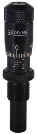

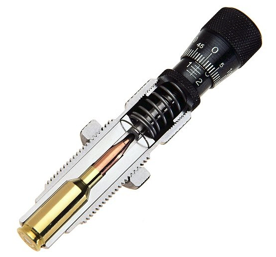

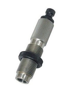

You dont really need the 3 die kit, just get the 2 die premium set, you dont need the extra neck die. The premium line is nice that it has the carbide ball and micrometer top. Basically the normal dies retrofitted with some more convenient features.
The sizer is a normal full traditional length sizer (40) with the carbide ball (38) added on, it would normally cost 80 bucks to make this die set yourself.
The seater with micrometer is juts a normal seater (40) with the micro top (40) added on, normally it would cost 80 to make this set up.
7085919
7085921
7085920
So to recreate the premium yourself would be 160 bucks, so the midway sale for 100 bucks is a good deal.

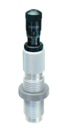

I prefer the competition seater with its sliding sleeve and more robust micrometer, but it cost as much as the 2 die kits by itself. Plus a sizer and a carbide ball would make this combo 160 bucks. So its a 60% markup to go this route, up to you to decide. You could also get the type s full length set with comp seater for 162 plus 20 for a bushing right now, this would allow you to limit over sizing the brass down which mitigates the usefulness of the carbide ball.
