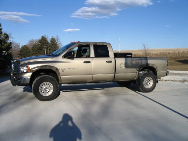

    Here's mine. 06 4x4 2500 Cummins Those are 33"s on 20" wheels. I have added a leveling kit from Hellbent Steel http://www.hellbentsteel.com/product/dodge/dodge-leveling-kits.html If your interested check them out. Waaaay cheaper than pro comp and the other big names. I tried 35"s and they would have tore the front fenders off if I would have turned with them on. Haven't tried a chip or programmer on this one, because I honestly don't drive it much. Got it new in 06 and have around 50k miles on it now.

    Here's mine:
