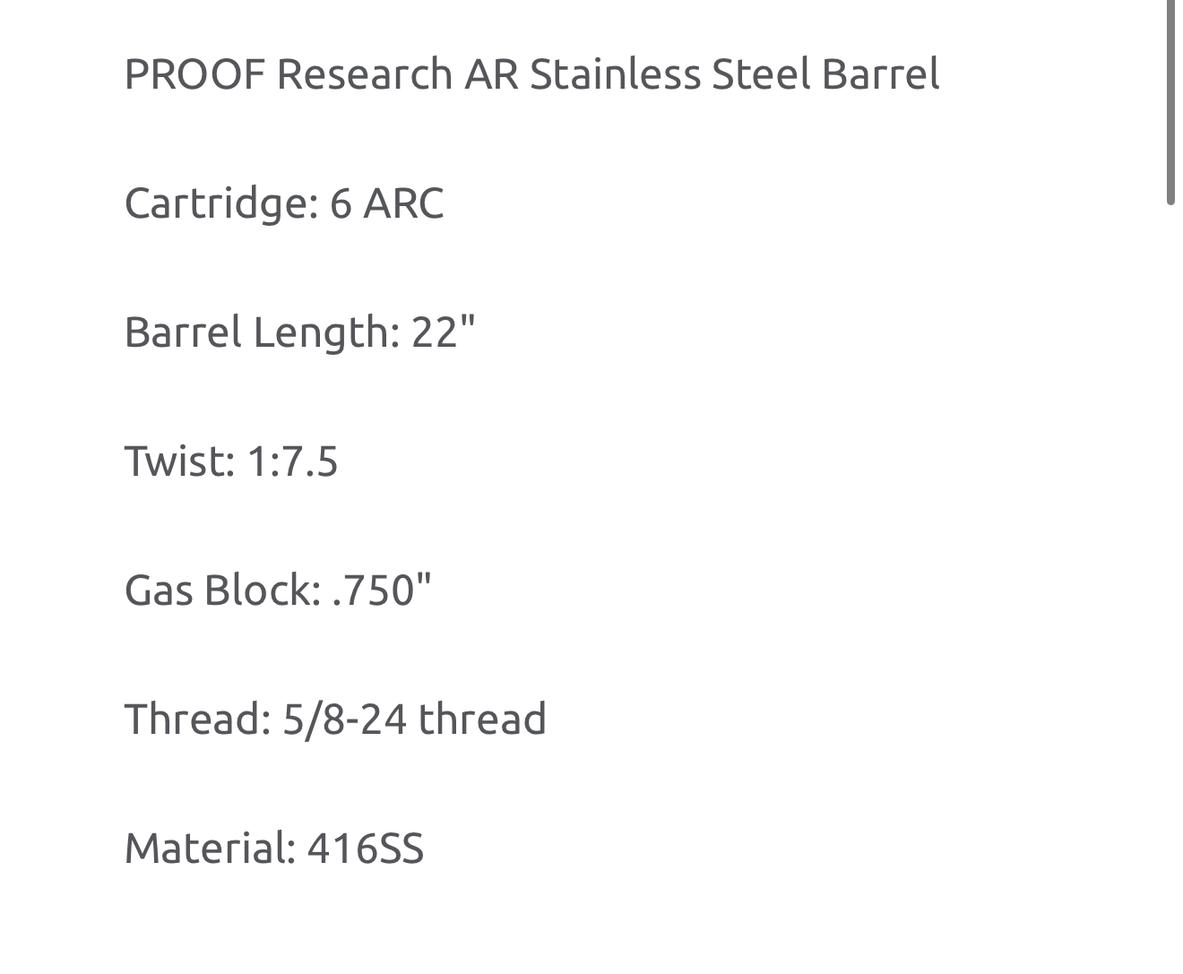

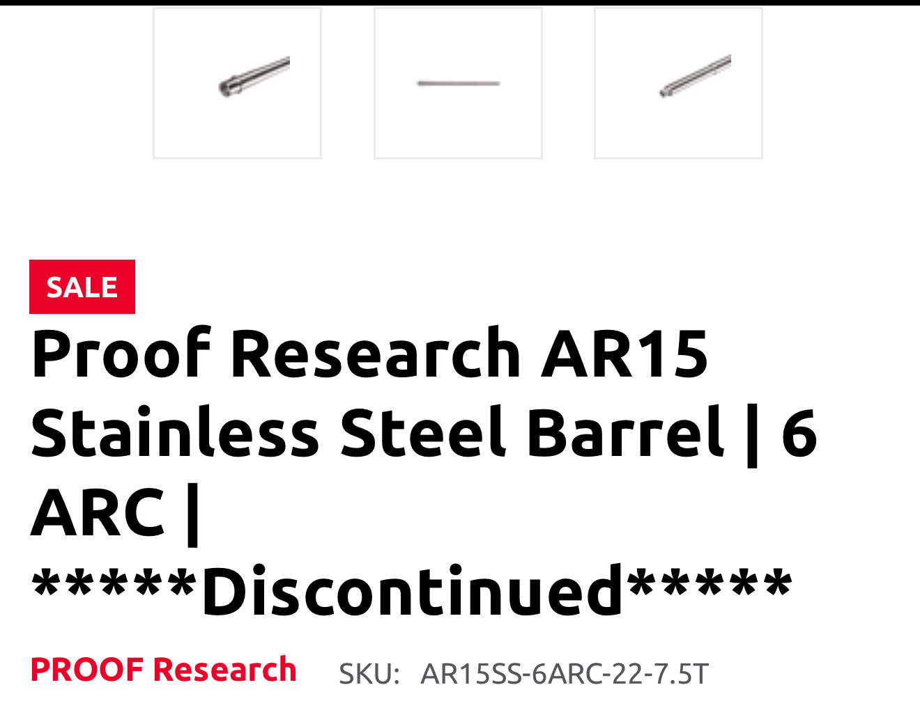

    Why would they discontinue this one :
    I see they make the same one still but with a 875 gas block
    22" is pretty long for what most people want out of a small-frame semi/precision/DMR style AR15; which is kind of what the 6 ARC is targeting.
    If you're prepared to lug around a 22" pipe you'd probably strongly consider larger cartridges. I'd imagine most buyers for this barrel ordered in 16", 18" or 20".
    Reactions: matt33
    Yea, I went from a 18” to a 14.5” and I don’t think I’d go longer than 16” from here on. Pretty happy with the performance and overall length of the 14.5” and see no need to change it up. That said, 18” is the sweet spot if you’re trying to maximize the cartridge while also keeping it from being too long.
    They still make a similar barrel. 22”. But with a 0.975 gas block. Not sure if other changes.
    This is for a gas gun match gun. Currently uses a 20” 556 with a 338 ultra can
    I'd rock the 20" if you're running it with a can in comps. That keeps the 0.750" gas journal you seek, and you won't miss those 2" in terms of performance.
    lol I bought the 22” with 0.750. Cause it was cheap. Just wondering if there was a legit reason they discontinued it
    Reactions: Tex68w
    I have no clue why they jumped journal size on those. I had a local source for cheap Proof Carbon prefits for a while, but that source dried up.

    I like the 22" barreled idea, but with only a .750 gas block I can see where the market segment would be limited. I bet sales were just much slower than expected. Probably just a few dedicated coyote hunters.
    It is something of a backwards Goldilocks...too light for sustained target use, too long for guys who want to run suppressed in tight spaces etc...
    Weight seems very close to the .875
    Does .125 make that much difference ?
    Not a ton. For those uber-small diameter handguards though, that .125 can very well make a difference between them flexing under recoil and making contact, or not, and don't ask me how I learned that one the hard way after chasing accuracy issues for hundreds of rounds and two barrels. :rolleyes:
    That .125 is probably the equivalent of running a magnum sporter contour on a target gun instead of a medium palma.
    Plus for some guys, those few ounces of weight savings are what they seek...and that contradicts a 22" barrel...which is why I think it probably wasn't popular enough to keep producing.
    I could be way off though.

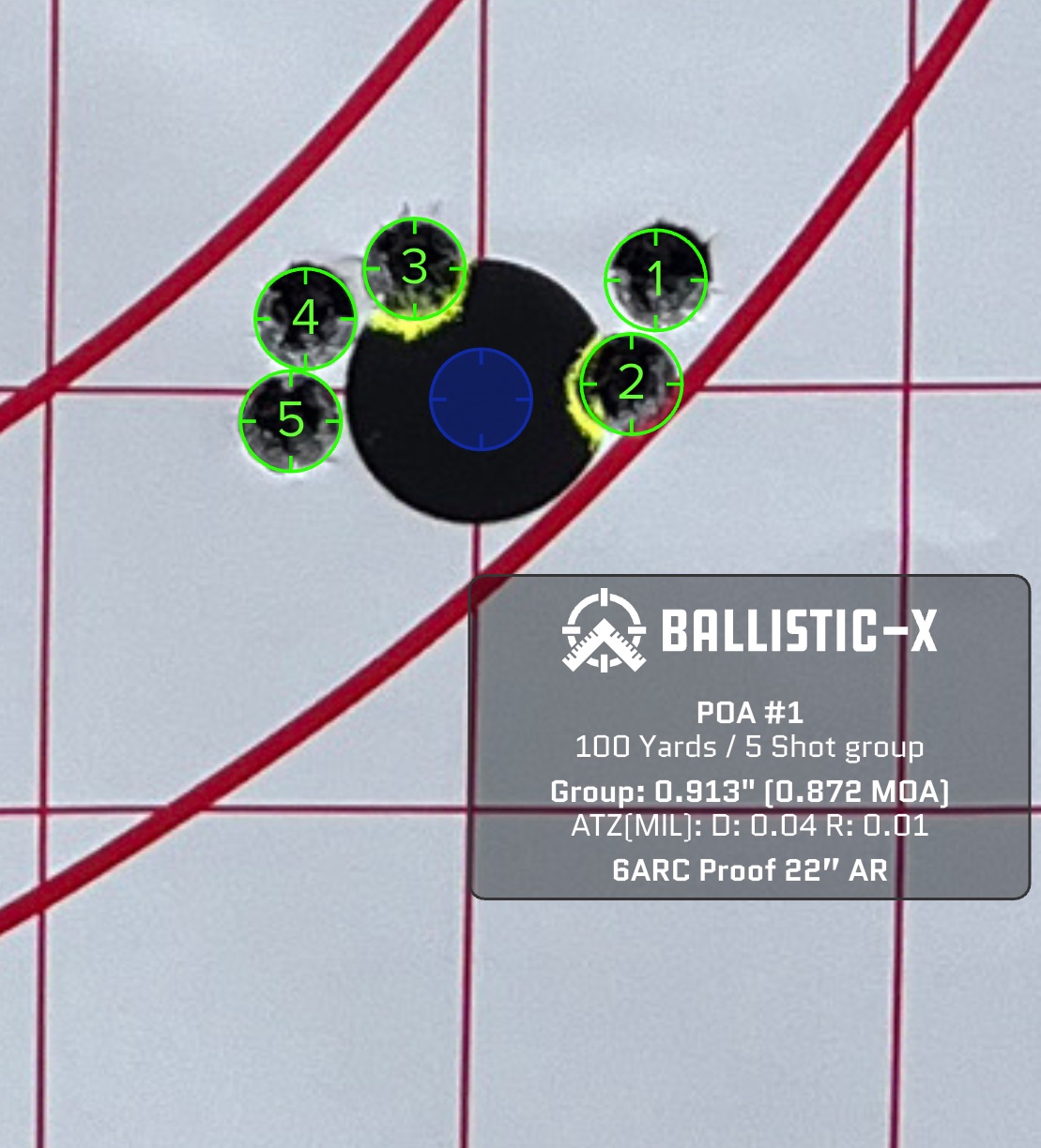

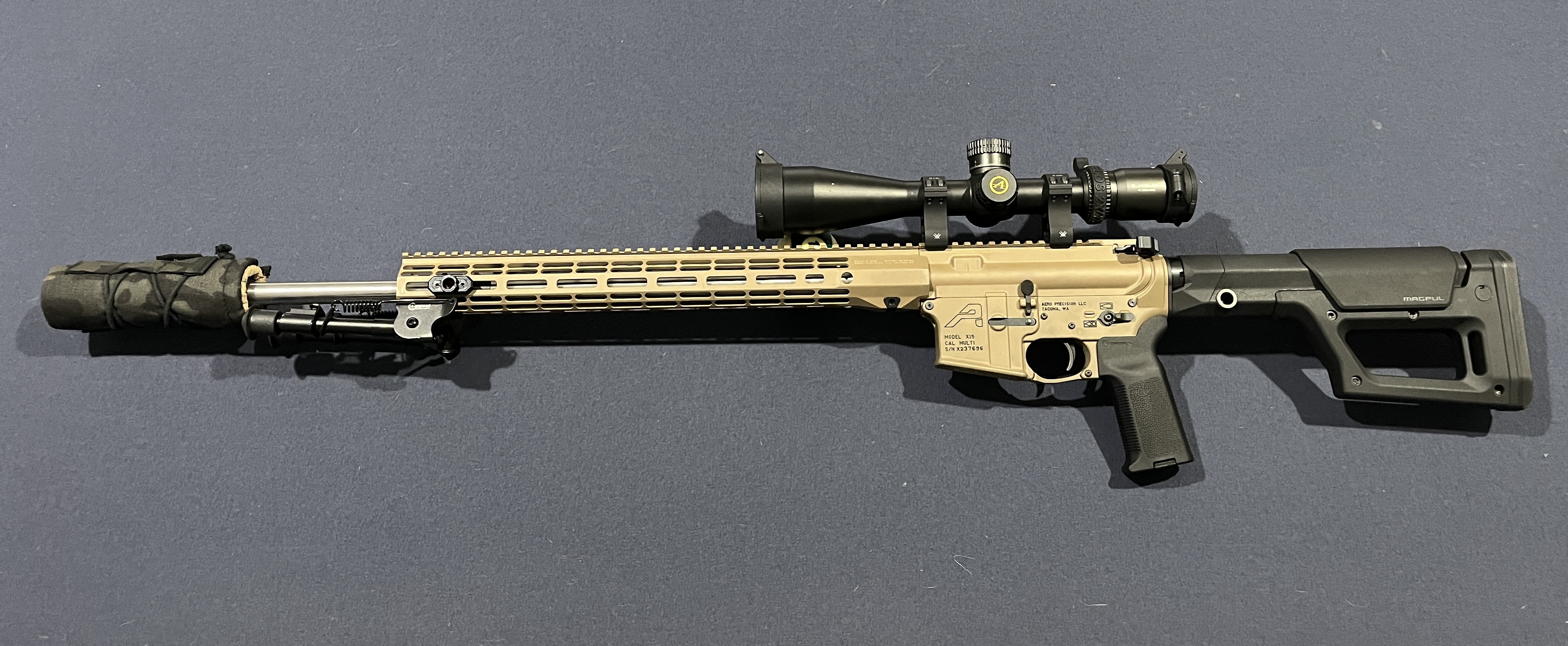

    I just put one of these together with the 22" proof barrel. Have managed one sub MOA group with it in the first 100 rounds though a few others were close. Definitely a learning curve coming from the bolt action world.

    With which load? I know when it comes to the factory-loaded stuff from Hornady, the only two loads I could consistently keep sub-MOA were the 108 ELD-M and the 103 ELD-X. The 80 ELD-VT have been atrocious, best group was 1.8 moa, and most were over 2.
