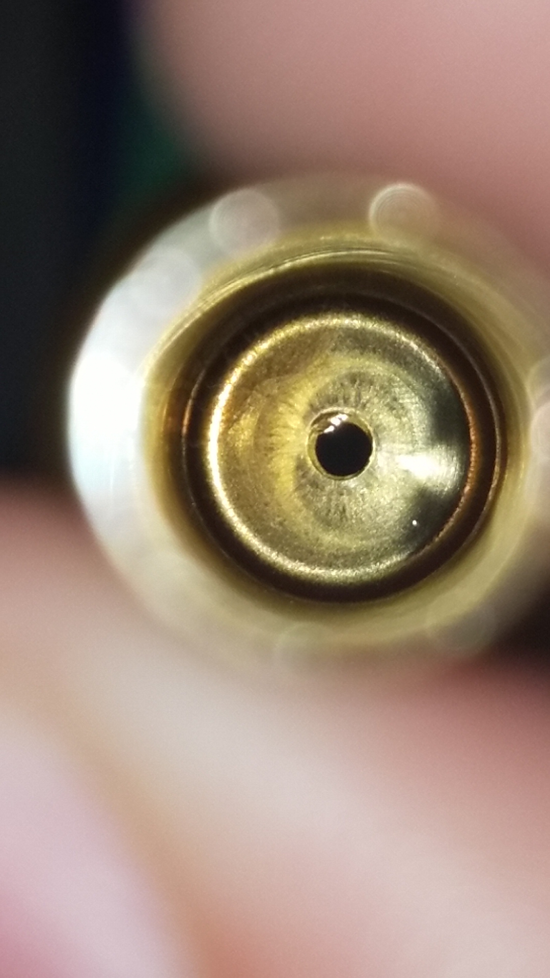

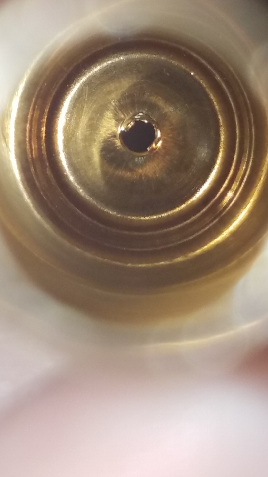

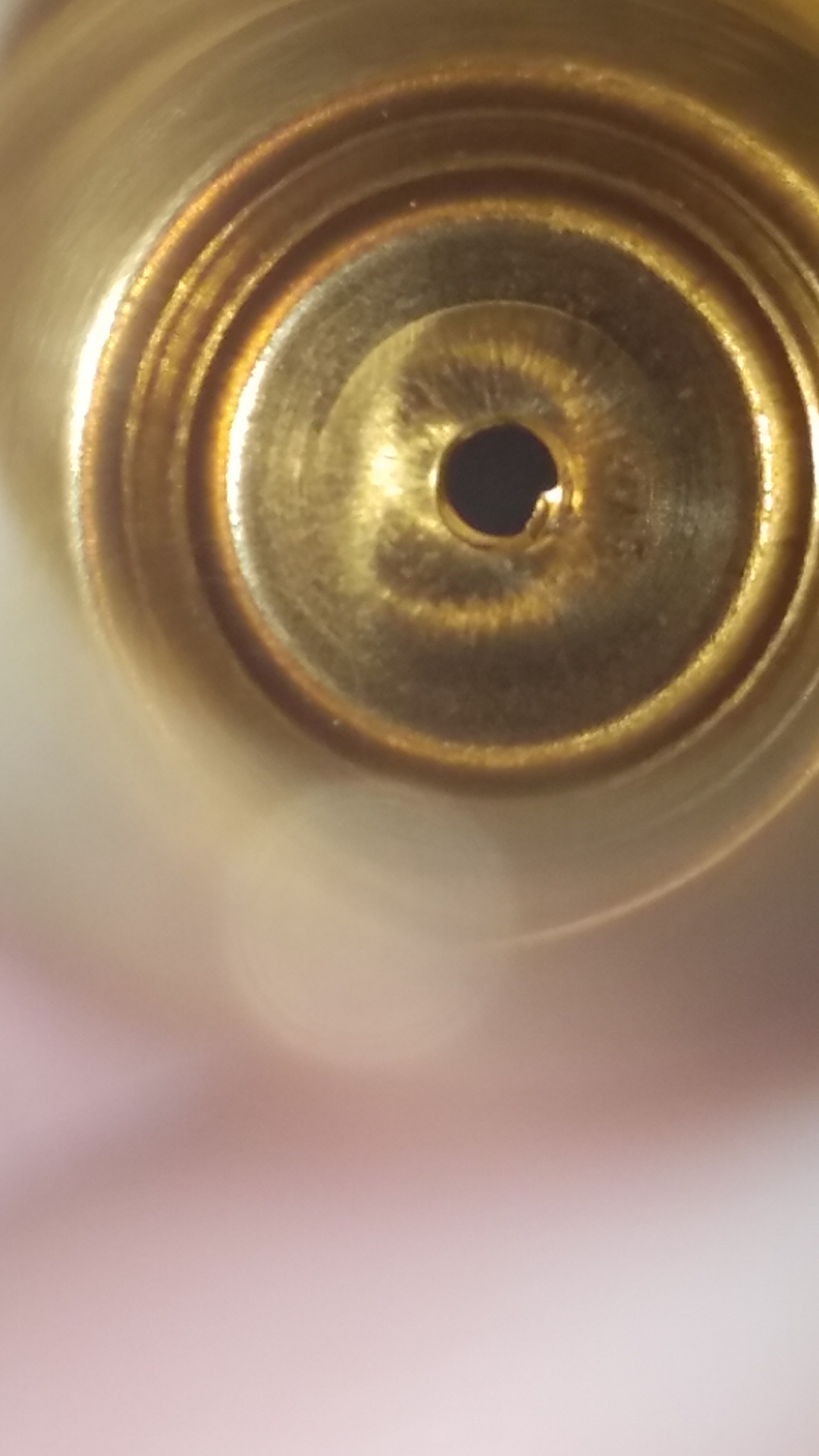

So I bought my first 200 peices of lapua 6.5cm brass after understanding it's the king of brass. Well the first box about 1/4 had lots of burs in the flasholes.
And the 2nd box almost half had a lot rough burs in the flash holes. After paying more than a dollar a peice I would think the QC or overall quality would be better.
Did I get a bad lot or? Should I contact lapua?

That is very unlike lapua. I would contact either the place you bought them from or lapua directly. You will get replacements and i bet the new ones wont look like that.

I have been running two different lots of 6.5 Lapua brass and the holes are good, possible you got a bad batch.
With that being said I am no Lapua fanboy but my one lot has been fired 16 times and has only needed trimming twice.
I would contact them and see what they have to say, they may not know.

I’d just deburr those flash holes and run it, but that is not characteristic of the brand. Drilling is supposed to prevent that but who knows. I’d call them up and maybe they’ll give you some brass

Lapua doesn’t drill, they punch according to their rep
Really?? I read for years they drilled and that’s why the flash holes never have shards in them.
Edit- just went to another forum and apparently it is a misconception that they are drilled, and I wasn’t the only one who thought so. They are indeed punched, but they still rarely need to be deburred. It’s not a very painstaking step to deburr them at all

Just contact them, they will get you sorted out.
I had a single defective piece in a box of 223 recently; it had a huge gouge up the side of the case that was clearly caused by an issue during manufacturing. They promptly sent me about 10 new cases, some sticks, a hat, and a t-shirt. They were also adamant about learning what lot # the defect was in so that they could track it down for their QC, which shows that they care about this stuff.

So this is the response I got.
Dominic,
This is not uncommon for any manufacturers brass. Cartridge case preparation should be done anytime you buy new brass. Flash hole reaming , primer pocket uniforming , case neck sizing ETC. Need to be done before any loading of the cartridge case is started. The trick is getting the proper tools. For flash hole deburring for the .060 flash hole of our 6.5 CREEDMOOR cartridge cases or for any cartridge case with that size flash hole. I suggest you use the SINCLAIR INTERNATIONAL FLASH HOLE REAMING TOOL # 749-005-418. For primer pocket uniforming ( small rifle) get the 749-003-709 small rifle/pistol carbide primer pocket uniformer and either the 749-001-607 handle or 749-001-880 power screwdriver adaptor ( I suggest this one). These tools will help remove the burrs , properly size the flash hole so your decapping pin in your die does not stick and uniform the primer pocket depth for more consistant ignition (this should be done with each reloading of the cartridge case. Flash hole deburring just needs done one time) Another great source for quality reloading tools is PMA TOOL on the web! Hope this helps Dominic. If you have any more questions please feel free to contact us at any time!

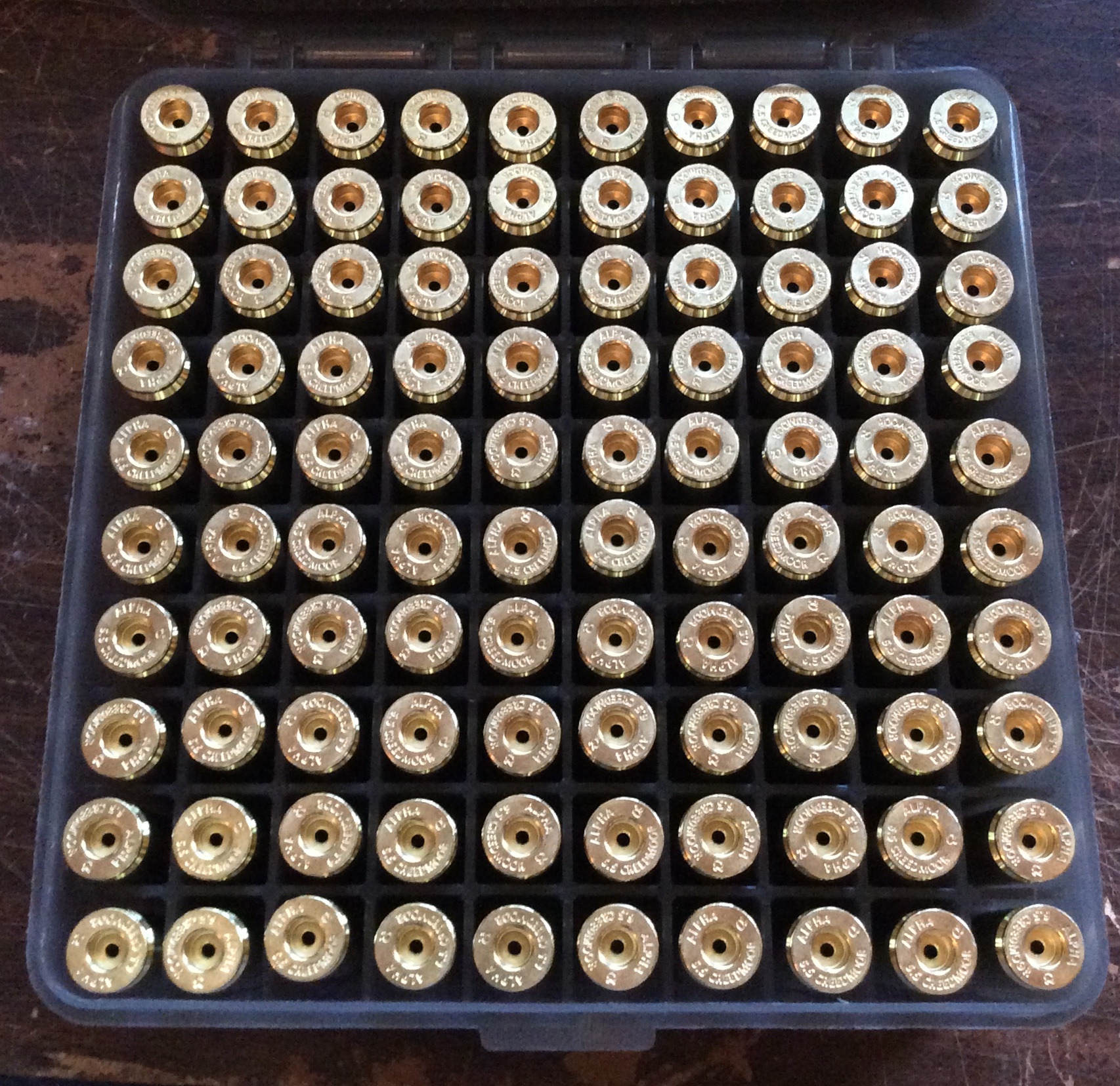

Ordered some 6.5 Alpha today. Had to call them to make sure I ordered the large primer version, BECAUSE MY CAT WAS DISTACTING ME?. Again great folks and exceedingly helpful. Awesome find, thanks to this thread......
b6graham
MMPRL
Belligerents
Jul 29, 2014
4,021
3,209
219
By cat you mean female friend?
Reactions: Max and JSTARSZ
