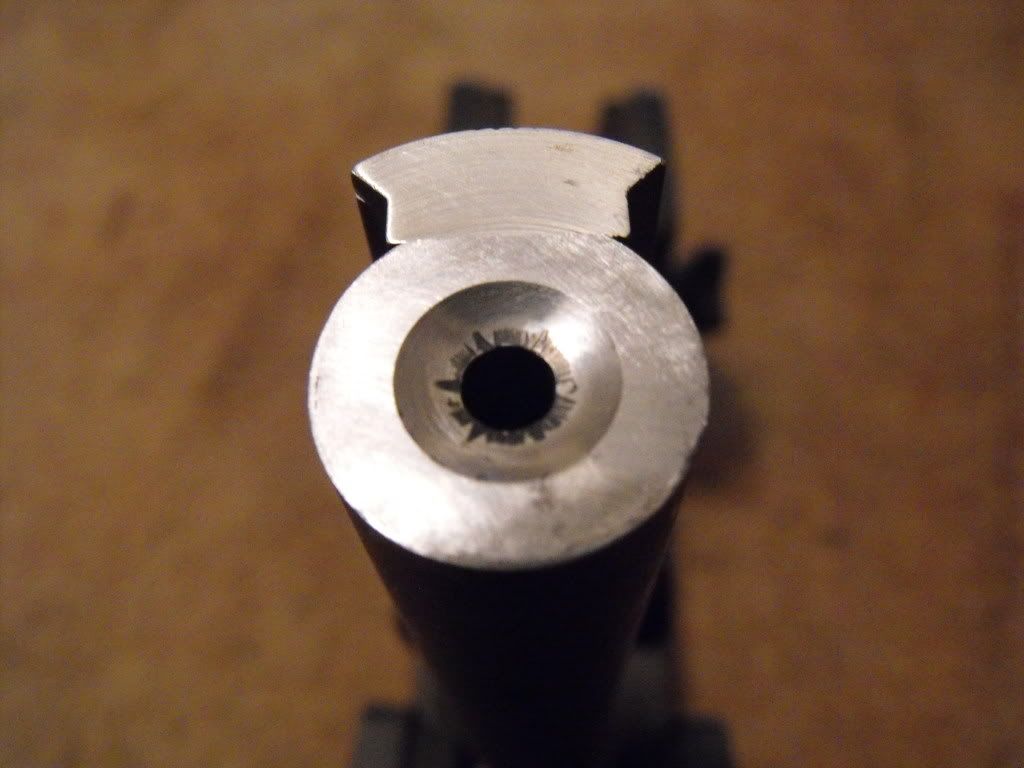

Re: DIY barrel crown
What I didn't mention is that the rifle was a 1/2 MOA shooter on FGMM before sending it to a local smith to be cut and threaded for the sandstorm that is on the way. Seriously, I about puked when I saw the work that was done. I shot it today and still sub MOA on 4 shots fired quickly before a rain storm. Not sure what to do. No more guns going to that guy.
I've crowned several of my own rifles and stayed in a Holiday Inn Express last night. They came out OK
Let me know if you need a little help.
It shoots great. The factory crown was fine. I had a friend cut the barrel from 10" to 6" & I crowned it. I'd have no problem crowning another barrel like this. The edge of the muzzle is razor sharp & there were no burrs to worry about. If you try this, try to find a carriage bolt with a smooth head. If you can't, just chuck the bolt in a drill & sand the head smooth before you start on your barrel. If you try it, I'd love to see how it turns out.
