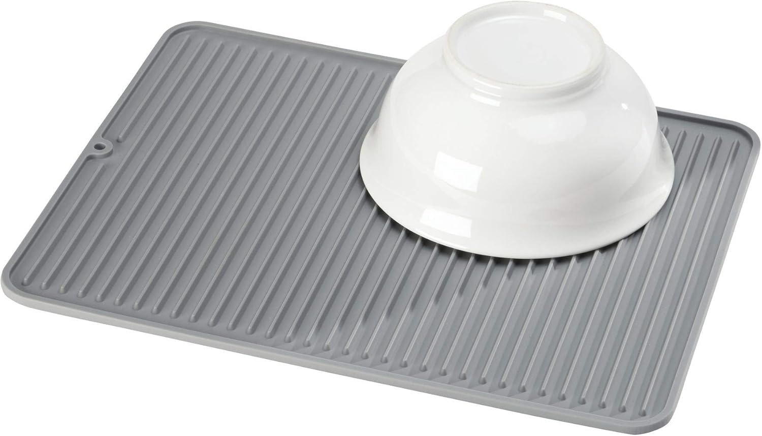

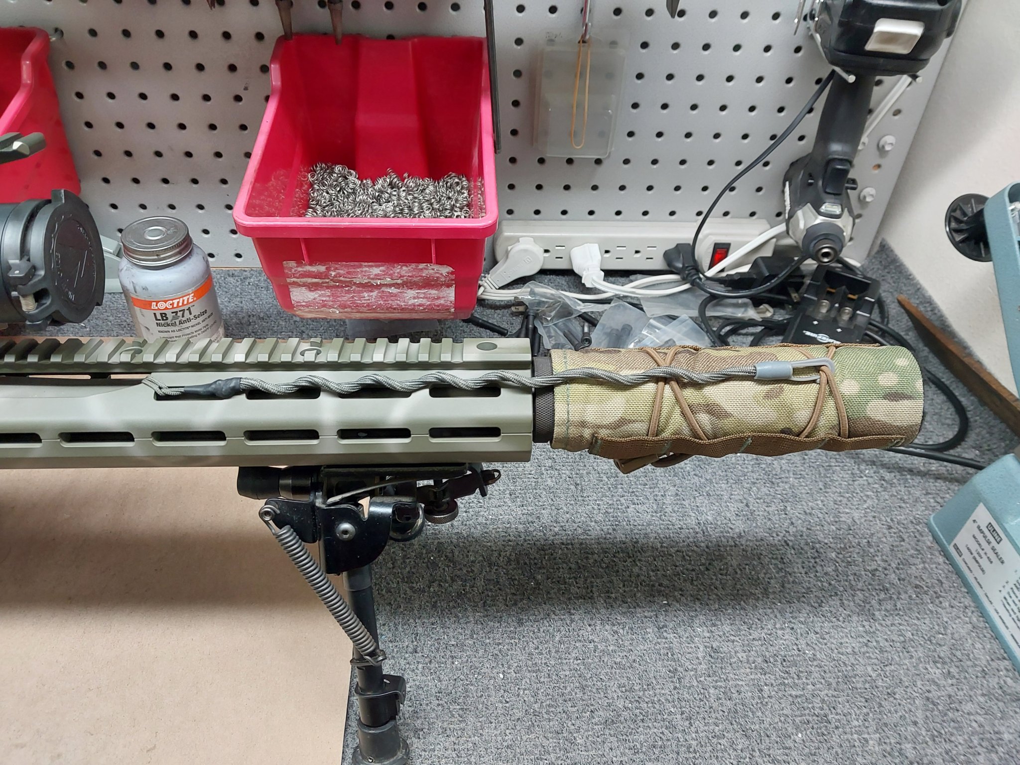

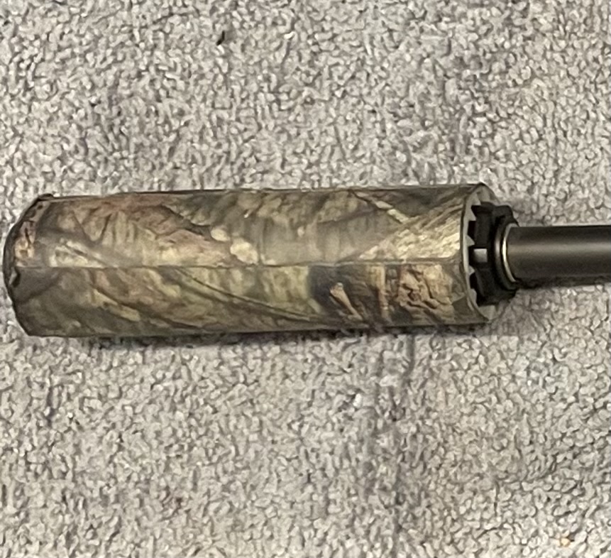

Silicone dish mat. Some Gorilla tape and some camo tape. I can get 2 covers from a $12 mat. Yes, I’m a cheap-ass. But my AG covers slide around too much. Depending on how tight you make them (so to speak) they don’t slide around at all. Very temperature resistant, and vented with ridges.

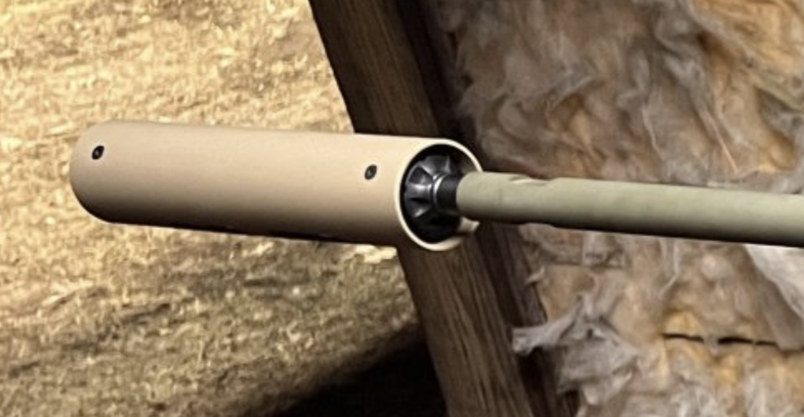

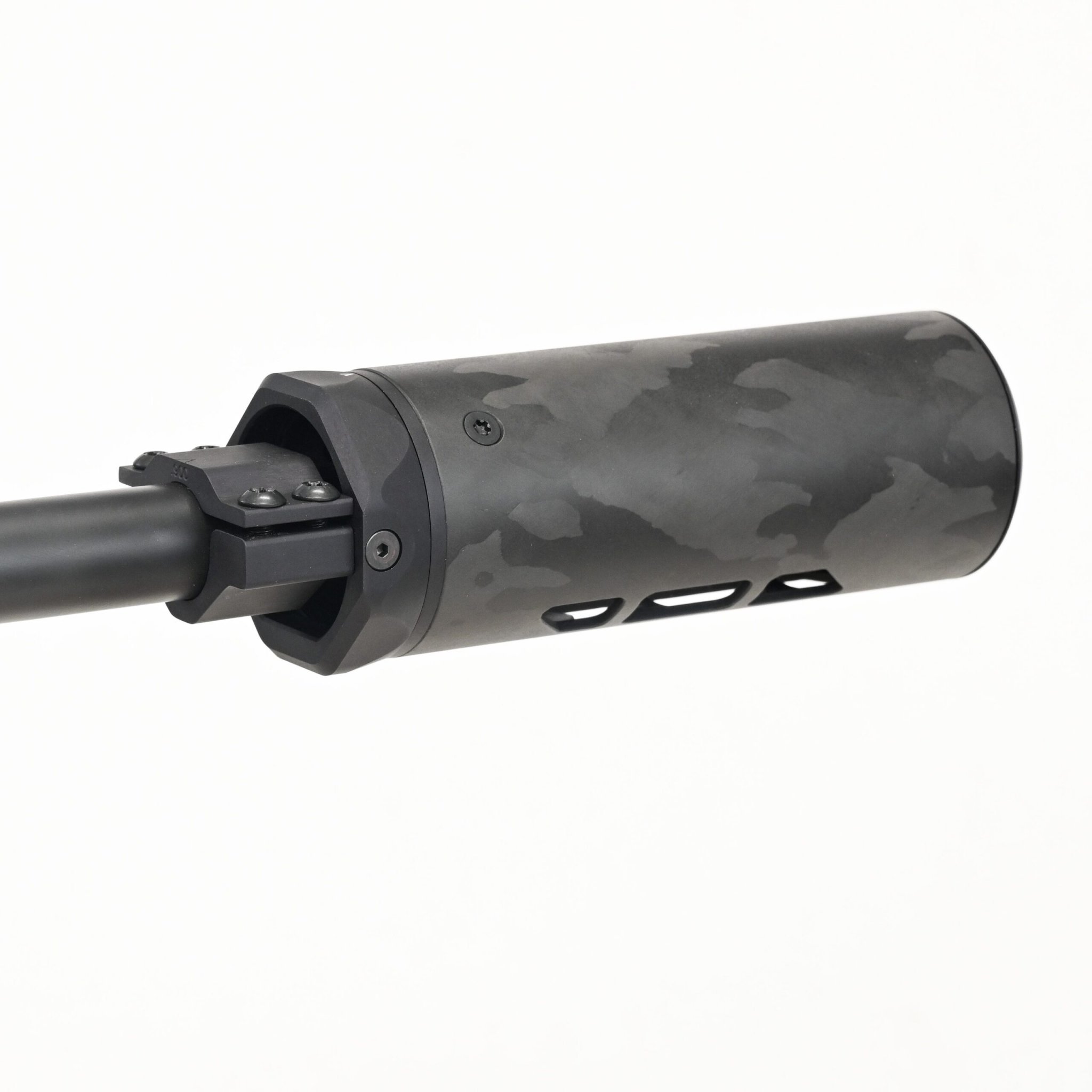

Cool. My “cover” is a bit different and does not stretch at all. Well, I’m sure on the atomic level it stretches. It’s a discontinued Modtac vented carbon fiber tube that clamps on the suppressor. It’s just ok in some ways (need a tiny allen key to install) and awesome in others (doesn’t move, best mirage performance I’ve seen in a cover).
I don’t claim to be a suppressor cover expert, however. I’ve used three brands total.
Here’s my write up on it and Modtac’s new version (below), of which I’m a bit unsure of.
