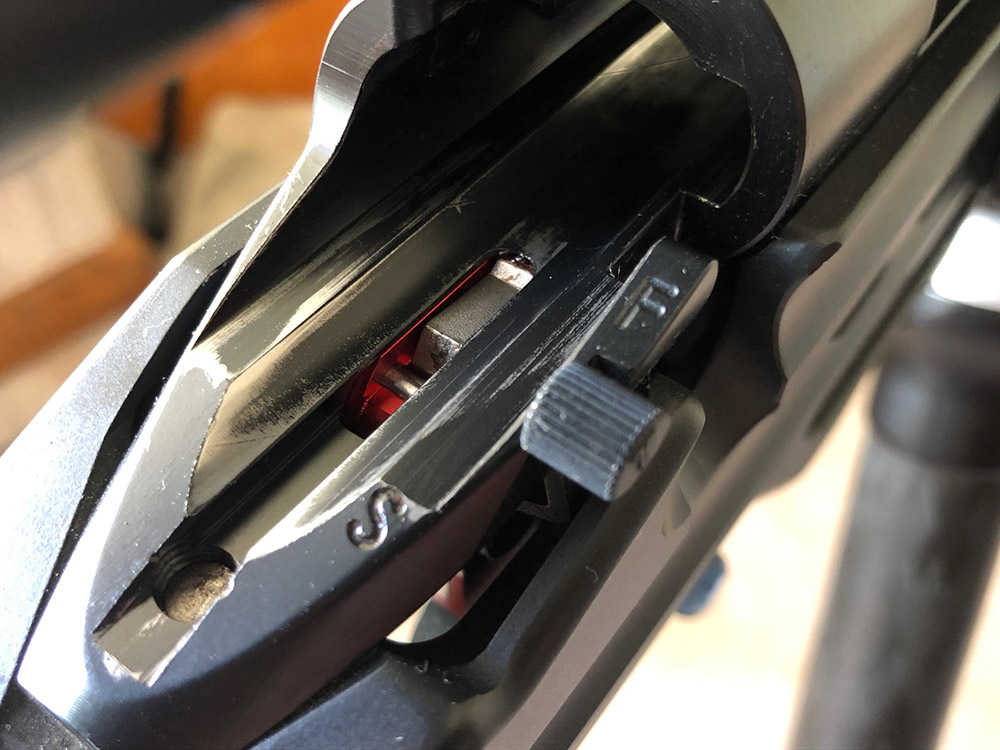

DLC wear on the raceways of my Bighorn action. This is what it looks like after close to 10k live rounds and probably 50k+ dry fire cycles of the bolt.
Is it difficult to remove the DLC entirely from the action and bolt? The way it is now, its worse than any factory Remington Ive had in smoothness of bolt manipulation.
