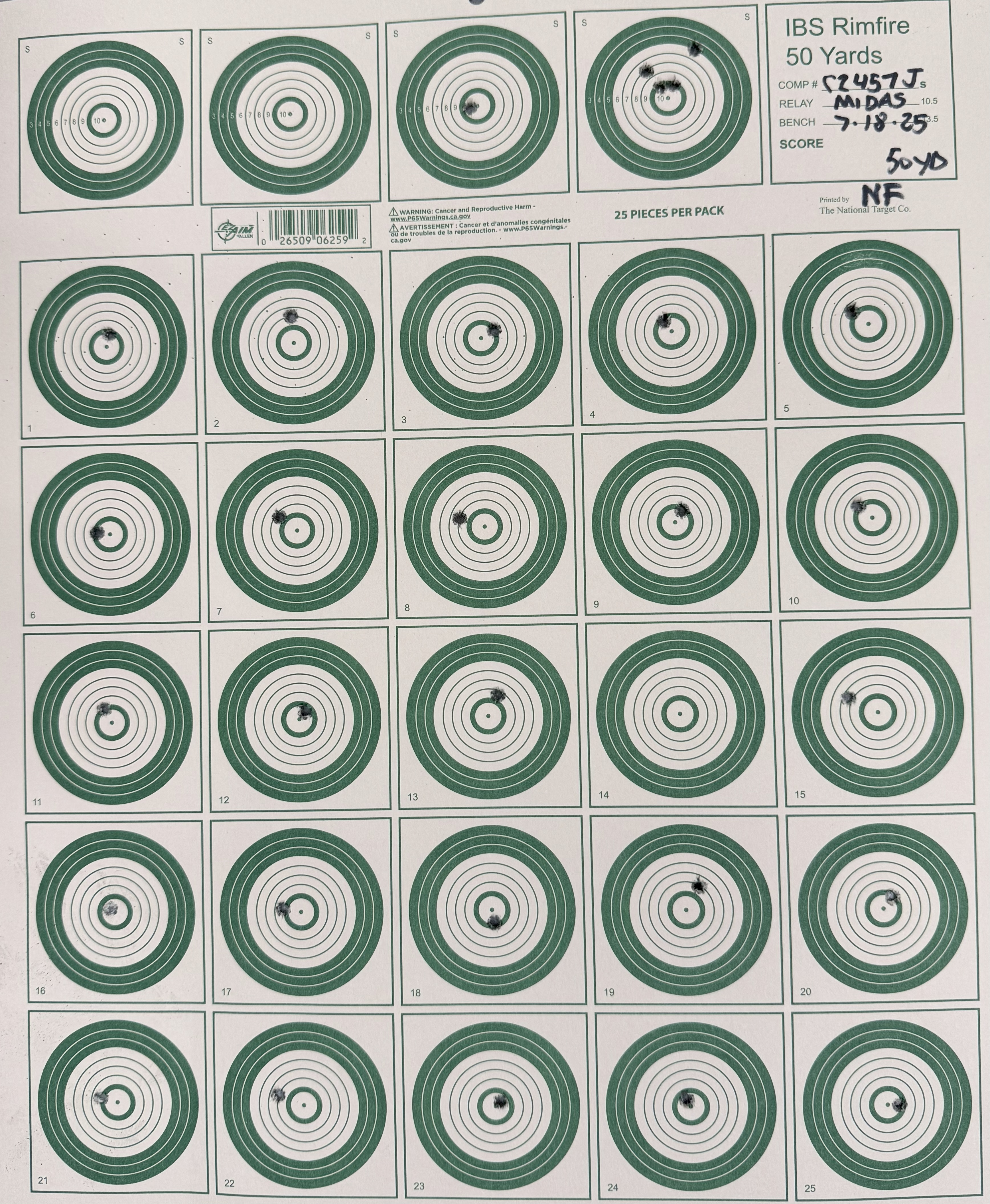

Here's what I do to compare. See photos.
Same ammo, Vudoo vs CZ457. This has always been how the CZ shoots. The Scope, barrel, both have been changed and at least 10 different ammo vendors. I thought it was the scope. I'm down to the scope base being the only variable other than the bolt or headspace. I did try reducing the headspace already and groups did not improve. Maybe I'm expecting too much from the CZ but when I removed and reinstalled the scope base the groups got larger on the CZ. I ordered another base, also contacted the vendor for the installed base. I'm not naming vendors until I finish troubleshooting.
The flyer on the Vudoo target was cold bore, first shot.

Not a huge discrepancy between the 2 cards posted above. Maybe the Vudoo chassis fits you a little better than your CZ rig ? 22lr amplifies cheek weld and trigger pull inconsistencies much more than a centerfire rig due to time in the barrel before launch, less forgiving than a round traveling 3x faster to exit the barrel. Spend some time watching benchrest shooters and how much or lack of input they physically put into the gun. You're overthinking it, step back, go back to basic fundamentals, and shoot it again. Alot of things need to be right when chasing that extra 10th benchrest.

Let me explain the huge discrepancy. Scoring a match the CZ produced 5=9, meaning hitting the 9 ring 5 times. Vudoo shot perfect with zero 9's, hitting all 10's for a score of 250. Vudoo also hit 13=X meaning bullseyes. This is a huge discrepancy when shooting a match. It the difference of winning or loosing. I shoot benchrest and do watch the shooters. I watch their lack of input, using a machined rest and clamping their stock into the frame, pulling the trigger with only one finger touching. I'm amazed that I have been winning up against that setup with Vudoo. As is, I will never use that CZ in a match. It's not even good for a practice setup. Its not the difference of flight time down the barrel either. It's not basic fundamentals, I am winning with the Vudoo consistently. I don't shoot differently with the CZ. As explained in a different reply it has a fully adjustable Manners stock. The Vudoo fits exactly the same. I measured both. Cheek weld was slightly different due to the difference in scope mount on the DNT that was originally on the CZ. I took the Nighforce off the Vudoo and put it on the CZ. I Trijicon Tenmile 50x is now on the Vudoo. First match with it is the first Saturday of the month.

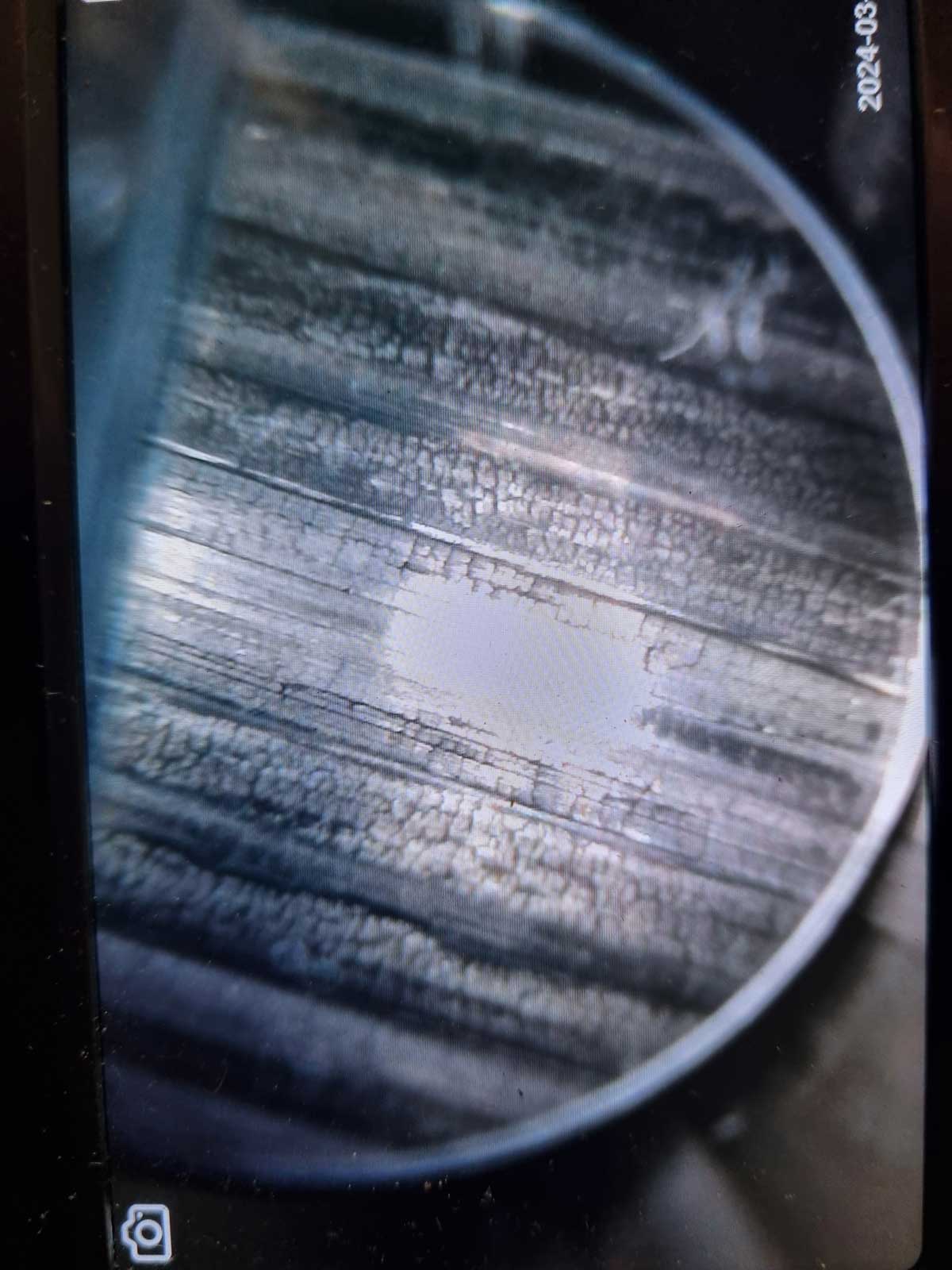

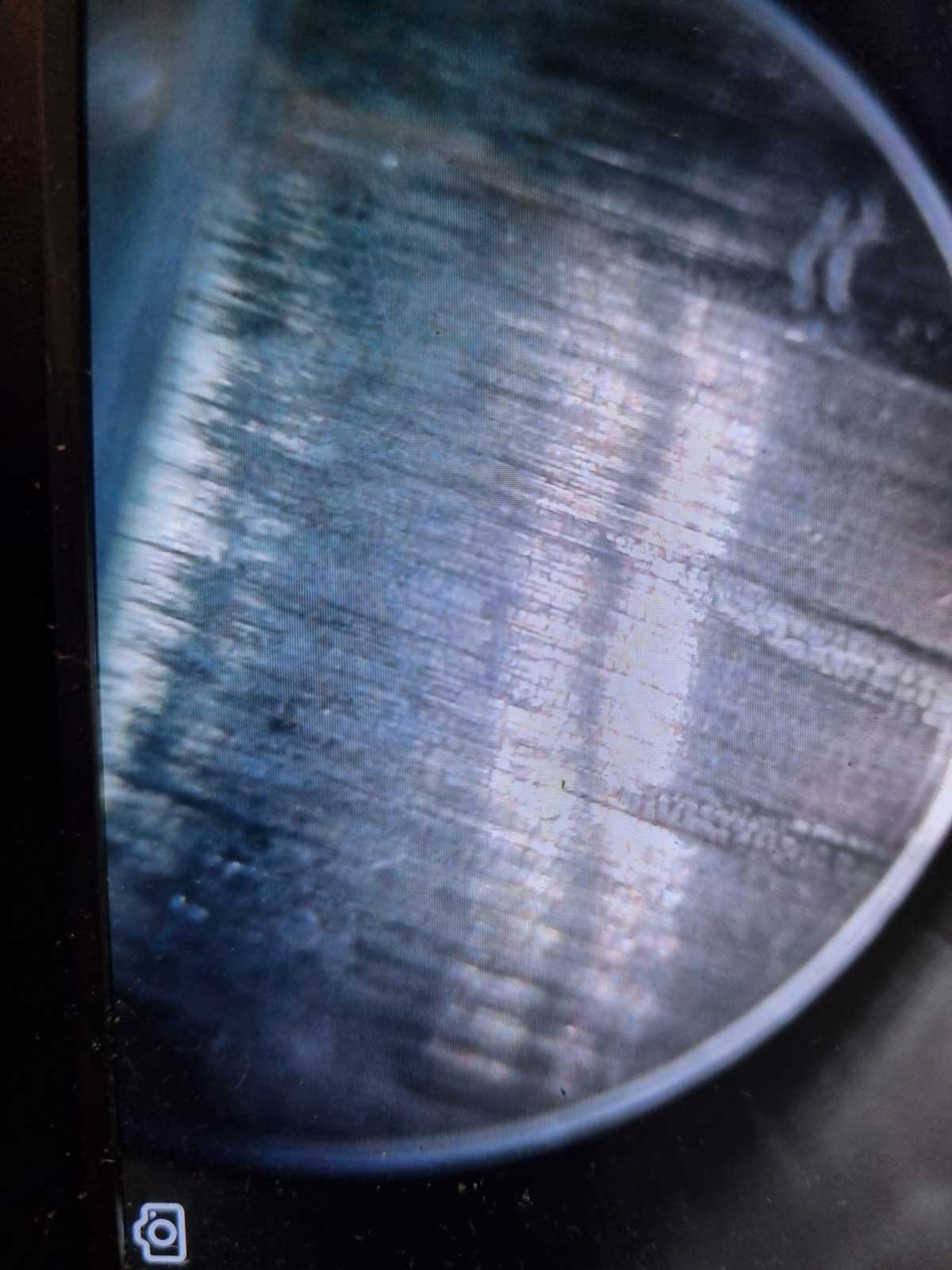

Well I may have finally concluded a bit more. First factory CZ barrel was not up to par. Second aftermarket had defects I found only after I viewed it with a borescope. This barrel was returned and replaced by another defective barrel. Now I'm waiting on a Lilja replacement. I think chances are the fourth will be a keeper.

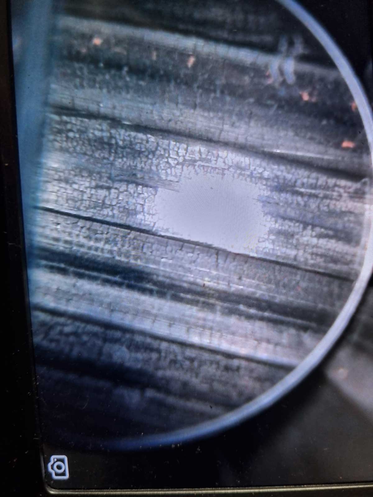

I have some of the ugliest, fire cracked, shit looking barrels on hunting rifles that shoot perfectly straight.
Try bore scoping a Savage. Looks like a monkey cut the rifling, and they shoot straight.
This is one of my Desert Tech 375CT barrels at 2440 rounds...still shot 1/2 or less moa!!
That's normal wear, firecracking.
Borescopes are a great tool. Very useful for routine cleaning to view carbon buildup and the removal of it.

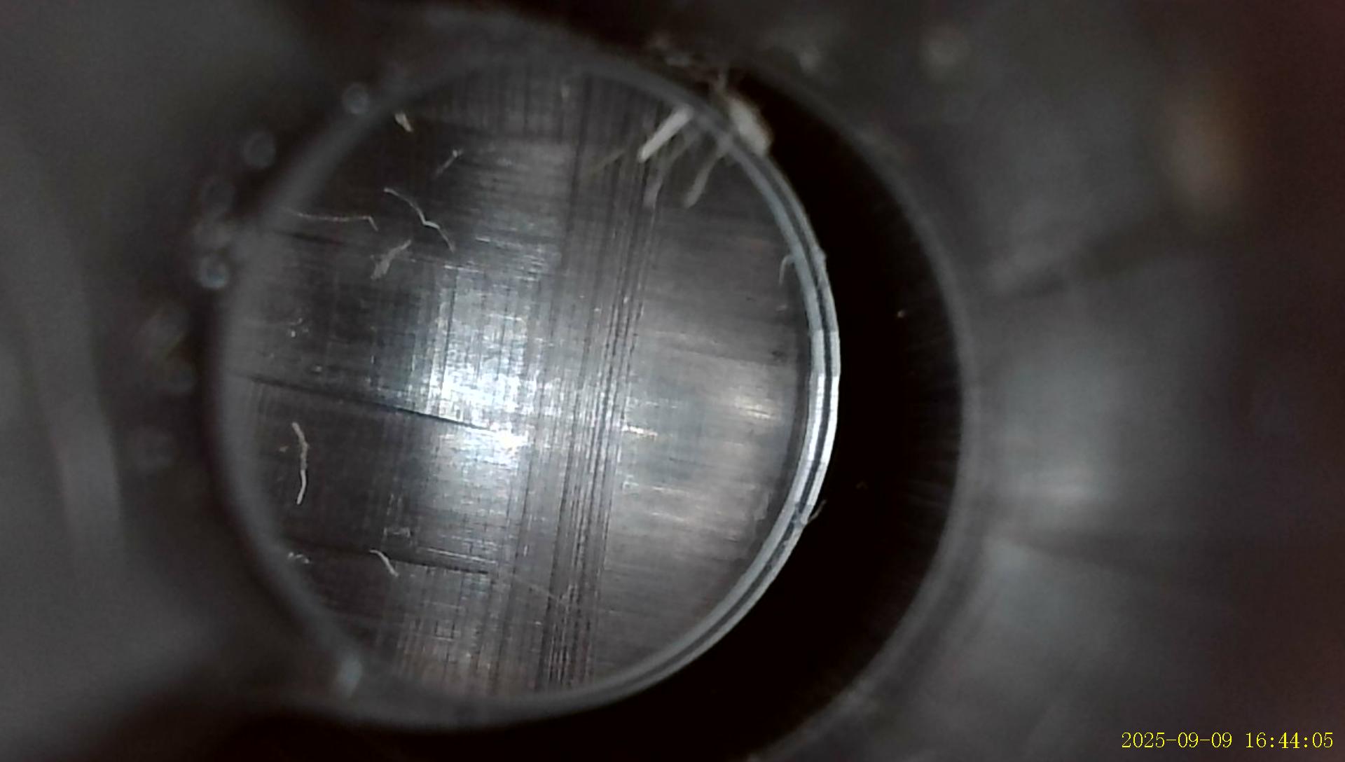

The attached image is not normal. It's not wear. It is a defect in a factory new barrel.

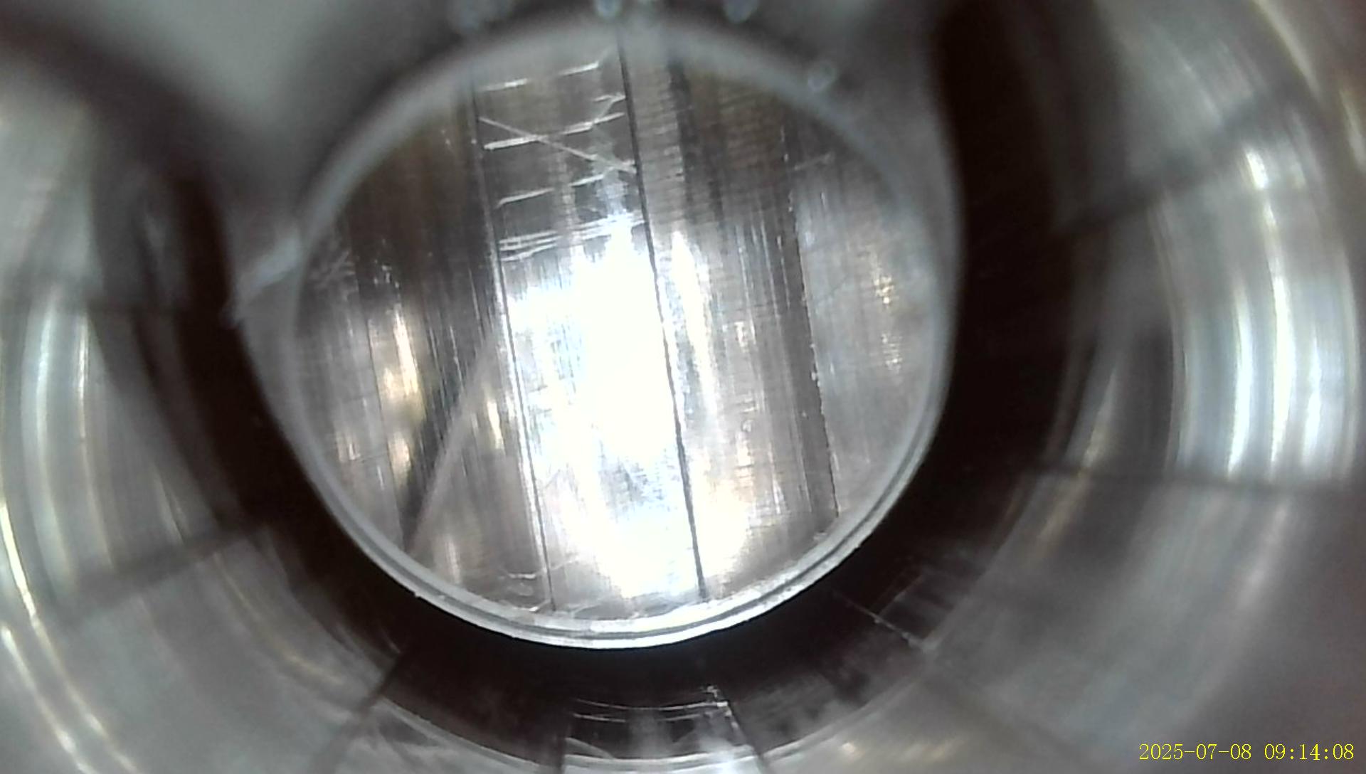

Here's two images. Which would you decide is a good process? One Mfg has a borescope as part of their quality inspection. Can you tell which?
The point being, is many folks with bore scopes buy a new barrel, immediately borescope scope it, come on here and wail to the heavens that the barrel is a piece of shit without ever shooting it.
MOST folks don't know what they are looking at (me included) and just think it looks like shit and don't even know it the "defects" affect accuracy. You know, sending multiple barrels back, never shooting them kinda thing.

I don't know anyone who returned a barrel without first shooting it. I tested both defective barrels with several ammo choices before sending them back. The both were from the same mfg btw. I also called the mfg after sending the borescope shots to discuss what I noted. I don't like classical music or know anything about it but I would know a bad orchestra from a good one. Point is it's not hard to see a large defect as shown in my borescope pic. I do borescope every new rifle if nothing else to note differences in rifling.
Borescope are not the worst invention ever. They are a needed tool. I don't know how I would ever know if I removed all the carbon ring when cleaning without one.

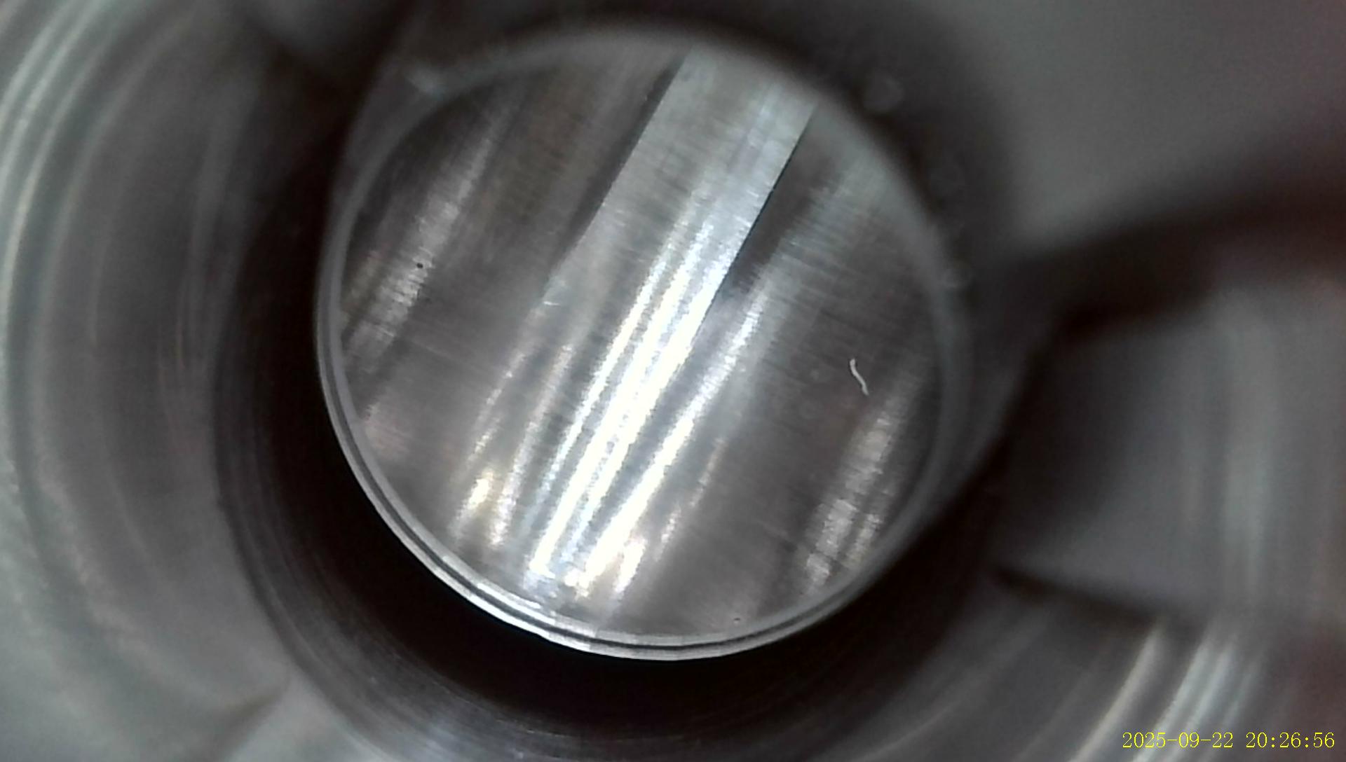

The new barrel shoots much better. I didn't adjust the headspace correctly and shot a 249 - 11X. I was jamming the bolt, I forgot to take the shim out of the bolt. Nothing wrong with the CZ, just the Vudoo shoots better? That's exactly what was wrong. CZ should shoot just as good. The previous two barrels were getting consistent flyers due to the defects.
I removed the bolt shim. I do think the CZ is going to shoot on par with Vudoo now. I should have chose Lilja first but tried to save a few dollars. That in the long run it cost more in ammo and time. I'm glad its sorted out now.
