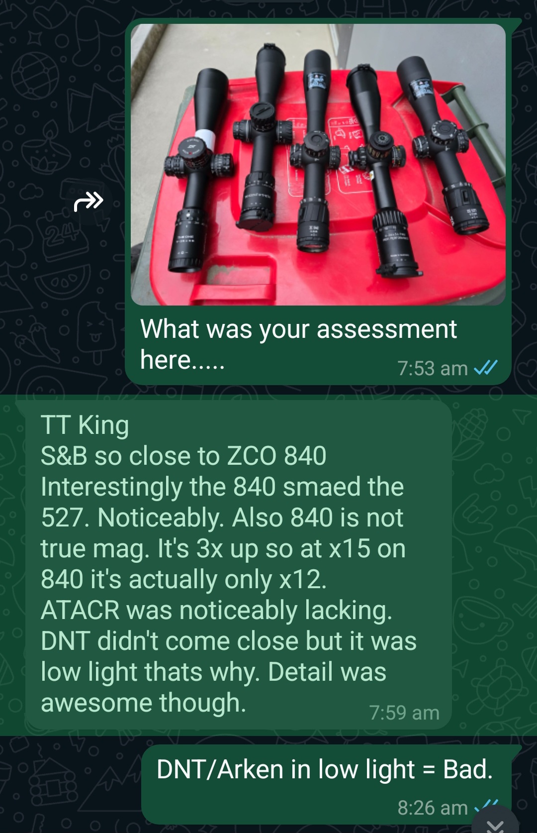

As a reference...
This is a private conversation between myself and my dealer/friend here on Aus...
In regards to Low Light...
DNT/ZCO/S&B/TANGENT/NF ATACR

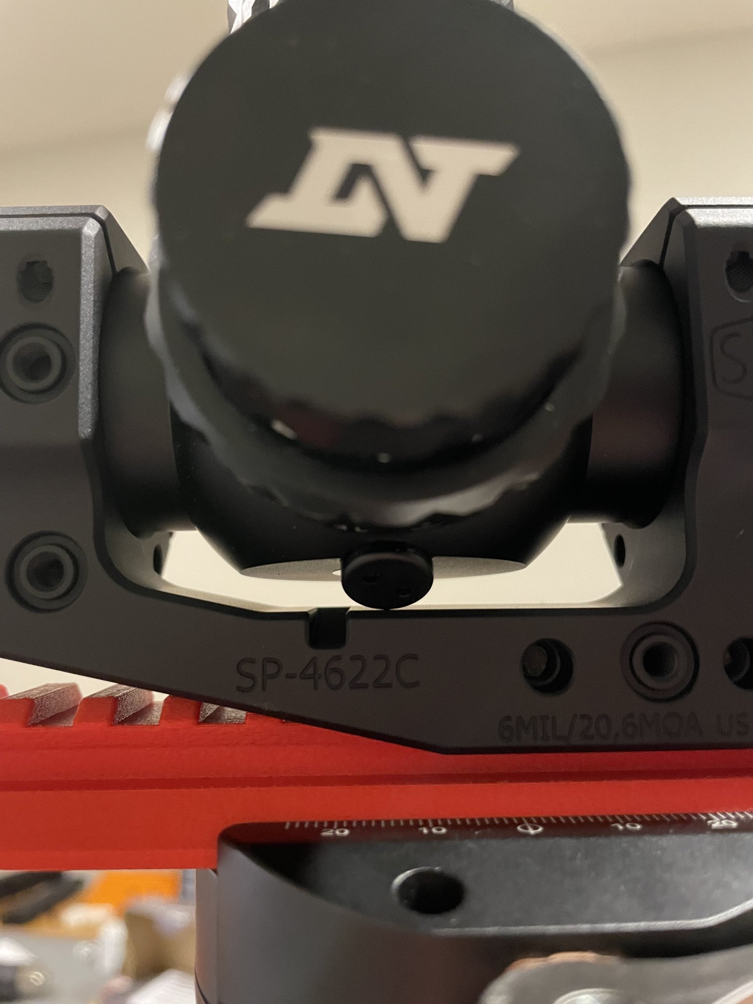

Got out today and got it zeroed and did a comparison with the Match Pro ED. I got to say the glass on the DNT is very good for the price range. It was noticeably cleared than the Match Pro. There was no CA in the DNT looking at white targets from 200-550 yards. Looking at the 550 yard IPSC steel with impacts and marks on it I was able to see the the marks clearer than I expected and more clear than the Match Pro. The reticle was nice also. All in all with the $599 price it's a steal for glass and reticle.
The con I feel are how the knobs feel when adjusting back to zero. Feel a little cheap but not bad as they are cheap. LOL The screws are a little shallow so watch it when adjusting not to strip. I got it zeroed and ran it up and had 19 mils after zero on a 20 moa mount. I ran it back down to zero and it hadn't changed so that was good. First time with the 6 ARC so only put 20 rounds through it so it's getting cleaned now. Looking forward to next trip out with the DNT.
Yes the turret set screws worry me. This was the response I got from DNT. They work but seem really soft where just putting a little tension on them is kinda worrisome.
“After checking with our warehouse we don't currently have any spare to send out, should they become available for purchase in the future it would be done on our website. For the time being, if you are pressed to obtain an additional set of screws Kenton Industries does offer for purchase custom set screws for our turrets, as well as taking the entire turret with the screws in hand to any hardware store that specializes in fine threaded screws could be another option.”
We would love to hear your feedback on which option works best for you and any other future customers who have the same inquiry, our team here at DNT is always appreciative of our customer's feedback.

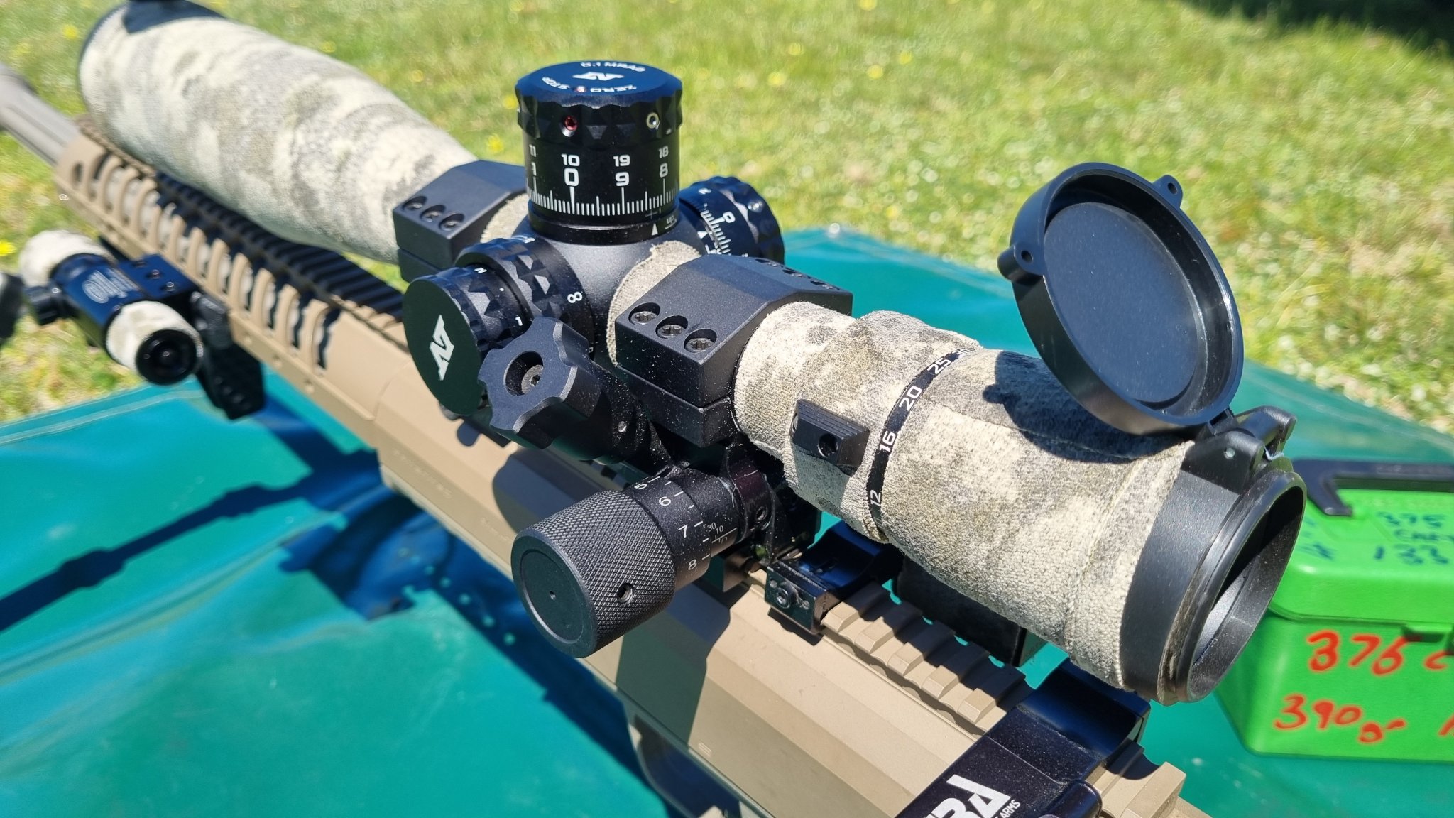

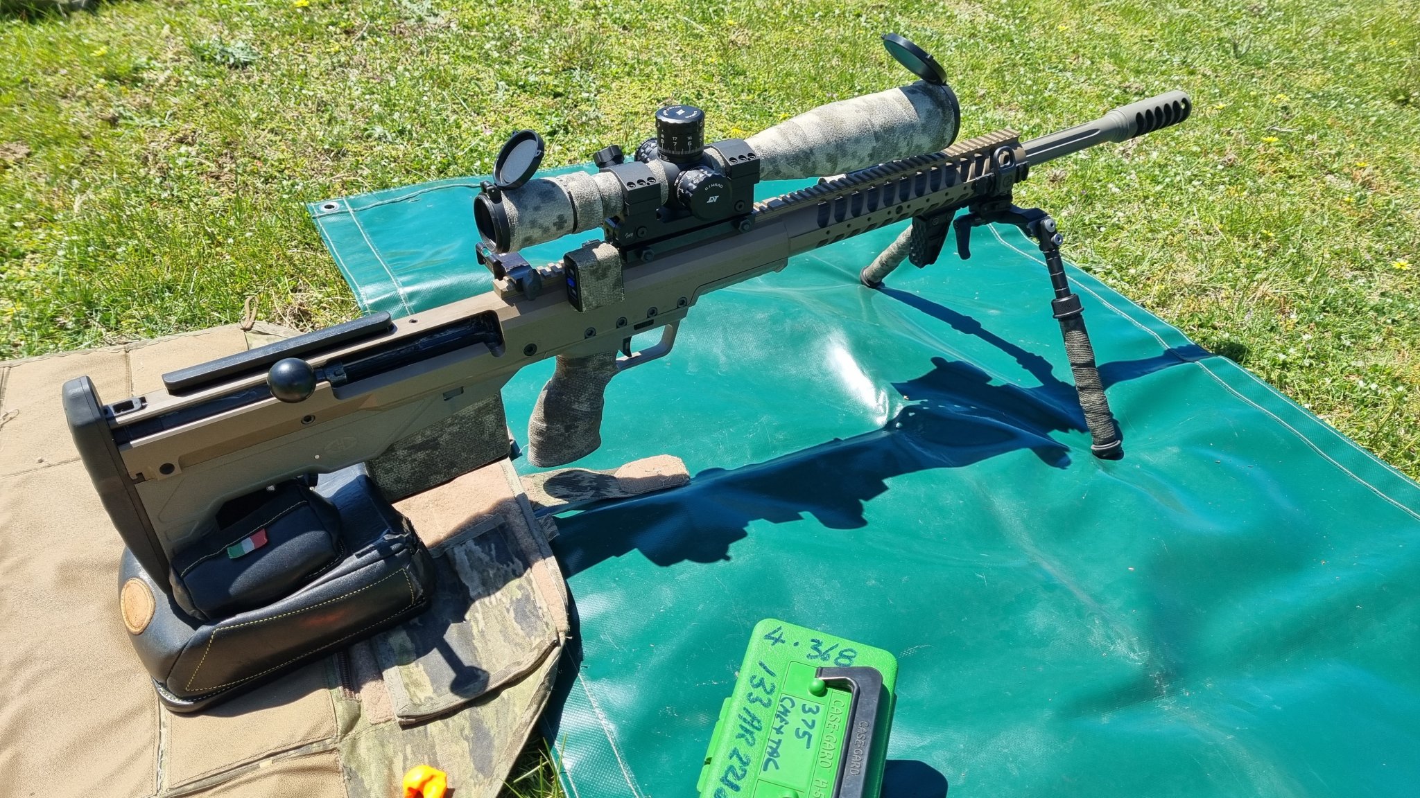

Gorgeous Day....
Setup at 1500..
I sighter....next 3 on the small upper plate..

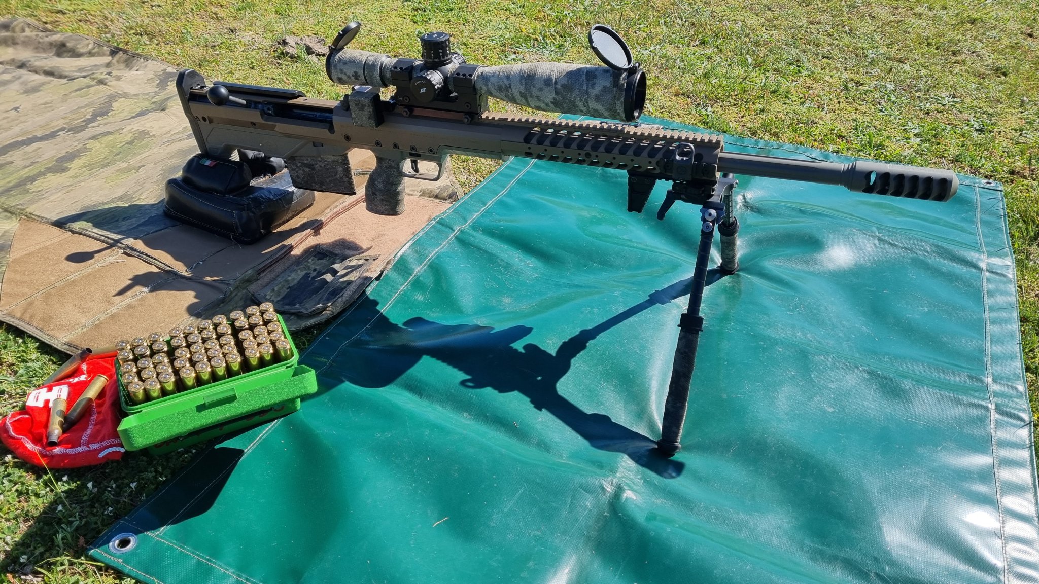

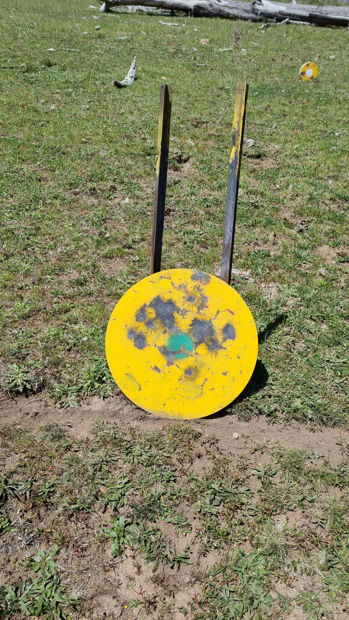

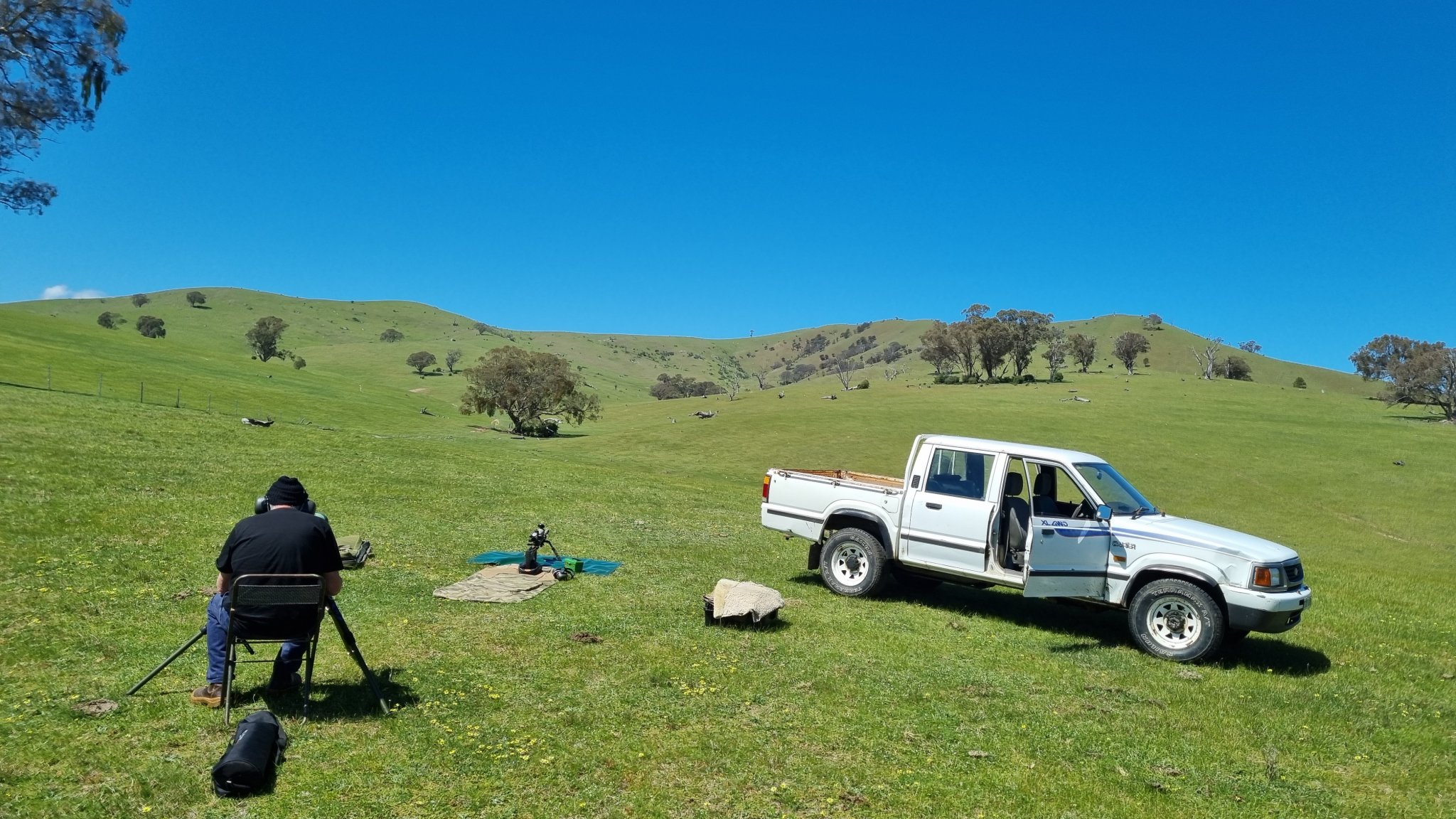

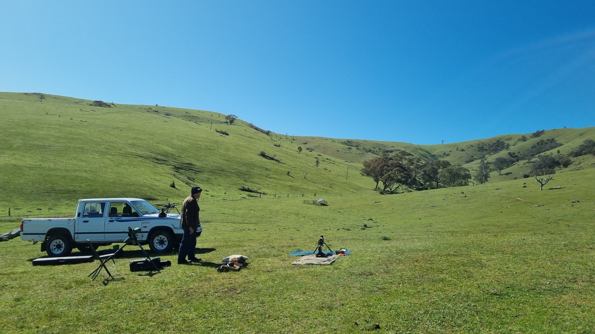

No issues with the DNT today, still cant really fault it....
shot at 28x...
1500yds
1760yds
3000yds
375 Cheytac , Hornady 390gr Atips
A great day.

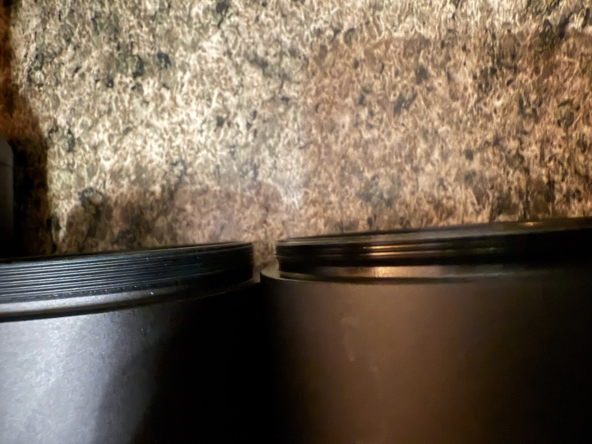

2.520 is the outer diameter of the DNT 7-35 sunshade. EP5 5-25 shade is 5.60 (at least that’s the MKM size of cap).
The DNT shade has a different thread pitch than EP5 5-25 also. DNT is on the left.

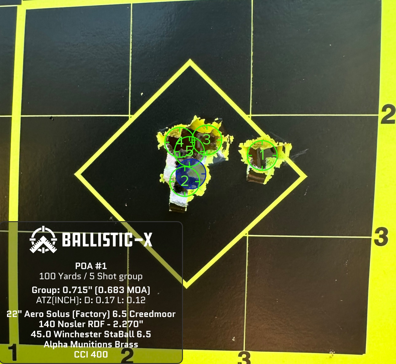

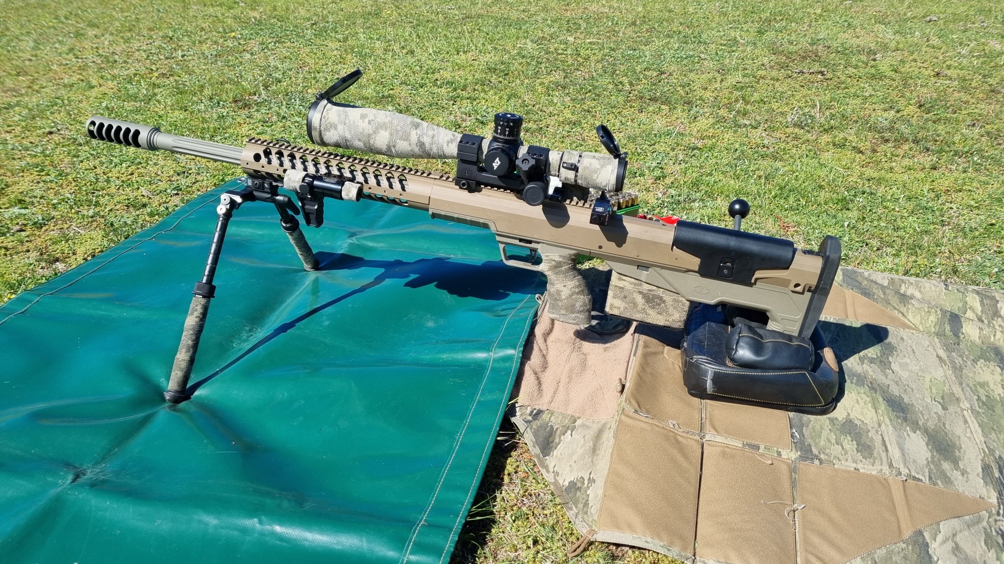

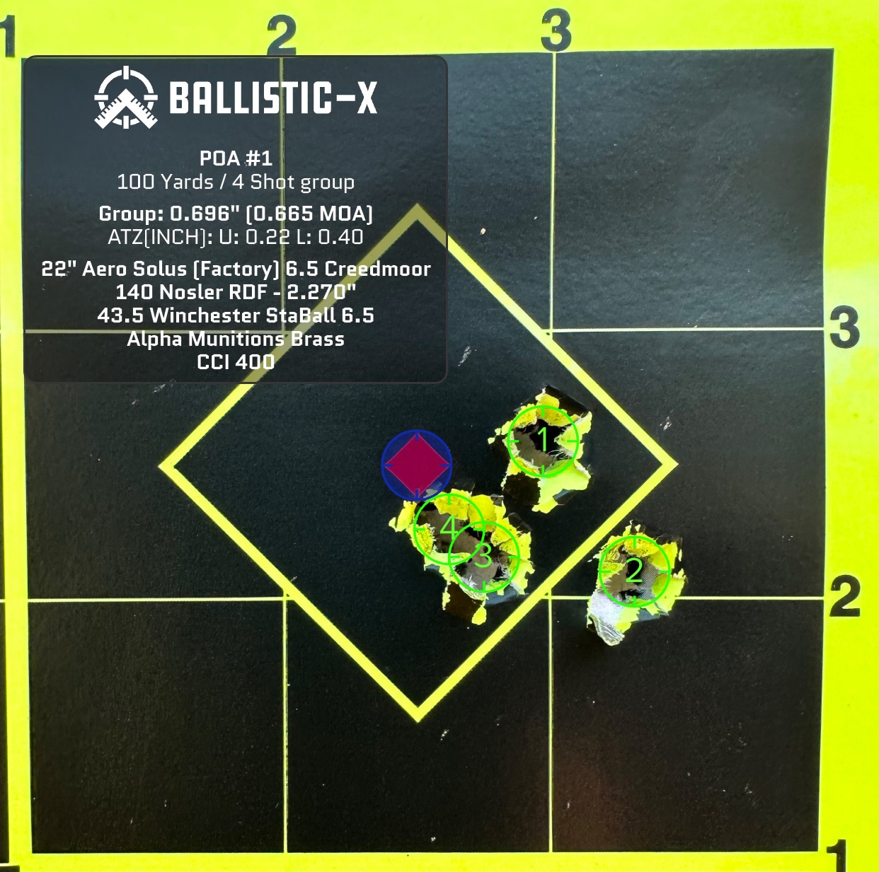

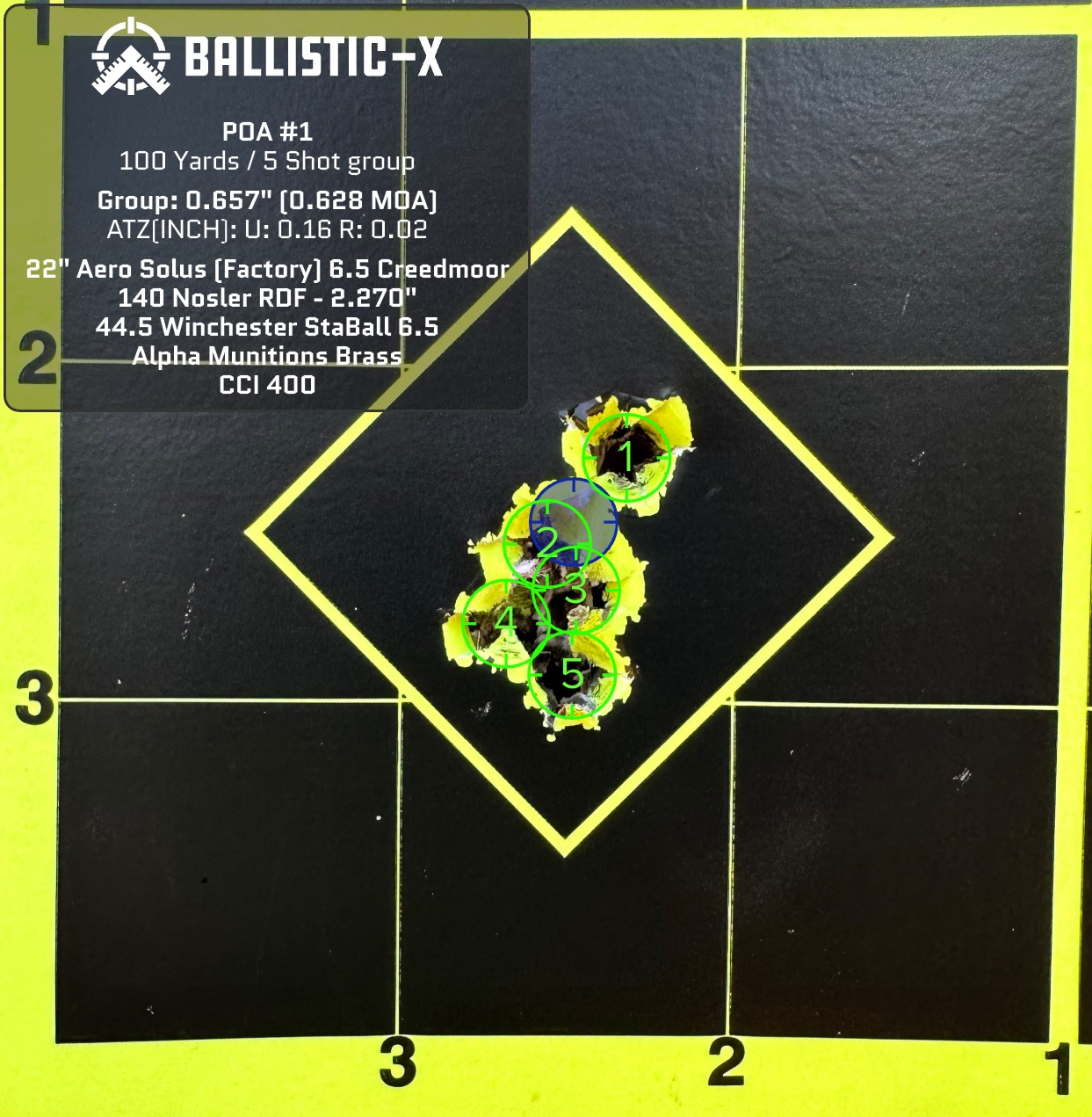

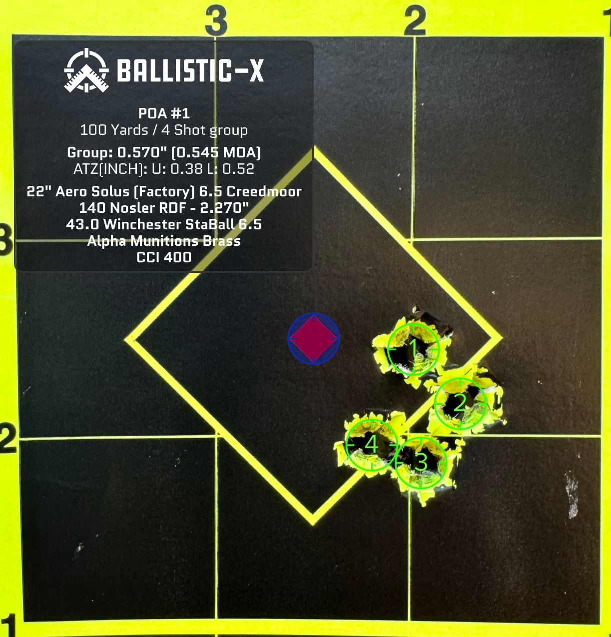

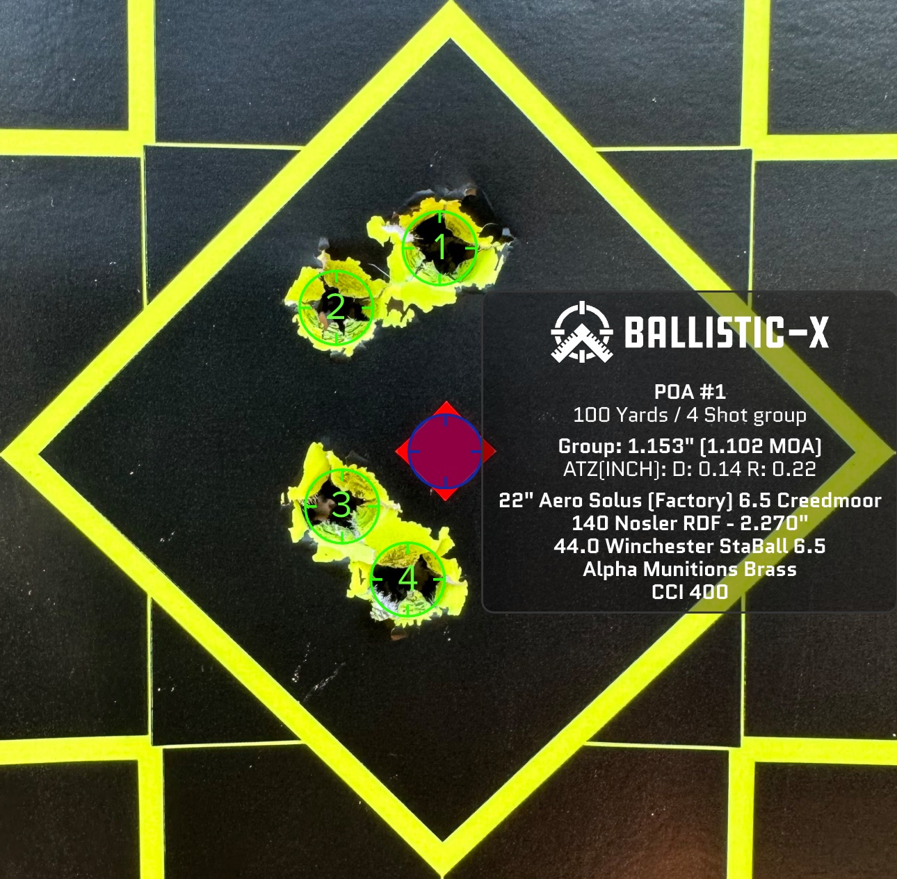

Apparently my Solus Comp 6.5 Creed is looking to be a shooter... The only things I've swapped so far is put in a TriggerTech Special with the screw removed (1 lbs.), and retorqued the action screws to 65 in-lbs. First 25 rounds, only a simple barrel scrubbing and dry-patching before going to the range. 3 shots to sight it in, so 3 of the groups are 4-shot groups, then the last 2 are 5 shot groups... I'm using brand new virgin Alpha SRP 6.5CM brass, Nosler 140 RDF's, StaBall 6.5, and CCI 400 primers. Seated them to 2.270", which is 0.010" jump, and still fit and feed perfectly from an MDT steel AICS mag with no front binder plate. Didn't know it was shipping, so I was caught with my pants down on ordering a matching Ergo grip like on all my other rifles, and the proper height rings, but they should arrive this week from Midway.
The DNT scope is alright... It tracks true, and I can see the reticle just fine, the reticle layout is very nice with the .1 MIL marks, the parallax is almost dead-on with the known distances, and I have no problems shooting tight groups. It was quite overcast, so it really put the glass to the test to show how it stacks up in the shadows compared to out in the bright light where every halfway decent optic can look clear. In the shadows when the sun went behind the clouds while shooting, above 25x definitely got a bit grainy, but nothing that wasn't able to be mostly adjusted-out with some slight parallax tweaking...But at 30x it wasn't as clear as my Burris XTR-3 5.5-30x56 at 30x. The DNT is assembled in China with Japanese EXD glass, and the Burris is built in the Philippines with Japanese ED glass.
Personal opinion based just simple on initial thoughts with only 25 rounds through it... In bright light, very clear, very bright, organic colors (no tinting). There is tiny bit of dark blueish/purple CA around the edges when you get your head off-center of the eye box, but that's not the end of the world. Eyebox is a bit tight at 35x, but most scopes will be. I'd certainly buy one over another Arken, I can tell you that much, just that the glass is much better than any of the ones I have/had prior, including a Gen1 EP5. Also I REALLY like the TOR reticle. It's .1 MIL marks, so it makes corrections and helping spot for others to give corrections for them super simple and easy.
It's definitely worth the $600 I paid for it, but honestly, the glass in my Burris XTR-3 5.5-30x56 is noticeably better for just a few hundred more. Haven't compared it to anything else yet, as those were the only 2 guns I carried to the range with me today. That said, if my budget for a LR scope was $600-750, I'd probably recommend the DNT.
That all being said, it very well could have just been extreme mirage from the cans, being that my rings are super low, and I'm waiting on my taller rings to arrive. That could help with the grainy image at max mag noticeably, because I did have that problem with several higher-end scopes until I put taller rings on them and got them above the barrels and suppressors directly in the LOS. My taller rings should arrive this week, so hopefully we can test this theory next weekend, and after more rounds my thoughts might change. Only time will tell, just giving my initial rundown.
Here's the first 5 groups (first 25 shots on a brand new barrel, random ass load choice, and getting some REALLY good velocities and ES/SD numbers for a new barrel that hasn't even fully settled in yet. But it started to settle in nicely in the 4th and 5th groups (other than the random flier in each one). Those fliers were me pulling because there was lots of people at the range today talking and bumping the goddamn bench while I'm trying to shoot.
Also, not sure WTF happened at 44.0 grains with that double-grouping, but that was weird.
