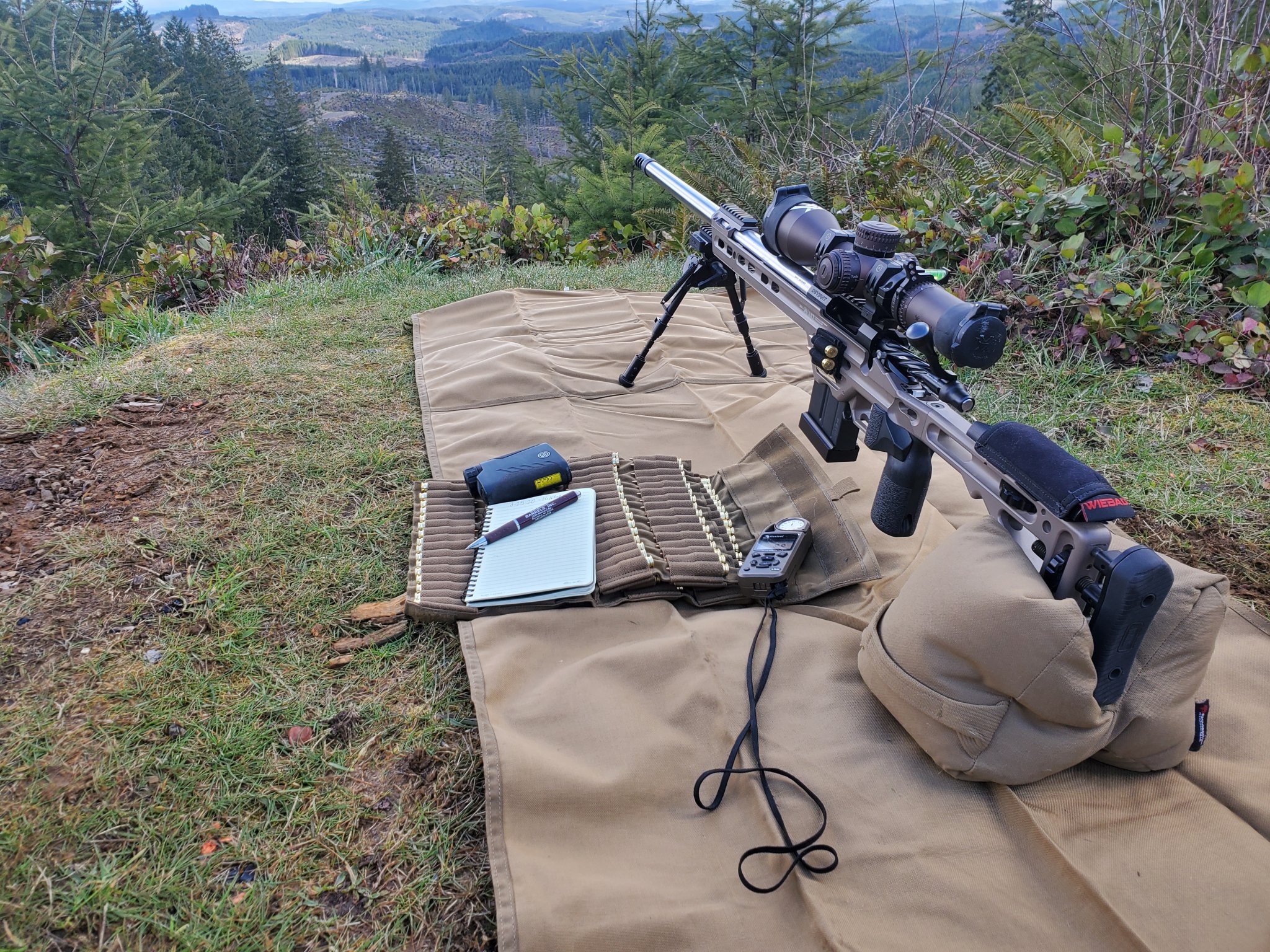

I was shooting this spot in Western Oregon yesterday. Where I was shooting from it was dead calm, yet I was still holding about 1.2-1.5 mils to get impacts.
Shooting down across several canyons from high up makes it even harder to tell what the wind is actually doing.
That's when making an educated guess and spotting that first shot becomes really important.
