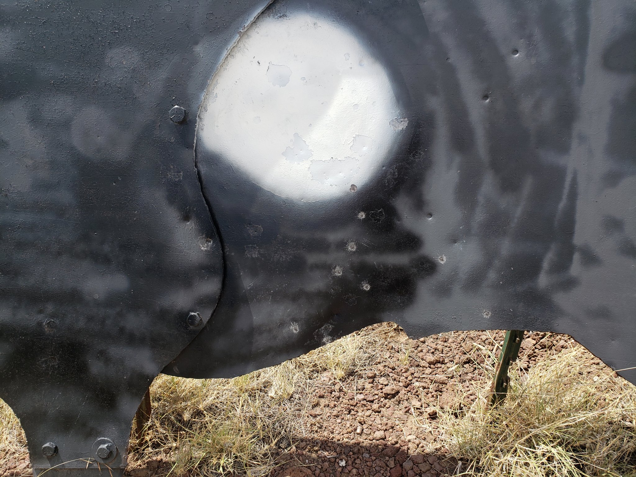

Just thought I'd put this in here for fun, and OT a bit, but I have a pcp air rifle that competes very well with my Anschutz 22rf at distance. It sends a 60gr, .245 G1BC, 25 cal, lathe turned pure lead boat tail bullet/slug at 862 fps with ES of 10 and is superior to 22rf in the wind. Wow, right?! However its not sub MOA at 100Y, more like just over MOA, and not built anywhere close to a Vudoo or Anschutz, etc in qaulity.
I did this very unoffcial test with it on a windy day at 421Y, 12 shots and 12 hits using a 3 MIL holdoff. I couldn't see where I was hitting but could hear the thwack on steel so was obviously hitting low. Also a wobbly, goofy, bench was used. This was just for a fun first try and I think it could be improved upon a lot.
The white circle is around 11" in size. Hey look a nick on the dick, I meant to do that, JK, lol ;) :D
Not too bad for a BB gun.

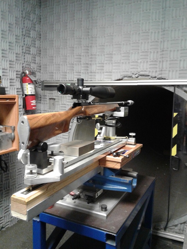

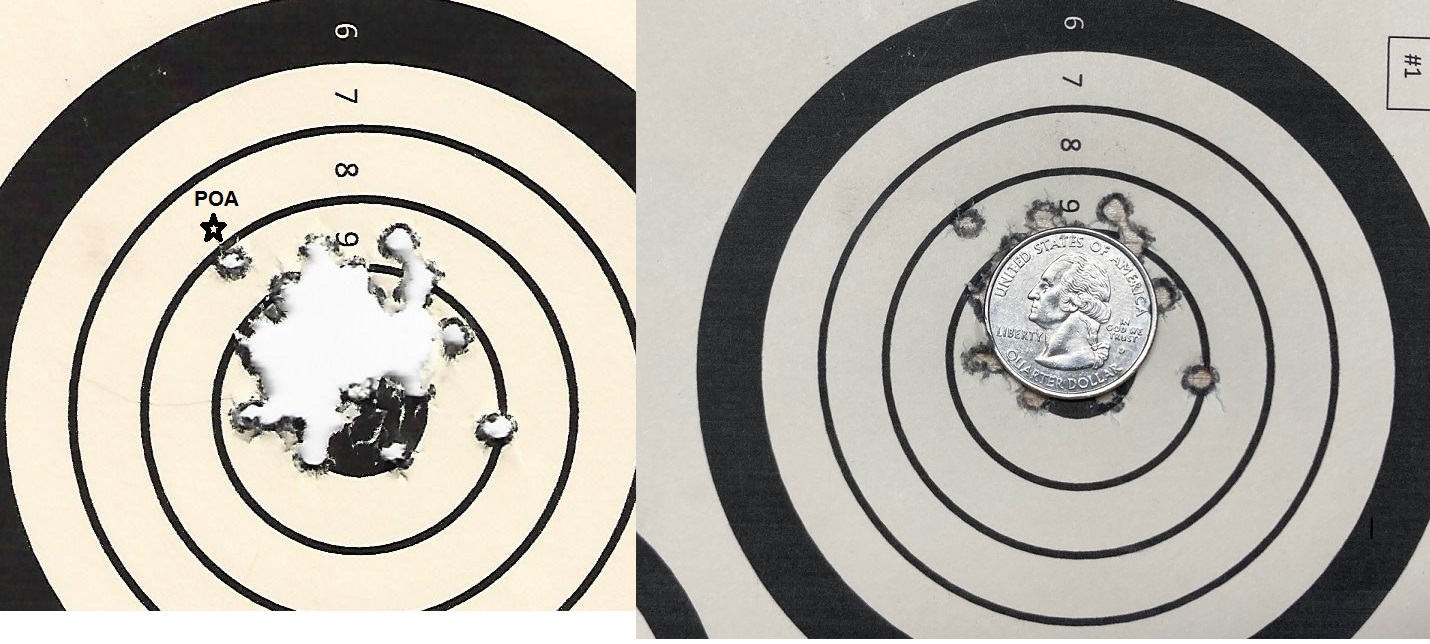

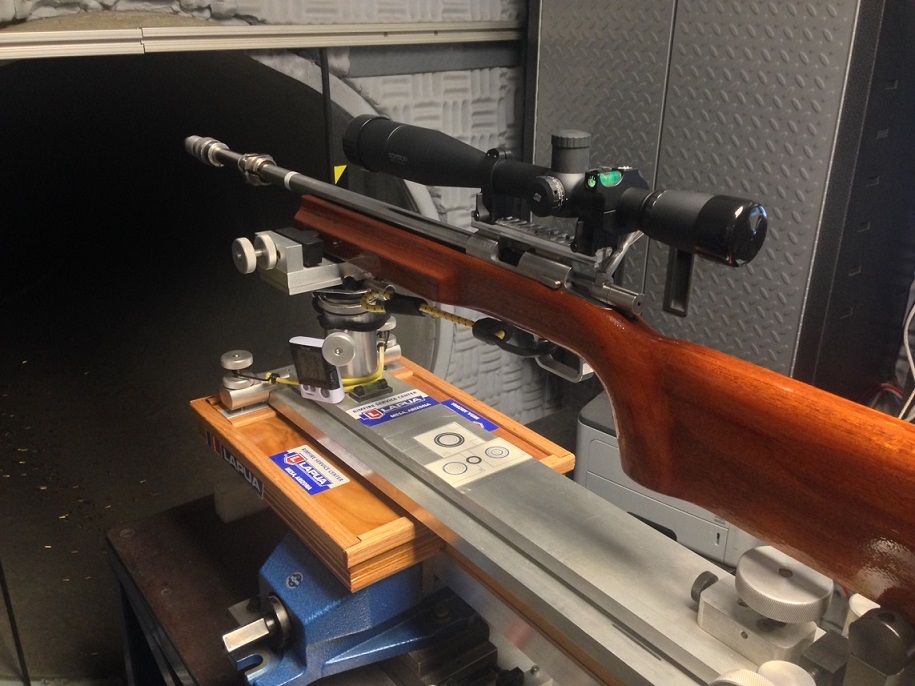

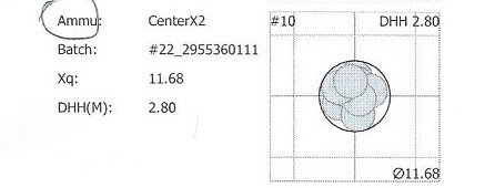

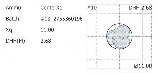

Here you go! just as it was when I found that lot of Cx1117 getting ready at Lapua's Mesa center and the test results. rifle is a 1st Gen Baity Falcon. the barrel in the picture shot that 20-shot group a new BM 3G barrel shot the two 5-shot groups with the CX 1962 & 1117 but this is not my dream rifle.
a 1965 1411 Anschutz Match 54 is what could be called my sexy rifle that CX 1962 lot did a 11mm group at the center. the same rifle shot this 50-shot group at 100 yds. with a lot CX 1913 first time shot in the rifle.
Lee
  • Falcon getting ready for testing, Benchmark .900 3G with ultra lite tuner and Scotts mid-barre...JPG
  • Love
Reactions: lash and steve123
