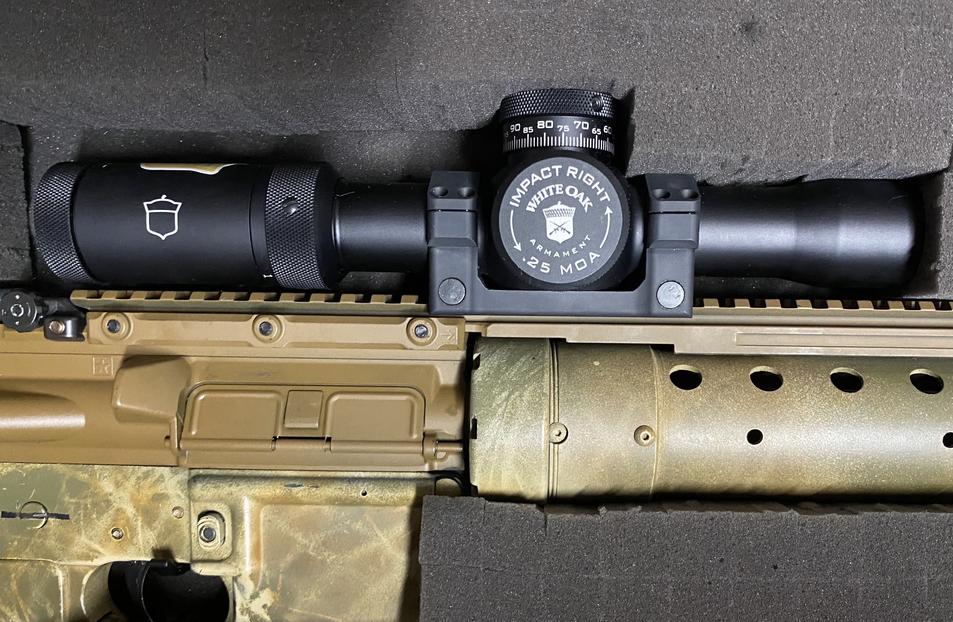

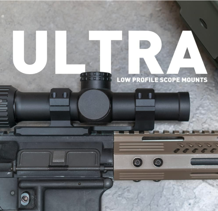

Some time back I bought a Monstrum / Amazon mount to try, proof of concept kind of thing. Better to spend $30 to find out it doesn't work than $200.
When I got it I was actually surprised with the quality. Moderately okay? At least the machining anyway. The screws on the other hand are crap and sort of roughly the right size for the tapped holes. I'm using it in a non traditional way on a rifle with decent recoil, so I have no faith in it holding up. I need zero MOA because I'm actually using it backwards, to set the scope rearward.
So I'm wondering if there's anything out of of GOOD quality, that's equally as low. Anyone know of anything off hand?
that's gonna be tough to find, cantilevers are generally made to be 1.5" scope height from rail because that's the minimum height you need to actually see through the scope.

As someone mentioned, look at NRA high power/CMP service rifle stuff.

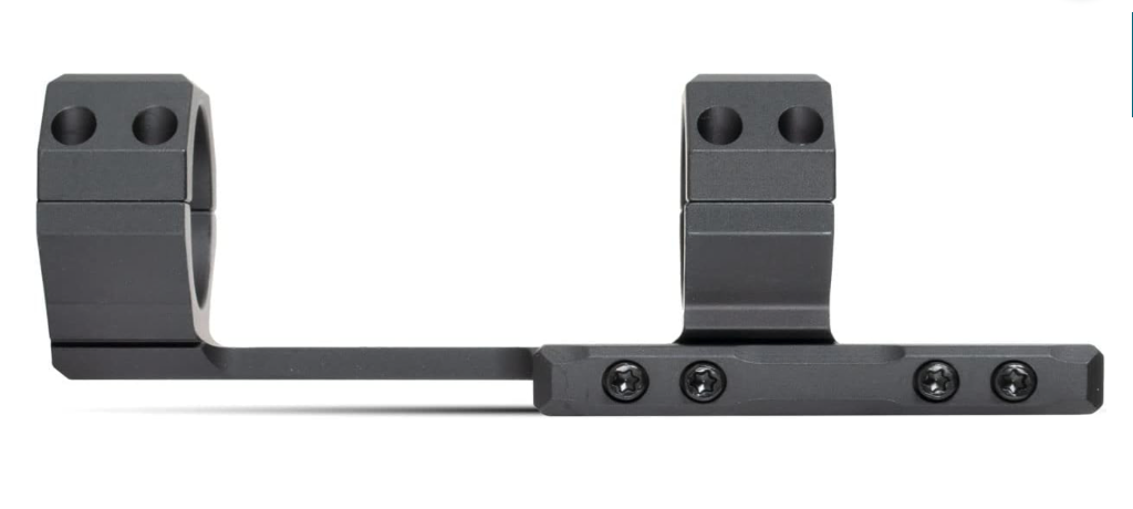

Warne has a 1.43” cantilever mount.
Geissele has a 1.30” cantilever mount.
I have one of these and it's a PITA, most of my scopes won't fit as the turret housing will hit the base before the tube sits in the lower ring halves.
