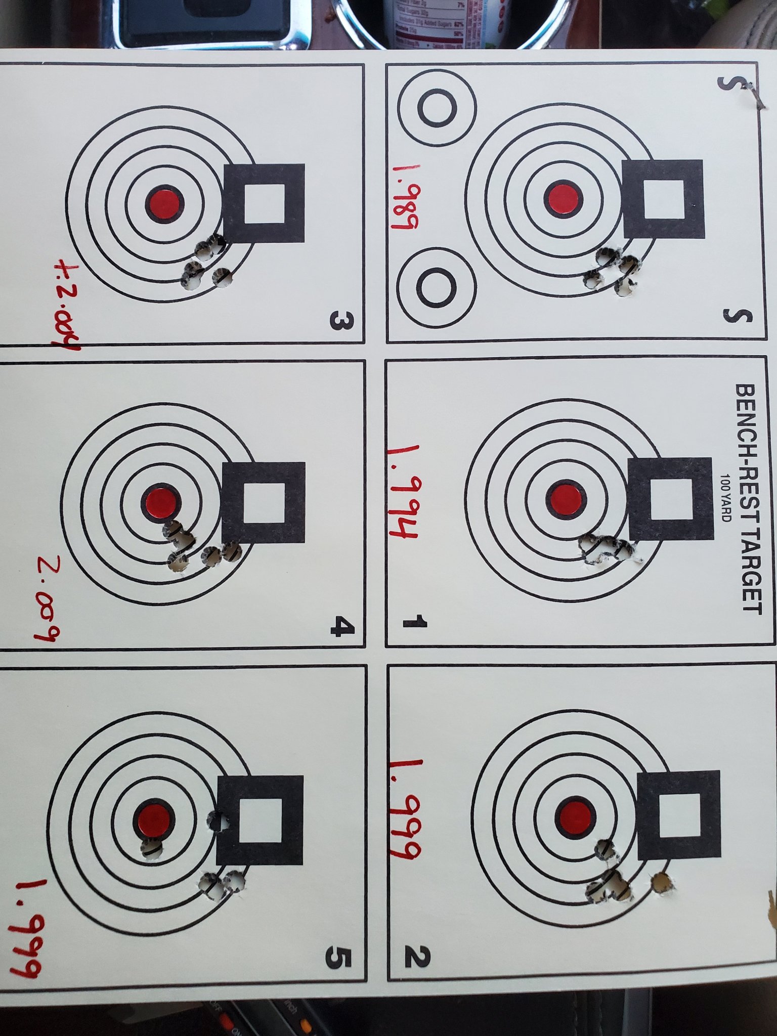

This is what a seating depth test looks like when I'm fighting the rear bag.
There's very obvious vertical stringing and grouping in different spots.
