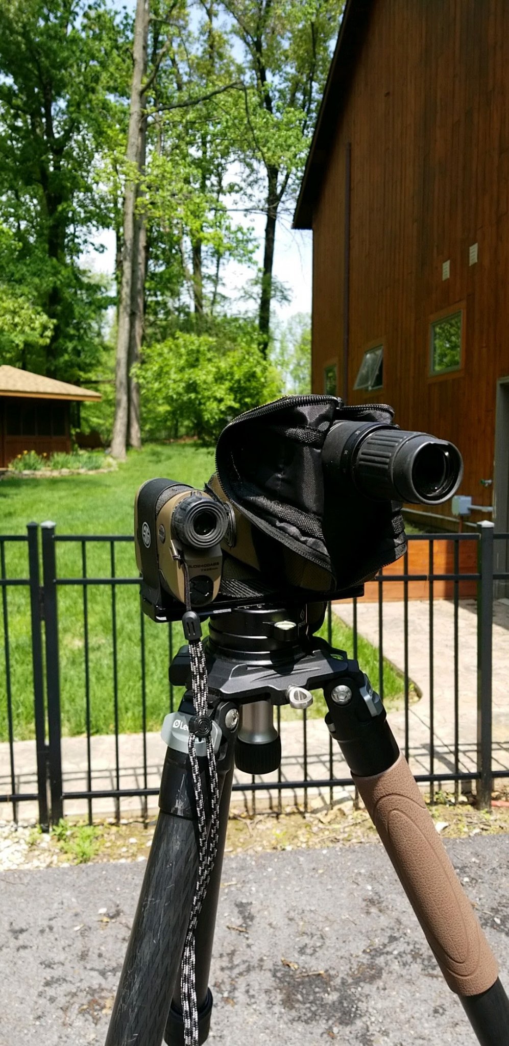

Aluminum plate with some holes drilled and tapped. Generic arca swiss rail.......
Reactions: K80/6.5
