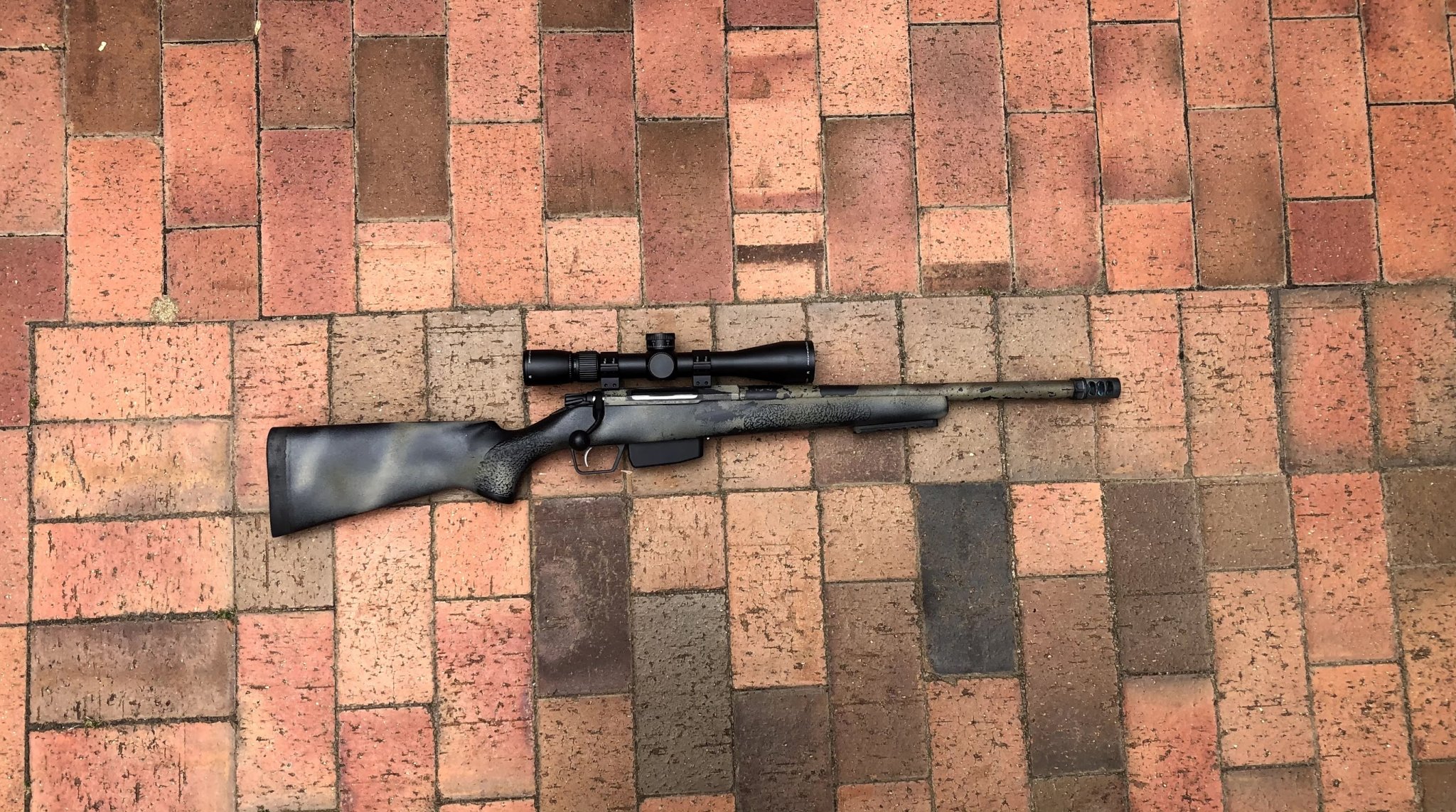

I bought a T3 for $400, cannibalized the action, sold the stock, BM, and mag for $120, barrel is still in my safe. Guy that sold it already put the Yo Dave trigger in it. $280 for one of the best production actions that has a unique look, has a wide availability of shouldered prefits(indication of quality of production?), and a trigger that beats a $400 AI trigger. Not really sure how you beat that...

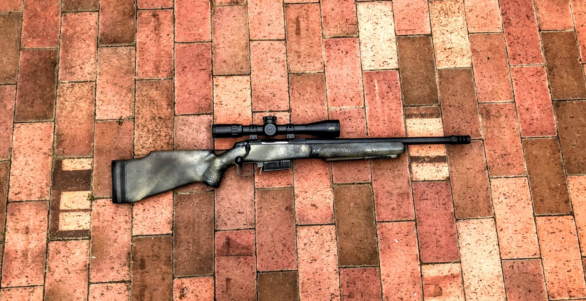

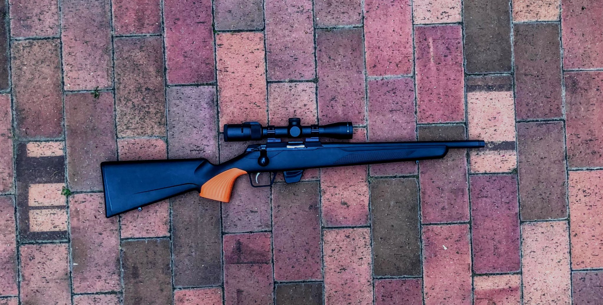

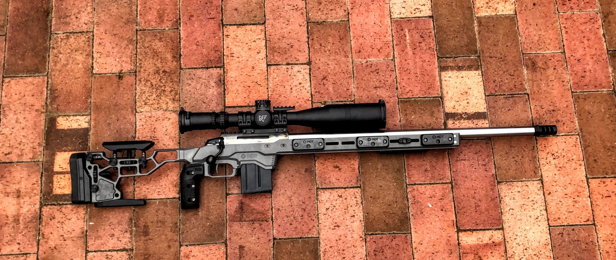

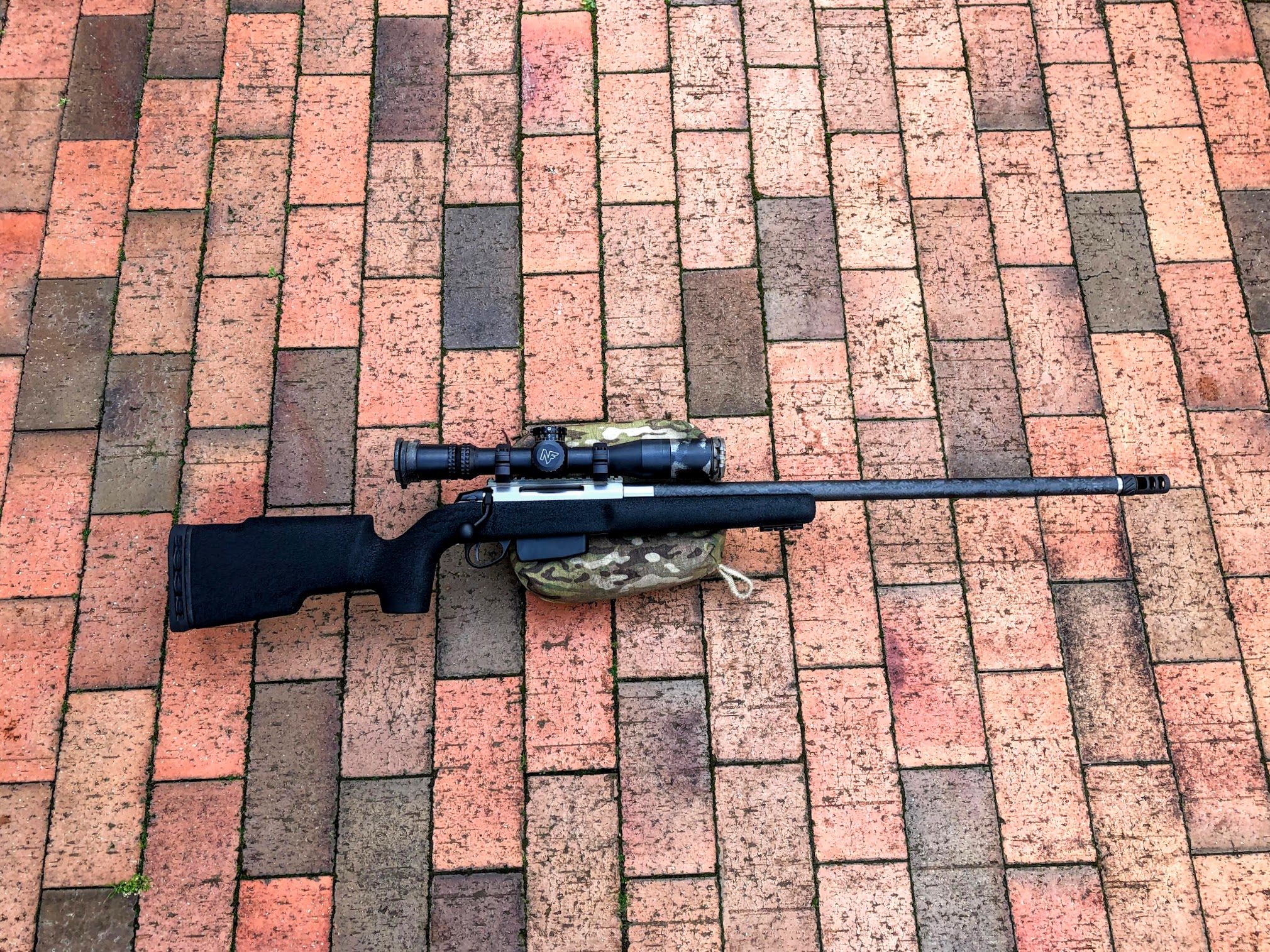

I have a Surgeon action so I'm well positioned to say conclusively that Tikka's suck ;)
