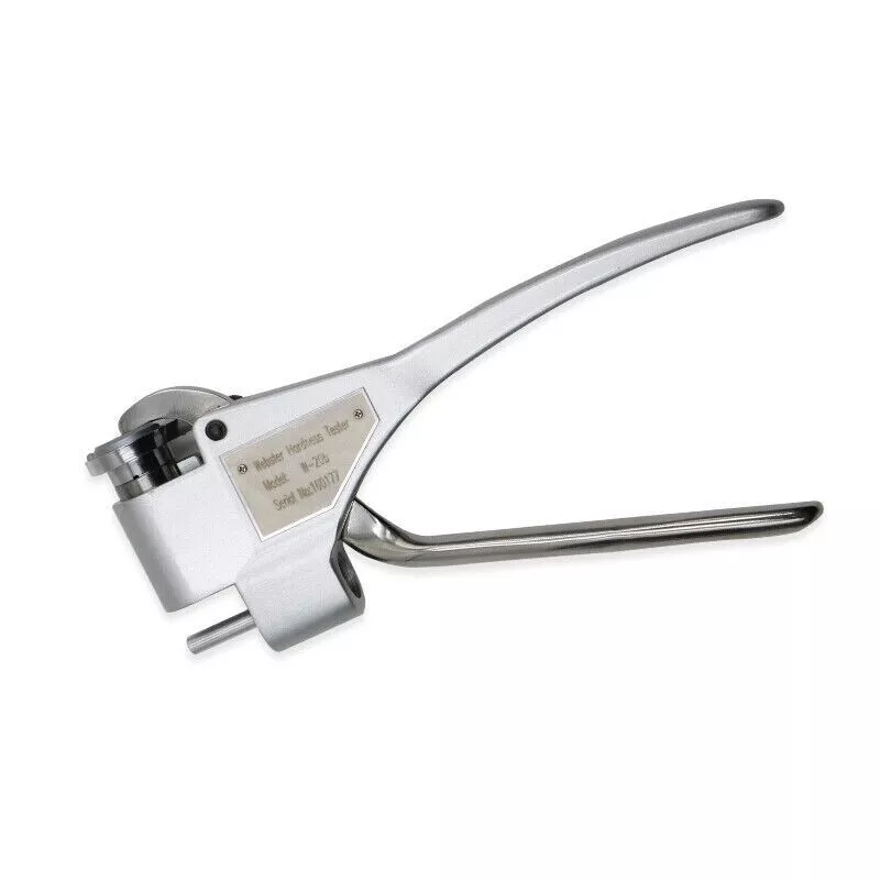

there is a device that can check hardness of brass '' W-20A Webster Hardness Tester for Aluminum Alloy Metal Durometer'' i have never used one my self
