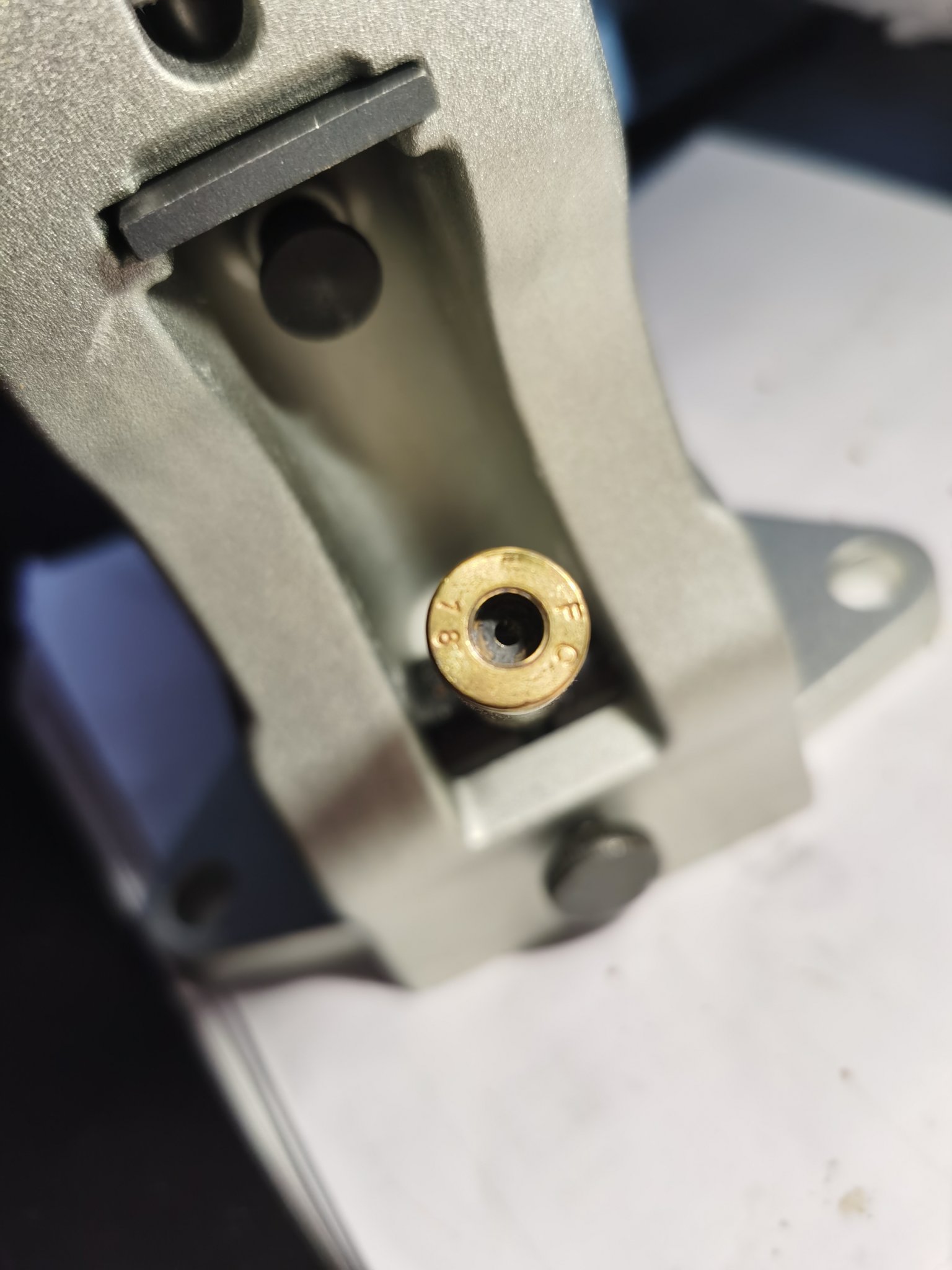

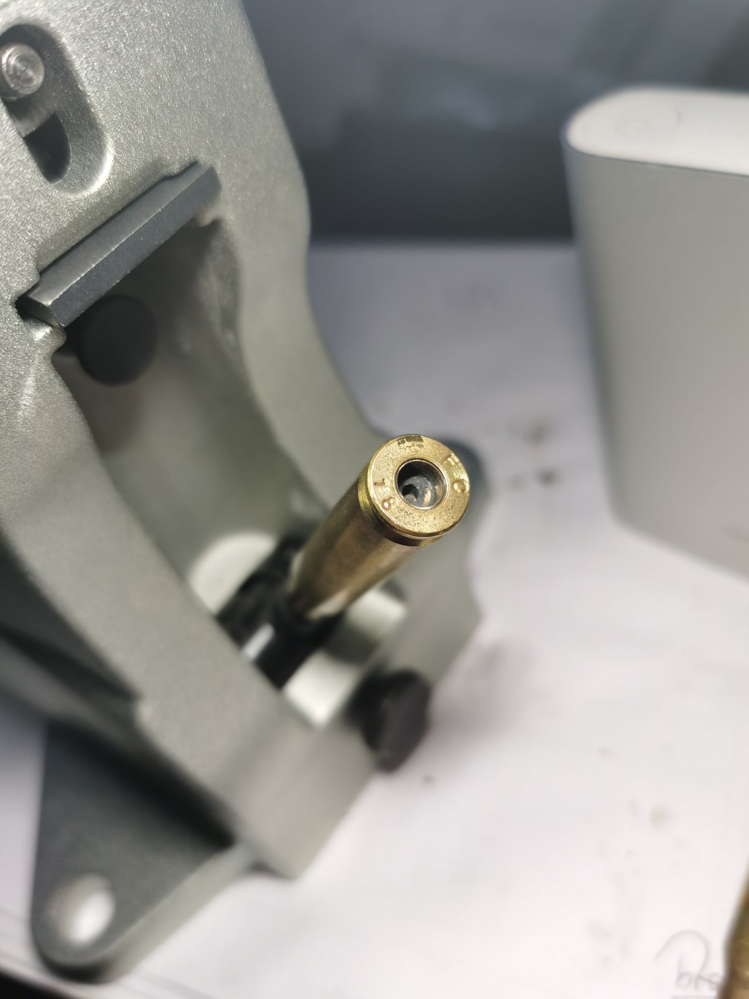

Tried to use the Frankford Primer Pocket Swagger tool to decrimp some Lake City 7.62NATO brass after decapping it.
Not much information online on how to set up and properly use the swagger tool. And tried a few brass, found out there is not much difference comparing to the brass which haven't been decrimped using the swagger tool.
Wondering if this looks like decrimped to you? Same brass, just different angle.
Thank you.
What I do, set the swager too the minimum, swager one try a prime. If needed set a little deeper and try again. I don't like to swager any more than needed.
No, I haven't tried to seat a primer yet.
From what I can see, it does not seem the swager pin have done anything particular or not enough to the crimp. This is the larger pin it comes with, the smaller one I believe it is for 223.
If I push too hard, the pin will stuck inside the primer pocket, gonna need a screw driver to separate the pin within the brass. A couple of videos I found on youtube, seems pretty easy on the crimp. Unfortunately neither has a closer look.

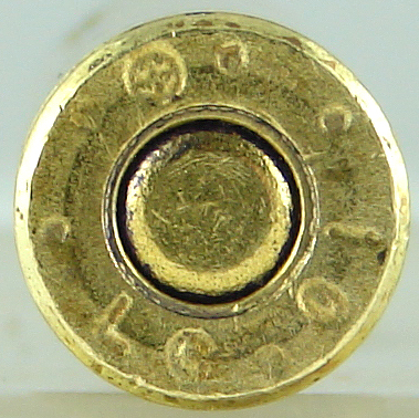

A factory loaded round . . .

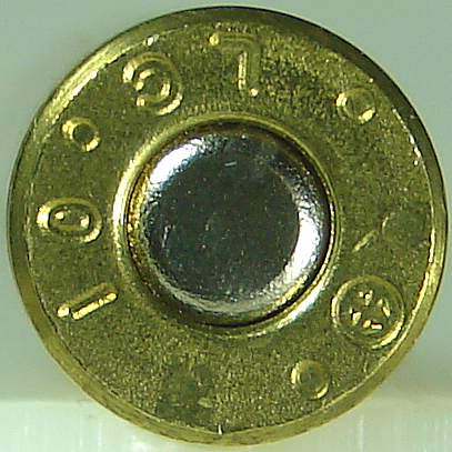

De-primed case . . .

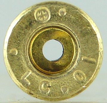

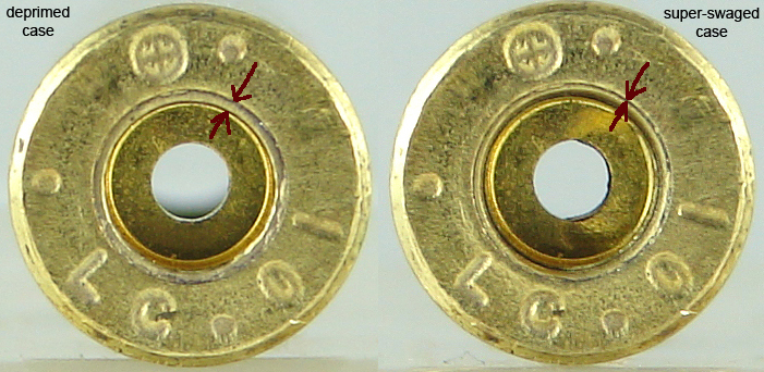

A properly swaged primer crimp using a Dillon Super Swage . . .

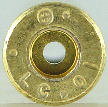

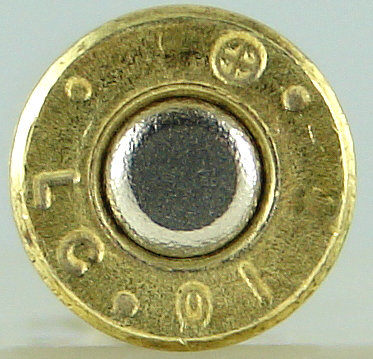

A re-primed case after swaging the primer crimp . . .
Thank you for the photos.
Maybe it's my eyes, but I really can't tell there is any obvious difference between the de-primed one (left) and the swaged primer crimp one(right).
View attachment 7537502View attachment 7537510
If I measure using a caliper, would I expect noticeable difference?

There's a significant difference between the two. Look at the distance between the red arrows in the same pics placed side-by-side below.

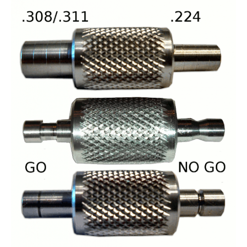

You usually can't tell if a pocket is swaged enough with your eye...until you ruin it.
I got a set of these primer pocket gauges, no guess work.
Thank you.
This would be some tools good to have, save a lot of time to guess.
Wonder when you use the Dillon Super Swage, do you always see the crimp pulled out of the primer pocket like a broken ring? Or the super swage just push the crimp to the side of the primer pocket, make it thinner enough to seat the primer?
If you look at the shape of the swage tip and the shape of a crimped pocket you should be able to tell. A crimped pocket will have a sharp step. Once swaged the tip is pushing that step out and back almost into a funnel shape

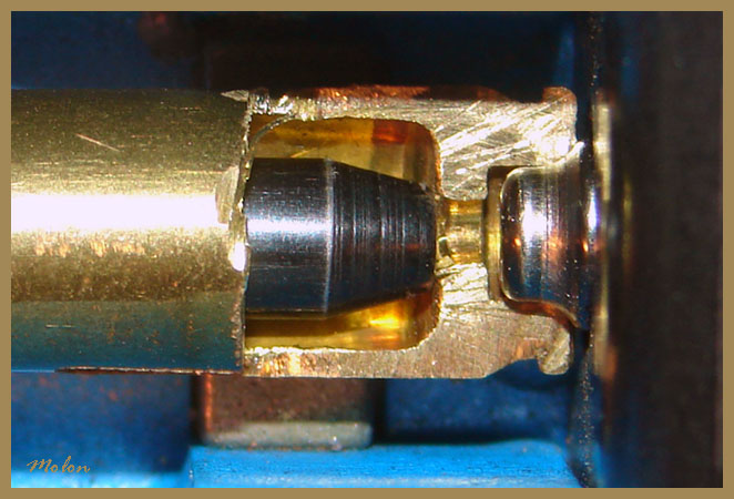

The Dillon Super Swage presses the crimped material away from the inside of the primer pocket and recreates that radius at the mouth of the primer pocket. The pic below shows a cut-away 223 Remington case in the Super Swage allowing you to see how the swaging rod works.
I'm liking the AmmoBrass Swage Setter so far for the convenience. Gives the same info as the piece of cutaway brass minus having to make it.
Bought my set from Dillon a month or two ago to avoid the wait.
Interesting idea! Gonna have to make one of those...

You stated yourself u can’t seat a primer so obviously it’s not decrimped. I’d recommend u order those ballistic tool go and no-go guage it makes it simple for you to check wether you Swaged enough or not.
