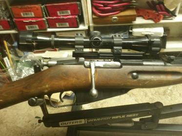

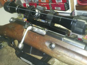

1930 hex / I've got the Bushnell 10x mil/mil on mine (stole it off the CZ .22 as it dosn't focus at 50yds) + ATI mount
Usually wears an old 4x that looks traditional (pic below)on it. -
