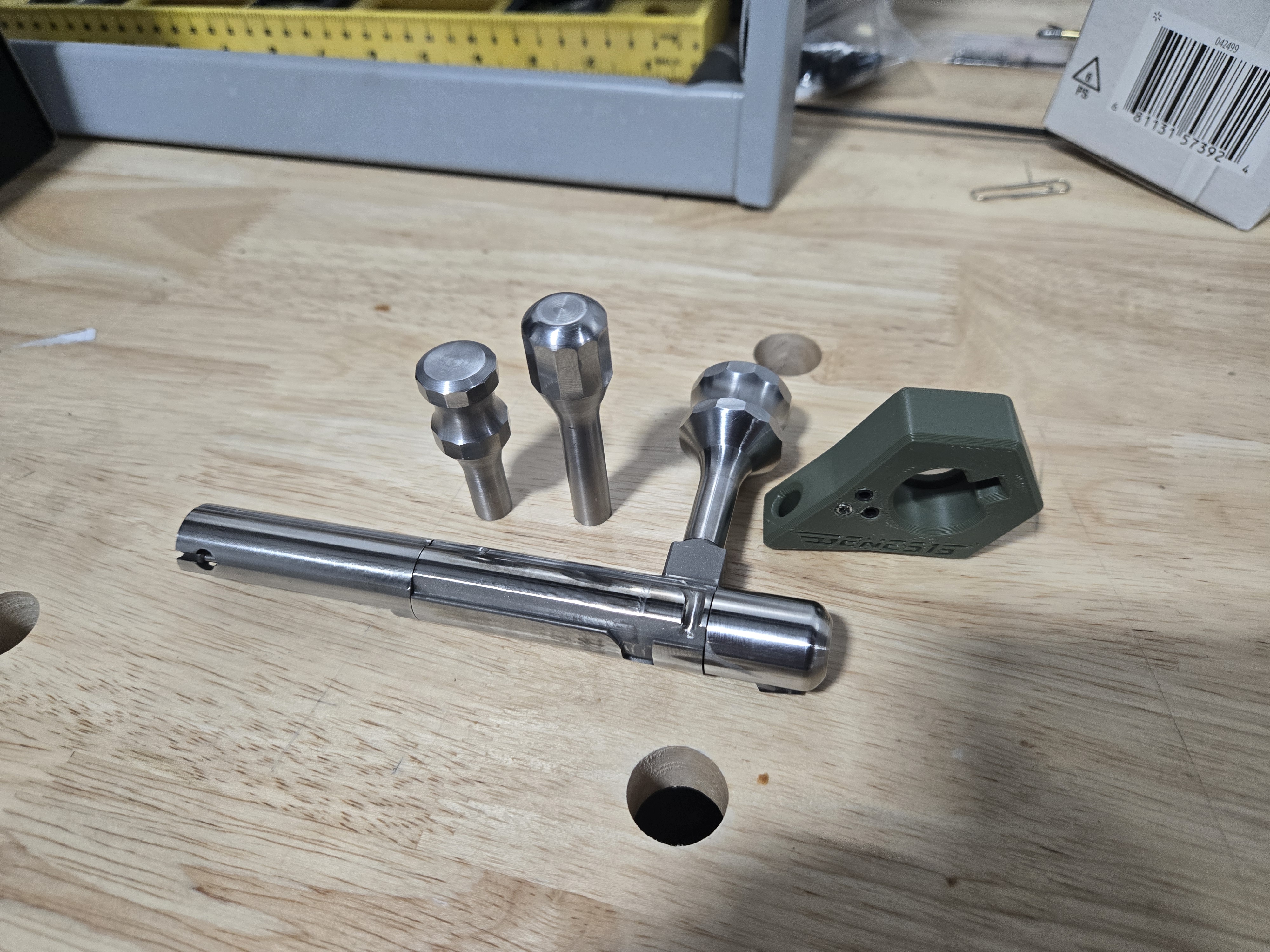

their is a unique feature on the bottom of the action if you look at post #147 that will allow a single shot adapter to fill the magwell port of the action. Also CZ457, T1X and Anchutz guys might benefit from it in the future "winky winky"

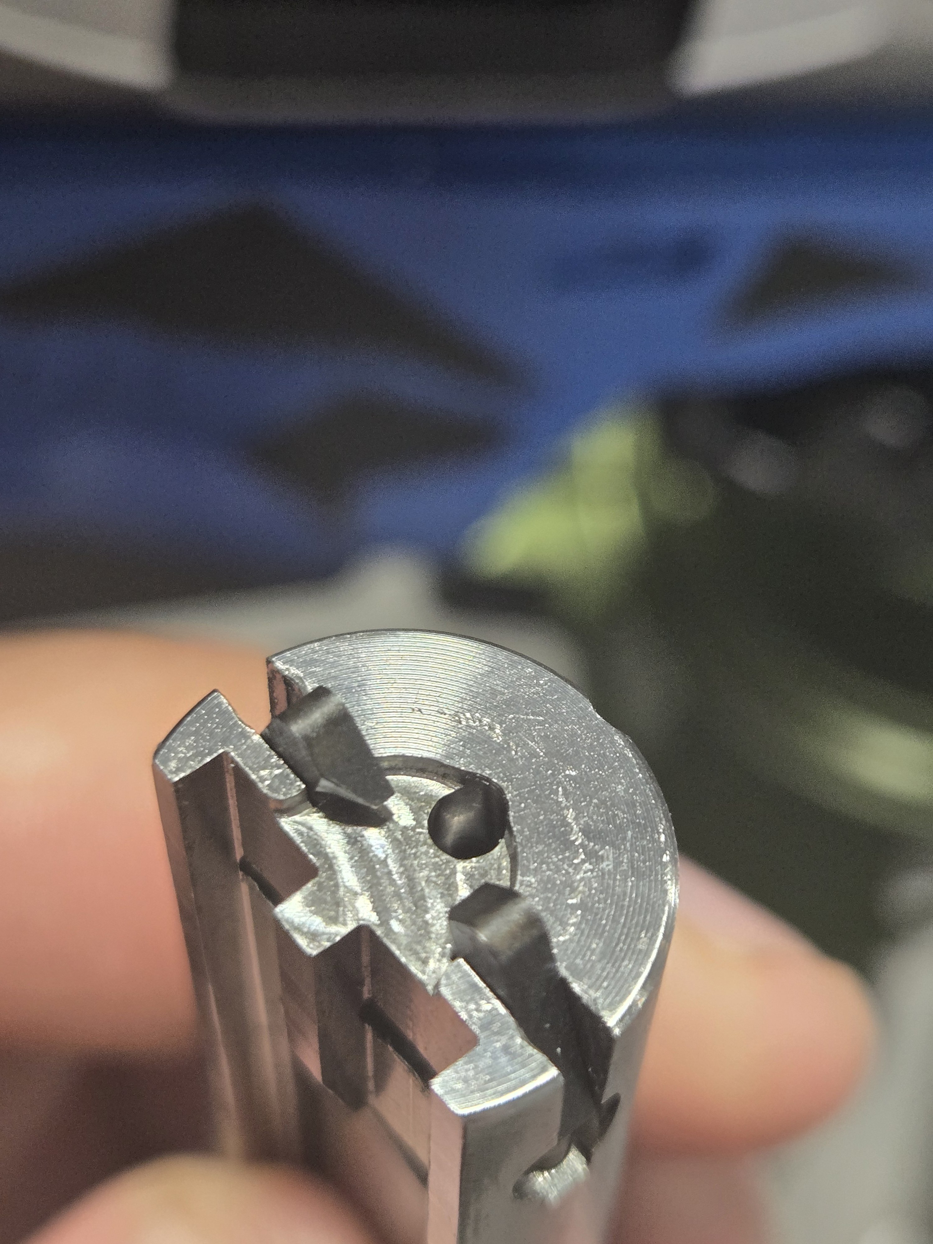

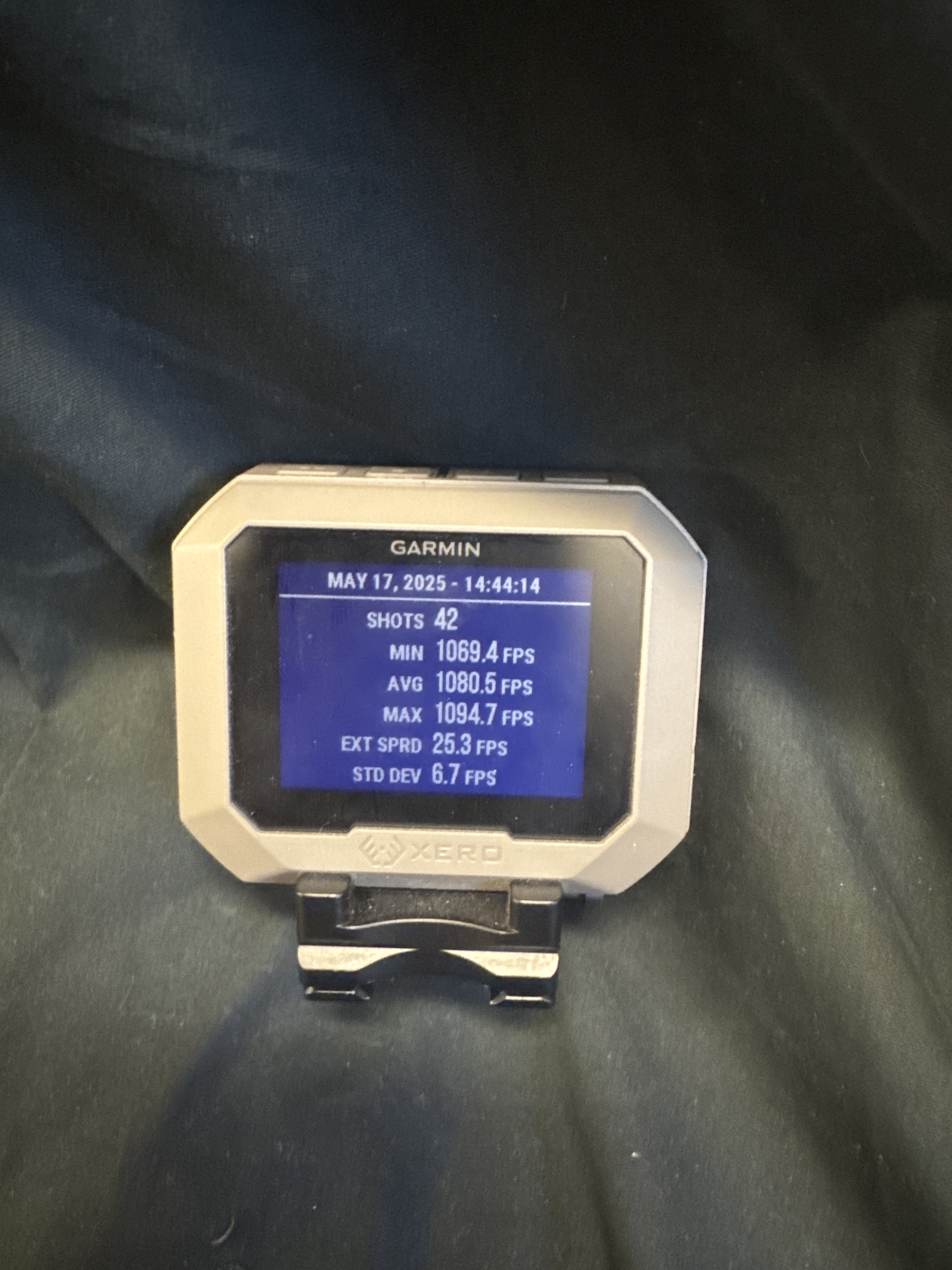

Just got my first batch of dual spring rate extractor springs and tested them this whole afternoon 500+ rounds. These will interchange with Gen 2 and 3 V22s also. It increases the extractor spring pressure while maintaining the same spring rate to control round feed reliable from the mag. Also found best angle cuts for my S7 extractors for this action. Very minimal force needed to send cases flying

Since it uses Mike Bushes extractor design and bolt head, it actually picks up and puts a round into the extractors without a barrel. As im understanding more, single stack mags allow for just one axial force vs a slant fed mag needing a heavier spring to over come two forces to allow rounds to feed into the extractor
