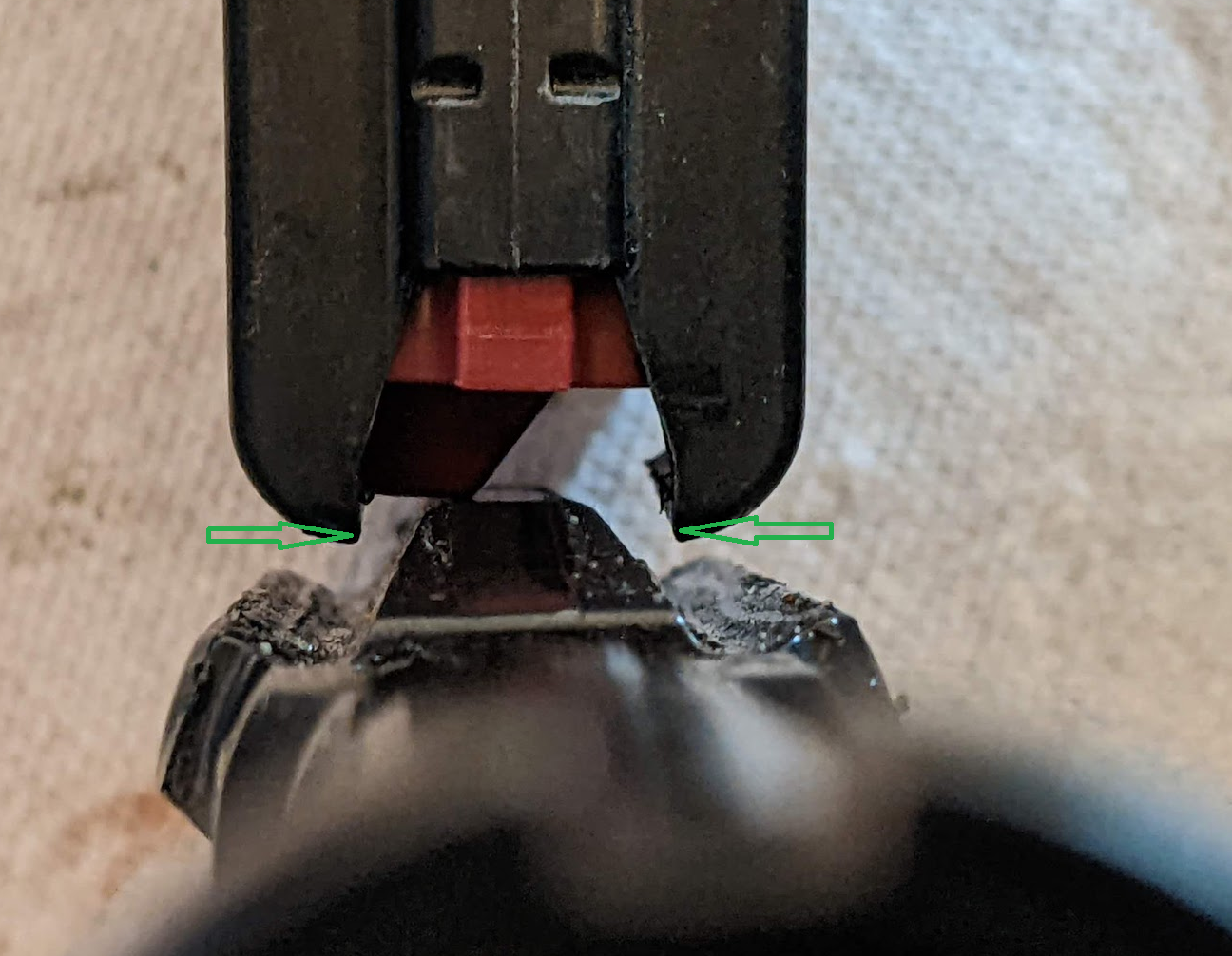

- Fig 1. Insert empty magazine, pull bolt to rear until the lug contacts the follower (don't pull all the way back until it catches on the bolt catch). Inspect to see that both side feed lips sit between the bolt lugs.

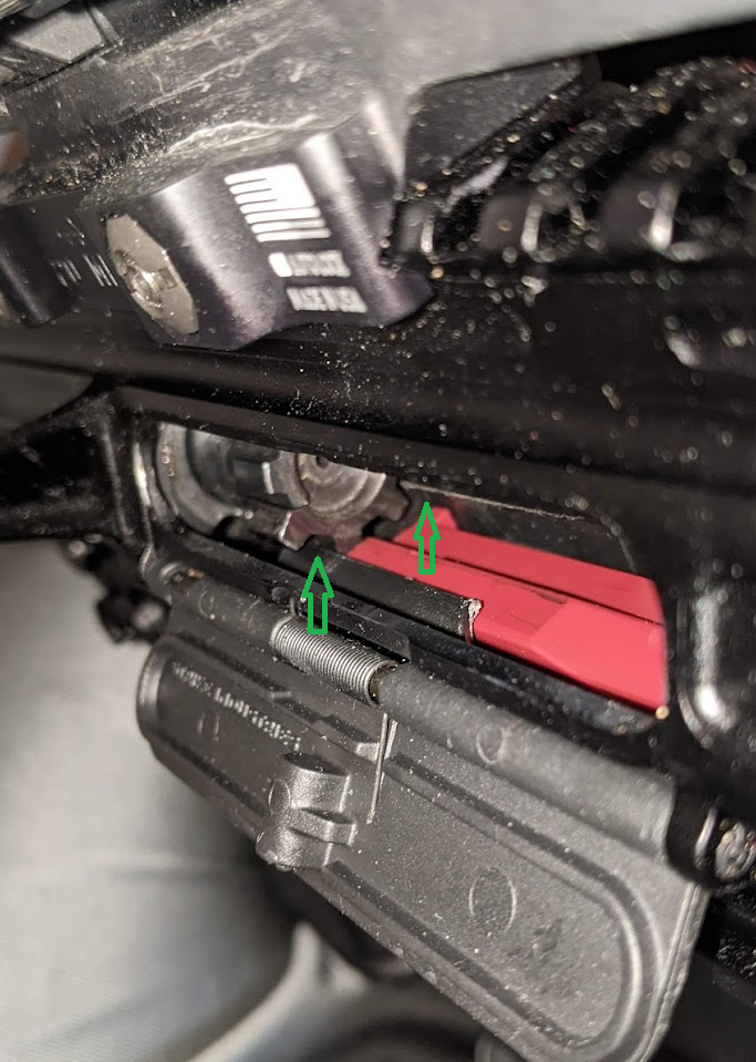

- Fig 2. Remove BCG from receiver, stand it vertically, place magazine under BCG. Ensure there is clearance between feed lip and bolt carrier ramp. Note - If the gap with the follower is very narrow, you may want to remove follower and sit the carrier in between the feed lips more to see if there is adequate clearance. In my example, more than adequate.
1. Feed lip gap too narrow or too wide causing dragging on bolt carrier hammer ramp area or bolt lugs, you'll see wear marks on the edges of feed lips - Solution bend feed lips if possible, if bending it would make the feed lips too tall, file the inner edges of the feed lip to remove some material. Rear feed lip gap should be roughly 0.570", front feed lip gap roughly 0.595".
2. Top portion of feed lips causing rubbing on bolt carrier or bolt lugs either due to excessive material length or improper feed lip radius/curvature. You'll see wear marks on the top of feed lips and the feed lip radius. Solution - bend feed lips if possible, otherwise file material off feed lips and bend. Procedure not recommended it'd be hard to get the correct radius. Better to return to manufacturer for warranty or refund.

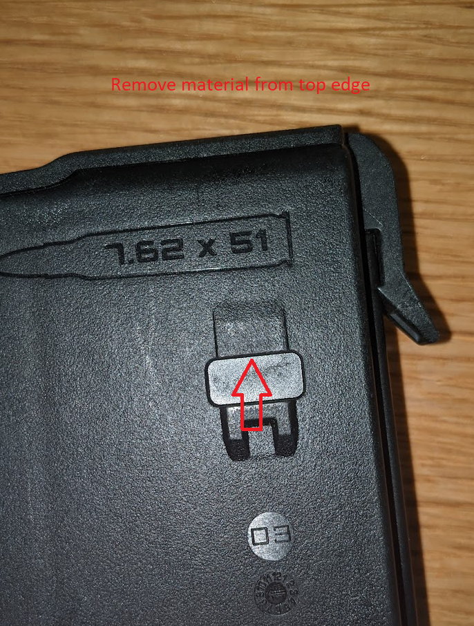

3. Nothing wrong with the feed lips length or geometry but the magazine's catch hole/recess for the catch is cut too low (causing magazine to require deeper insertion before it catches) relative to your lower receiver magazine catch position. You will see wear marks similar to #2. -File top edge of magazine catch hole/recess however you can have excessive vertical slop which can cause feed issues or other issues like failure to lock back on empty. Procedure not recommended. Better to return to manufacturer for warranty or refund.
Fig 1.
Fig 2.
Fig 3.
I'll definitely check those things. The mags are factory cerakoted, and there is visible wear marks on the edge of the feed lips. I've sent an e- mail to ASC to see what they say, but I have three of those mags, so I may play with one and see what happens.

Just finished filing the feed lips on one mag. Rear gap is .550", front gap is .570", now the mag seats and there is no drag on the bcg. Good call. Thanks. I think that's all they need.

I figured out my issues. First issue was fixed with a correct length buffer (2.5"), and the second issue was fixed by opening up the feed lip gap on my ASC mags.
