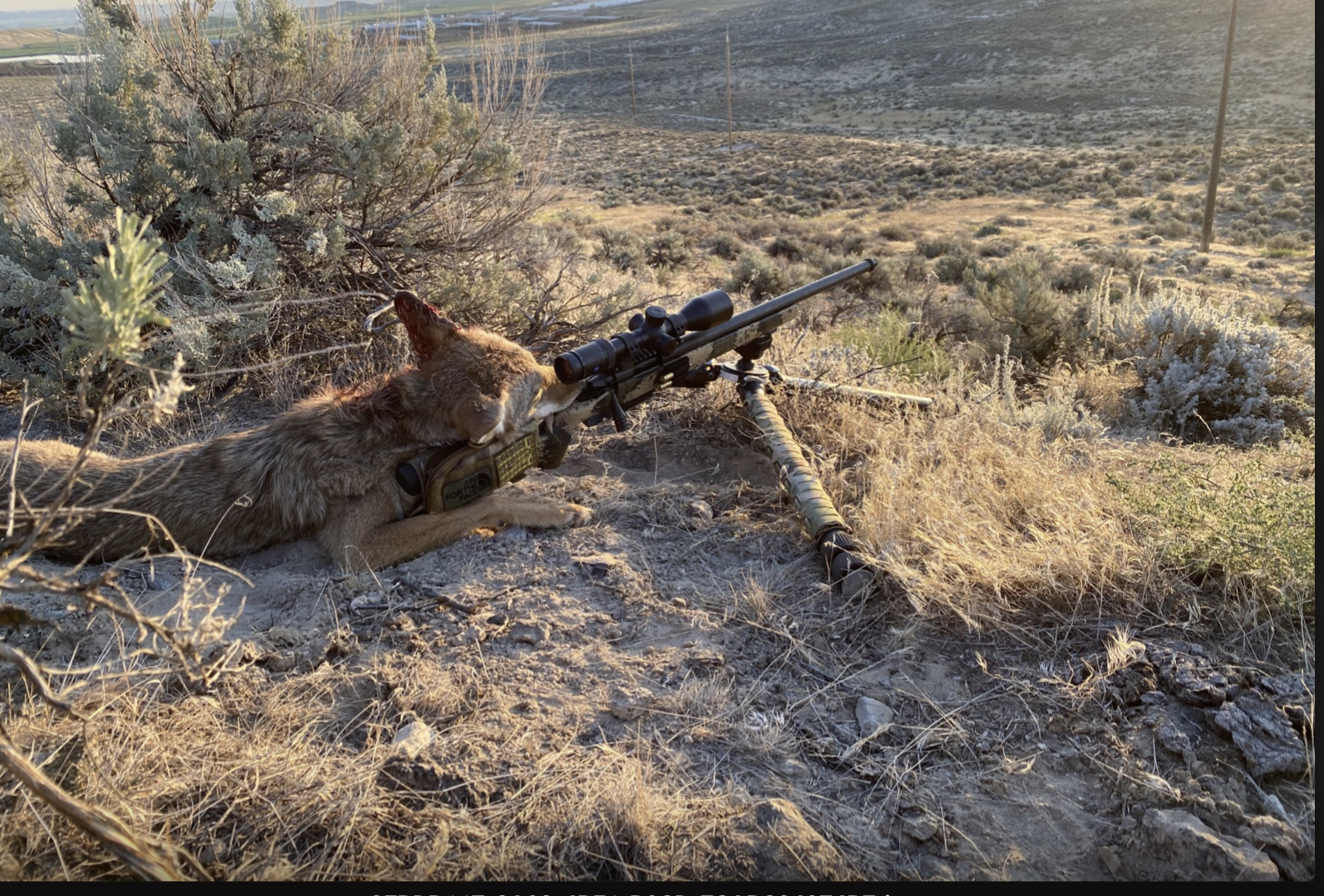

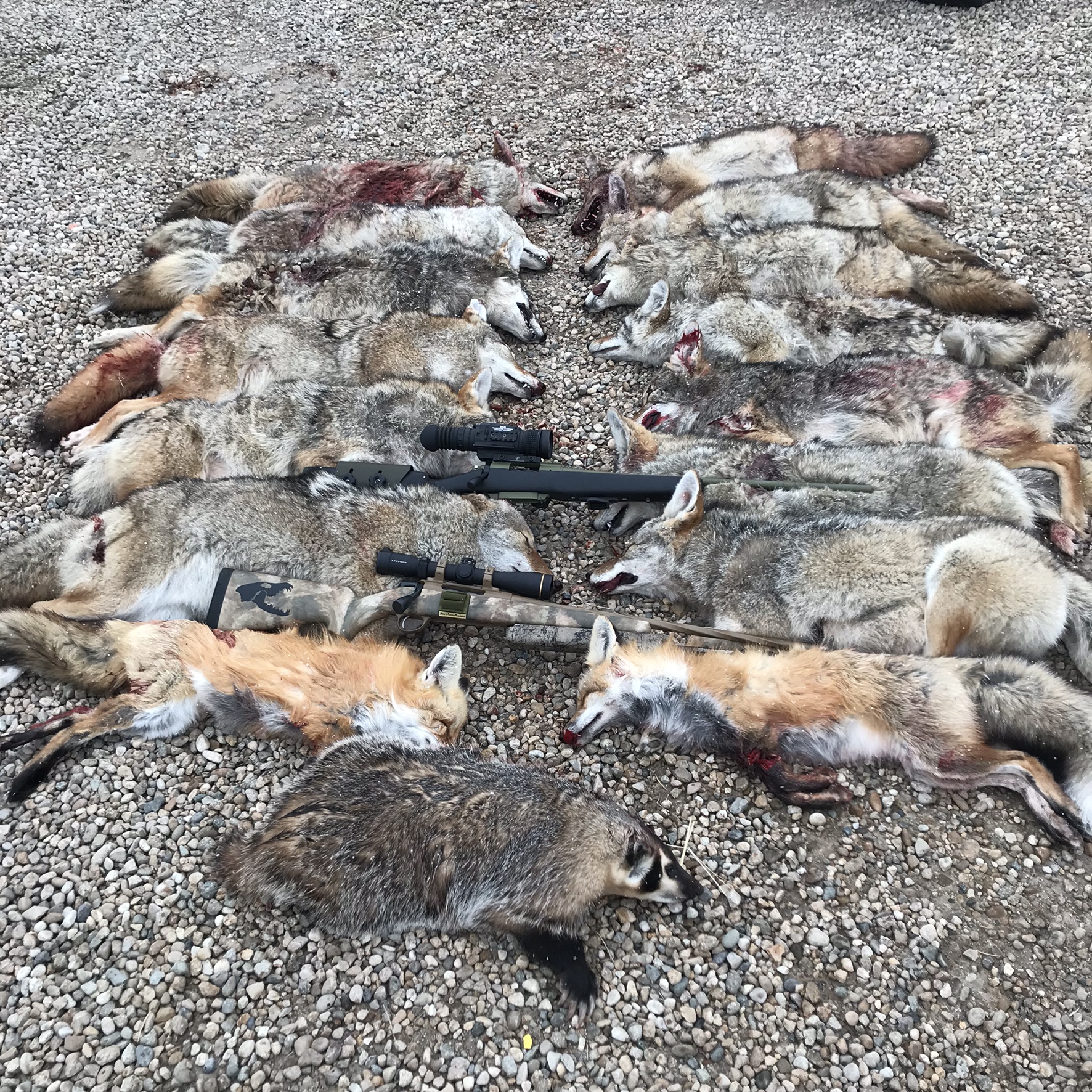

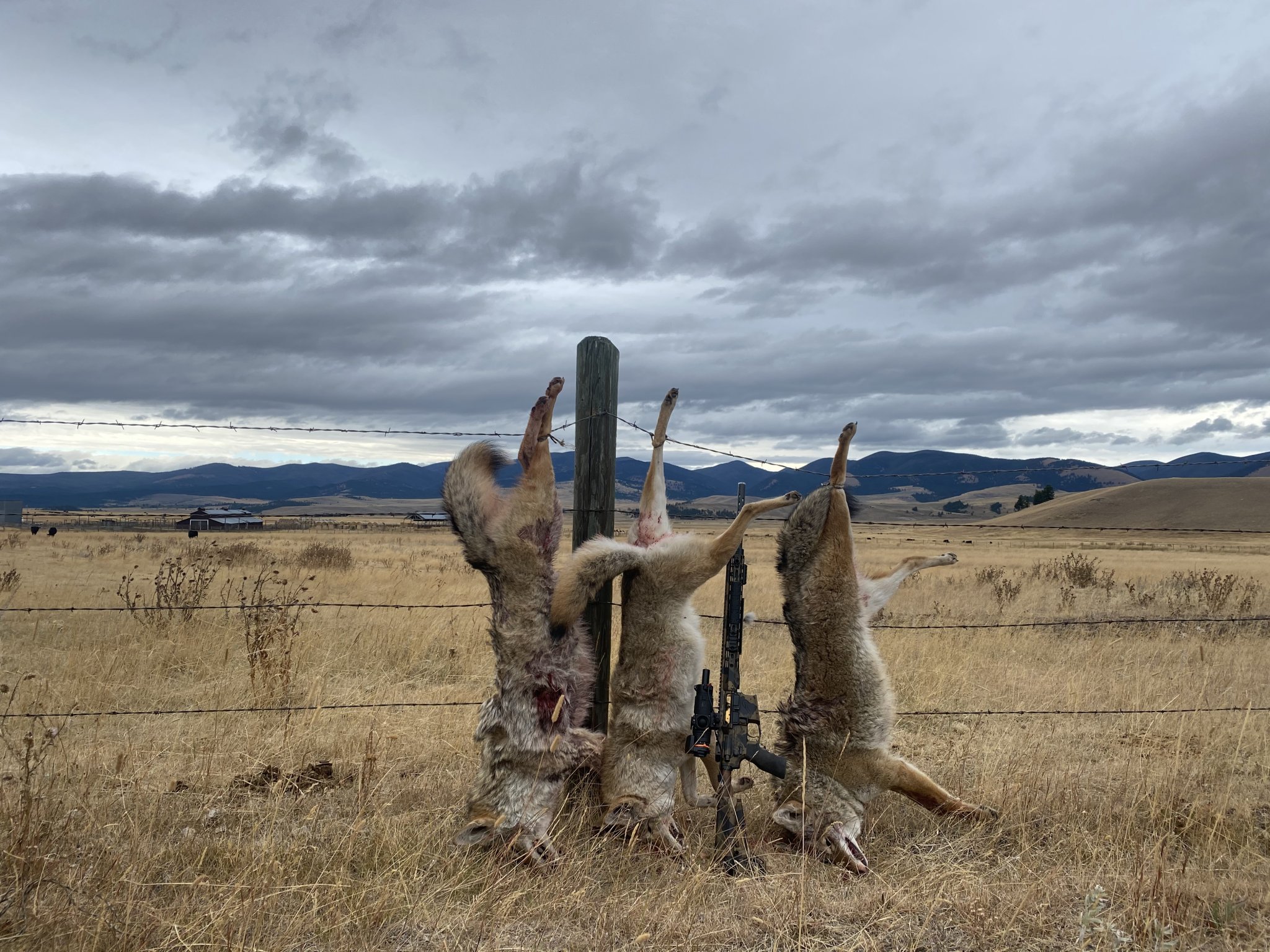

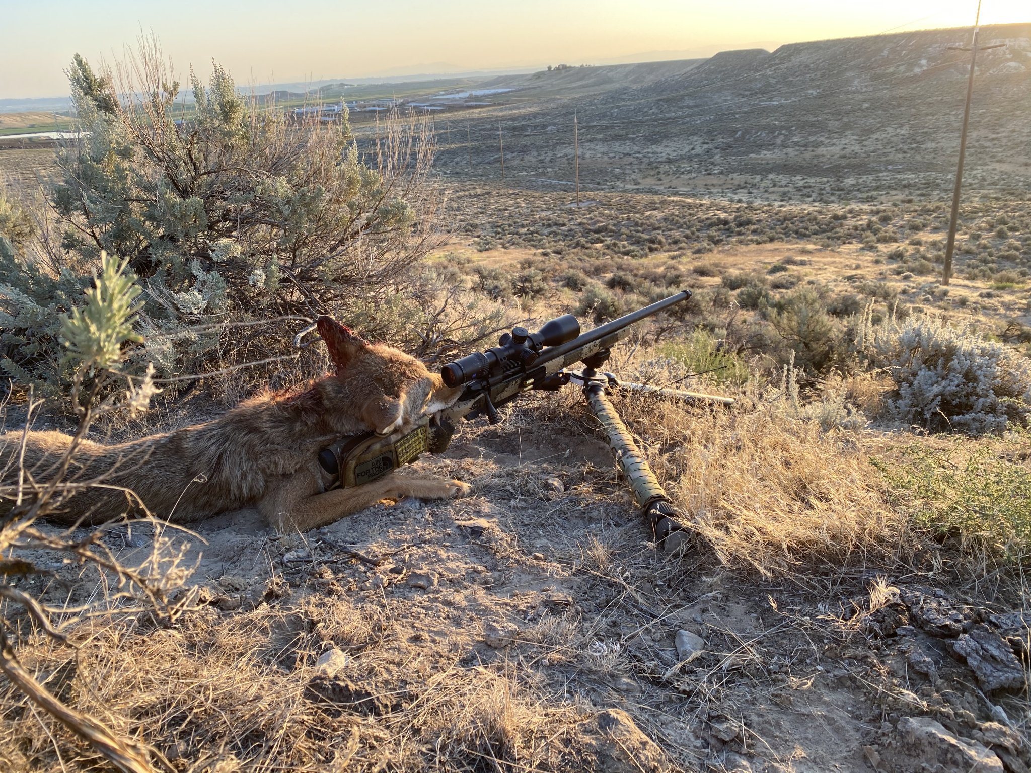

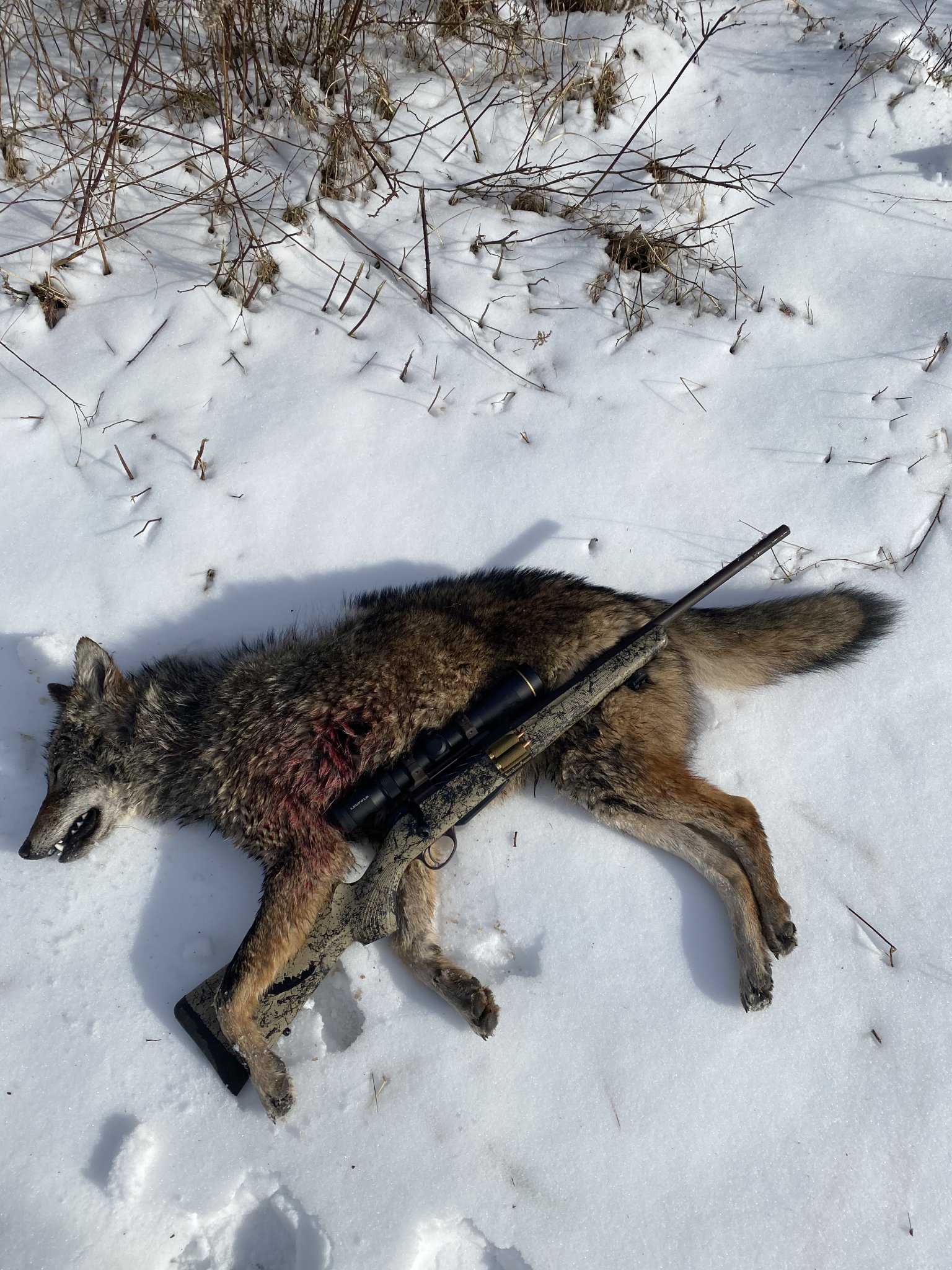

Oh I already have plenty (too many) coyote guns already lol 4 ar setups 223,204,6.5 Grendel, 22 nosler.. 2 tikkas in 243, 204, full custom proof carbon/ manners carbon 243, and a handful of remington 700s lol the short dta is definitely appealing especially for shooting out of the truck. definitely not lightweight though but I’m hoping a thinner or carbon barrel will thin it down a bit.
