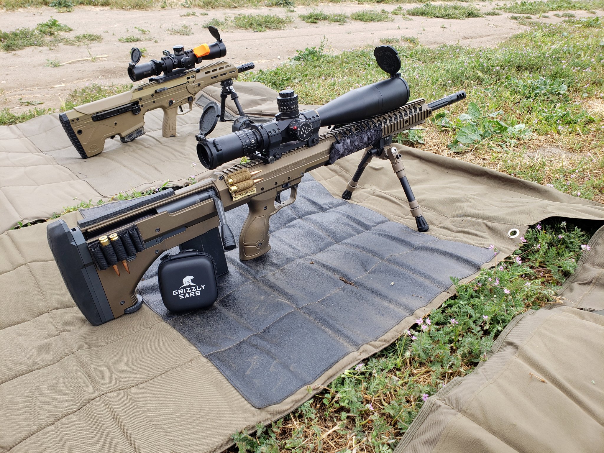

You mean this .. nope don't own a DT, nor a 6.5 Creedmoor nor use eldm... but look closely at the pictures, they might surprise you... just saying.. yes I have loads with the ELDM and all your questions, hence why I chimed in
