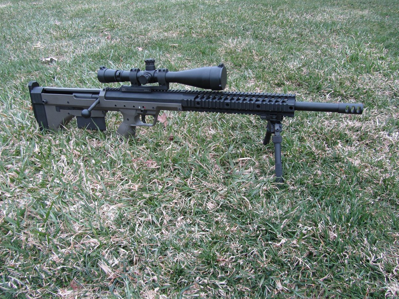

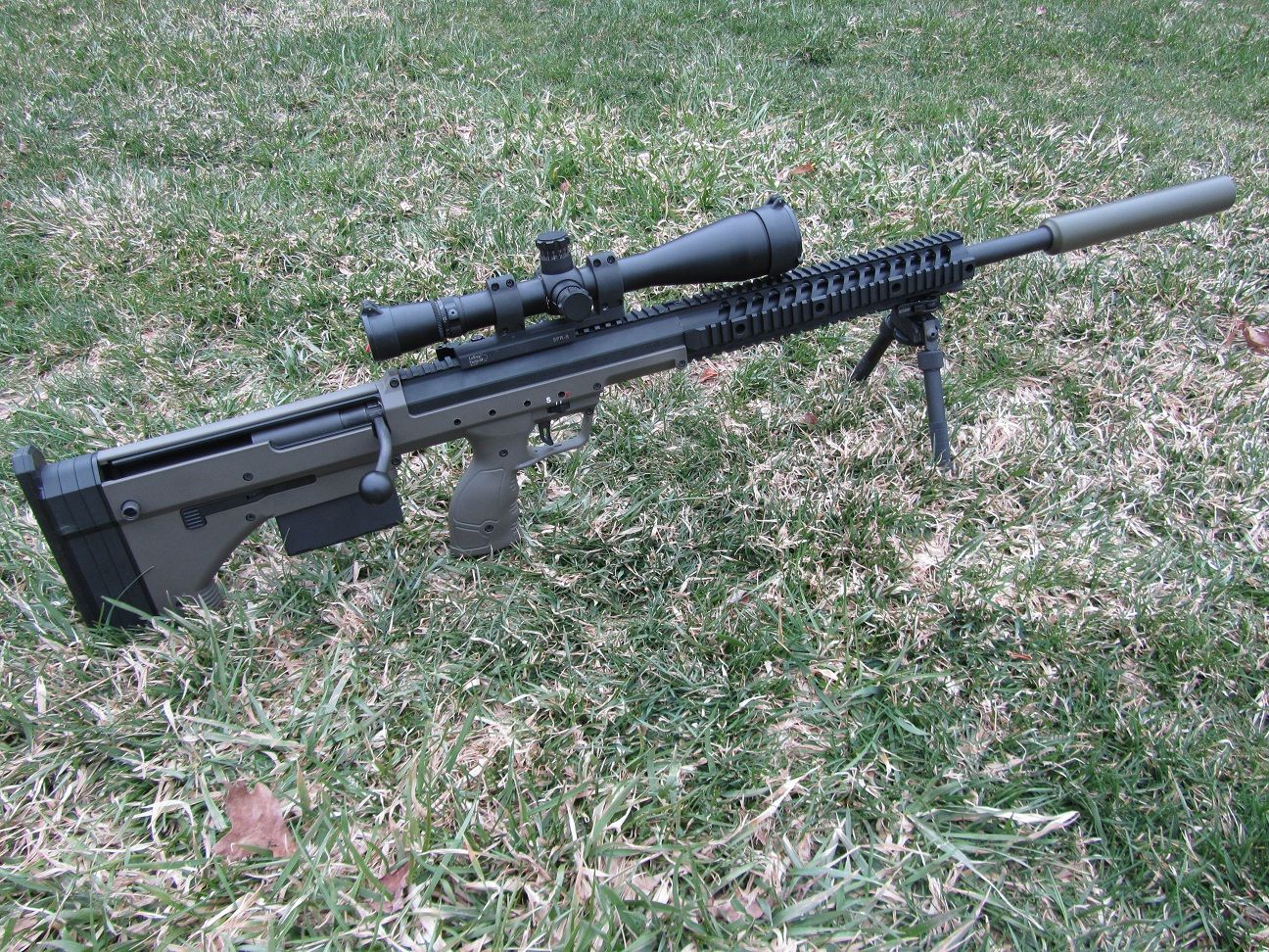

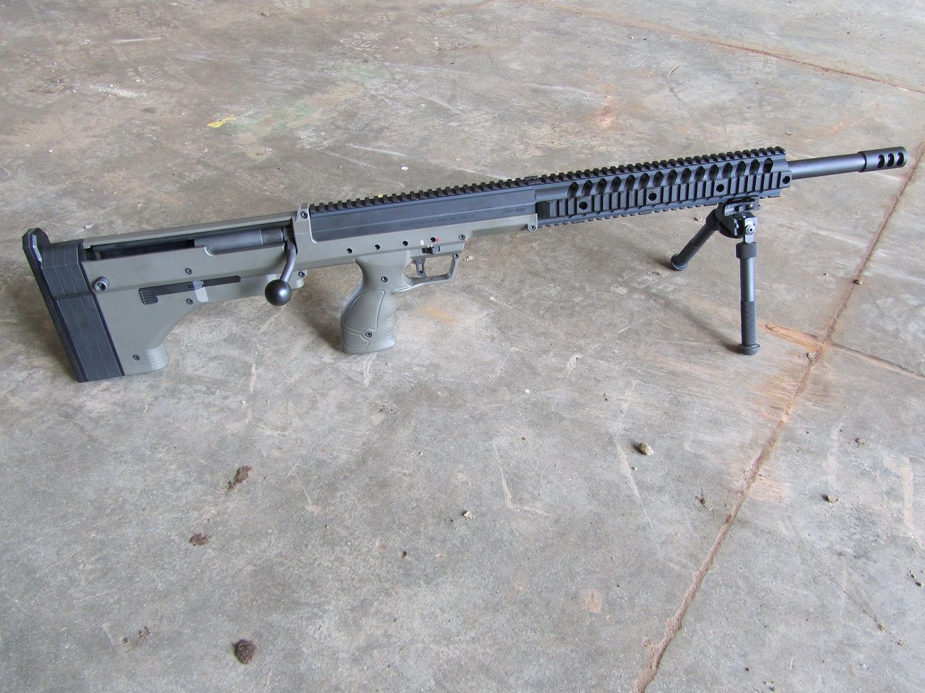

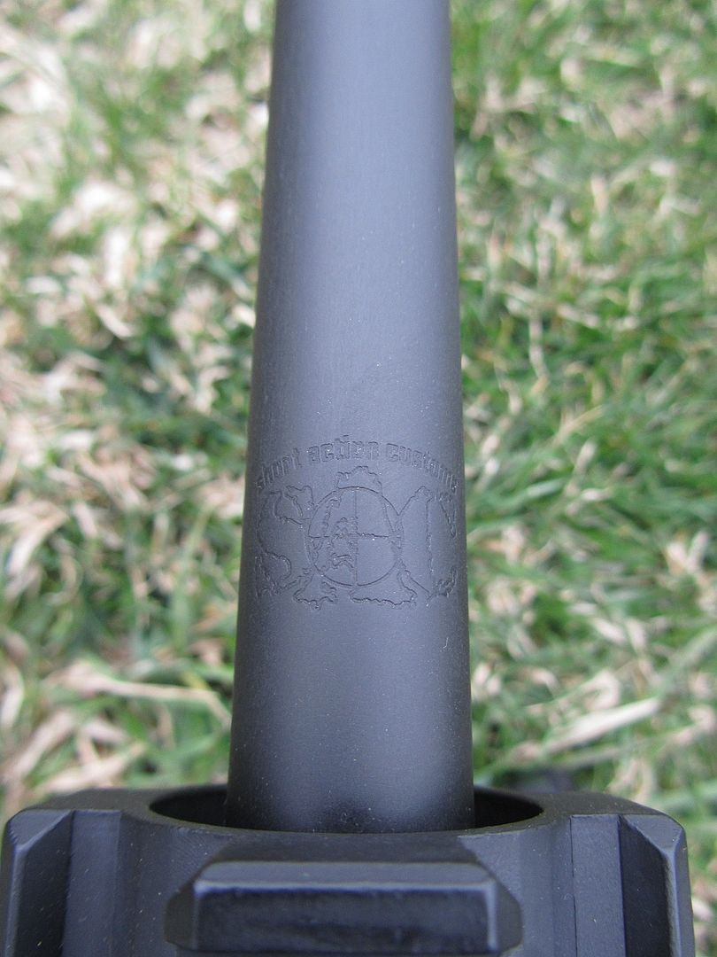

Shooters,
Short Action Customs now offers custom made Desert Tactical Arms barrels. These barrels will be made to DTA's dimensions but to your specs as far as over all length, weight and contour, fluting, caliber and twist. Here are the features of these barrels.
-SAC DTA barrels start off as Bartlein blanks contoured for us specially by Bartlein Barrels.
-1/2 MOA guarantee with most rifles shooting 1/4 MOA or less.
-Barrel extension supplied, fitted and timed to the 12 o'clock position of the curvature of the bore.
-Finished barrels are Cerakoted to the customers color specs.
-Threaded muzzle with thread protector is standard.
-Many calibers and twists are available.
-Same tight tolerances and workman ship you come to expect from Short Action Customs.
Barrels are shipped ready to go for $1425. Shoot us a PM, Email or Phone call with any questions.
