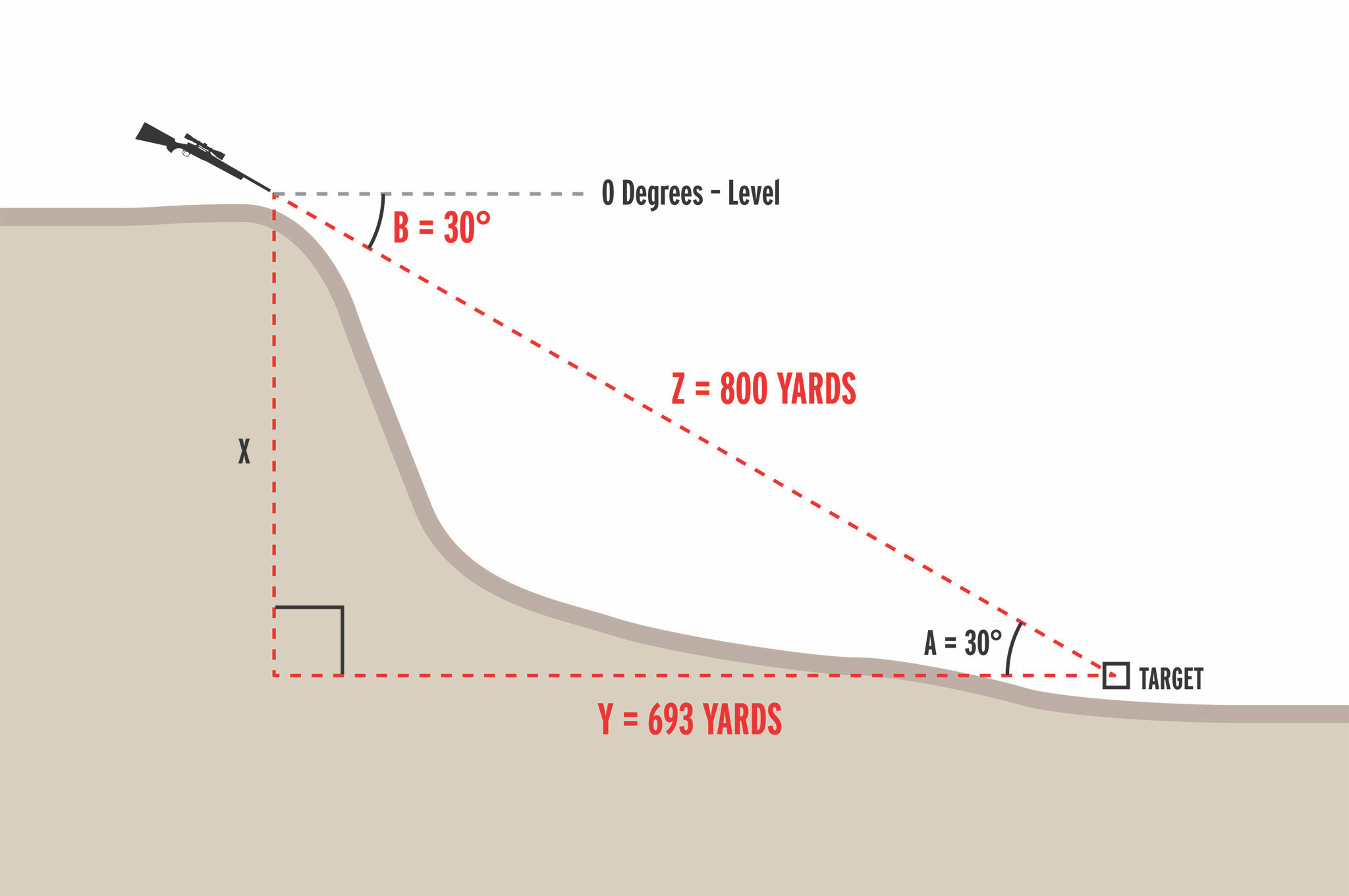

Imagine you are on level ground and have to shoot at a sniper at the top of a tall building.
Only the straight down pull of gravity matters, so if the building is 300yds away, it is drop over 300yds even if the bullet travels 360yds to get to the top of the building.
But it is also velocity over level ground, so your velocity is slightly lower as well.
So at close range where dope changes slowly (100 level vs 120 bullet path) it doesn't matter much.
At longer ranges (600 level vs 720 bullet path) or with steeper angles it can be significant.

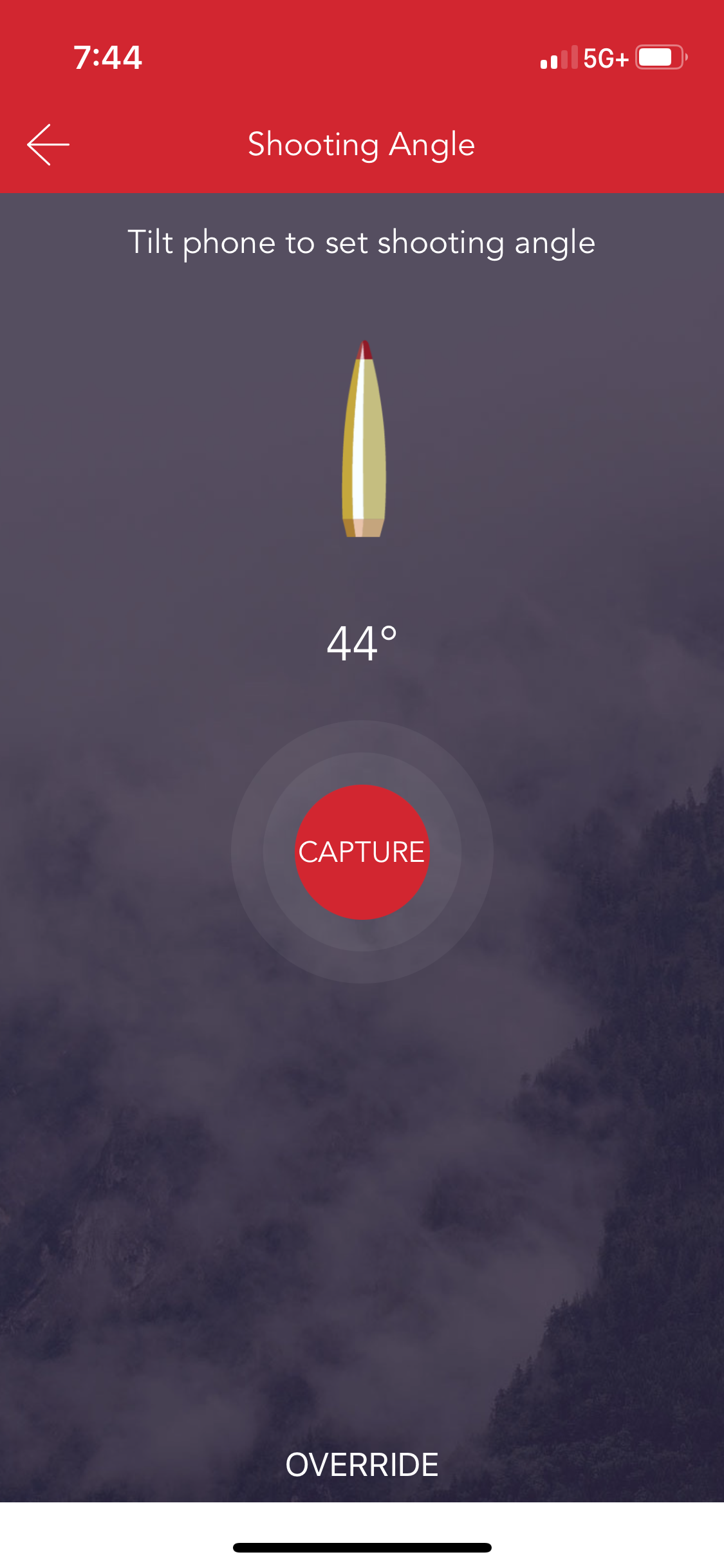

If you're using ballistic software, there’s likely a field where you can input shot angle. It will tell you exactly the change in drop is. Easy to play with different angles.

Just use the cosine of the angle to calculate the true horizontal distance and dial that into your elevation.
For example, let's say that the target is registering 575 yards on your laser range finder, but you are elevated such that you are looking down at a 15 degree angle toward the target. The cosine of 15 degrees is .96592582628, so multiply that by 575, and you get 555. Dial your scope for 555 yards, and you should be dead on the target if all else is correct (wind, etc.).

My notes, which are plagiarized, use at your own peril...
A shooter starts seeing the angle of trajectory influencing the trajectory beyond 30 or 45 degrees, depending on the
distance. The reality of high inclines in long-range shooting is such that most topography does not offer extreme long range
shots at extreme angles. Notwithstanding mountainous terrain, in all probability beyond 1000 yards the rifleman
will not see targets at angles greater than 10 to 15 degrees. When necessary, it is important to account for inclined angles.
Change elevation to adjust for the inclined angle but still adjust for wind at the slope-range distance.
