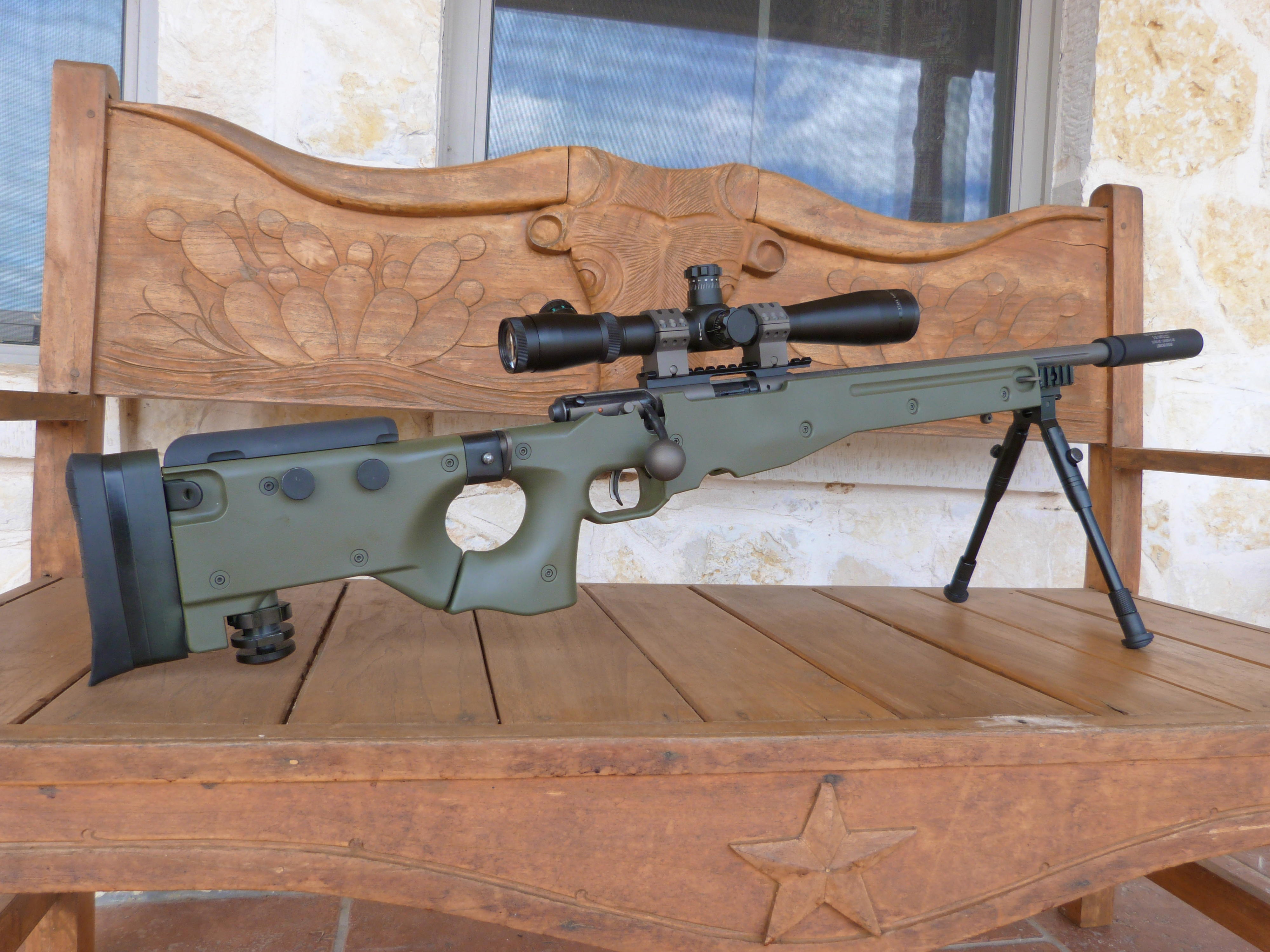

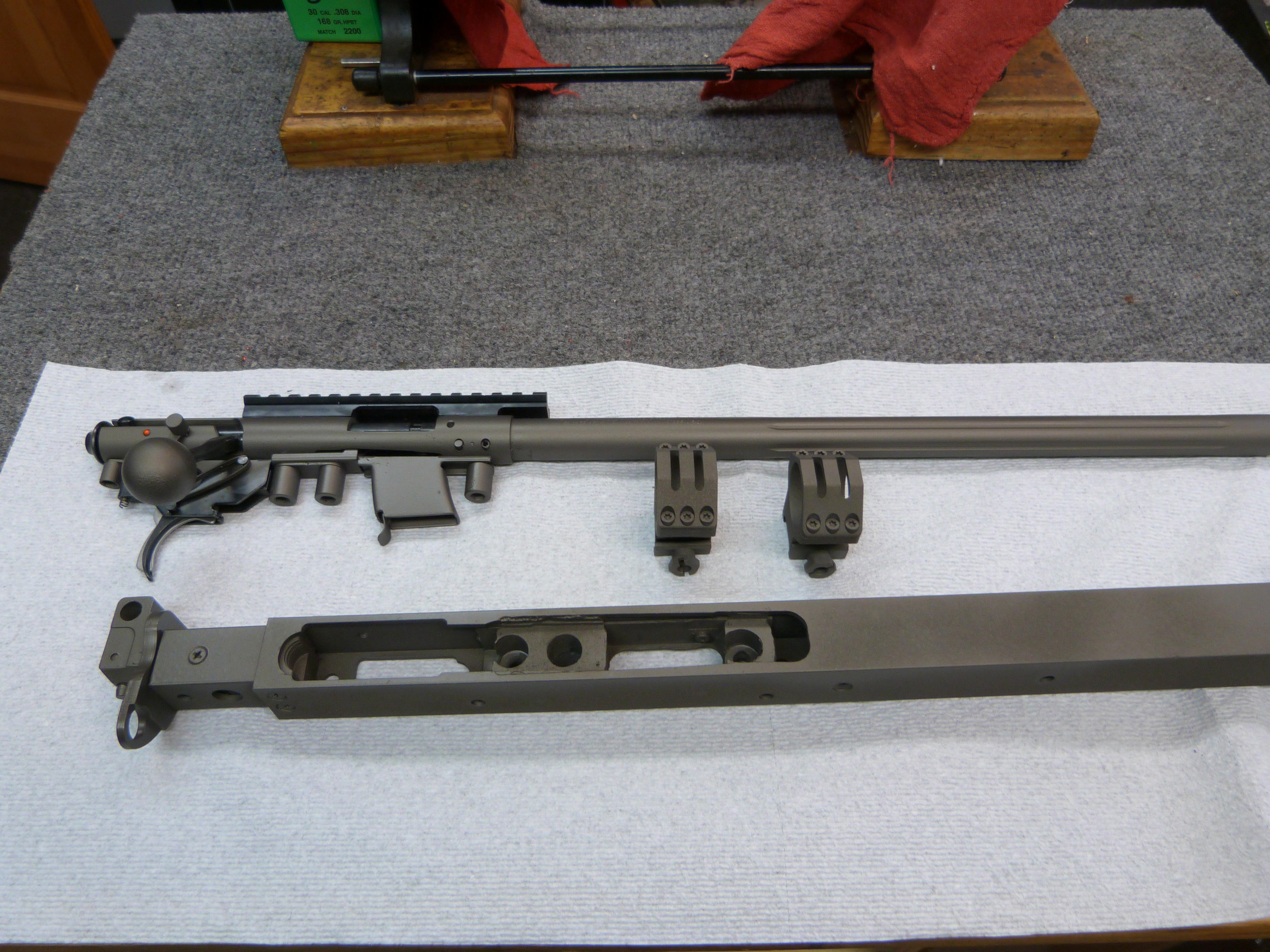

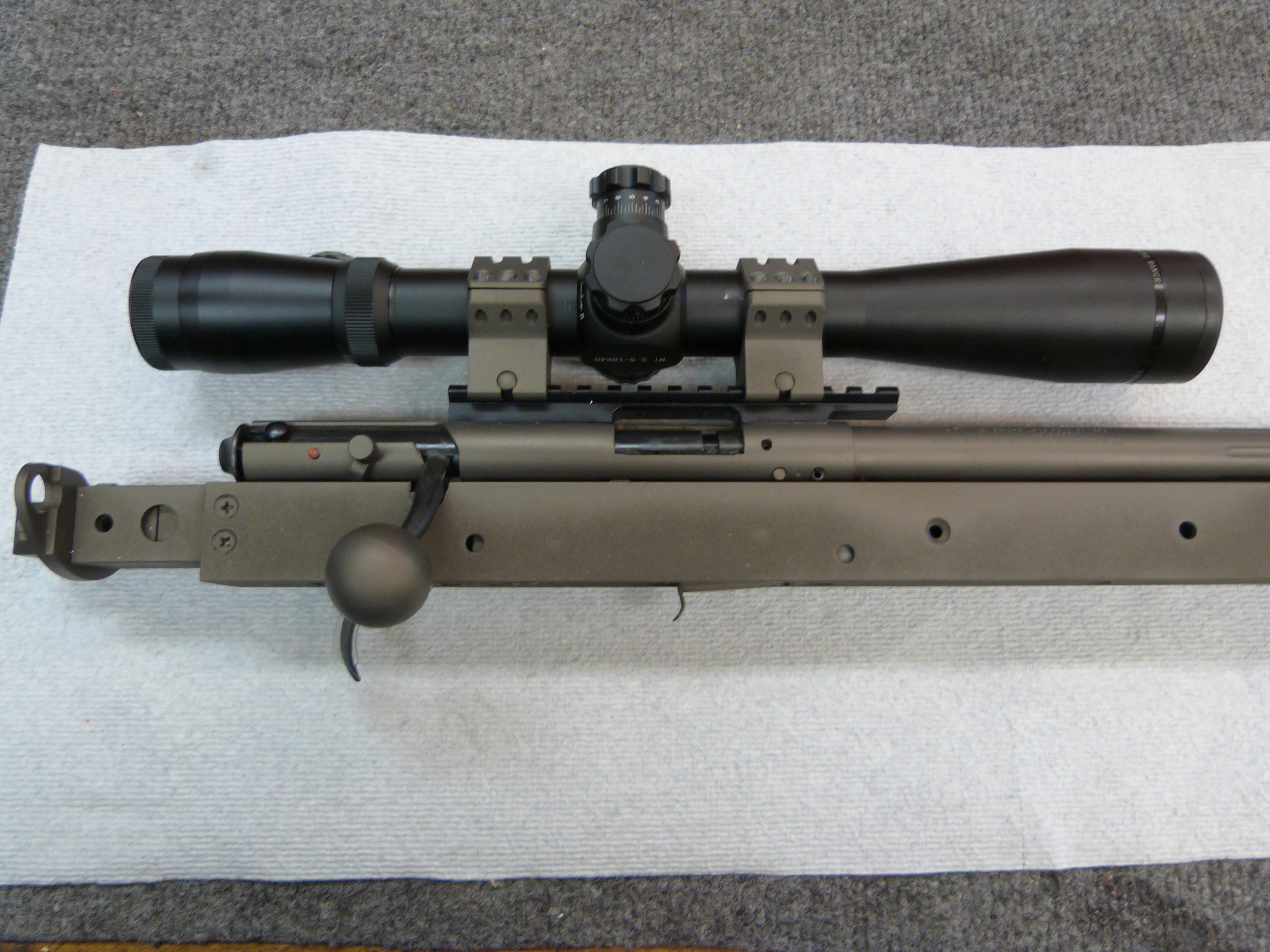

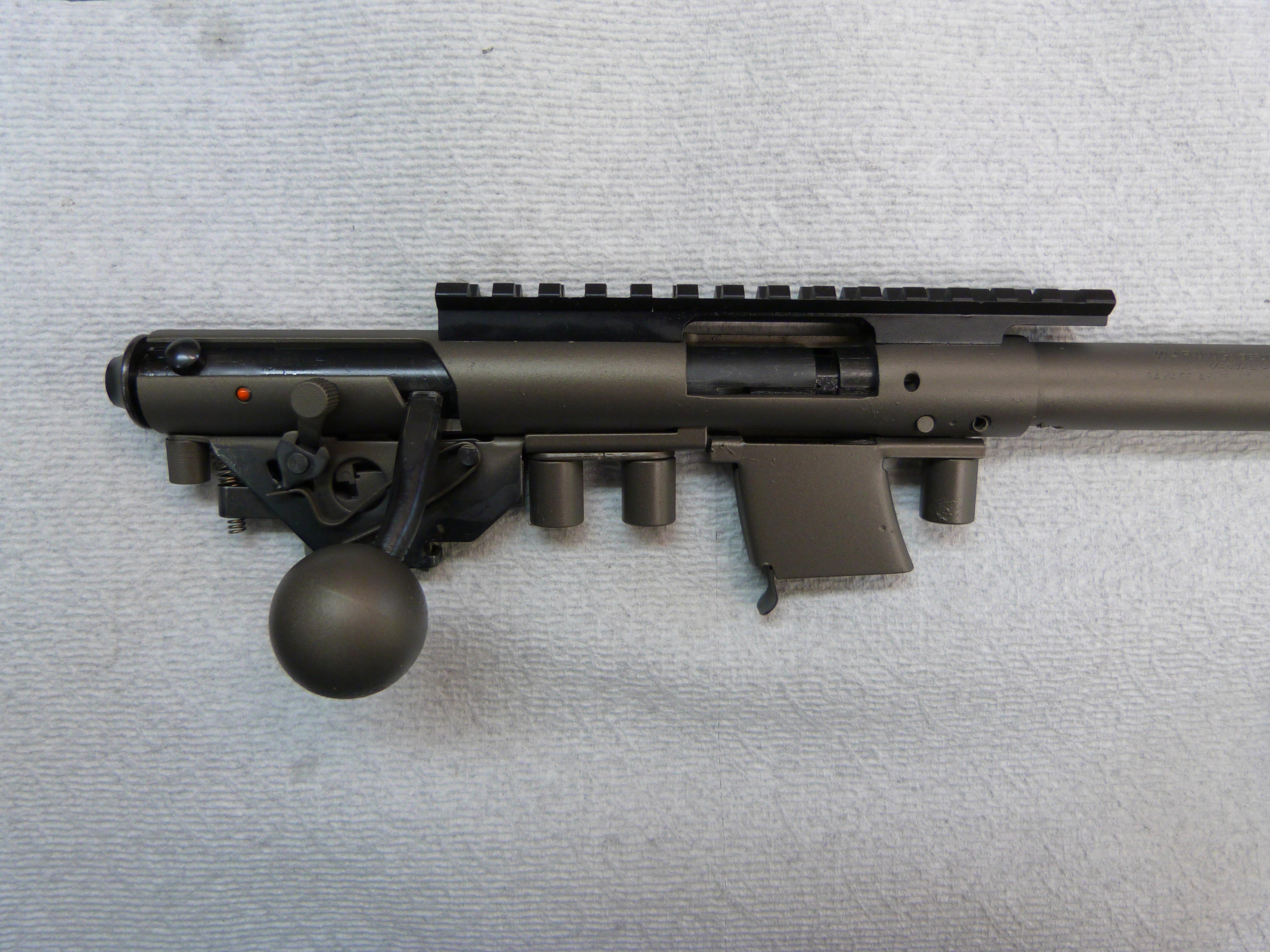

Coat right over it. Below is a picture of mine that I cerakoted with 60/40 Burnt Bronze and Sniper Gray. The factory finish is "rough" enough that there is no need to blast. Be sure to thoroughly degrease...that is the key.
