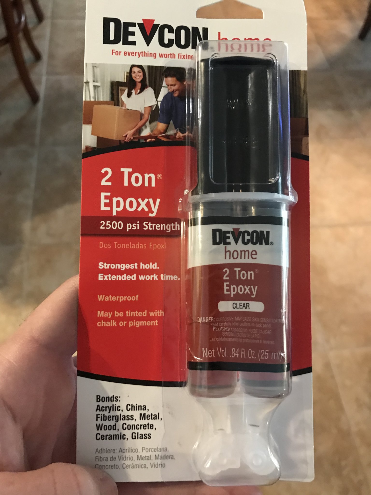

Is this what you were referring to?

No, but it'll work!
Devcon #10110 and 10210 are specific product numbers we often use; same stuff between the two, but putty and liquid, respectively.
That 2-Ton stuff will do fine for casting a screw. It's not a high strength application, if you think about it.
Prep extensively, mix thoroughly, and then move assertively.
-Nate

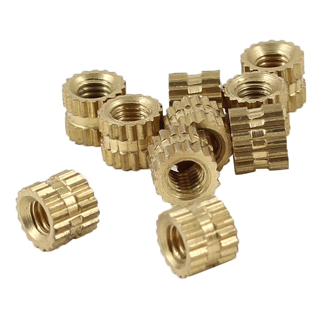

You could also get a brass insert of the same thread pitch and diameter that is knurled on the outside that will help bond it with the Devon. That is what I used when I put a savage action in a Manners stock that one of the local would be gunsmiths completely butchered and the guy that owned it was so disgusted he was just going to throw it away. I'm glad he gave it to me I love the Manners T4 now and the price was great.

Could I pick one of those up at Ace Hardware? Also the #10 you’re referring to is a new bolt to fit into the brass insert? So basically I apply the Devcon into the rear cavity, place the brass insert into the devcon, let it set for 24 hours and then install the new bolt or existing screw?
.org
You may be able to find them at Ace or one of the other hardware stores if not just order online. I would recommend doing a dry fit first to ensure everything lines up properly considering you will have to open the original screw hole up for the insert. You will also want to make sure that the insert shoulders out against the trigger guard and is not below flush so the insert and screw take all of the load from tightening not your bedding compound. Another good tip is if You havent allready sourced the release agent kiwi neutral shoe polish works great and you can use the leftover for spiffing up you boots and shoes ;)
