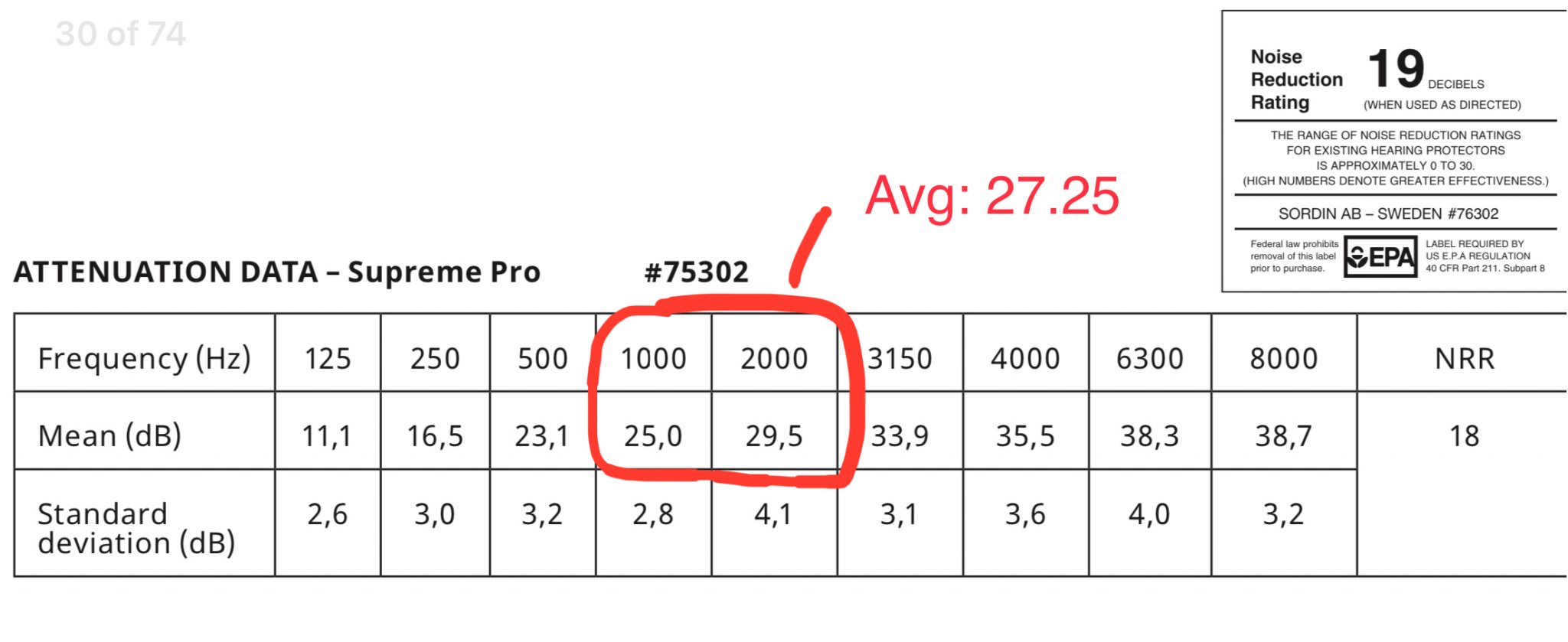

Here’s the Sordin’s hz chart:

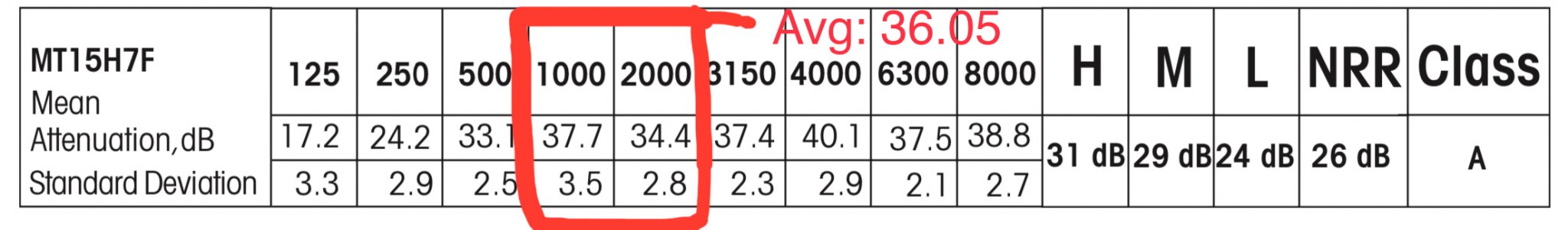

and here’s my Peltor TacticalPro’s hz chart:
The difference is quite large, 27.25 vs 36.05, or 8.8dB. The TacticalPros beat the Sordins across the board except for at 6300hz (less than 1 db).
You can get comms for the TacticalPros too, if that’s your thing.
The TacticalPros are larger than the Sordins, however. My head looks like an even puffier version of Glaz from Rainbow Six Siege lol.

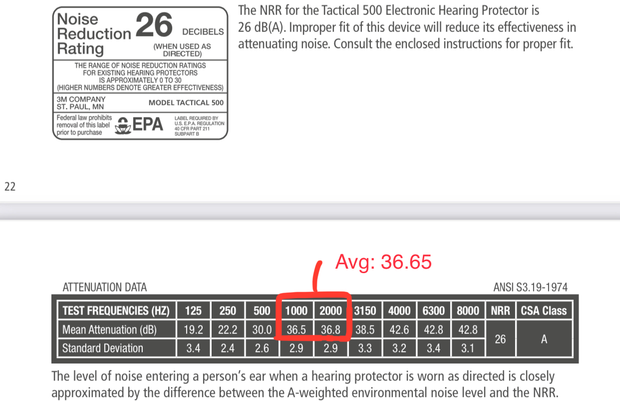

The 500s have Bluetooth, look to be a bit better at the top end (2k-4k avg) for short-barreled rifles and/or guns with compensators (hz according to Trevor), but the TacticalPros have a better 500hz number for magnums (hz again = Trevor). They also don’t have comm ability, I don’t think.
edit: I just compared the 500-4000hz average between the Peltors and the Sordin:
  • TacticalPros: 36.54
  • Sport Tactical 500: 36.88
  • Sordins: 29.4
If I did my math right, it’s a wash between the Peltors, and the Sordins closed the gap a little (~7.1 dB less).
With either Peltor, I suggest getting the gel pads (quite expensive). They reduce the protection by ~1 dB according to 3M literature but add significant comfort and sealing around glasses, so I feel they probably come out ahead in dB land vs the stock pads anyway.
I don’t know if the Sordins come with gel pads or if they are an add-on as well. If an add-on, I wouldn’t be surprised if they too suffer from a 1 dB reduction, but do check.

I’ve also attached the docs from which I got my Peltor numbers. They are hard to find!
