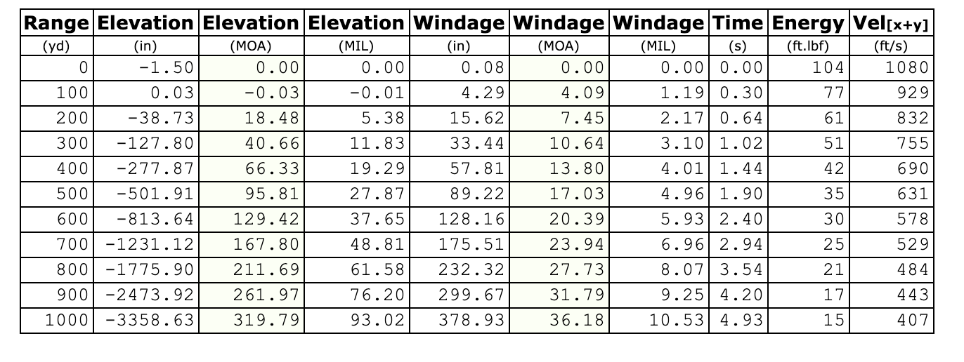

So I pulled a table for 22 out to 100 yards.
Realistically, and it sounds insane, I'd want a set up that would handle 550-600 yards max.
How do you calculate what mix of rails, mounts and scope adjustment needed for subsonic? I run MIL/MIL scopes.
So for 500-600yards, you'd need 30-40MILS/100-130MOA.
Scope mounts and rails would be additive, but when it comes to scopes, the internal adjustment is the total range that it will move. The zero you use will place the reticle in that range. The longer the zero range, the better the placement of the reticle?
So if you have a 30MOA base, a 20MOA mount is 50MOA or 14.5MIL. If your scope has 30MIL of vertical adjustment, does that mean that there is 15 (half) mils of elevation to use? So a total of 14.5+15, or about 30MILS of vertical to use That would get you close to 500 yards- and then you could go down the reticle to get more mils? at 25-30x on a scope, how many MILS of a reticle are visible 4-5?
BUt that is really using all the adjustment to get max range- your zero would be in a limited range of possible values? And if you had to dial in some wind, you might not be able to get the max elevation?
I've never had to play at the edges of the sighting systems before. I'm just looking for a way to calculate what is needed.

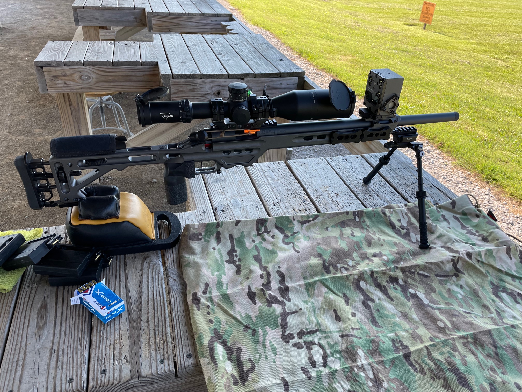

Here are the details on my setup with my Vudoo
Trijicon Accupower FFP MIL 4.5-30 x 56
MPA BA Scope Mount, 0 MOA, 34MM 1.25" - able to dial 27 Mils with 40 MOA base
With Center-X at 1100 FPS. I was 30 Mils to 500 yds and had to hold over 3 Mils in the reticle which is not too bad of a holdover. I have a Charlie Tarac Micro on order that will give me another 30 mils which should be good to 750 yds (in theory)

I finally got in my Charlie Tarac Micro and it is awesome... nobody at the range knew what the hell that space looking box on the front was. Your drop table at the top is on for 400 - 20 Mils, 500 - 28 Mils, 600 - 37 Mils with Center-X. Below 400 looked a little strange to me, but maybe that is a 100 yd zero. 22LR is a fun round to try to stretch out.

The micro is a simple, but perfectly calibrated tool - there are no moving parts, just 2 mirrors. You buy the micro set at a fixed angle, mine is 30 Mils which basically corresponds to my 500 yd data. The big charlie tarac is adjustable using some set screws, but the micro is fixed.
With a 50 yd zero, I have the ability to dial 27 mils which gets me to almost 500, so every distance before that I don't need the micro, I just dial. Starting at 500 and beyond I put the unit on the rail and it changes my 50 yd zero to essentially a 500 yd zero. Any distance past that I simply dial my scope just like you would normally. 600 yds, I dial 7 mils which is on top of the 30 the device gives me. So now with the unit I have 57 mils that I can use and not have to hold over in the reticle... 30 mils from the unit + 27 from dialing.

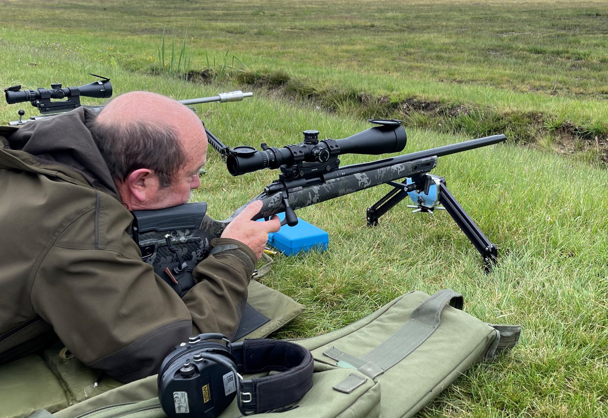

Went with the ERATEC in moa as that's the increments in the scope - the 22rf setup is a clone of my Dasher. Tested the ERATEC at 100 yards, put 40moa on and the change in impact was 41.75" and the back to zero so it's good re. repeatability. Does not add too much re. scope height on the rifle
Tried my first distance shoot on Sunday, 300 yards and very interesting. Both rifle and distance new to me so see a bit of a learning curve;
