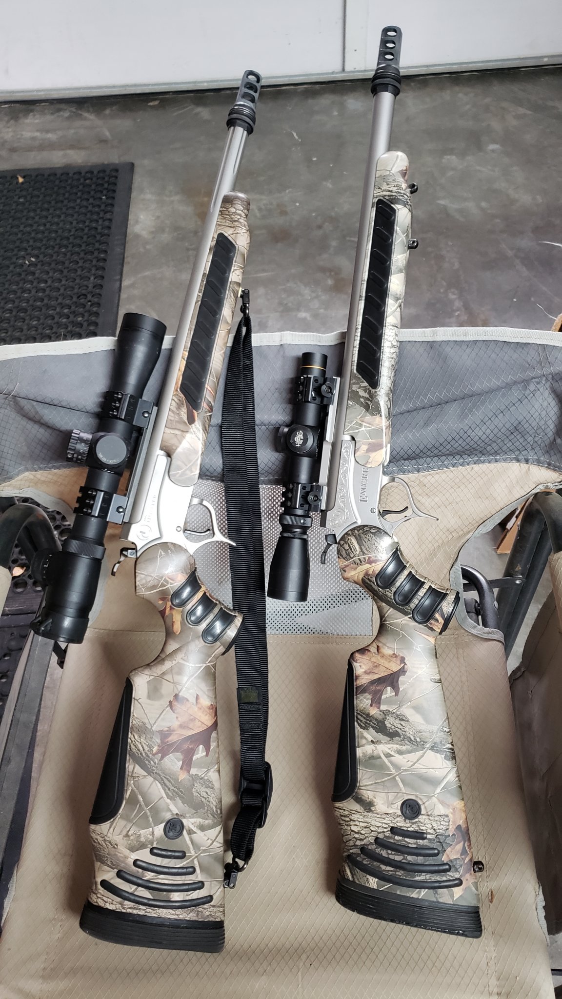

My Twins . . . . .308 with the sling . . . .300Blk on the right . . . . both very quiet.
I been playing with about 8 grains of Trail Boss pushin a 230gr Lee Lead in the .308 . . . and luvin it. The KEY to makin the 230 lee to shoot right is filing the bases and a light lube like Alox. Gettin about 2-3" groups at 50yards with my reloadin. Someone who was REAL meticulous could probably reduce that some. When I first got the .300 blk I was at the lease filling my barrels at about 2pm and Ill be danged if this piggy didnt walk out to the feeder just as I walked back to the truck about 60 yards. A quick switch to a Remington 125gr Accutip 300black knocked him right down ...
