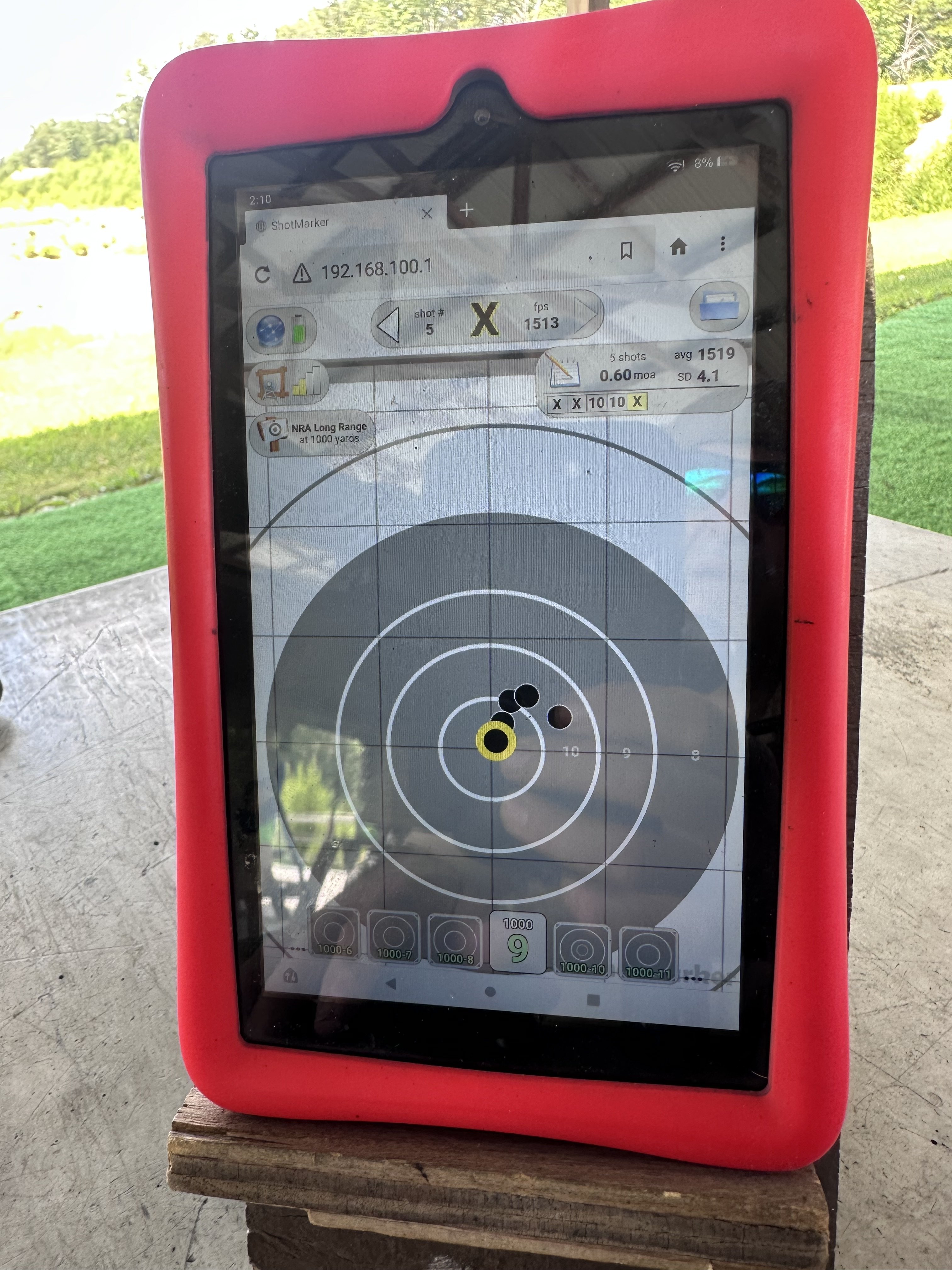

    I’m shooting a 6.5 Creedmoor.
    Today I shot at 1,000y for the second time.
    The first was exactly 2 years ago nearly to the day at the same range.
    My barrel was nearly new 2 years ago and I was shooting 0.4moa with hand loads and 0.6moa with factory ammo.
    Today my best group was 0.6moa with hand loads after 2500 rounds down the barrel.
    A new barrel is on order and should be arriving in about 4 weeks.
