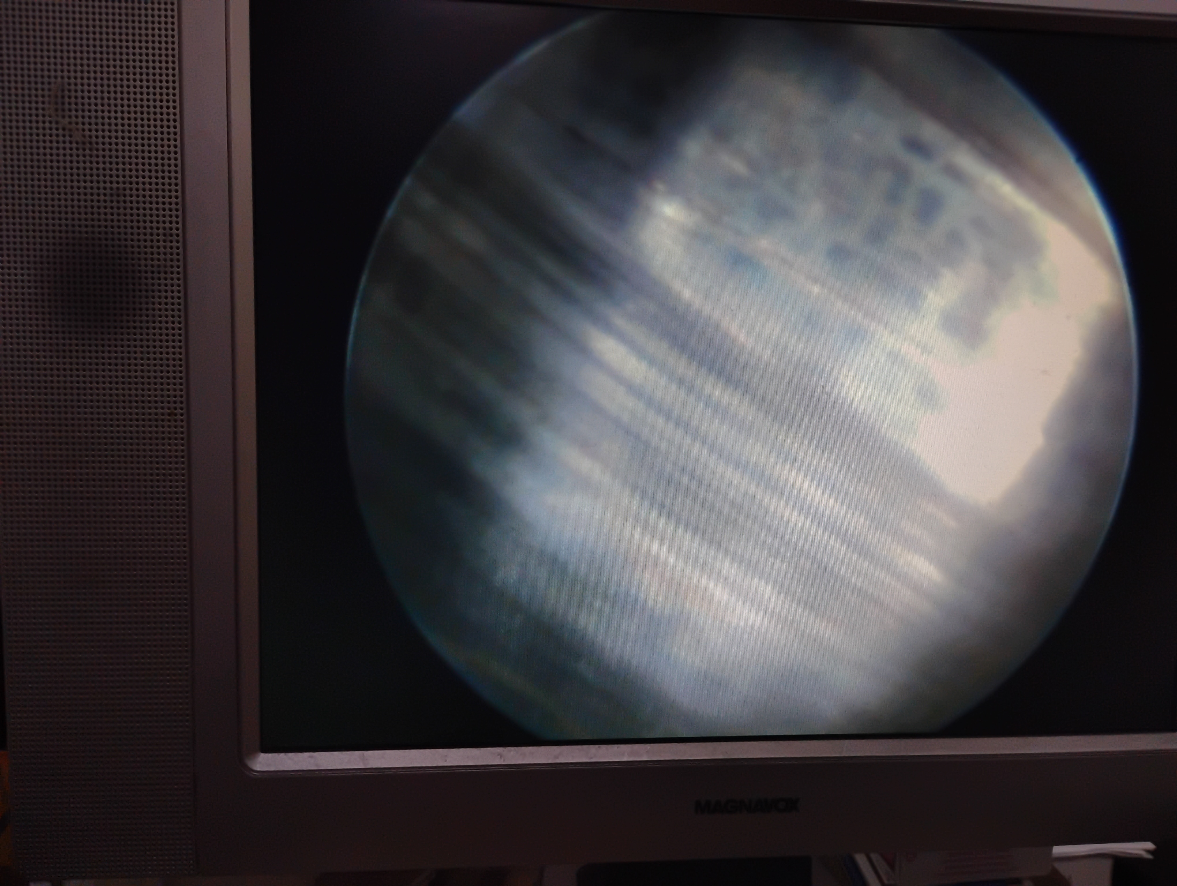

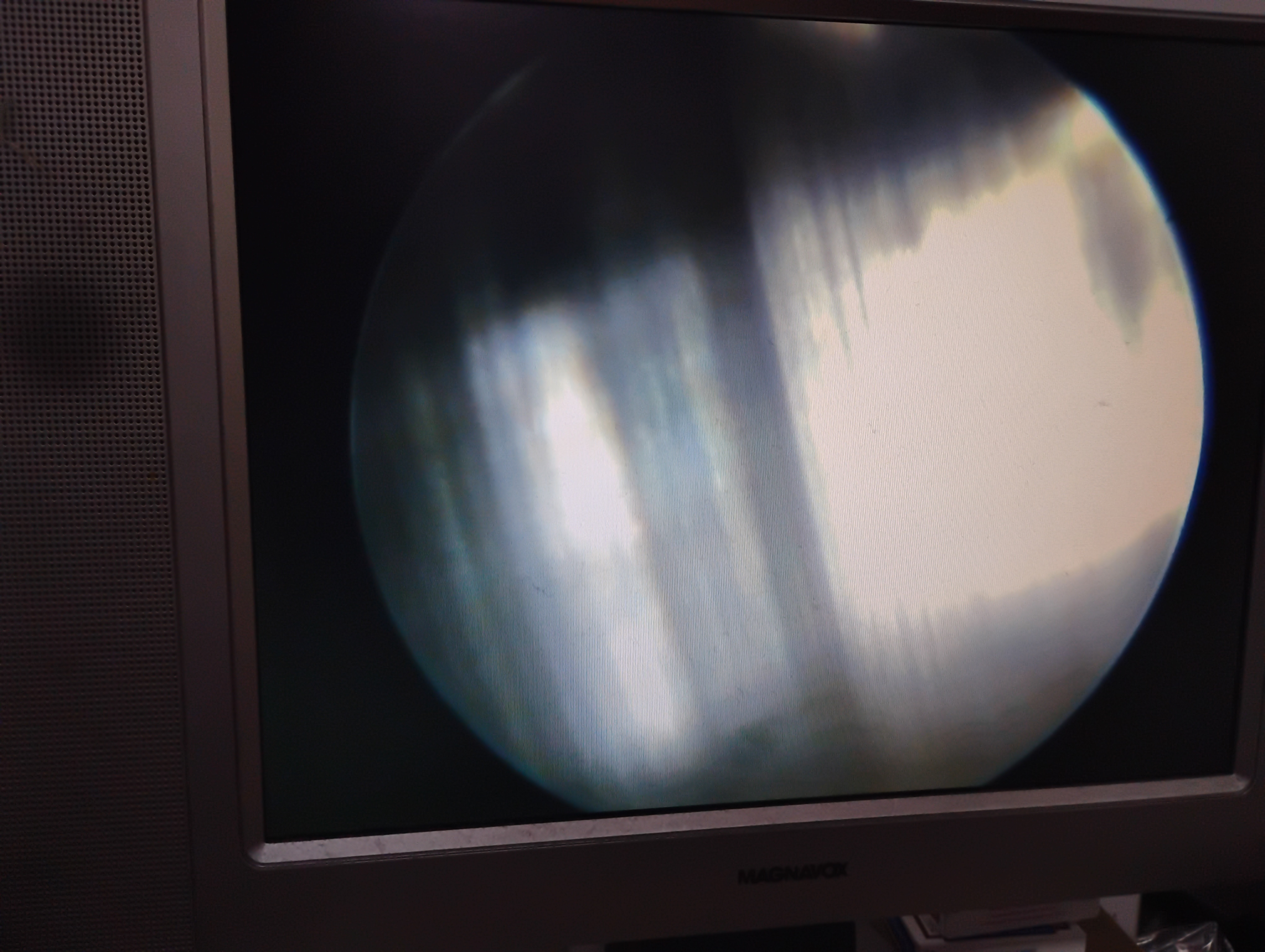

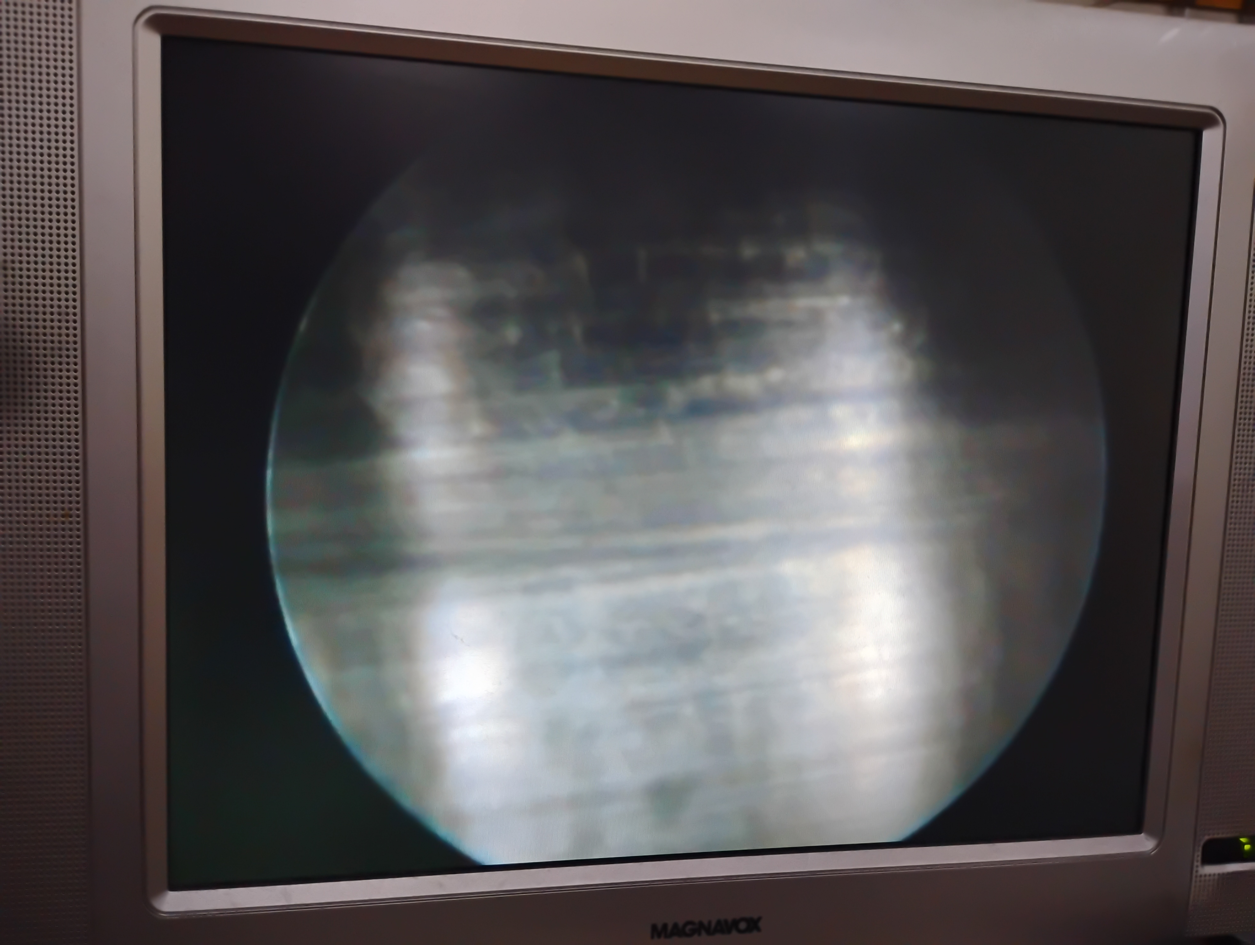

Latest example with pictures attached. Customer has less than 400 rounds on a 6mm barrel. Caliber is 6XC. He used Iosso bore paste along with Tubbs Final Finish to fire lap the barrel. How many times etc... we don't know exactly.
The first approx. 2" of rifling in front of the chamber... the lands are completely gone. Basically polished smooth. From the breech face of the chamber until you get about 6" up from the breech do you start to see lands. At this junction point the bore is about .2385". That's a full .0015" of material that has been taken out of the bore.
Tubbs years ago asked me to endorse his Final Finish kits. I said... only if he was going to cover the warranty on the barrels. The conversation ended right then and there on the phone.
The rest of the bore when you look at the lands there is no crispness to it. The edges are smoothed/rounded over. All points to cleaning damage. Sorry for the grainy pics.
The customer wasn't happy when we said we will not warranty it. He said he's done it to four other barrels with no issues. Again guys... we have no control over how much is done and how often and how aggressive. Cleaning is simply beyond our control in what a person does to the barrel. Maybe the company who makes the cleaner product should cover the warranty to the barrel/customers rifle. I'd like to see that happen?

First picture is at the case mouth.
Next pic is 6" from the breech face. So approx. 2" to 3" from the case mouth and you can start to see the land.
Approx. 8" from the breech end
Here is several inches in from the muzzle. Looks nice but again the crispness to the lands isn't there.

Again first two inches of rifling in front of the case mouth are gone. Where the lands do start the bore is .2385". Basically at that point a full .0015" was taking out of the bore there.
Ok, I should have read more carefully. Well, that's definitely enough for way too much gas to overcome the bullet; if it's sealing at all any point in the barrel. Damn.

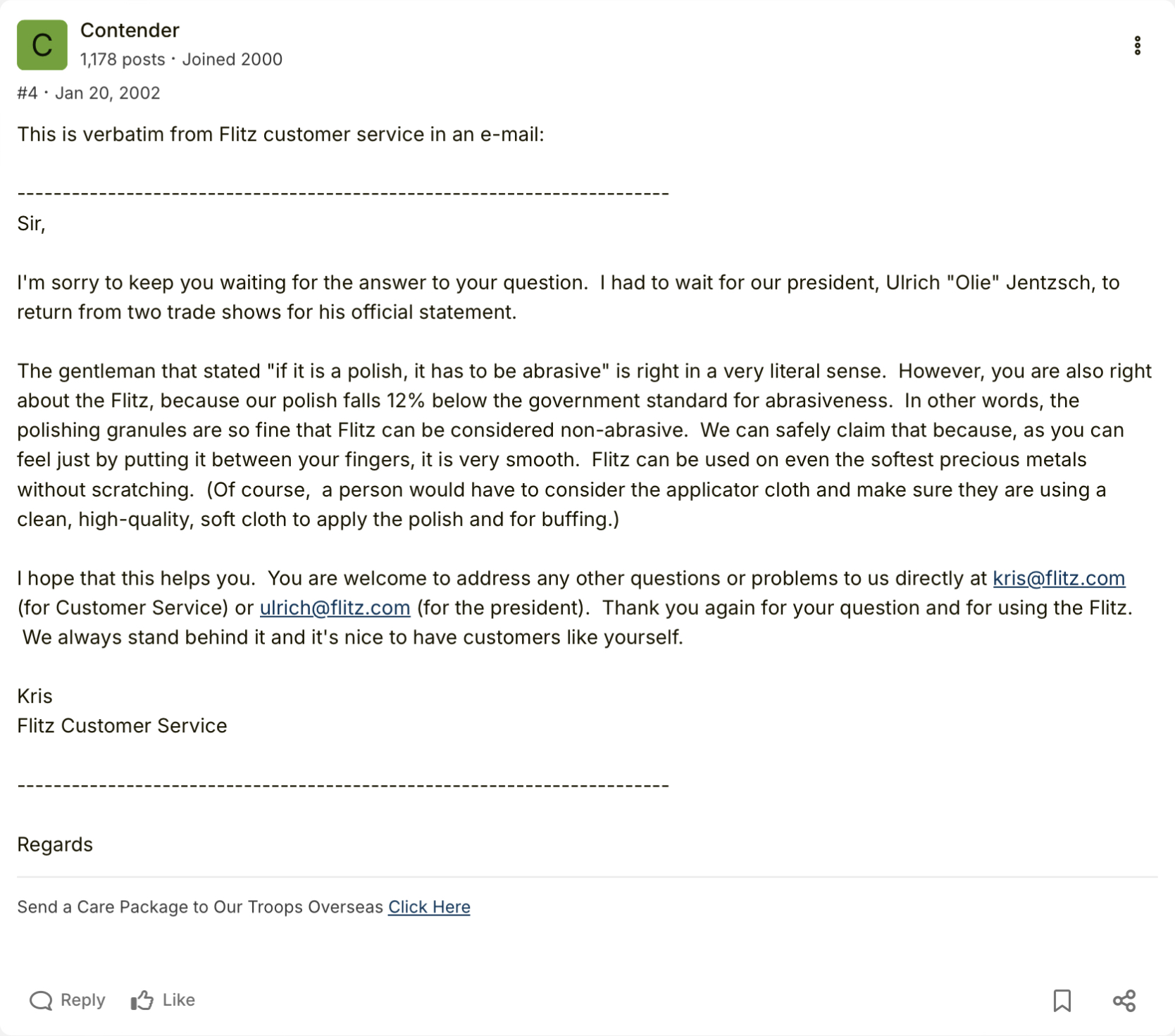

So confusing. They basically said it’s not possible to hurt the barrel with it.
They’re probably getting away with saying that by using some obscure definition or parameter for “abrasives” used in commercial circles [speculation].

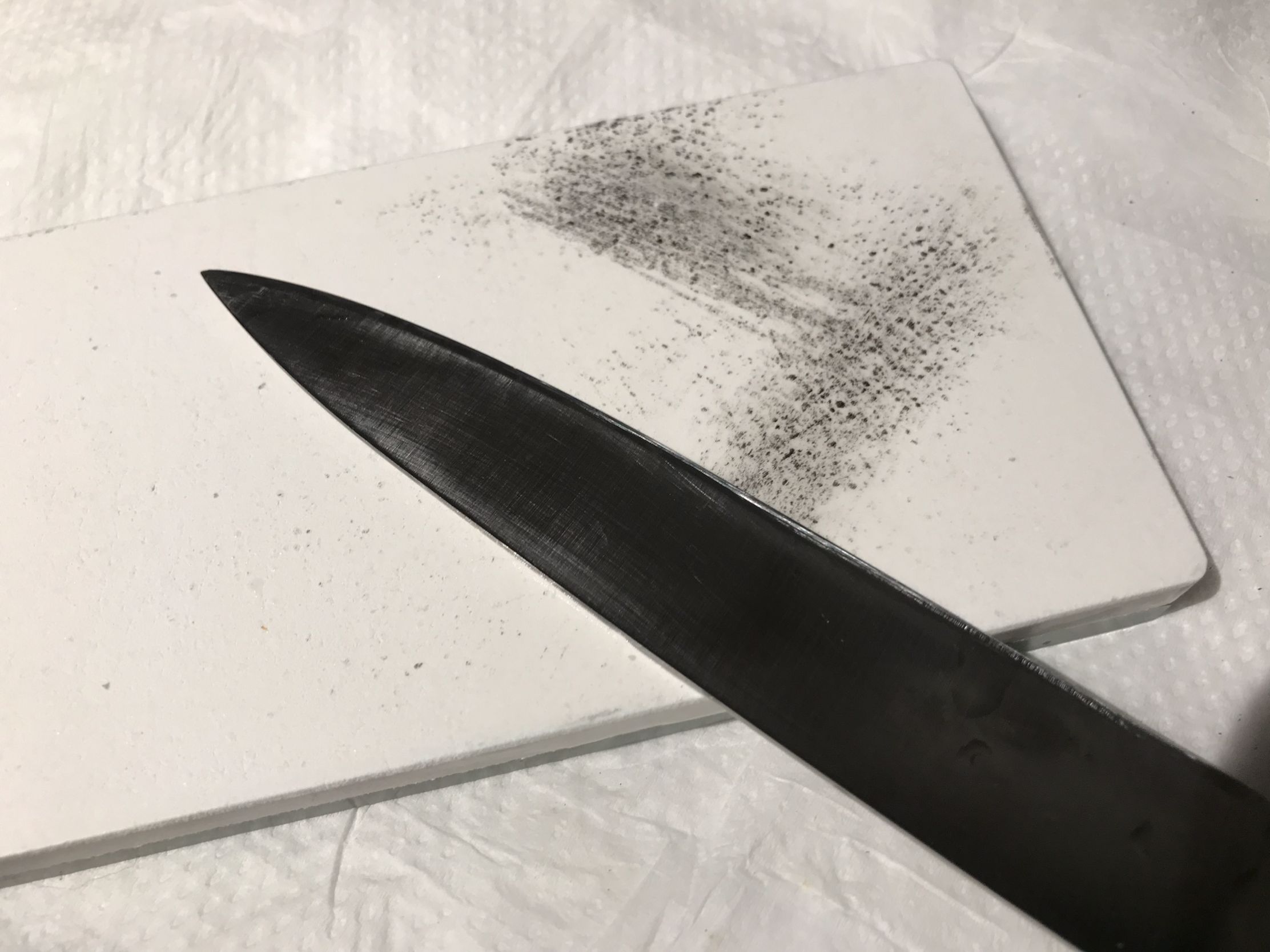

Apples to oranges, I know - but…
…look! I successfully sharpened my kitchen knife…
…without resorting to the use of an abrasive!

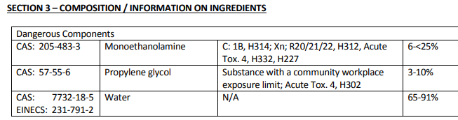

Do you have anything other than a screenshot to back up your claim?
Ethanolamine aka monoethanolamine or 2-aminoethanol (that's in Bore Tech Eliminator, etc.) in an aqueous solution, does not directly convert to ammonia through a simple chemical reaction, but ammonia can be formed as a byproduct during MEA's degradation. The degradation process is primarily driven by factors like high temperatures and the presence of oxygen or other chemicals.
Monoethanolamine (HO-CH2-CH2-NH2) is a stable organic compound in water under normal conditions (solvents like bore tech eliminator are mainly water with some monoethanolamine and proplyene glycol).
I would much rather use monoethanolamine to chelate/remove copper than ammonia b/c it's less toxic and less corrosive
Beyond a screenshot? Sorry, no. Just what I remember from High School Chemistry. I don’t even have a single one of my own, or even my kids’ textbooks to reference - but that would be kind of like asking for documentation behind πr^2.
Not saying it forms Ammonia, but functionally - it still is.
The easiest and cheapest way of liberating Copper with a liquid cleaner is through the use of an Amine group, in one form or another.
Basically, “weaker” Ammonia.
That’s why our “Ammonia - Free” cleaners still have this Ammonia smell.
So while “Ammonia - Free” may be technically correct, it is still to a large degree disingenuous - it's really still Ammonia - and almost reeks of lawyerese.
