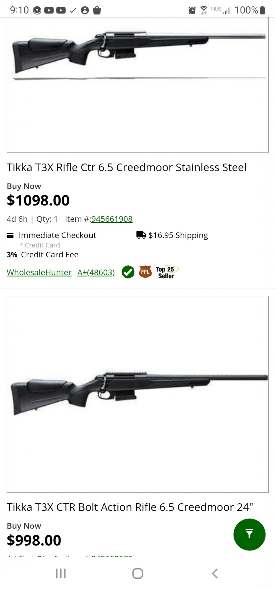

Can’t vouch for the seller but here’s the route I was talking. This should shoot with any rifle out there. Add a bravo and a decent optic and you’re set. If you ever want to upgrade you take a small loss ghats well worth the fun you had and upgrade.
