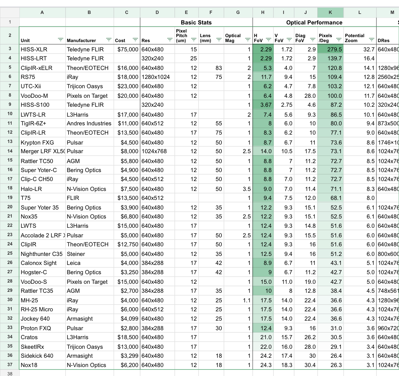

I've been comparing thermals lately and in an attempt to quantify the differences I've compiled some data. There are clear patterns of pixels/degrees FOV. It seems that the long range, high budget devices approach or exceed 100 pix/deg. Medium range, middle budget fall in either the 72 pix/degree or 51 pix/degree, depending on if you prefer a larger FOV or not. You can see my rough estimations in the attached picture.
This pattern also held true for the new armasight thermals that I've been considering, their 640 4.8-19.2x was 109 pix/deg, 3-12x was 72 pix/deg. The 320 6-24x was 72 pix/deg and 320 3-12x was 36 pix/deg. All at base mags
I'm betting the threshold for bad image quality is around the 12-24 pix/degree mark. My only experience with thermals is an ATN 384 1.25-5x which comes to 24 pix/deg at 1.25, which is pretty much useless beyond 50-100 years and anywhere past 2.5x digital zoom.

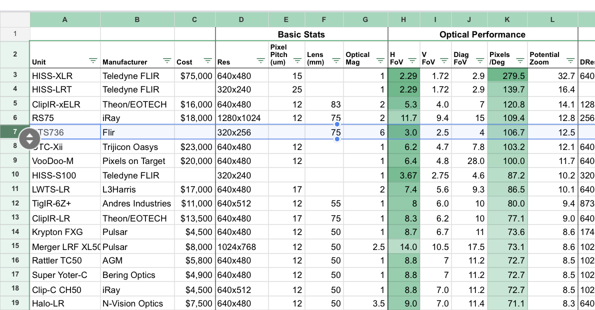

Agreed on the pixels/degFoV. I’ve used it as a metric to compare optical zoom capability in the clipon options out there. A partial screengrab of a spreadsheet I try to fill in whenever a new unit is getting talked about to help place it in my mind for different applications and which units it may be similar to. The “potential zoom” is all proportional based on me feeling like 5x is the top end on the voodoo-s
