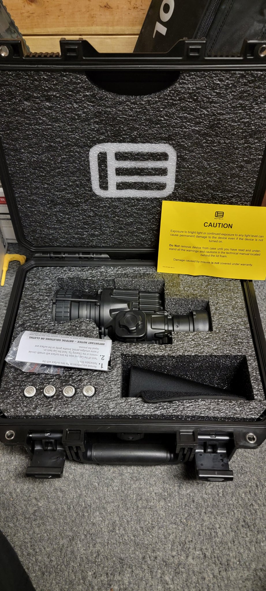

A few LR's arrived. Sold. Hoping (e)XLR is not too far behind....edit to add. Disregard the yellow warning they put in box. That is obviously an I2 nv carryover.

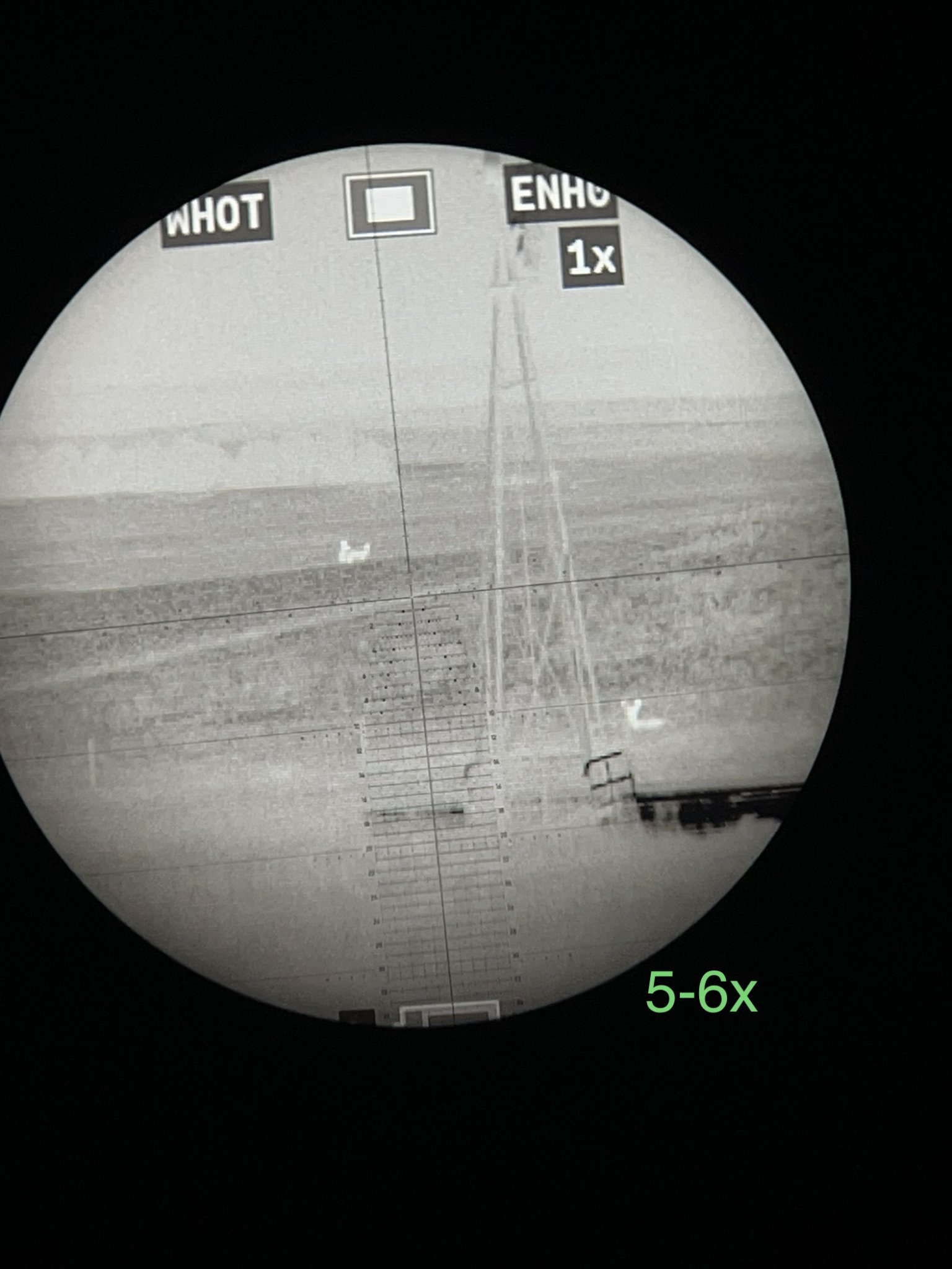

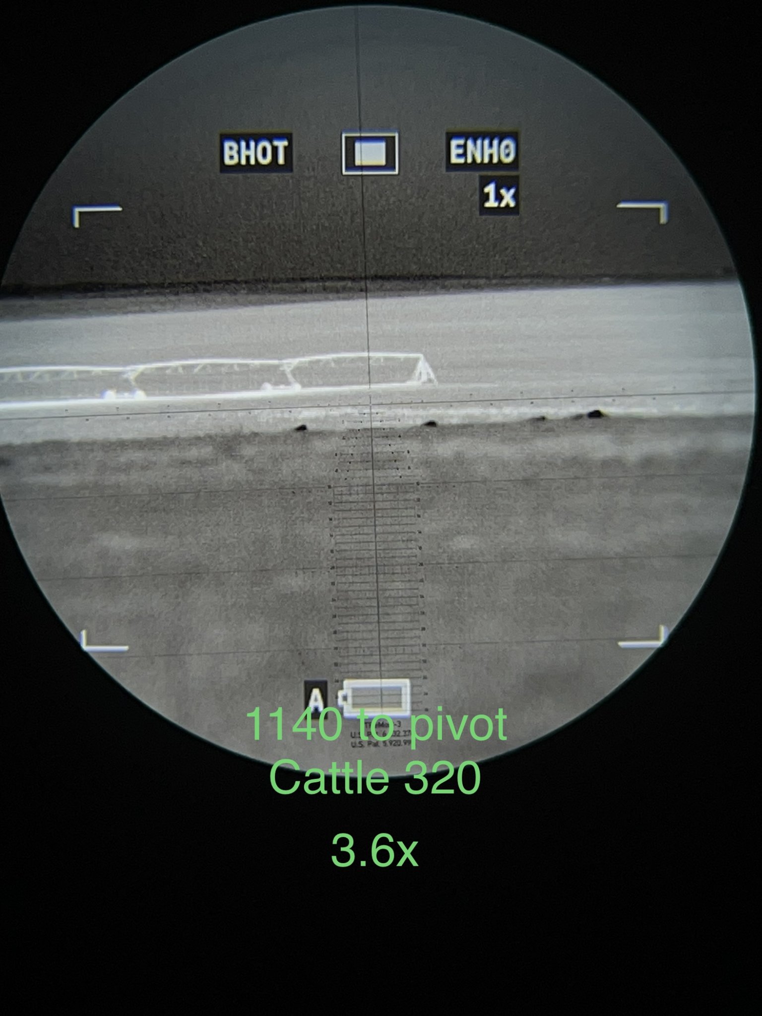

All I can say is wow!! Probably could tweak the settings a bit more but overall awesome image and nice button/menu layout
ClipIR-LR
3-18 mk5
Couple more. No regrets here!!! Thanks for the fast shipping @DownRangeThermal
THIS ^^^ is how to post thermal pictures!!!
Thermal pics without range to objects and day scope magnification information are very close to useless to potential buyers (most clipons look similar at close enough range with low enough magnification). Knowing magnification settings and range lets us compare your photos with past experience or other photos where information was provided.

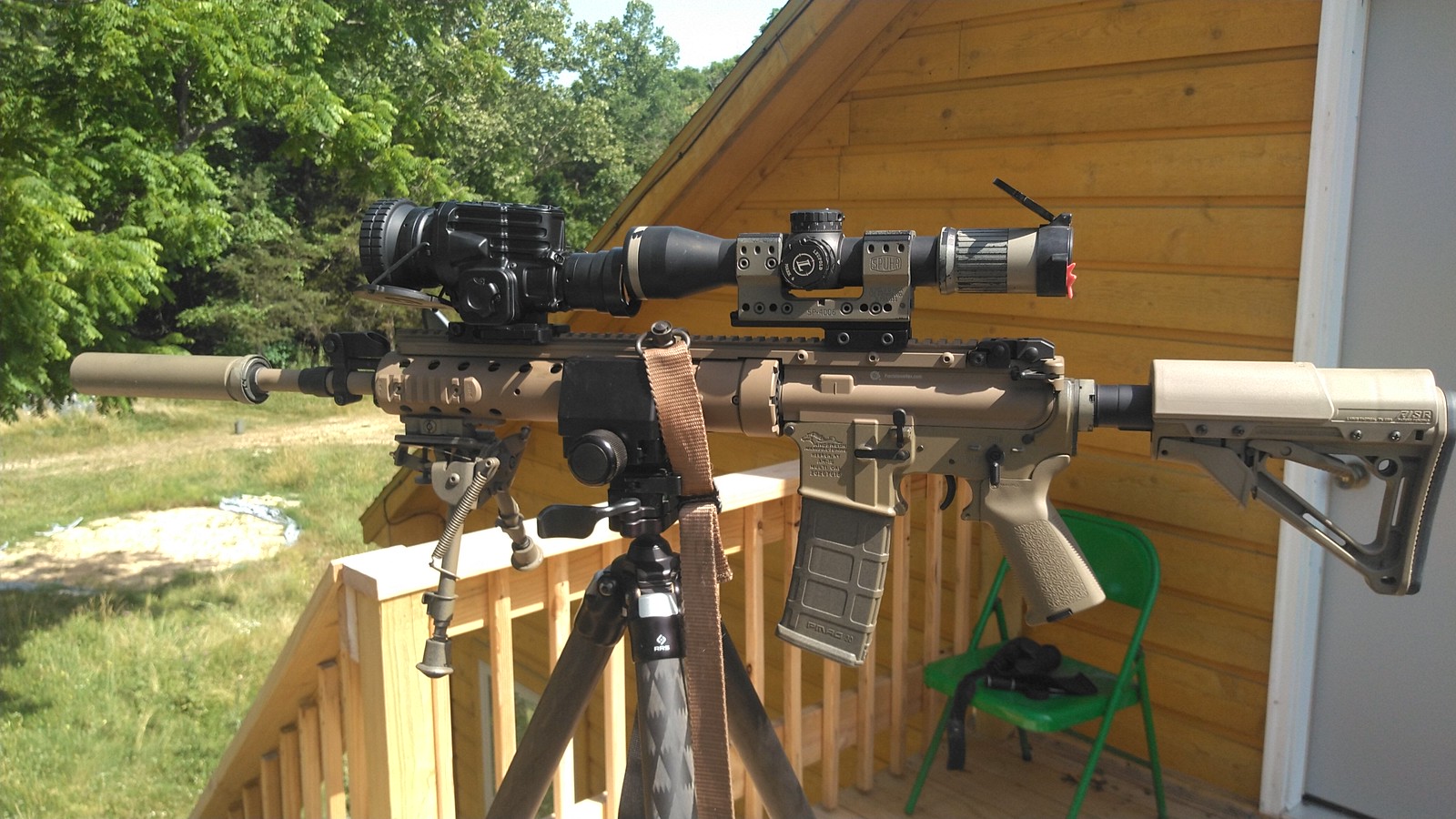

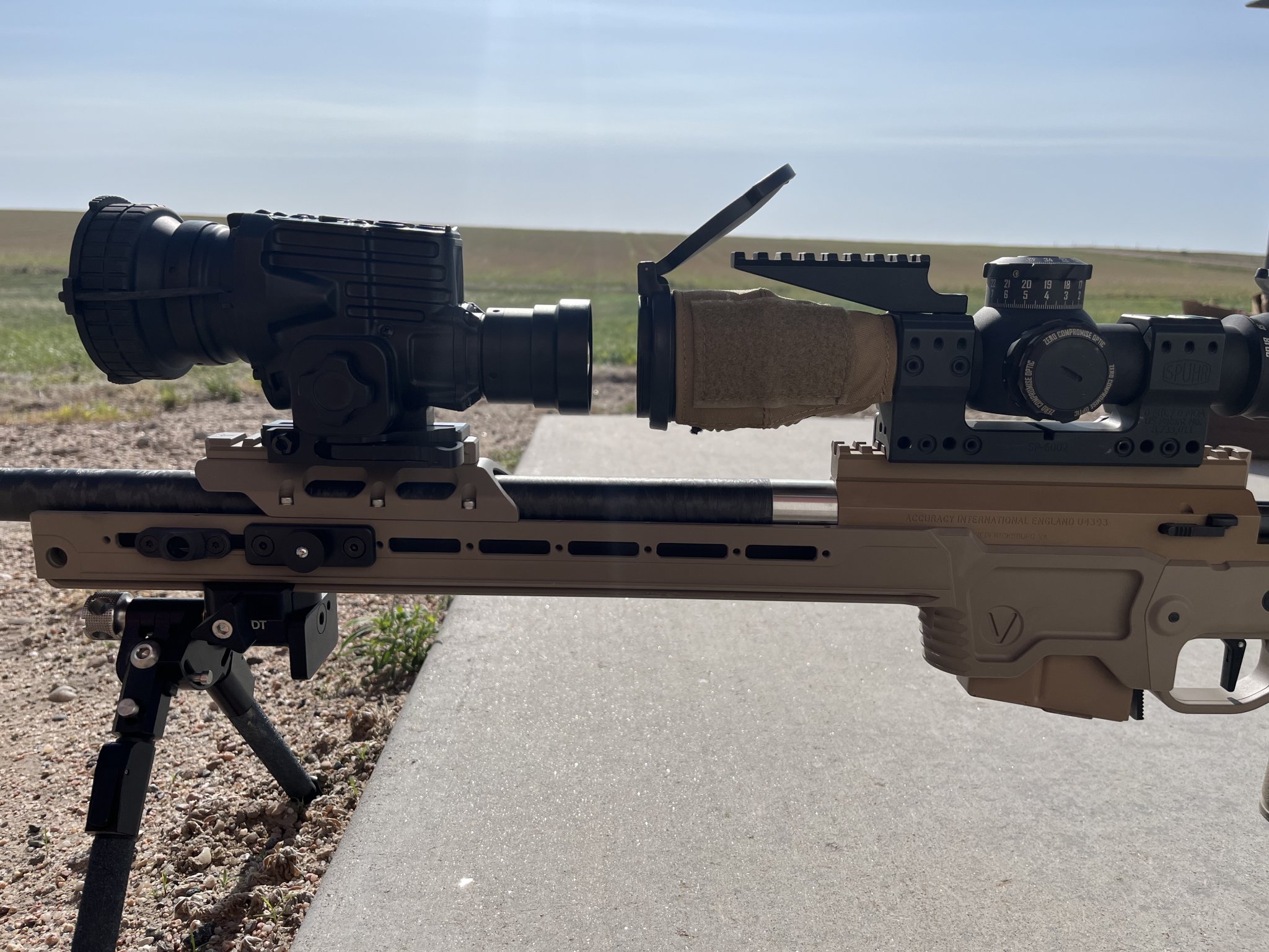

These clip-ir are tall though. I need to get a spacer ordered for my badger c1 diving board to get the raptor high enough or mount the raptar to the side

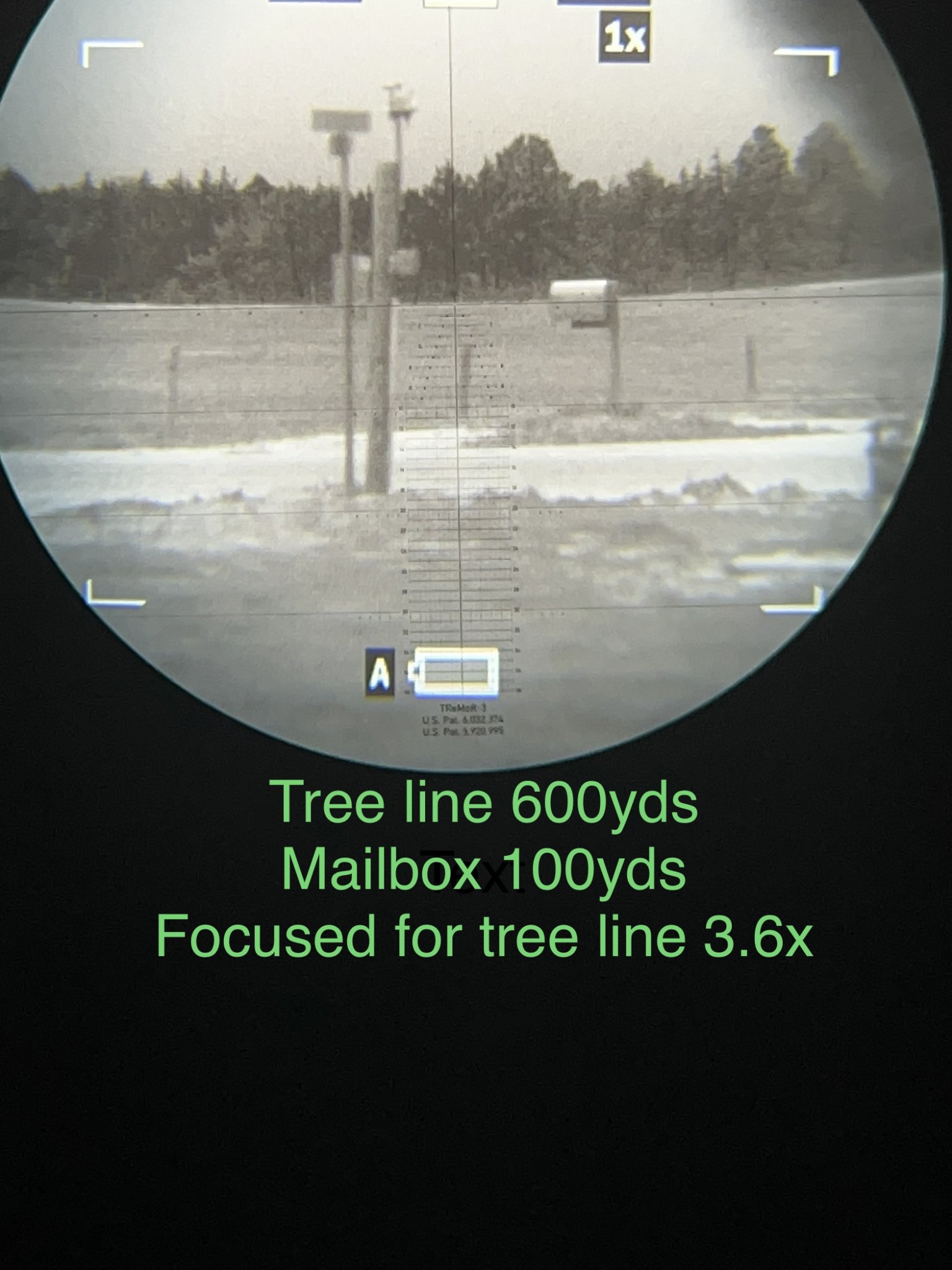

Still waiting on my mid range thermal unit, will advise when I get it. I did however get in the new EOTECH mid range clip Clip on NV and I am very pleased with my initial impressions. I am getting a nice full view at just 1.5x through the 1-10. Its rated at 1-12x so I will get it out soon on some higher mag optics and see how versatile it can be. Liking the length savings over my previous 2124LR.

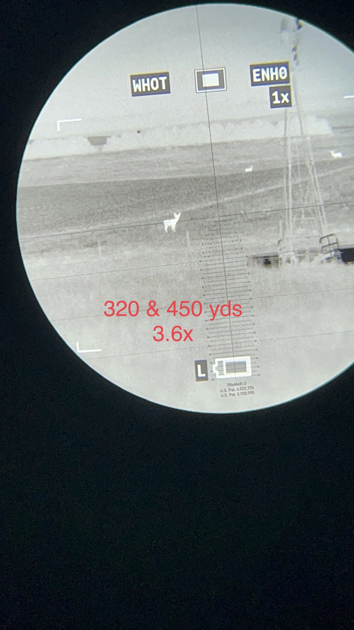

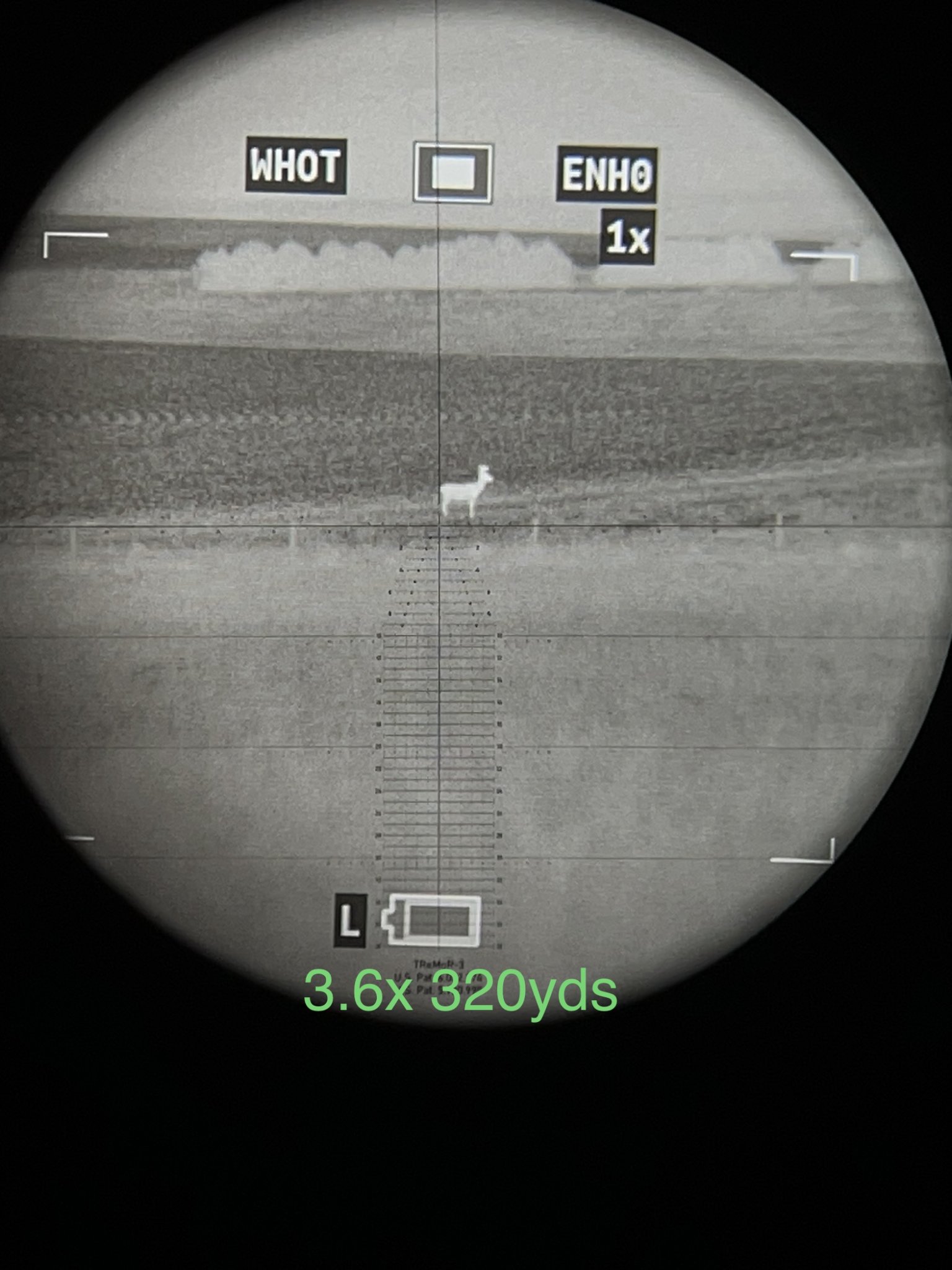

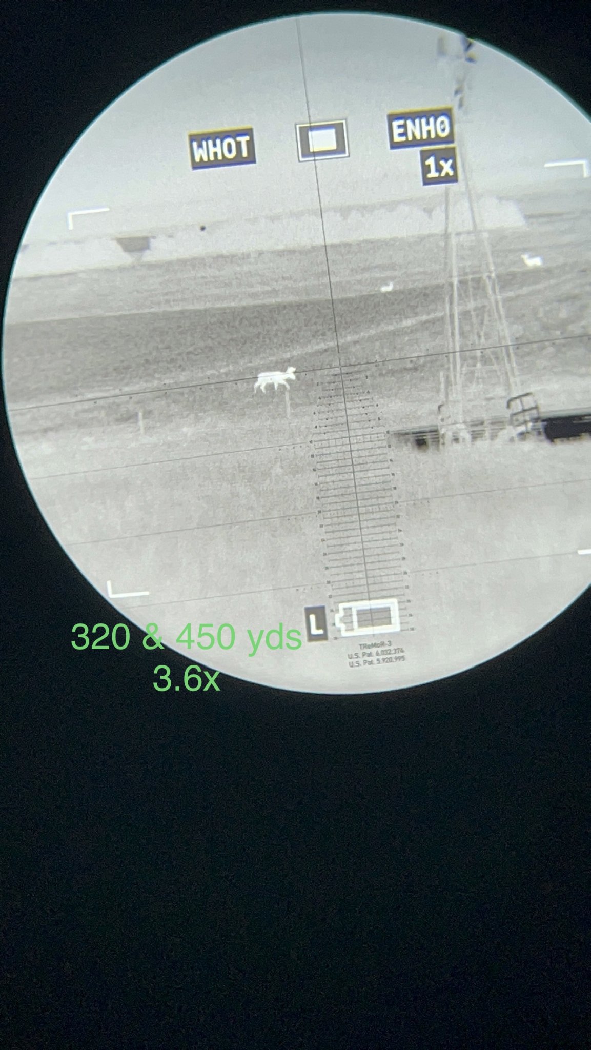

Found a few deer tonite

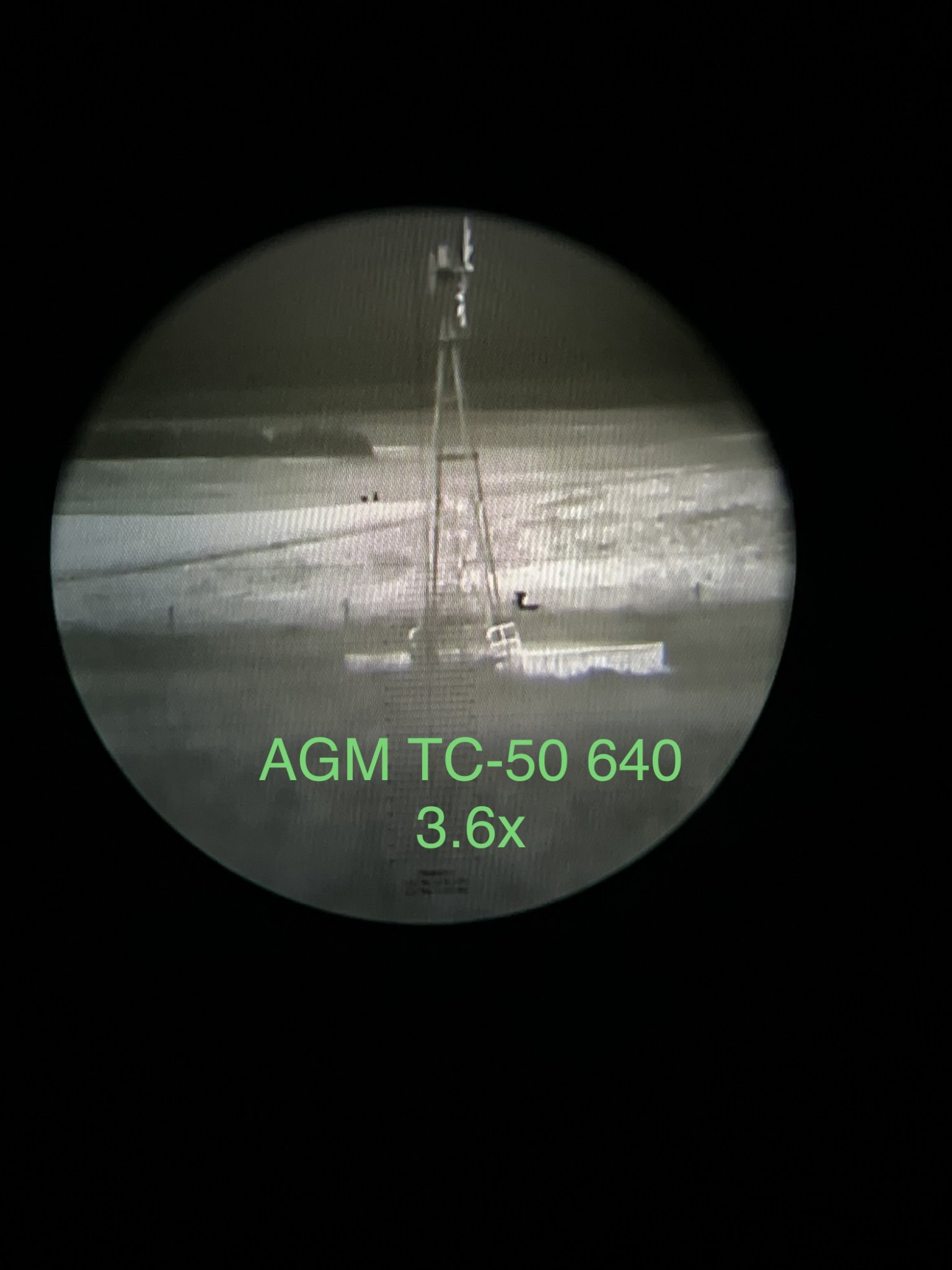

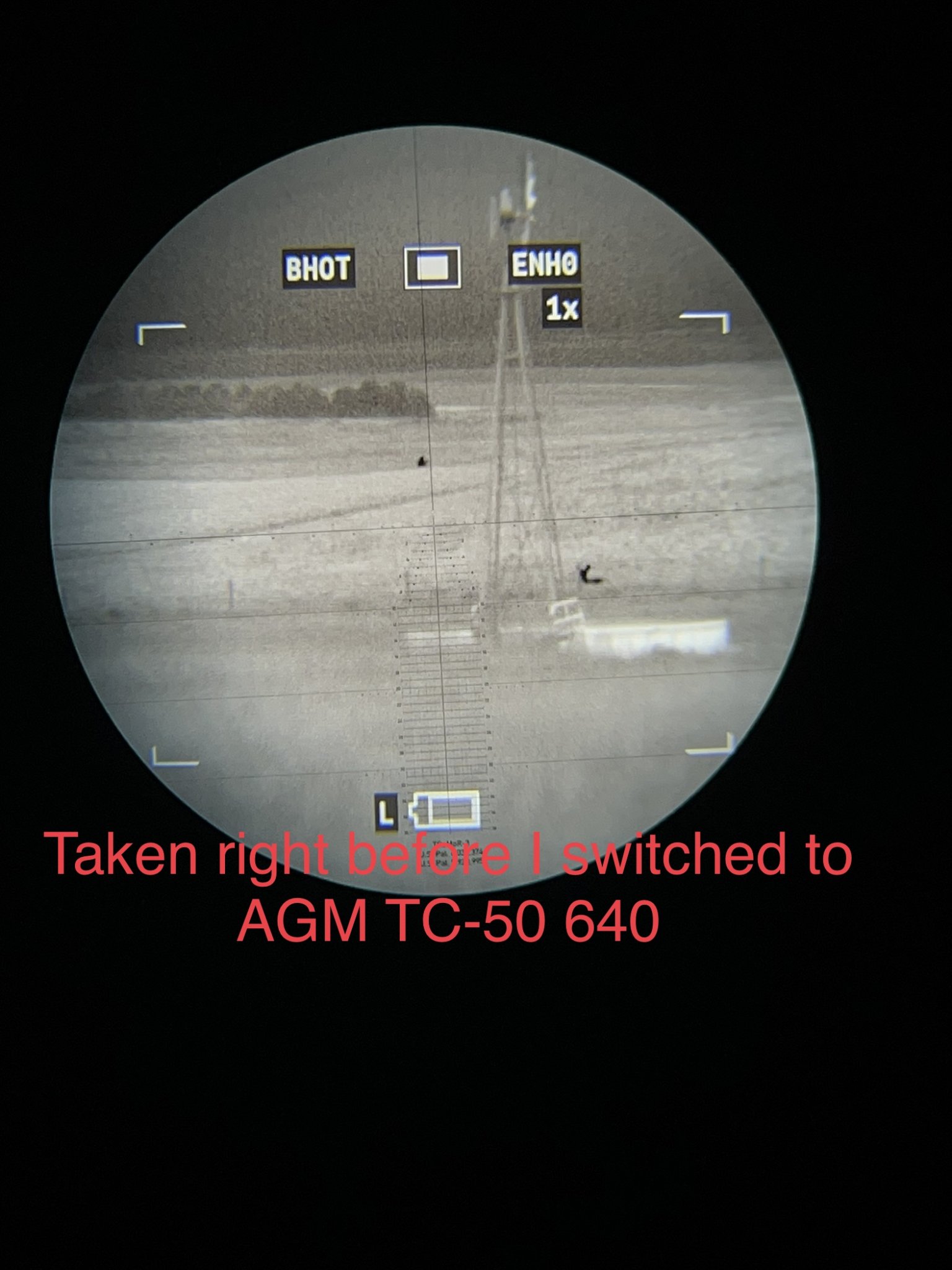

Surprisingly, the AGM TC50 appears to be holding its own per the picture.
It doesn’t do to bad to about 800yds or so. After that PIDing objects gets harder. Was looking at an old farm stead about a mile away last night and the Clip-ir LR easily pulled away by a large margin. Roughly 800-900 and in the AGM does a decent job.
@WhereNow&How 640 version of the tc50. My brother has my old 320 tc50 and we both agreed the 320 did better at distance than the 640. Closer in the 640 had a better image. The 320 has an aluminum housing where as the 640 is plastic. I think eventually I’ll sell the 640 but I’m guessing with the Steiner c35 hitting the market it might be a tough sell.
Reactions: WhereNow&How
Yep, funny how the 320's can outperform 640's at distance, albeit it comes with a narrower FOV.
All about pixel density per sq. inch.

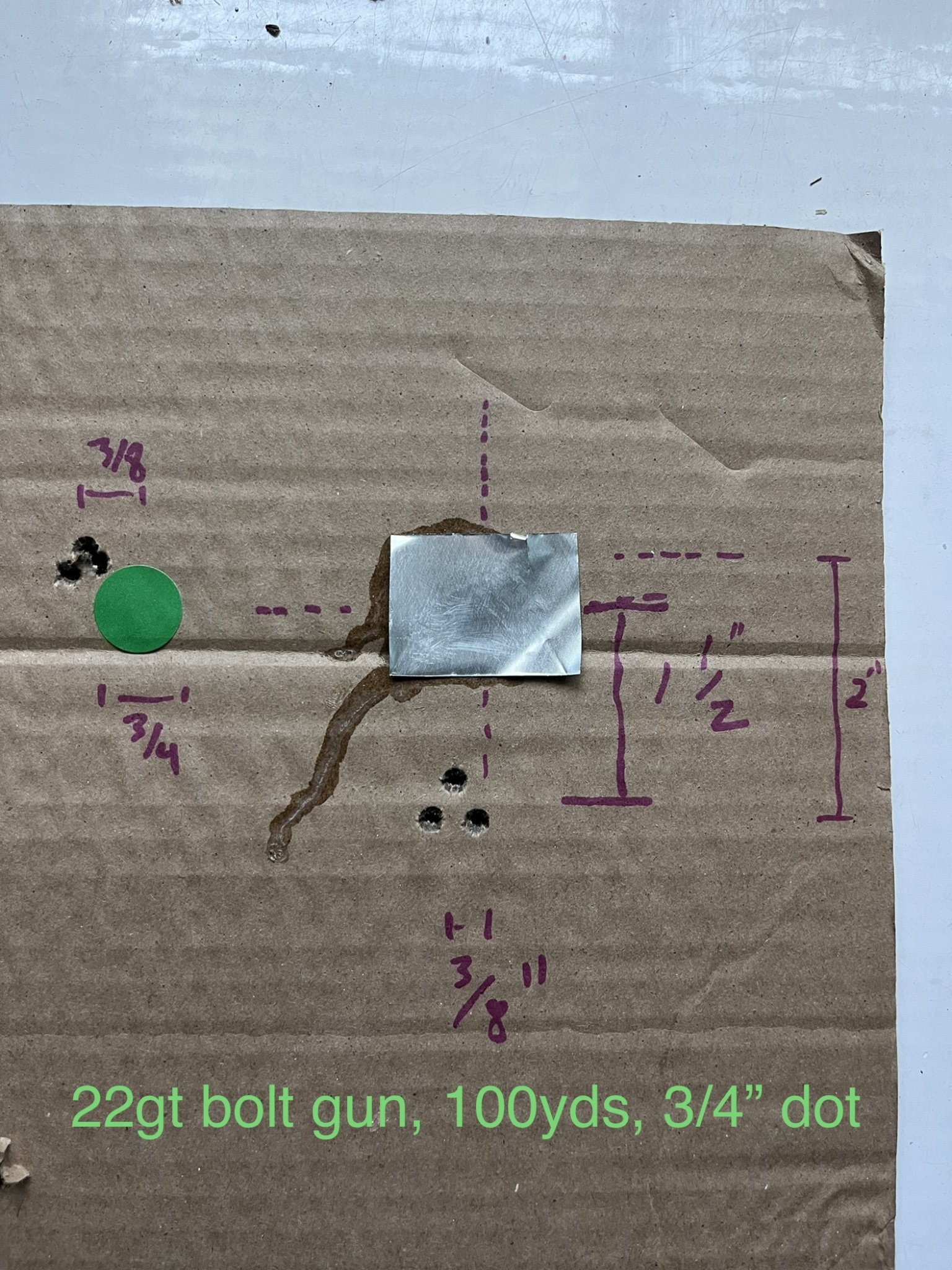

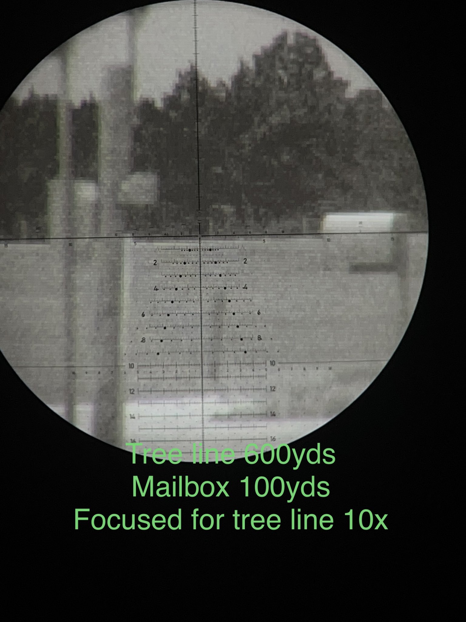

prone
22gt
AI with vision chassis
ZCO 420
100yds
20x for day scope group
10x for clip on group
Still windy and hot, going to make wheat harvest early at this rate🤨

I’d be verifying that with a couple more tests and then returning it for another.
Ya I’ll mess with it a bit more. Probably should order one of those fancy thermal targets for more testing. I guess though if it’s a repeatable .5 mil ~ low on multiple guns I can deal with. My old tc50-320 my brother has now was a consistent .4 mil low. Just clamp it on the gun, dial up .4, and go to work 😄
But for over $10k, 2 MOA isn't really acceptable when the industry standard is 1 moa. I think more testing is needed, and hopefully it's just a bad unit. If I got my ELR and it was 2-3 MOA off consistently, I would assume it was broken and send it back.
As long as it's consistent and repeatable, running an offset in the day scope is no big deal for me either. If it moves around, that's another story. But for $15k, it shouldn't be doing either.
This 2moa offset was with the setup that had the day scope up on a riser, right? Can’t imagine that helps the situation having the optical axis being so far off from each other.
EDIT: maybe I’m mixing you and wig up, who posted this on the other thread

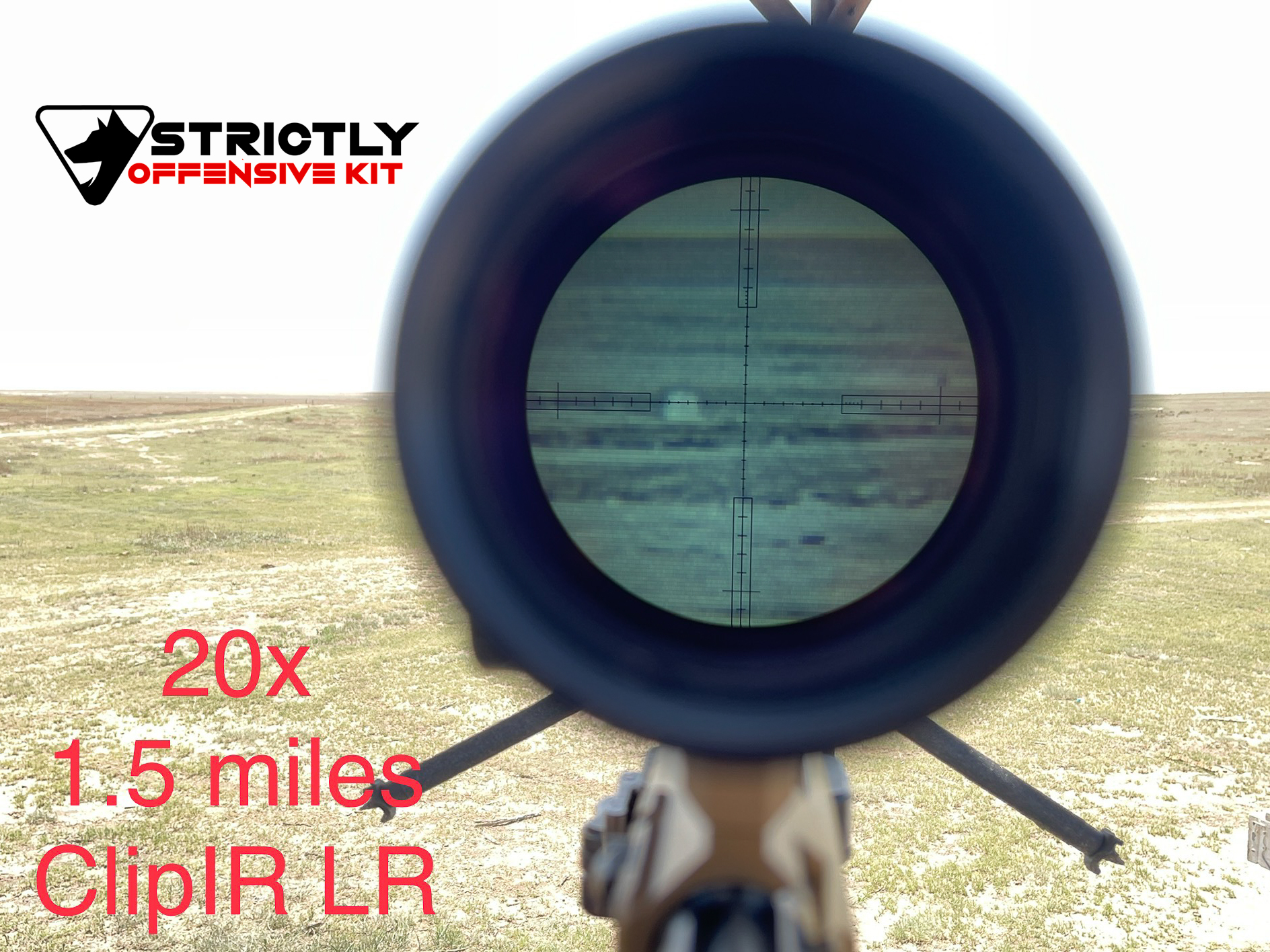

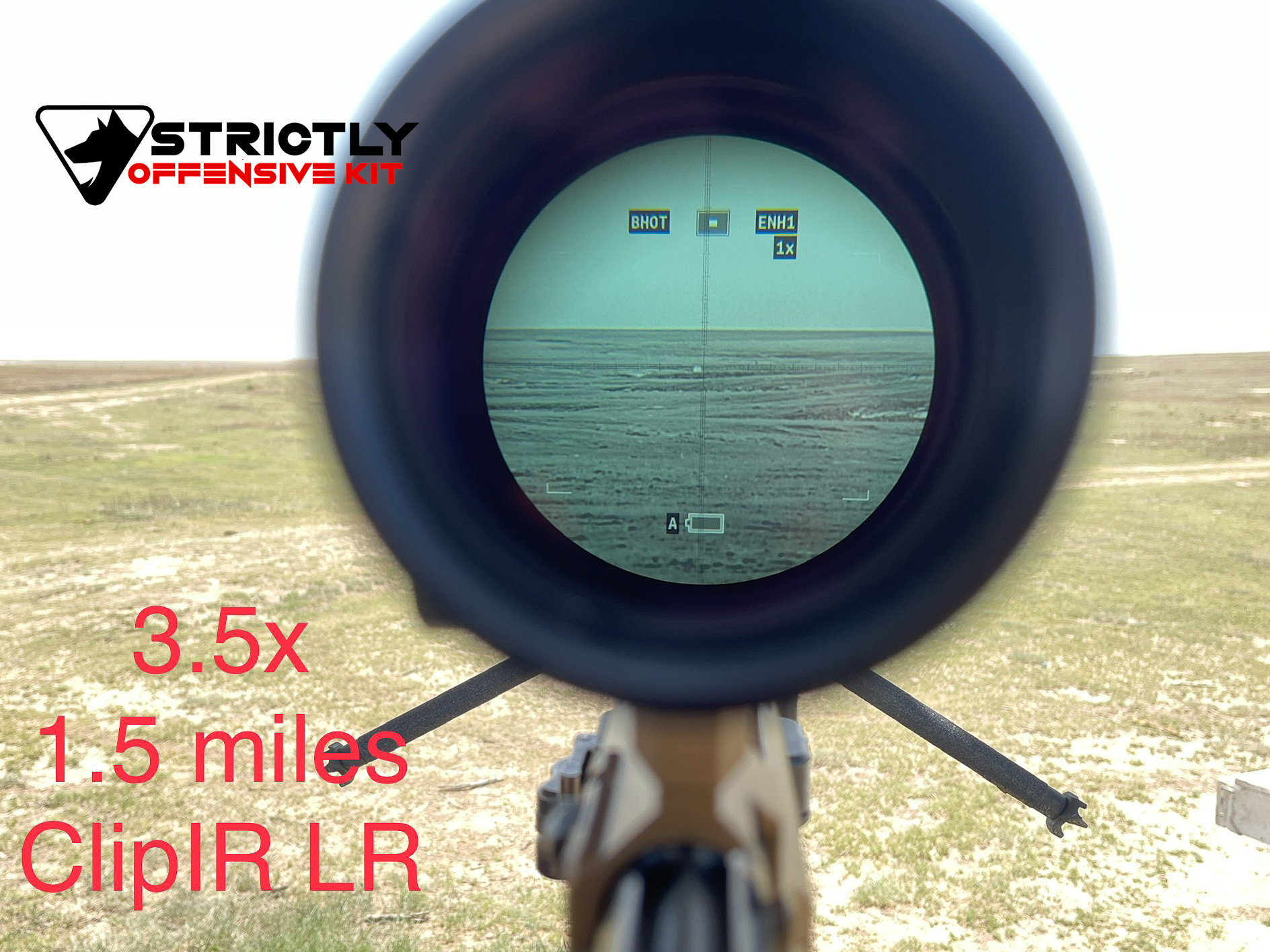

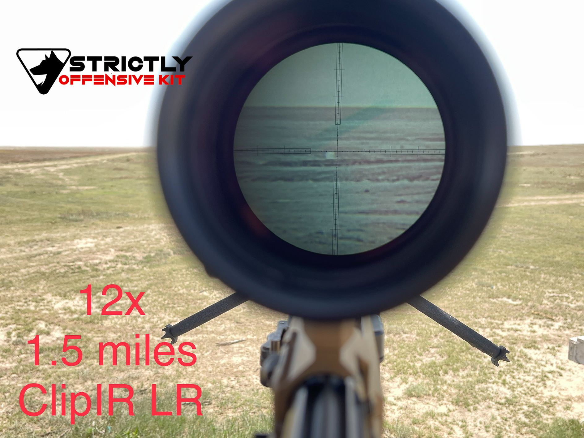

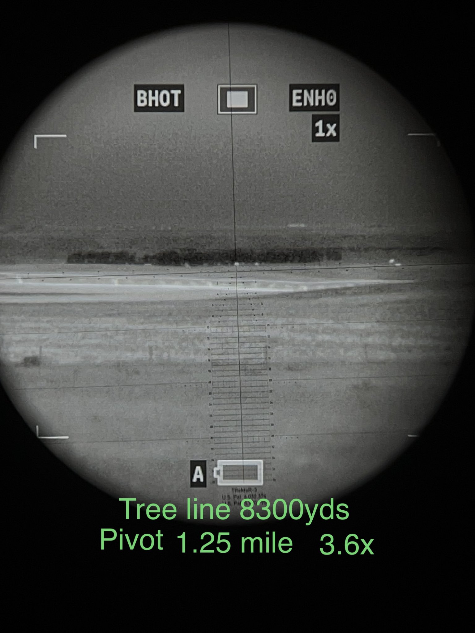

I tested the ClipIR yesterday at dusk on steel plates that are separated every 100yards. Fire round from rifle - mount clip-on and fire - same impact. Did this several times with great success. This was through a Steiner LPVO.
Also fired a round on 2x digital. It was low by about an IPSC plate at 550 or 650 yards. This is to be expected.
We also took it out in the heat of the day with 25mph wind gusts, 104F and terrible mirage. Humidity was most likely very low. We found the 1.5 mile steel plate as seen in the pics. Optic is a Hensoldt 3.5-26.
