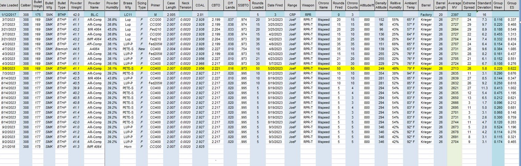

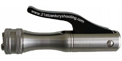

Instead of using my Lee hand primer that I got many years ago, I now uses the 21st Century hand primer, which is adjustable to whatever depth I want. Also it has more leverage than the other hand primers making it much easier on these old hands of mine, and has a hard stop for more consistency. It's not cheep, though.

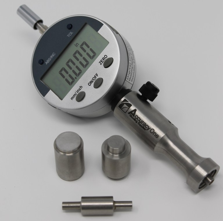

And to quickly and accurately measure seating depths or primer pockets, I use this tool (also, not cheap 😵‍💫 :

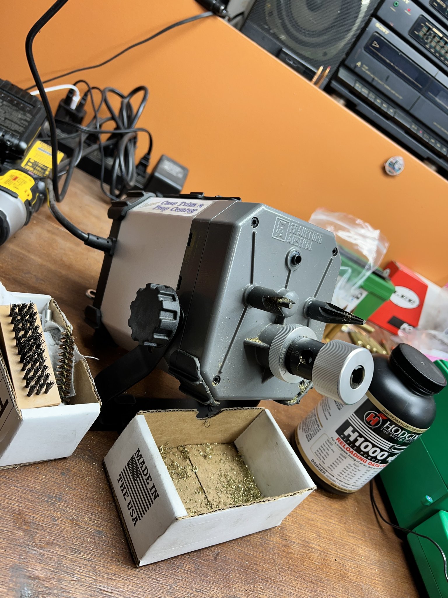

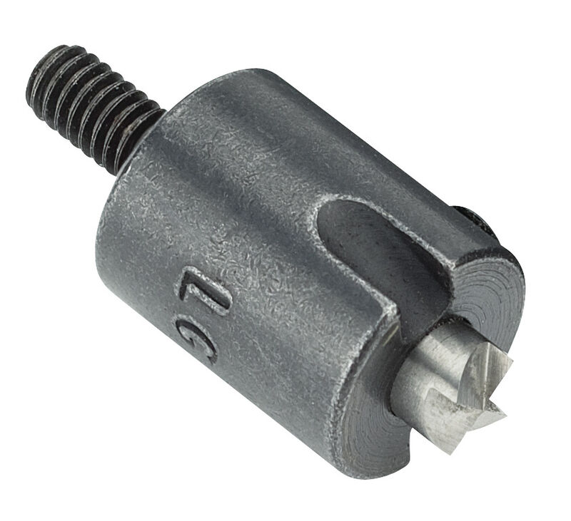

FWIW I use a Hornady Case Prep Duo, but with a VLD chamfer head instead of the standard chamfer tool most come with, the regular chamfer heads are nearly useless with most modern long range projectiles and do more harm than good IMO since they make a sharp ledge.
Forgive my ignorant question, but is that basically like using a VLD chamfer in a cordless drill (my current plan)?

In addition to my 21st Century priming tool I've also got the Frankford Arsenal adjustable priming tool. Though Frankford Arsenal is adjustable, it just doesn't have a good hard stop like the 21st Century tool or like the CPS from Primal Rights and still hard on old hands like mine. Yup, it comes down to if one wants quality equipment and how much one wants to spend.
That little light saber looking 21st century priming tool is the fucken mutt’s nuts! Cool & quality ain’t cheap😎
Thanks. I had ordered the Frankfort unit per John's recommendation. If it does not work out well I will try this one. The AccuracyOne set will stay in my wish list for now.
Do you think uniforming primer pocket will make a difference? I'm thinking of getting something like this https://www.brownells.com/reloading...-flash-hole/carbide-primer-pocket-uniformers/.
Reactions: markl323
This Frankfort is a good improvement over what you have and as I mentioned in a previous post, I also have it. I was a little disappointed with it in that it didn't have a good hard stop where I could get as consistent seating as I hoped for. . . AND, the leverage isn't really any better than typical hand held primers making hands get tired when doing a lot of priming. The 21st Century one is so much better in every way, though you do have to buy separately the LRP and SRP seating pins.
For most types of shooting venues, I don't think is makes enough of a difference. If you're a benchrest shooter competing for small aggregates where winning is determined by the .0001", then I'd say a big yes. I do not compete, but I do like to have my cartridges as uniform as possible so that when I see a flyer, I can better investigate and determine what might have caused it. . . often it being the nut holding the rifle. So, I do uniform my pockets and seat the primers uniformly as a way to eliminate any question about issues with that part of the cartridge when I see something I don't like on my targets.
I would not get a pocket uniformer like that as it isn't adjustable. It might work just fine with your Alpha brass if the cutter is set as the right depth. But then, if you use some other brass that tends to have significantly deeper pockets, this uniformer probably won't work.
I have an RCBS pocket uniformer as well as a 21st Century one (see pics below). The latter is much easier to make adjustments and actually contains within cutters for both LRP's and SRP's. Both have carbide cutters, which I feel is important to get good easy cuts in the pockets.
