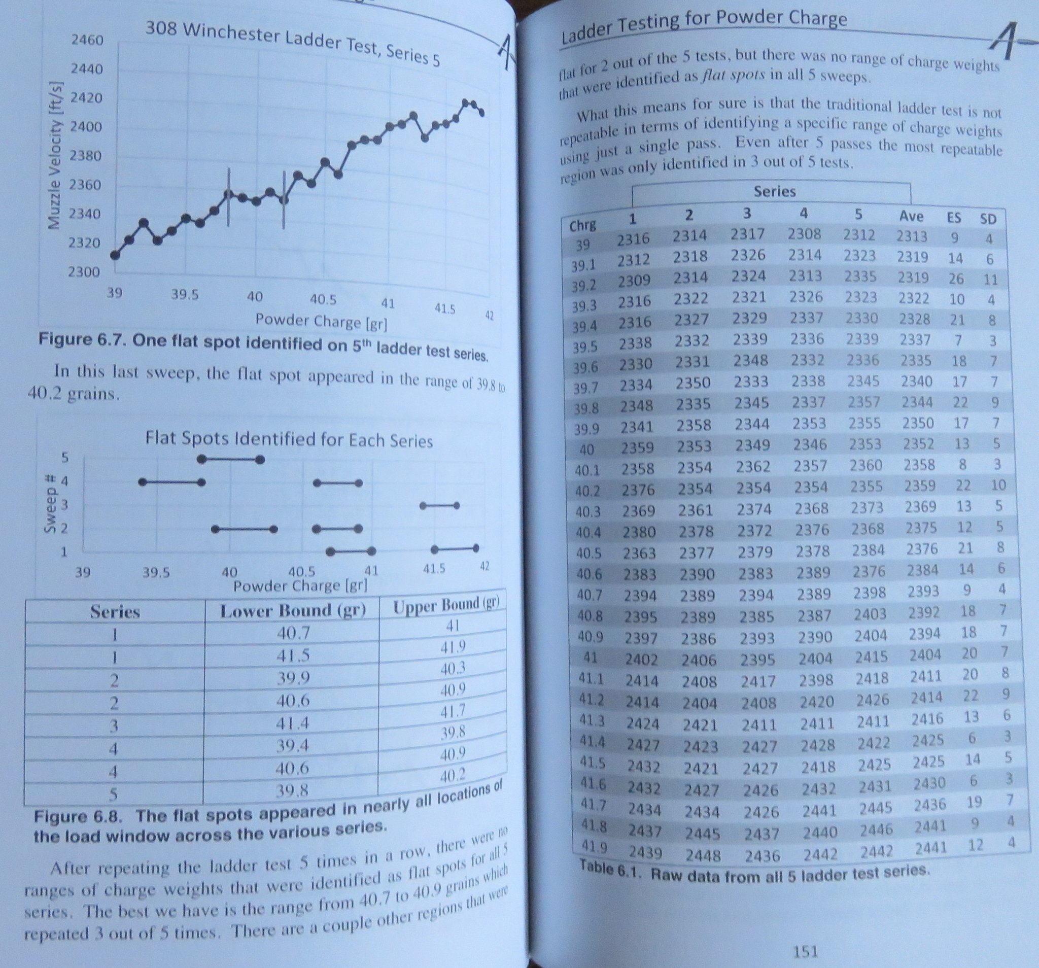

I watched a video yesterday and they were talking about using a Chrono to find the velocity plateau for ES.
Using a Rem 260 with H4350 and Hornady 123 Eld and CCI primers does anyone have an idea about what velocity the plateau starts to show up.
Trying to get a rough idea before I start so that I don't miss something.
There may be some confusion here not knowing the source of your info. A velocity plateau is not a term I am familiar with but I suspect they are looking for a spot where the velocity doesn't change as much for a change in powder charge. If this is what sometimes referred to as the Satterlee method, or a velocity ladder. Scott Satterlee was the impetus behind the method a few years ago but has since changed. The "flat spot" is a function of the testing not a function of the charge weight. Look for some recent posts concerning "flat spot'.
It's been proven, on more than one occasion, that doing this kind of testing is really a waist of time and components. You're better off focusing on what you get on your targets.
What your chrono can tell you is how well you're loading your cartridges; that's all, other than having data you can use in ballistic calculations for firing solutions.
