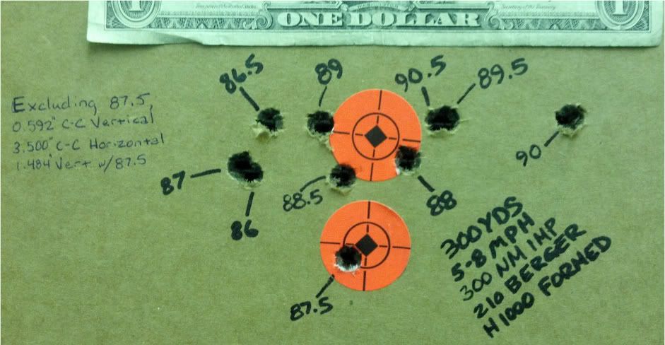

Went out today with the 300 NM 40° Imp to test some forming loads and do a ladder test with the 210 Bergers and H1000. The ladder test is strange to me because if you exclude one shot (87.5 gr) I only have a vertical spread of 0.592" C-C. It really makes it difficult for me to choose where to go from here. Below the pic, I will post the velocities.
86.0 - No data..88.5 - 3210.....91.0 - Did not shoot
86.5 - 3162......89.0 - 3215.....91.5 - Did not shoot
87.0 - 3185......89.5 - 3224
87.5 - 3219......90.0 - 3276
88.0 - 3207......90.5 - 3280
Starting at 88 grains, the velocity went down and between 87.5 and 89.5 grains, the velocity was stagnent. I'm guessing that 87.5 grains should be my effiency limit. Is this correct? It takes another 2.5 grains of powder to see any REAL velocity increase. I know these are only 1 velocity per round but, at least its something.

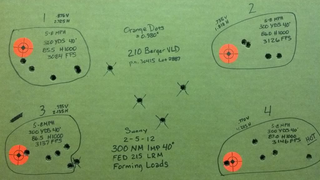

I also shot 4 groups to find a load when forming brass with the 210's. I like group #2 but, the groups have more horizontal movement than I was expecting. Does this indicate a potential rifle issue or can it just be attributed to the wind? At my shooting position, I had a 5-8 mph wind running from 2 - 7 oclock. I was shooting across a "wind tunnel" 2/3 of the way to target. All shots were fired at 300 yards prone. Group 4 was too hot to shoot on a regular basis. Whatcha think?
Re: Evaluate my ladder test & groups. 300 yds
I would say you could have a problem with your barrel not being floated.If your first shot of the string was at point of aim and then they started to string to the right. You say the wind was 2 to 7 oclock, your impact would strike left not right. Just my opion.

The barrel appears to have plenty of clearence.
I know the last shot in group 4 was in the dot and the first shot was on the right. Same with group 3. Group 1 had the first 2 shots below the orange dot and group 2 was nearest the dot for the 1st shot and then the third shot went right.
<div class="ubbcode-block"><div class="ubbcode-header">Originally Posted By: Cigarcop</div><div class="ubbcode-body">You need to shoot the ladder test out further than 300 yrds, then you will see your vertical. </div></div>
I'll try and get out to 450 or 500 yards and repeat. I've typically seen a vertical spread at 300 with all of my other rifles.

If the intent of the ladder test is to find a 3 consecutive shot node with minimal vertical dispersion, then I'd say your 89.5 - 90.0 - 90.5 node will be hard to beat. I
would load 5-shot groups at 90.0 gr. at different seating depths and see which seating depth affords the tightest group.
Looks like 89.5-90.5 are the tightest. Like Squarenut said, go from there. Although there is minimal vertical dispersion, as long as you feel you had good form for every shot, no reason not to. But, if you have longer than 300 to work with, that woul dbe the optimum scenario.

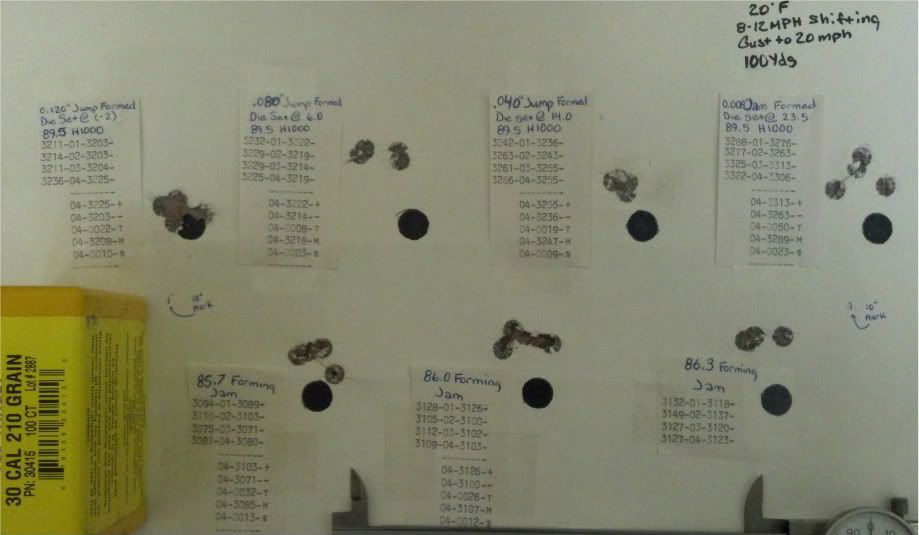

I had gone out the previous weekend and shot these. Temp then was 20 and temp most recently was 40.
Top left is 0.120" jump, 0.080" jump, 0.040" jump and top right is jammed. All groups have 4 rounds.
Bottom row are my forming rounds where they need to jam to assist in proper shoulder formation. I only got to shoot at 100 yards due to the wind which was shifting 8-12 and gusting to 20 mph.

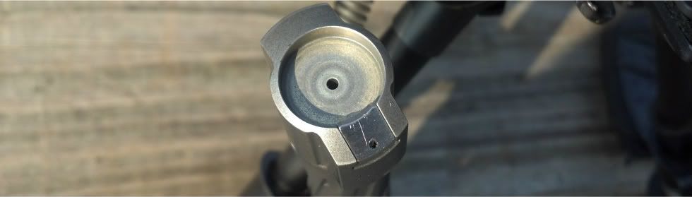

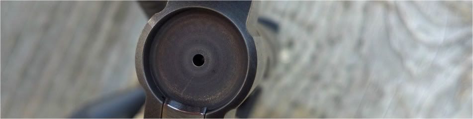

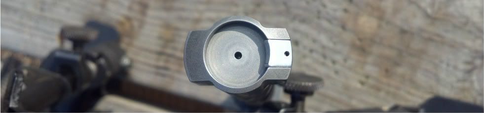

Well, I went out today to form some more cases and "find pressure" again with the cases I already have formed. I had been shooting 89.5 grains 40 off the lands and had the issues described above. Today, I started at 86.2 and went up to 88.6 grains in 0.3 gr inc. The first round had resistance when opening the bolt. This is what the bolt looks like after 3 firings with the old brass and a max on this photo of 86.8 gr.
and this is what it looks like after I clean it with some steel wool.
It's kinda hard to see but, the forth round of the day was shot on a clean bolt face and you can make out the word "Norma" on the bolt.

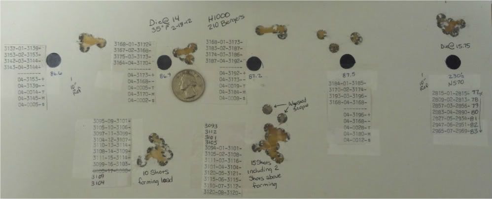

I'm going to attribute all of these issues to soft brass and an idiot overloading them. I have settled on 87.0 grains after this work up today in less than favorable wind conditions. All I need to do now is vary the seating depth to try and dial it in on a good wind day. Previous velocitys on 89.5 grains netted me 3245 fps and 87 grains gets me 3175. 75 fps is not worth a $2 piece of brass after 3 firings.
The group on the top right is 230 Bergers over N570. I went out to find pressure and didn't put enough powder in. The 7 shot group can be covered with a quarter and the charge weight runs from 77-83 grains in 1 grain increments. I have also dropped my forming load down to 84.5 grains from a previous 86. The new forming load gets me about 3105.
Now I need to get out with the new load and see how many firings the brass will stand up for.
